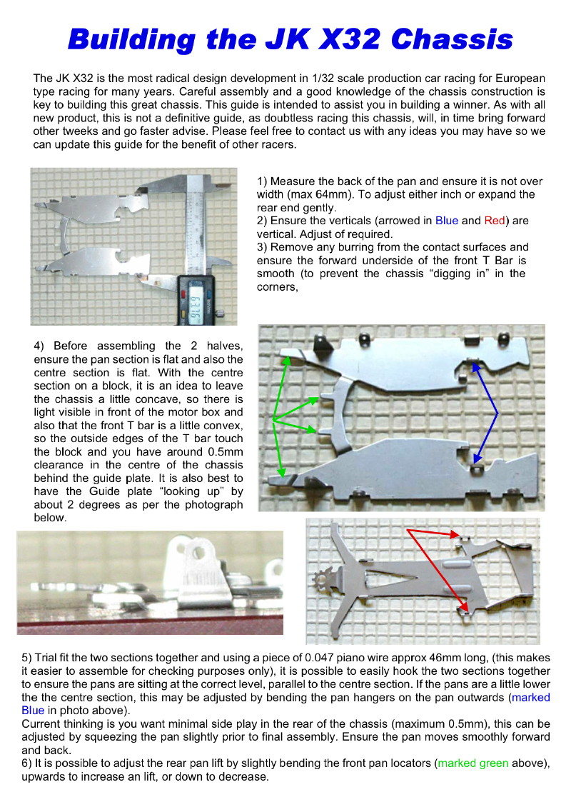

Building the JK C11 1/32 chassis
9 replies to this topic
#1 Cheater
  • 25,548 posts
Posted 19 December 2009 - 11:56 PM
This is for the 1/32 version of the JK C11 chassis, which the British seem to call the X32.

I am looking to build a couple of these cars. I am going to build one with a two-piece chassis and one with a three-piece chassis. I want to set them both up the same to start to get a feel for the different handling characteristics.
Any one have any tips on setups and tricks that have improved the handling? I am curious as to what different "Bite Bars" will do to the handling?
I plan to run 3/32 axles. I have been looking into 2mm axles and wondering if there are any noticeable gains?
Thanks.

Are you building these for fun or to race?  They are racing this class at the ROC there in Windham.  But you might want to look at the rules because they don't allow 2mm axles in this car...

I am interested in peoples input on what works best when setting up these cars.

1.  The bigger the bite bar the tighter the car will be.
2.  2mm will somewhat lighten the rear, but limits the tire choices (based on hubs)
3.  Body selection can help; several good OS and RF choices out there
