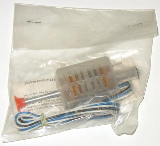

#37 slotcarone
  • 4,032 posts
Posted 04 April 2011 - 06:09 PM
:D We all got burned on those puppies--where did you find that picture?
#38 Howie Ursaner
Howie Ursaner
  • 1,452 posts
  • Joined: 01-March 07
Posted 04 April 2011 - 09:08 PM
its unbelievable what you can find online.Believe it or not it seems these things are still being sold for HO racing.Amazing, Unreal, I think i'm gonna have a cow. :blink: :shok:
http://hoslotracer.c...tat-727?page=11
Howie Ursaner
