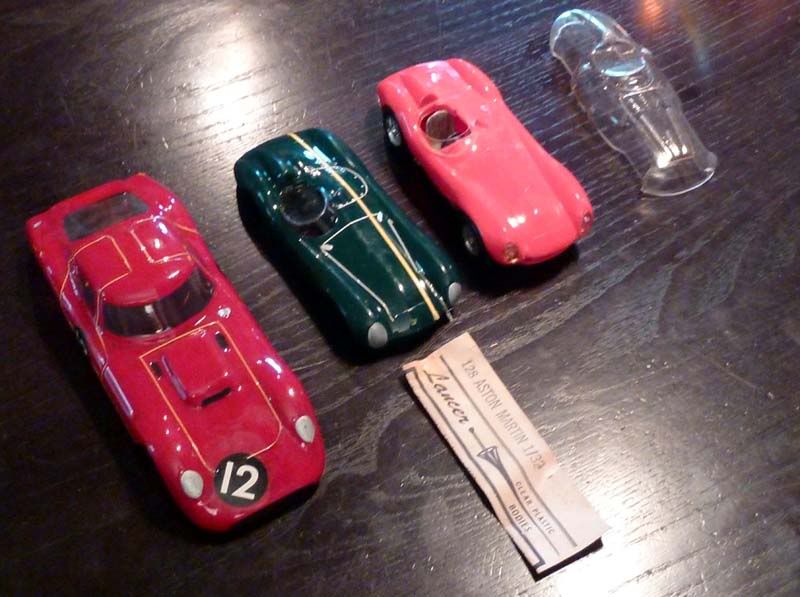

Below is an original pull...
That has to be butyrate, Lexan does not pull as nice.
Russ Toy (not Troy)
