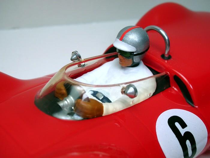

I find detail painting very difficult. I don’t do as much on a car as I’d like to but……..I just do the best I can. To help me with helmet stripes and goggle straps I cheat and use RC striping tape:
The Russkit mirrors are epoxied to the windshield and a roll bar of 1/16” aluminum tube is Zap glued to the underside of the body:

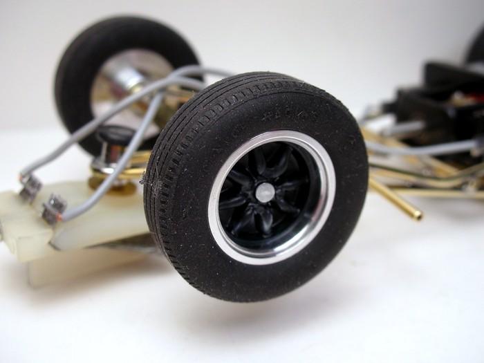

The wheel inserts were painted a dark metallic grey and the aluminum rims polished:

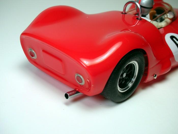

I added an exhaust pipe of aluminum tube. It’s glued to a brass pin tube that’s soldered to the chassis:

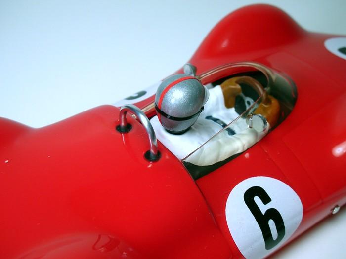

The driver:
You really good painters (insert Jairus Watson here) can make the driver’s suit look weathered and add wrinkle lines. I’ll just leave mine all nice and white…..like at the start of the race!
