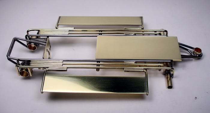

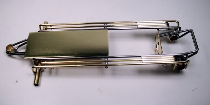

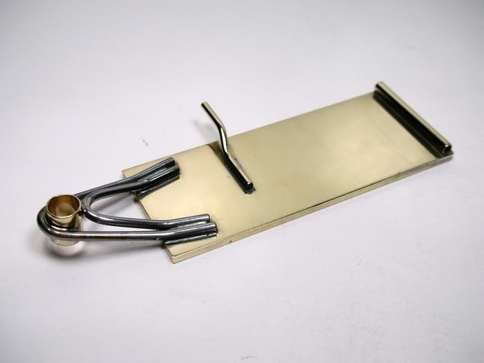

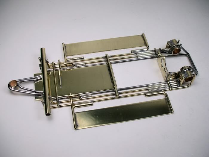

The key link to the era is done. Mr Drop Arm is ready to go:
To me this really gives the chassis a vintage look:

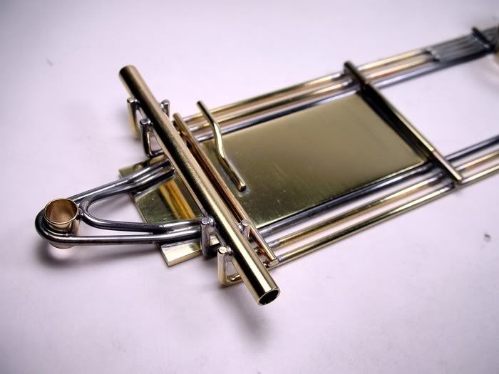

Next comes the pans:

... that qualifies as slotcar porn. :-) A beauty of a job!

Nice drop arm. I'm guessing we started using the plate arms about March of 1967. I remember our local builders discussing why we didn't think to just use a simple (and heavier) brass plate instead of all those brass rods. :)

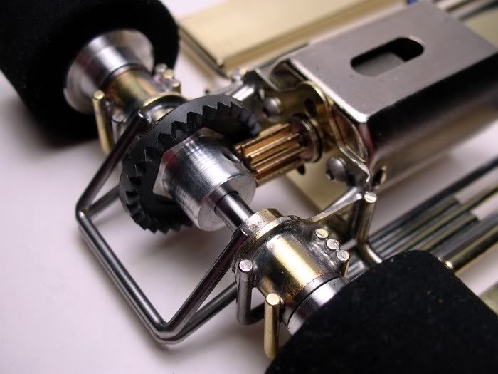

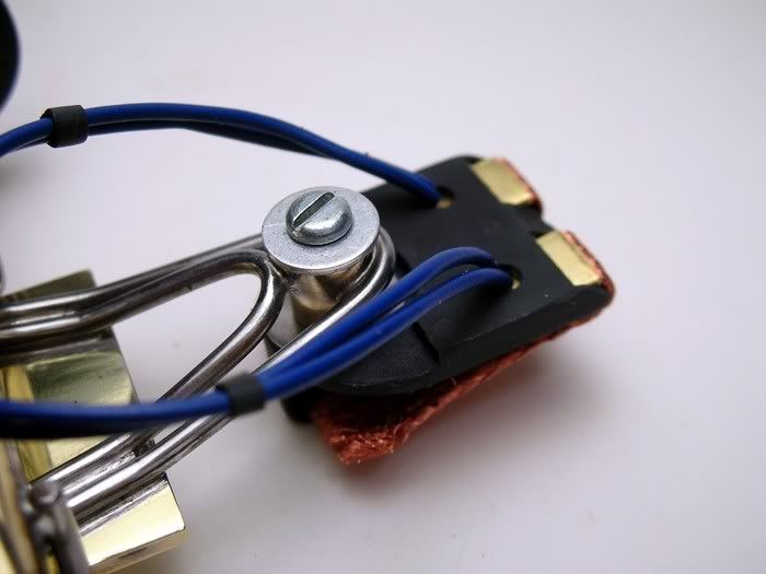

OK, here's what I'm stuffing in this drop arm. On the left is a Cox guide, at center is my modified guide, and on the right is a stock Parma "The Blade".
Steve Okeefe taught me to do this. I used a Dremel tool, a file, and some sandpaper. It does nothing but, I hope, add to the "reflecting the spirit of the mid-1960s racing era."
What do you think?

Yes, Rick, but aren't you supposed to build a slot car? All I see here is fine jewelry... :D

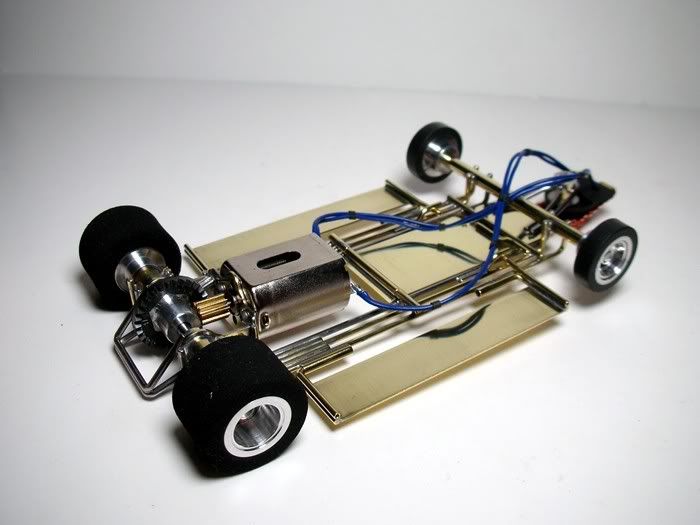

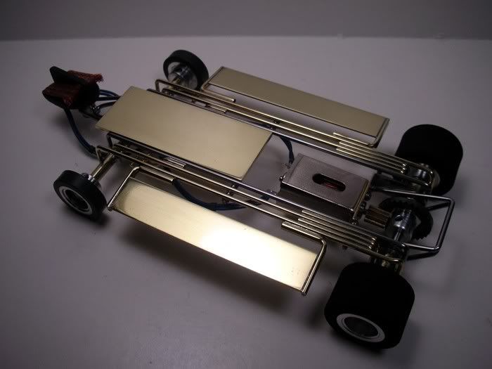

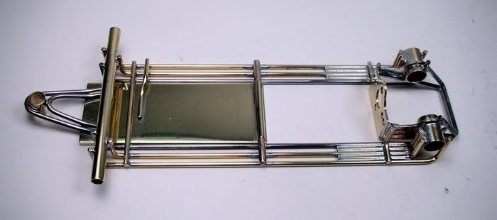

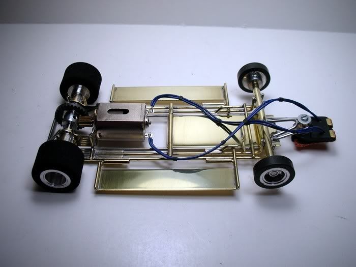

Thanks, Dokk :blush: . I sure hope this thing is fun to drive so it won't be just a paper weight :blink: :unsure: . Anyway, here is the finished chassis:

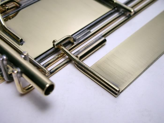

I thought it would be fun if I used period pan hinges, up stops and down stops... no .030" piano wire:
It weighs 64 grams. Is that heavy or light for a D3 chassis???
Yes.
:laugh2: LOL!
It's all relative. It's not the lightest nor is it the heaviest. It can/will be made to run good on some tracks. On a King track, it may be too heavy to win. Unless, of course, if run against similarly-built vintage cars! :D
#58 TSR
Posted 11 November 2007 - 08:36 PM
Rick, trust me, you will NEED the weight. :)

Rick, That is a good weight for the King track... just don't hit anything :rolleyes:
Thicker pans for the Kingleman (.040) and even heaver drop arm (.062) for the flat track must might be the trick! Very beautiful chassis by the way. :clapping:

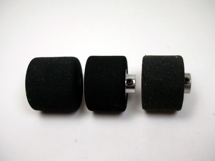

I know it HAS to be slower than the modern-design D3 cars but I'm wondering how a vintage design will drive. I'm somewhat concerned about the weight because I don't want it to be too much slower down the straights. It already is going to have a slower speed exiting the corners.

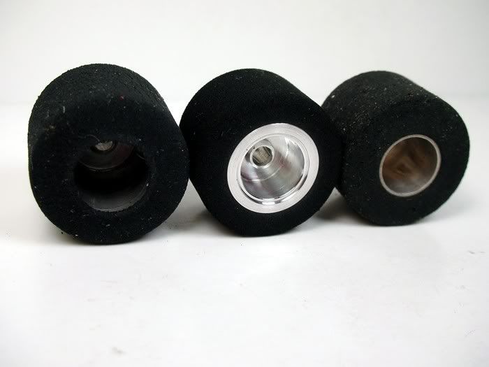

I'm kind of after a slower cornering speed though. Not so punched in the turns. Maybe it will have a touch of drifting action :unsure: . Toward that end, I'm using 1968 spec rubber. Below from left to right are a modern Alpha 7/8" X .800" wide wheel-tire, my 1968 legal 5/8" wide Alphas on our cloned Riggen AA vintage wheel and an Alpha narrowed up to 5/8" wide:
Geez, that wheel on the left looks like sh*t :shok: at least to me :blink: .

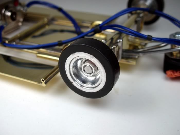

Anyway, here it is together:
Here are the double thin lead wires, Cox look-a-like guide, no guide clips, and no guide nut:
Here we have a 1/8" axle with no pink crown gear and no angled pinion gear:
Here are no plastic wheels with foam tires:
And finally, we have a view of a bovine, tilting pile: :shok:
Or not :unsure: ...
Time to get a Dynamic Lola T70 body mounted and test it at Eddie's, :D
Onward... ;) :)

When building D3 cars just figure on 50 grams in running gear and body. Comes out pretty close for a guesstimate when building the chassis. On most road courses I use 120 to 125 grams as a rule. Anything over 115 grams and you'll notice the brakes start to go away. If she tilts, narrow the tires first, don't add lead. 1/16" or 1/8", depending on the tilt.
If you add lead, start by putting squares right behind the front body mounting tubes on the pans. Start with a total weight of 120 grams first. Seems like there is a loss in horsepower when the car's weight goes over 125 grams.
After adding lead you may have to go back to wider tires, maybe not. Don't forget, D-3 cars USE the front wheels as their outriggers. They MUST touch and roll on all sections of every lane. On BPR's King, 100 grams is the starting point that I use.
She's a beauty. Brings back some wonderful memories. :D Don't forget what my dad always said to me, "When in doubt. PUNCH IT!". :D
