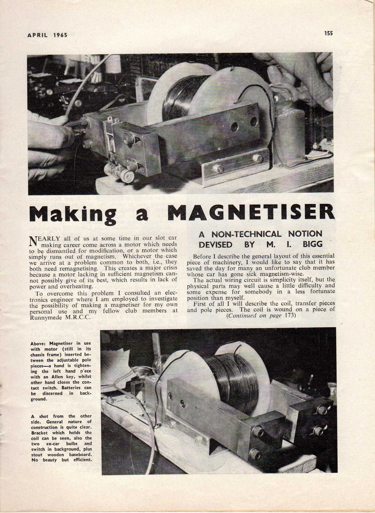

#32 Mark Onofri
  • 2,630 posts
Posted 01 May 2025 - 05:22 AM
It figures, it was at the bottom of the list.
