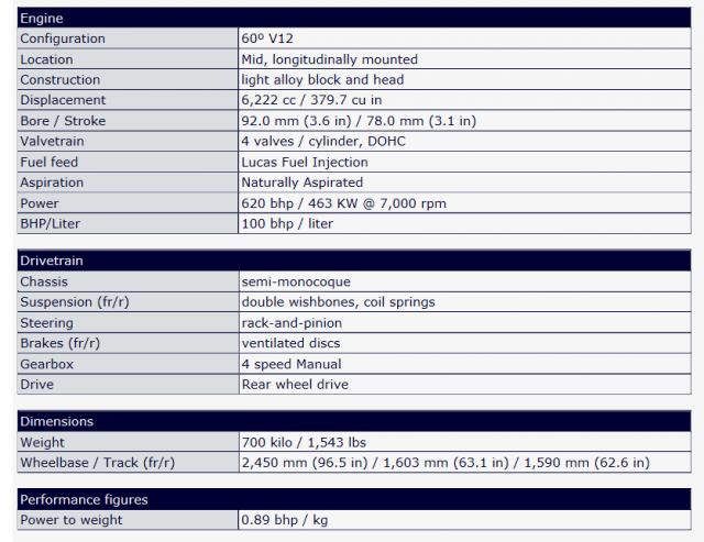

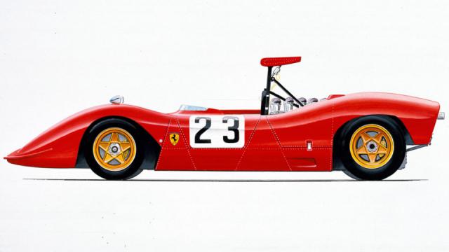

For starters, here's the plan

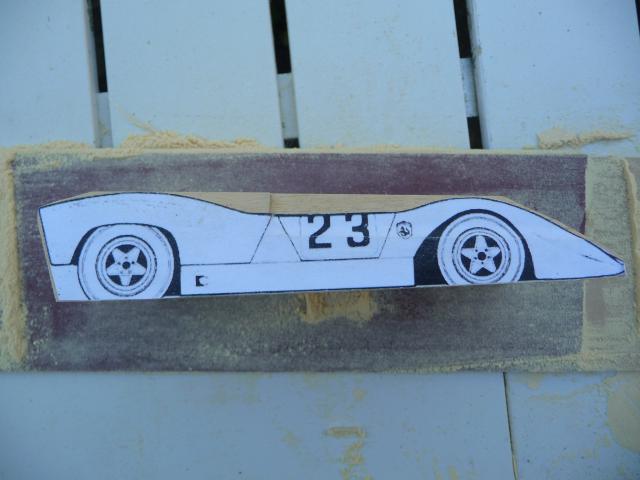

Where did you get the cut-away drawing? My slot car room is covered in these.

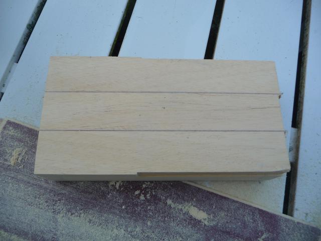

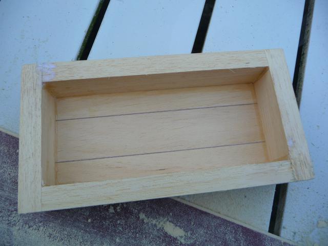

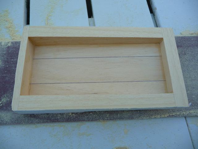

Here is the box made with chopsticks Obéché.
I still have the same method of construction.
The two black lines are 1 mm plywood glued between the wooden sticks, they will use it to achieve symmetry of the car.
I found the cut-away here
http://forums.autosp...artists/page-59

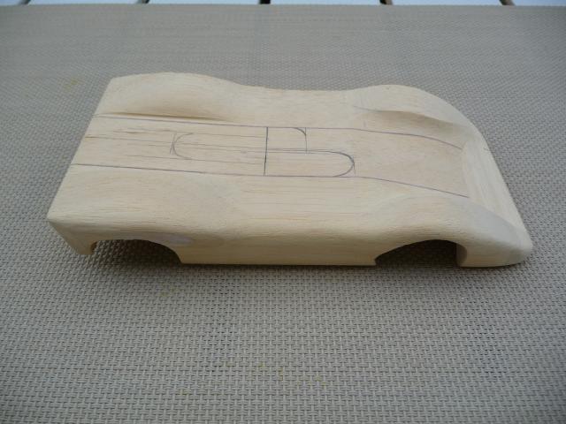

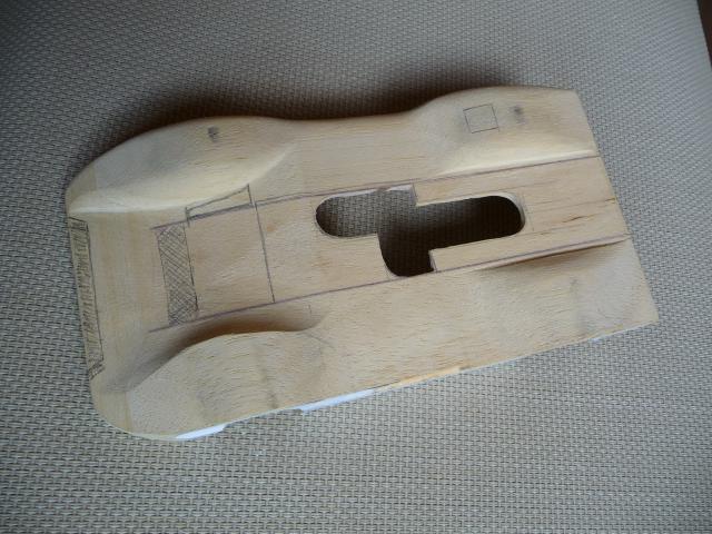

Here are the latest pictures.
I will make a short break and continue later.

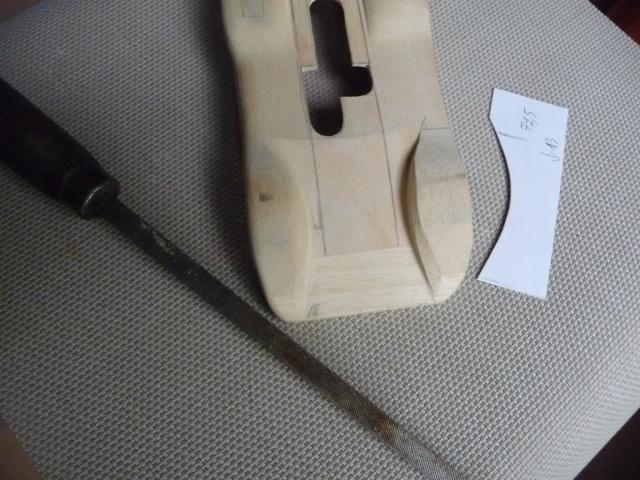

Posted 31 August 2015 - 05:06 AM
This has stages of development, the body weighs 44g

Posted 05 September 2015 - 06:53 AM
Thank you friends for your comment
Now she weighs 38g

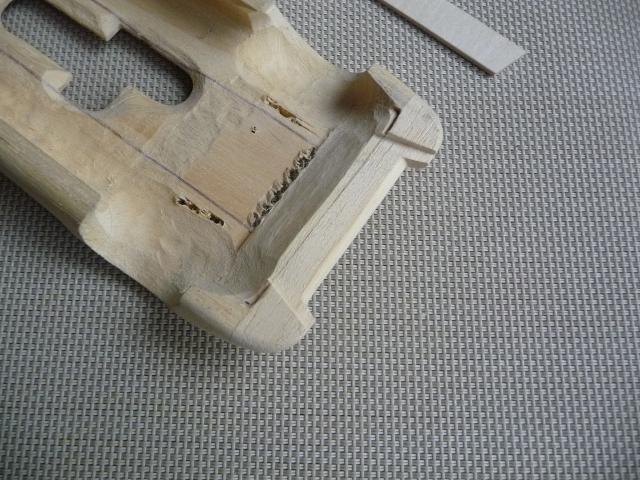

The idea is to cover the central portion of the auto sheet aluminum of 0.3mm thickness.
So this morning out of bed, I did a quick test to see if this is possible.
The tool is brief and to the rest of my remaining sheet and brush handle to push the plate, this is what happens.
It's not perfect but it is feasible, the parts will be rebuilt as soon as I get back the sheet
