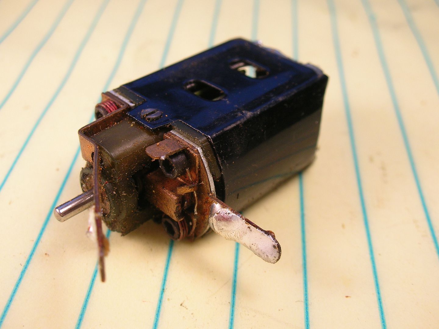

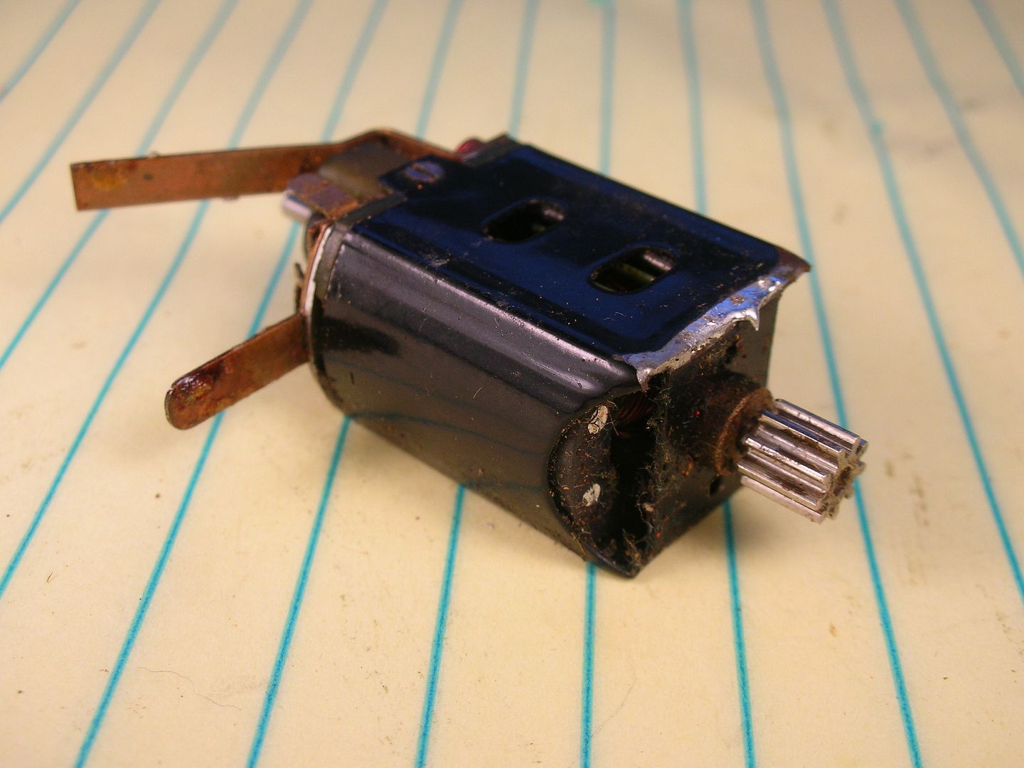

First inspection and the motor looks like it might be a GP15 instead of a GP27, unbalanced with no heat sink:
We'll see when I tear it apart... if it doesn't fall apart first! :laugh2:

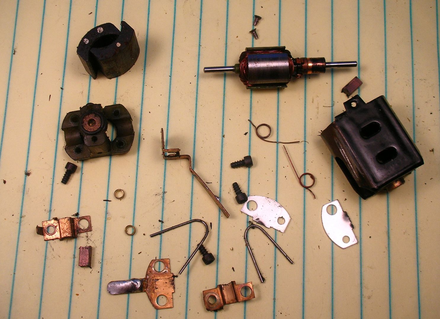

I love Mexican food... and beer! But it seems my "Bandito" GP27 marked box contains a "Lawman" GP15 motor. :o
Unbalanced non-tagged arm:
We have a need to clean:
  • Jencar17 and Samiam like this

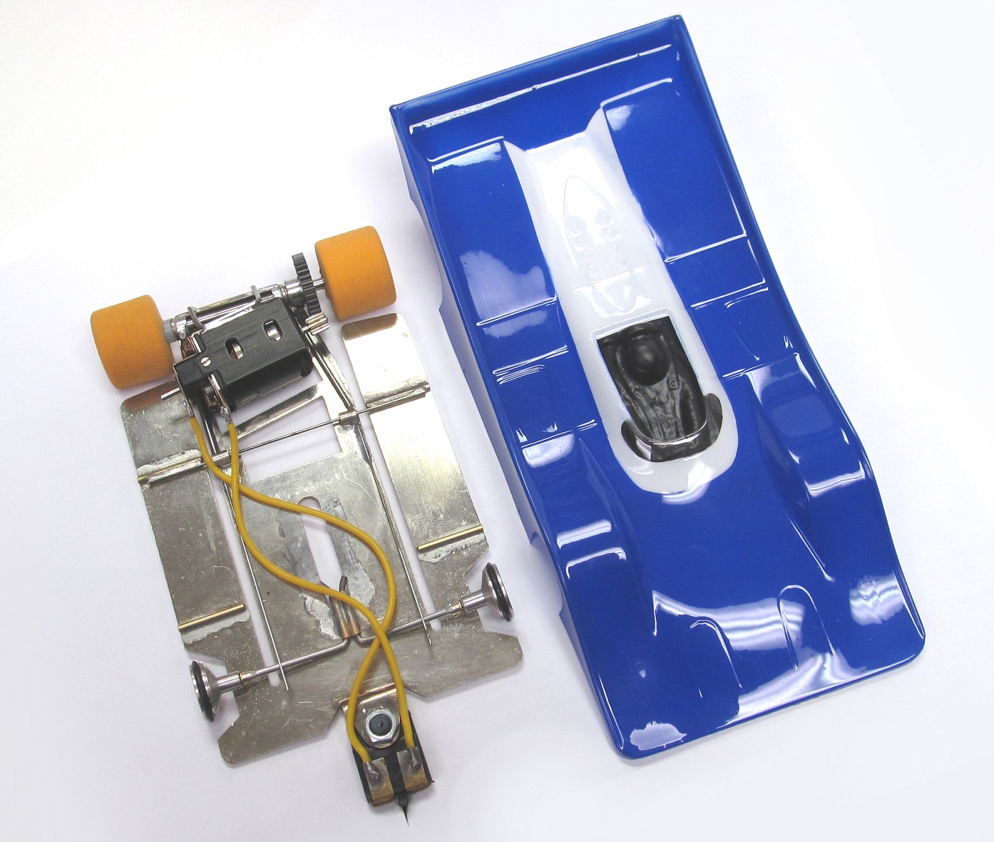

Okay Rick, I have blown up and examined the bodies in your advertisement. I believe the body you have is the third from the left.
The first and the fourth are the body I linked to.
As for which motor you want... just have John wind you a new 27 arm.
Watching updates with interest. :)

#9 dc-65x
  • 7,030 posts
Posted 27 December 2016 - 09:01 PM
Hi Jairus,
Yes, I believe it is the third body form the left in the ad also, especially when you look at the bottom of the body. It's painted in the same paint scheme, white rectangle around the drivers compartment.

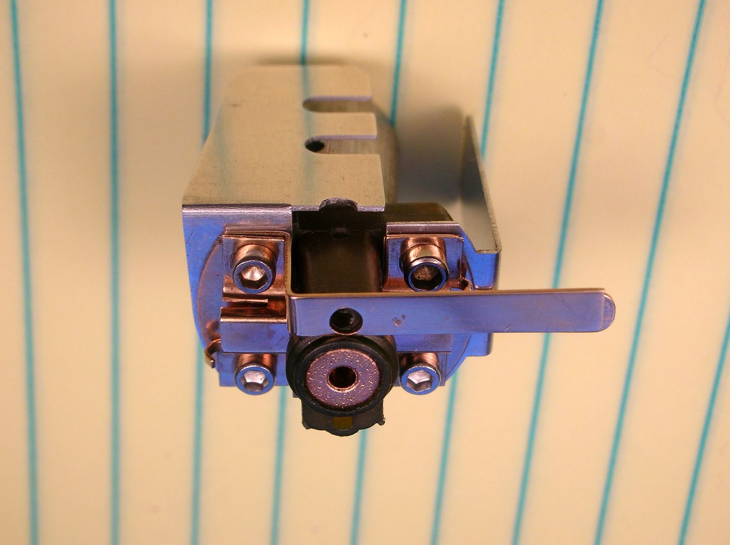

I found some heat sinks similar to the ones used on the G27 and G40 cars so I went ahead and restored the endbell using them:
Everything cleaned up nicely:

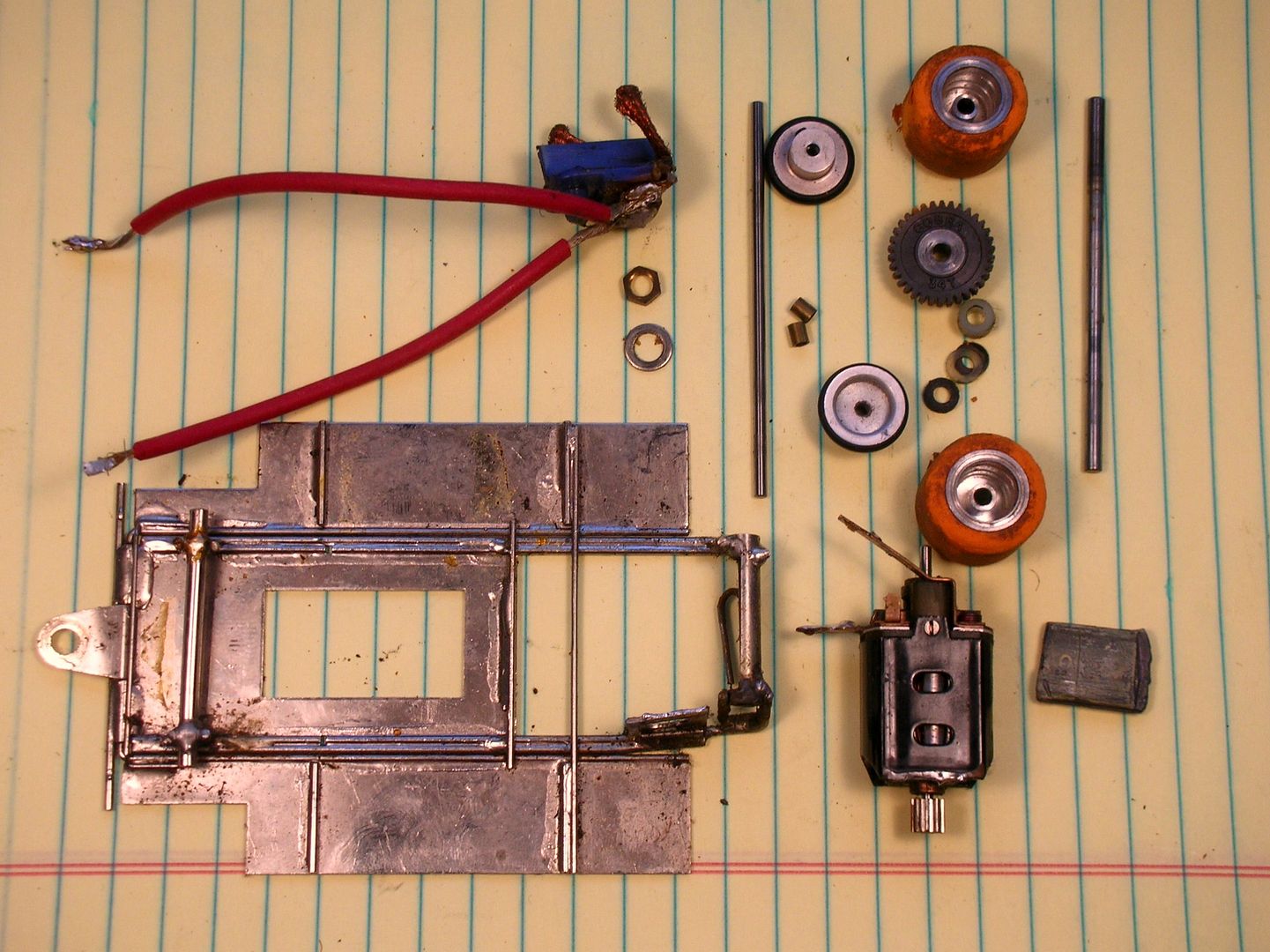

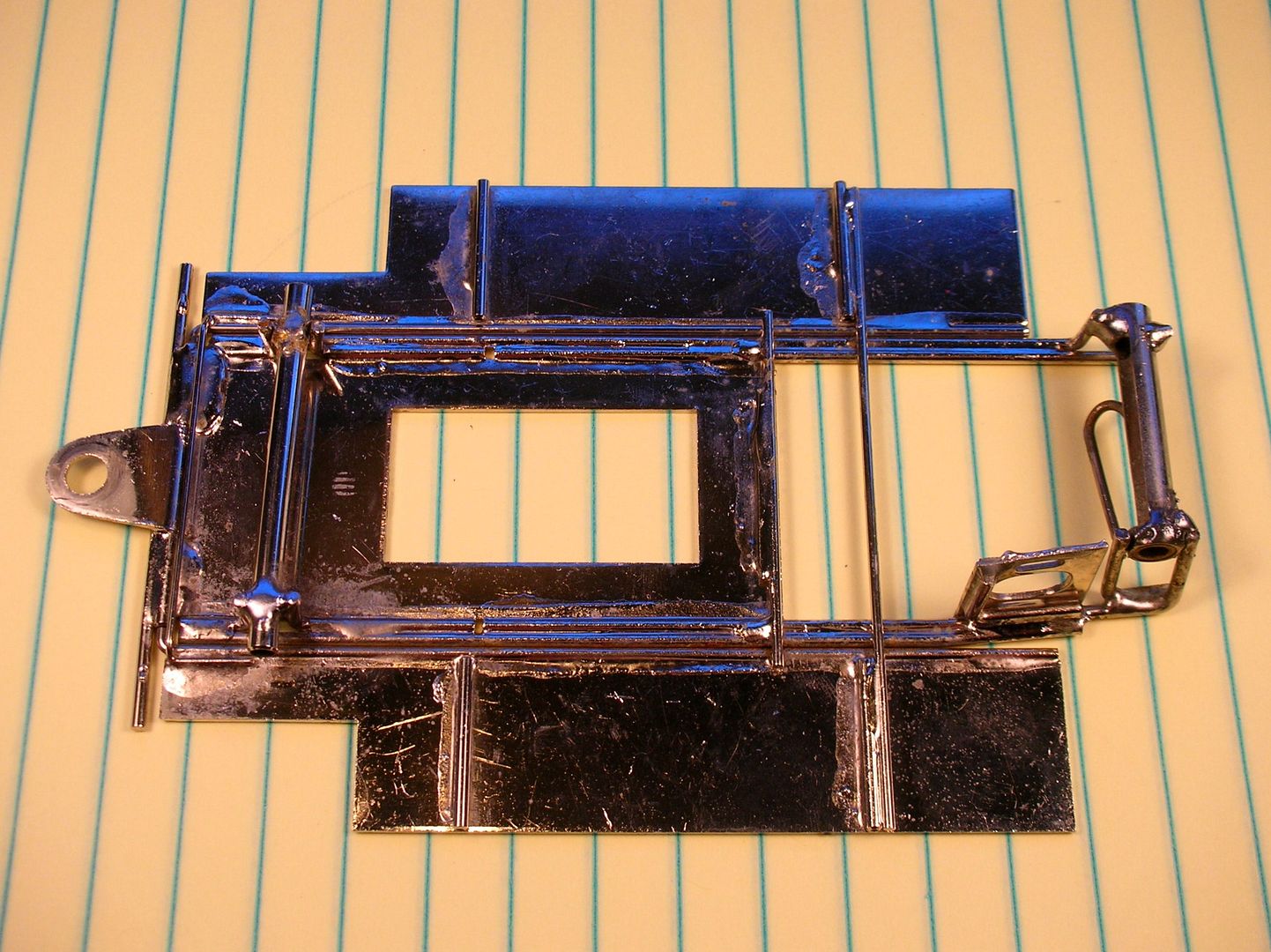

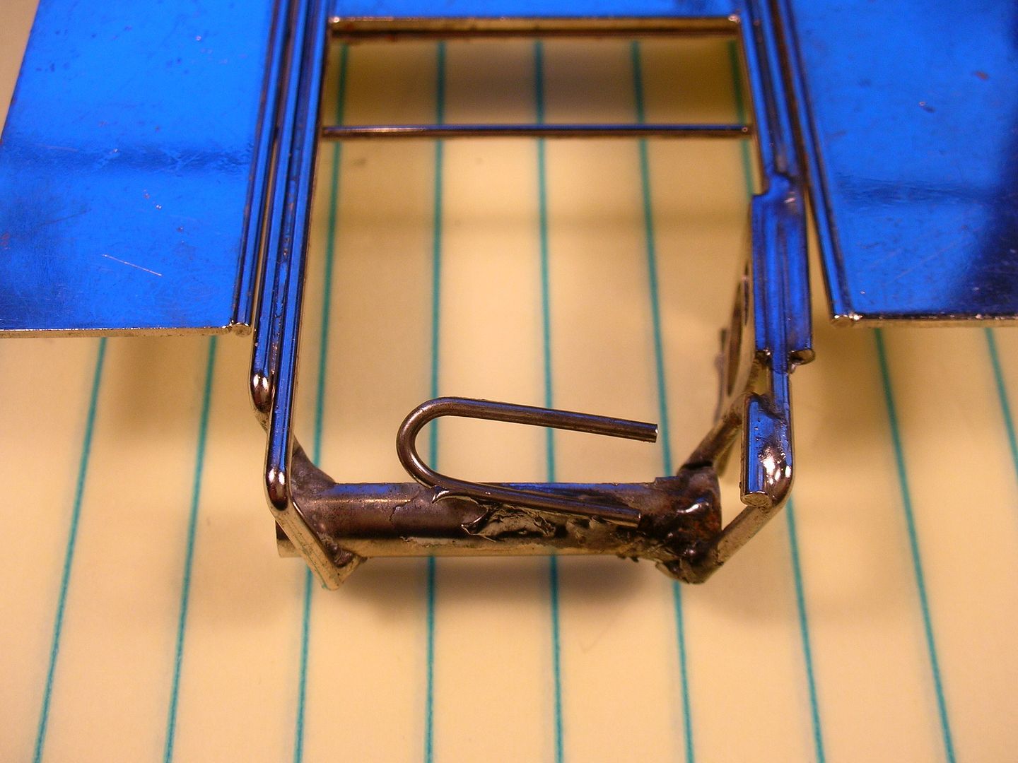

I've got the chassis squeeky clean and ready to go into the jig for repair. Both the front and rear axle tubes are broken loose on one side and all the solder joints have been user repaired... so to speak.  :o

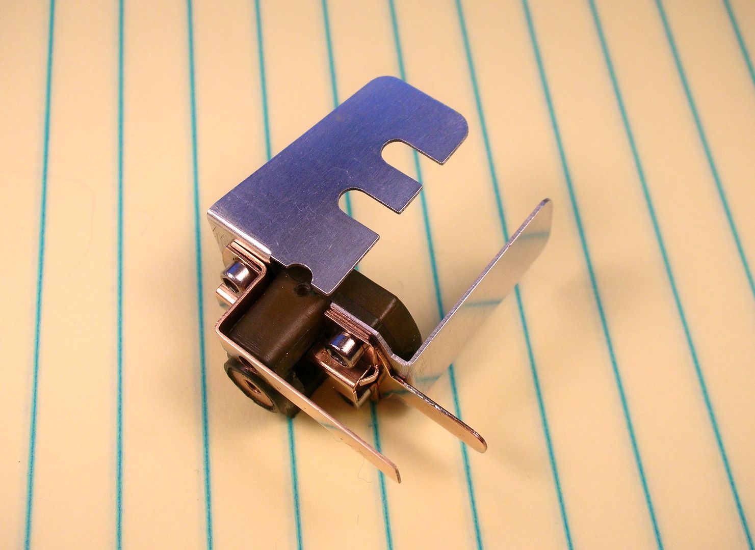

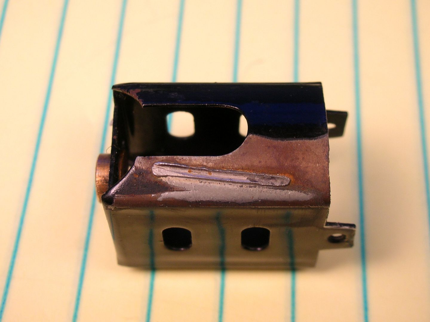

I'm guessing this motor brace could be factory since it seems to be an early Champion Arco magnet clip:
Here's where the motor can paint was removed prior to soldering it in. Maybe it was hit with a belt sander???

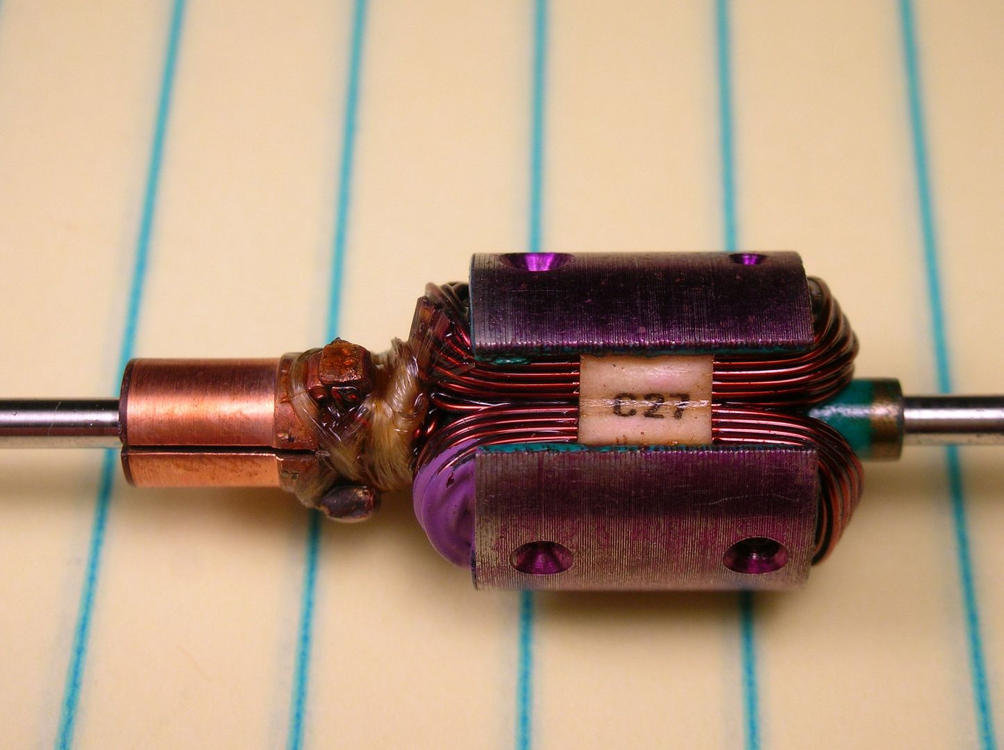

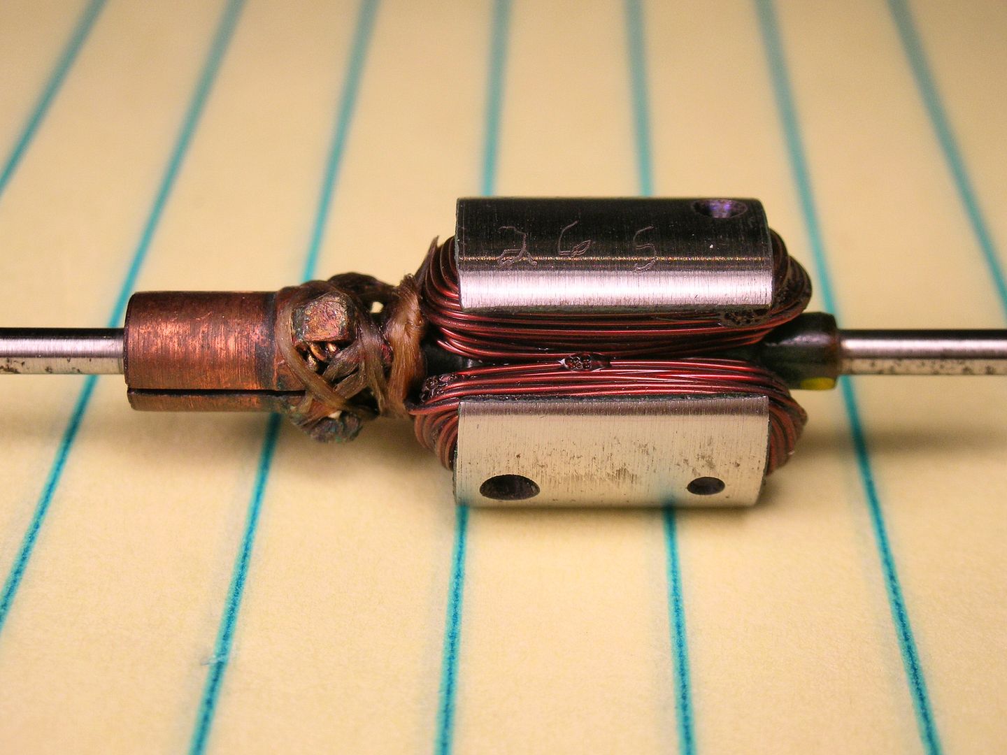

First is an absolutely lovely hand wound arm with what looks like a "C27" tag. Is it really a "G27" tag with the "C gone bad"? Anyone got any ideas?

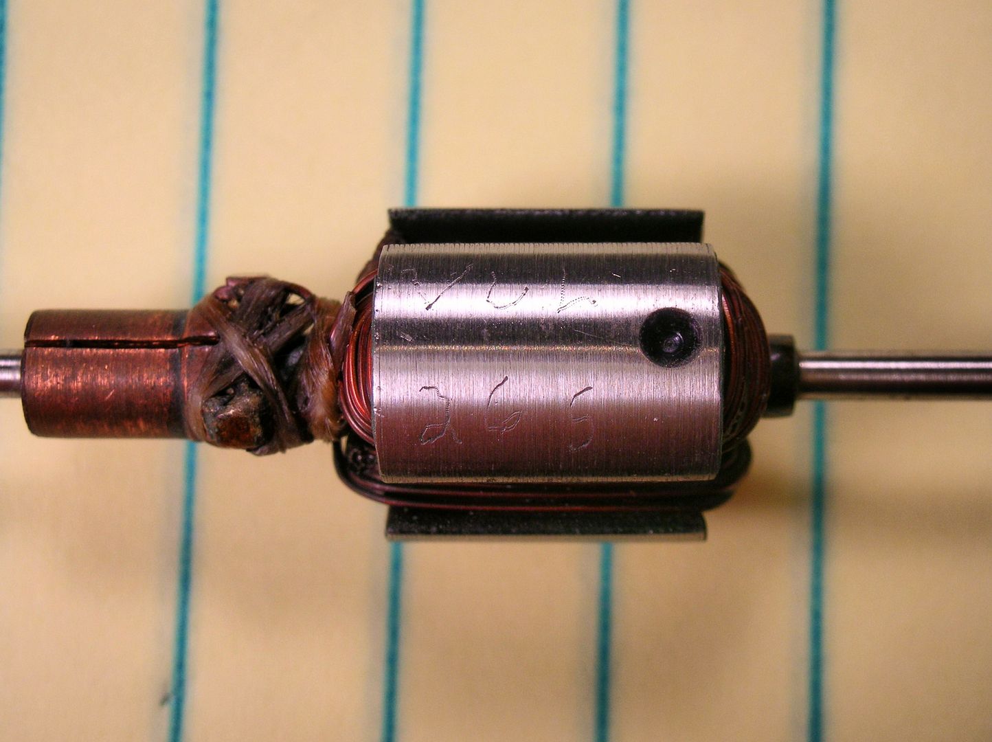

Next is an arm marked REHCO S26. The Champion catalog says the Group 40 car had a single 26 wire armature:

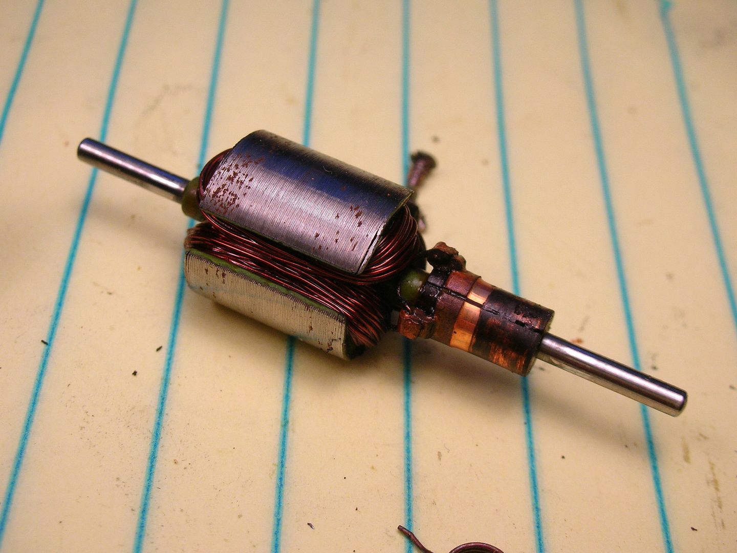

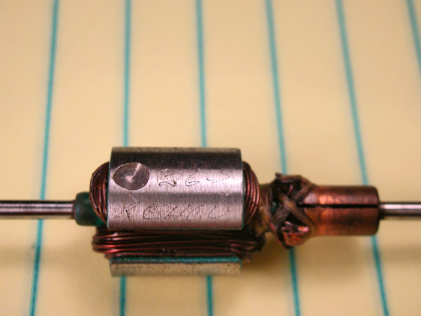

This one is marked VUL (Vulcan?) S26:
It might be hand wound too:
Any ideas?
  • Jencar17 likes this
#13 tonyp
tonyp
  • 15,325 posts
  • Joined: 12-February 07
Posted 28 December 2016 - 10:32 PM
Isn't a Vulcan a Lee Gilbert armature?
Anthony 'Tonyp' Przybylowicz
5/28/50-12/20/21
#14 Bill from NH
  • 14,894 posts
Posted 28 December 2016 - 10:45 PM
Rick,
That first arm has been balanced by Camen (purple paint on the comm end of the stack). C27 could mean Camen 27.
I thought Vulcan was a name Mura once used on their open class arms. I have a Vulcan 26 that I used to run on relatively short tracks, such as E. Hartford and Hampton Beach.
As I recall, the Vulcans weren't a hand-wound arm.

I do have one Vulcan #25. It's definitely hand-wound but not as neat as Steube and especially Camen (Pooch) arms.
