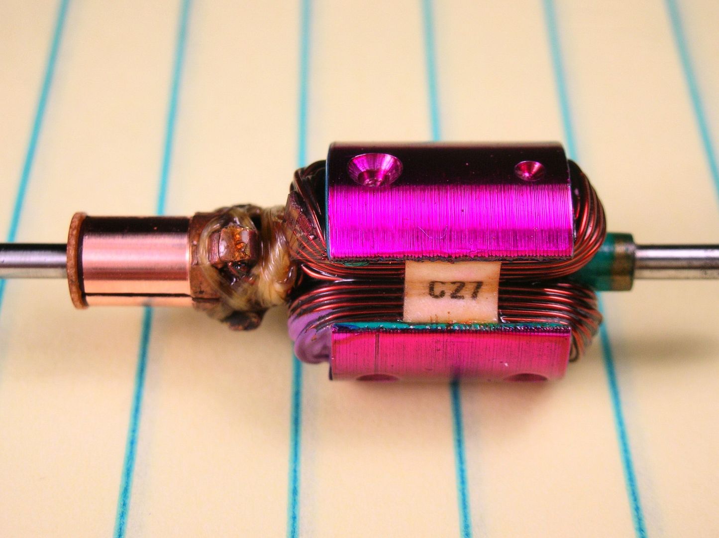

I reread the thread and one person seems to remember a tagged GP40 arm and another person remembers an arm with no tag but the stack engraved S26. So we seem to be back where we left off... :unknw:

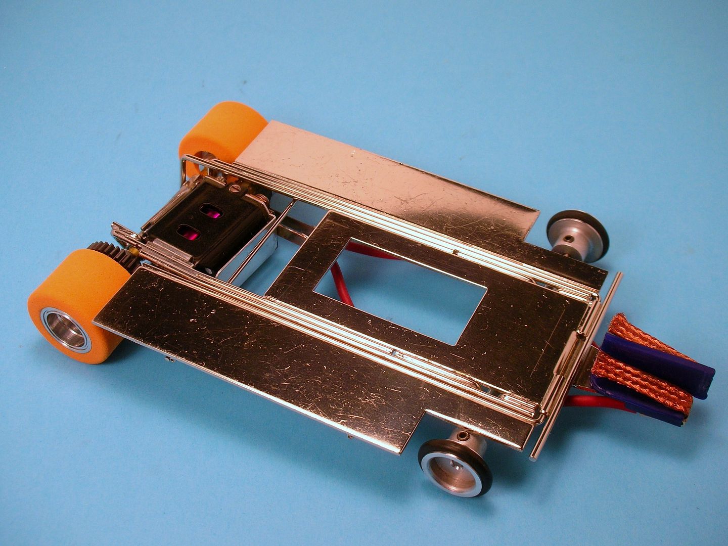

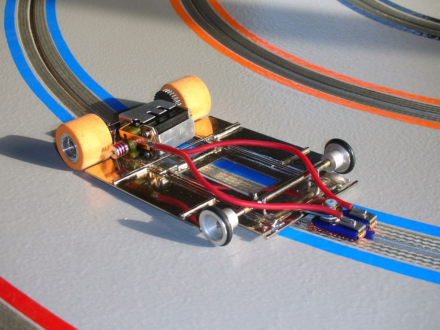

Here's the finished chassis. I lightened it up as much as possible:
Just kidding!  :crazy:

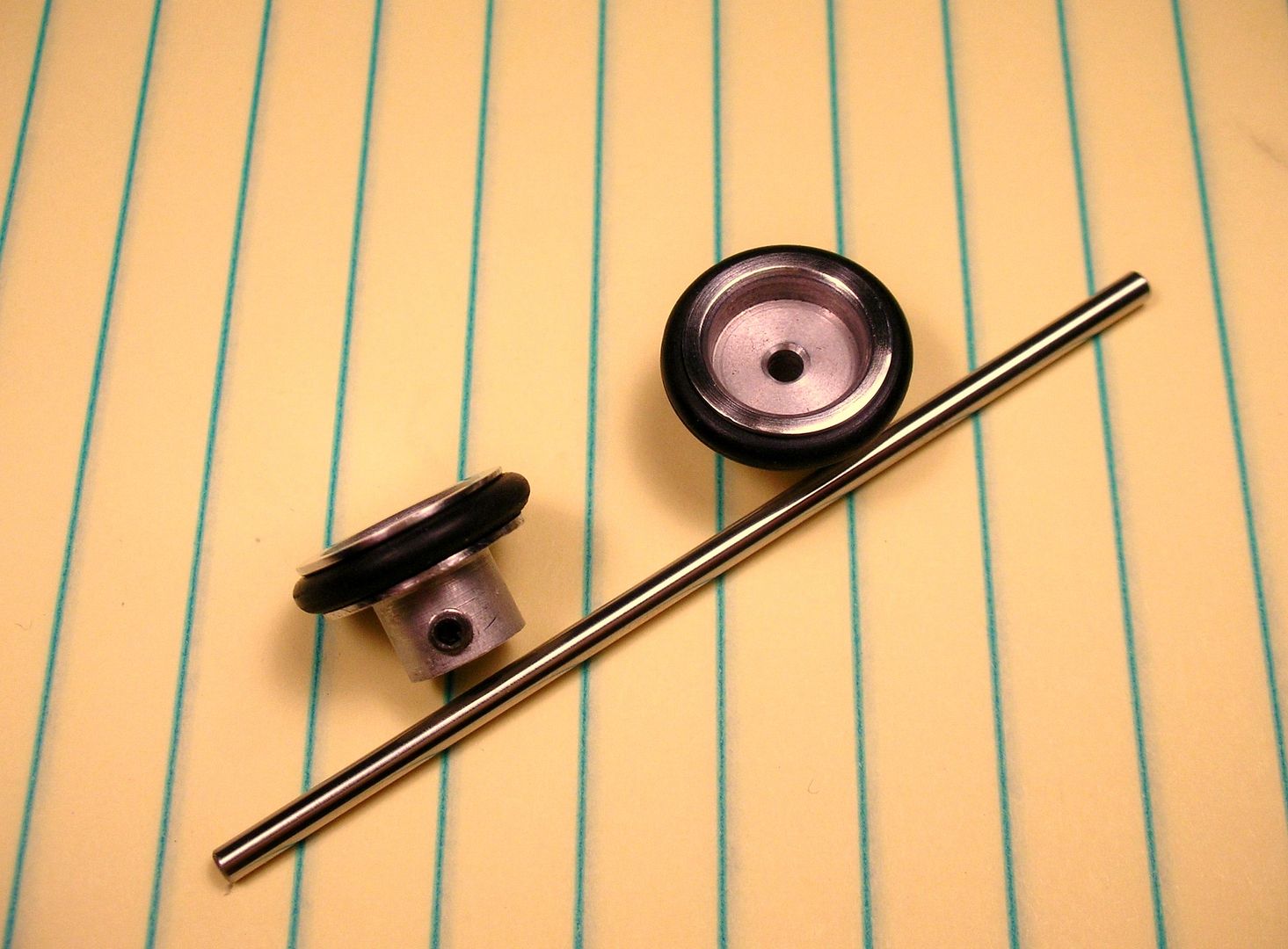

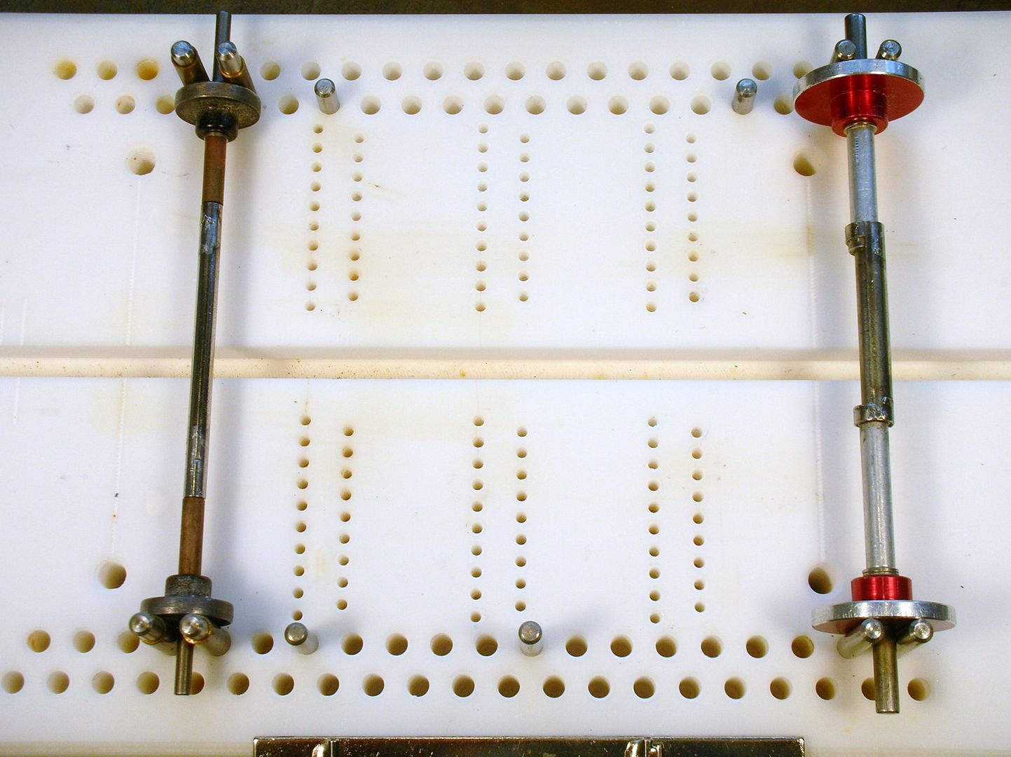

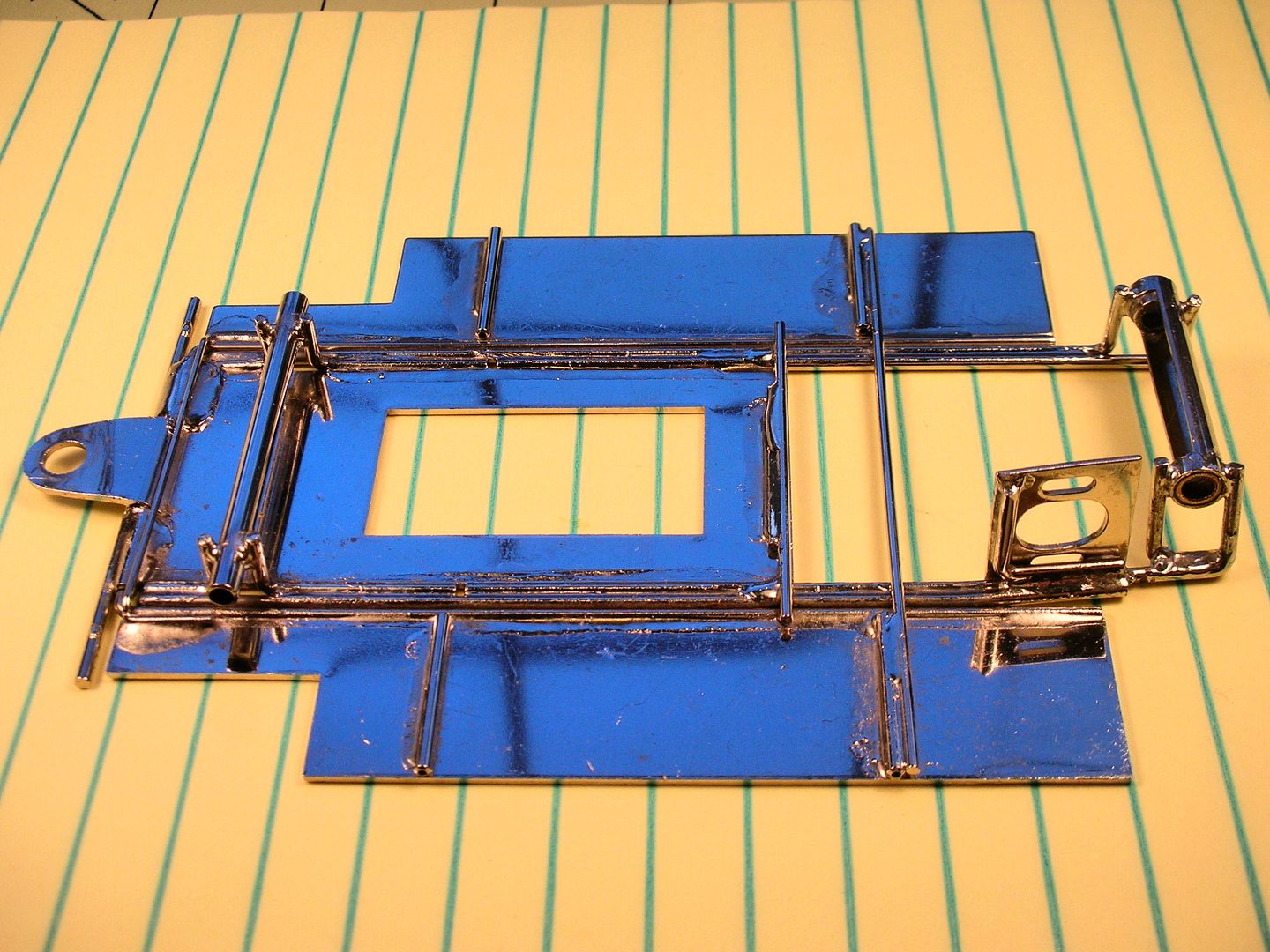

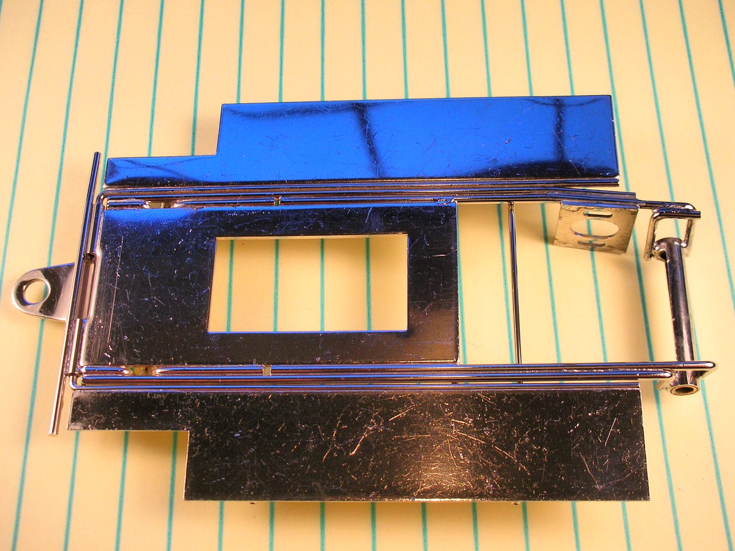

The chassis had user soldered and broken joints on the front and rear axle tubes and the front tube was bent so I removed and repaired the tubes as shown above.
Here's the repaired chassis. It's probably in better shape now than when it was new. It's nice and flat and squared up:

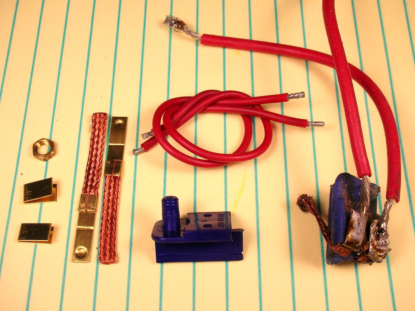

The original Jet flag and 220v high voltage cables are being replaced with the new old stock parts on the left:

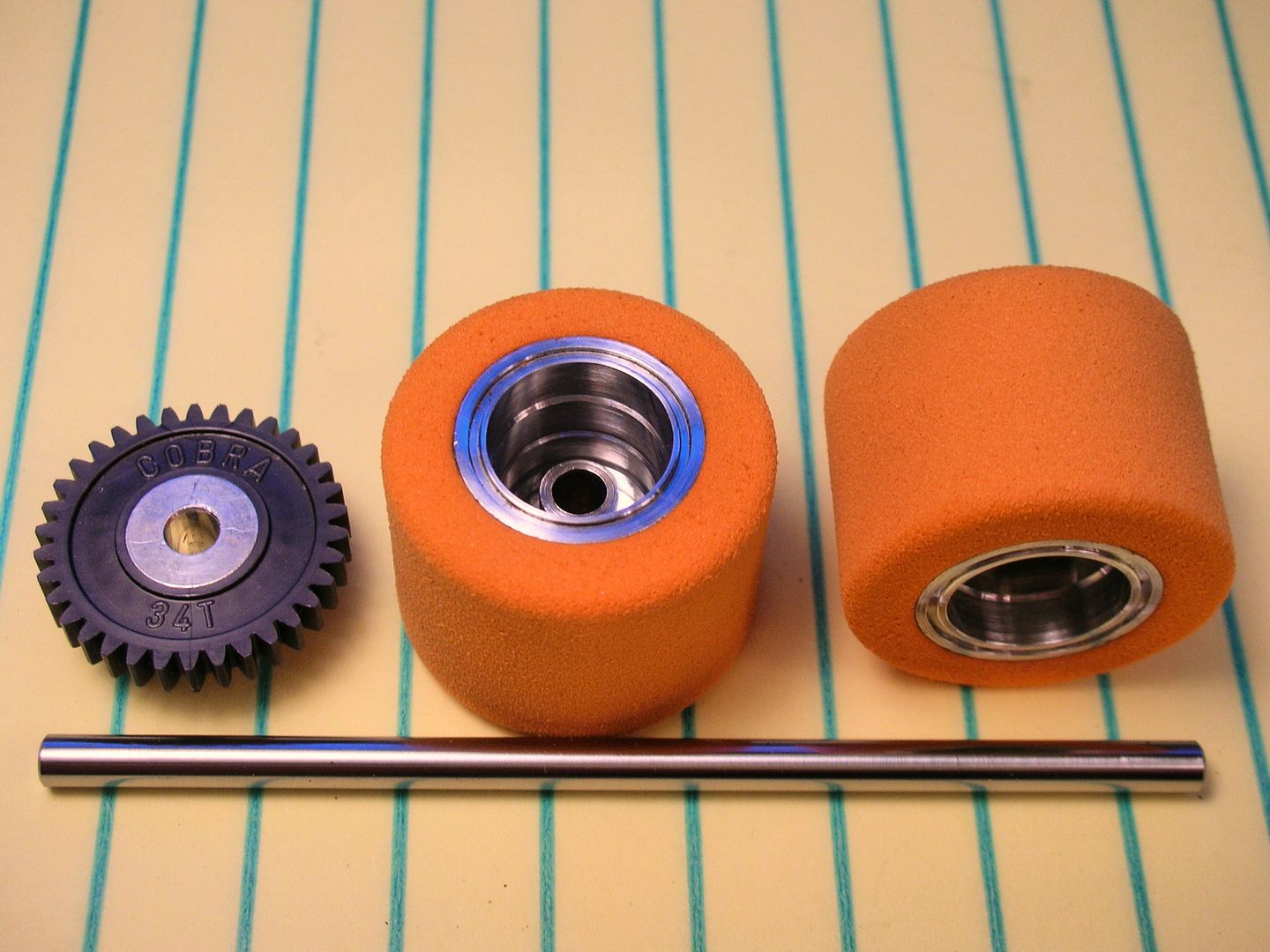

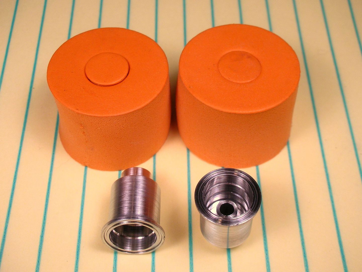

The original tires were toast but the wheels weren't bent so were cleaned up and new rubber rounded up:
Here they are with the fresh Riggen rubber mounted and ground. Also shown is a new gear to replace the original chewed up Cobra 34t and the polished-up original rear axle:
The factory bead blasted front wheels got the rims polished to bling them up a bit:
So, now I have to decide what arm to stuff in my set-up...

Rick, are the chassis mainrails two .063" piano wire? That's what they look like in the photos.
#29 dc-65x
  • 7,055 posts
Posted 31 December 2016 - 11:42 PM
They sure are, Bill... good eye!

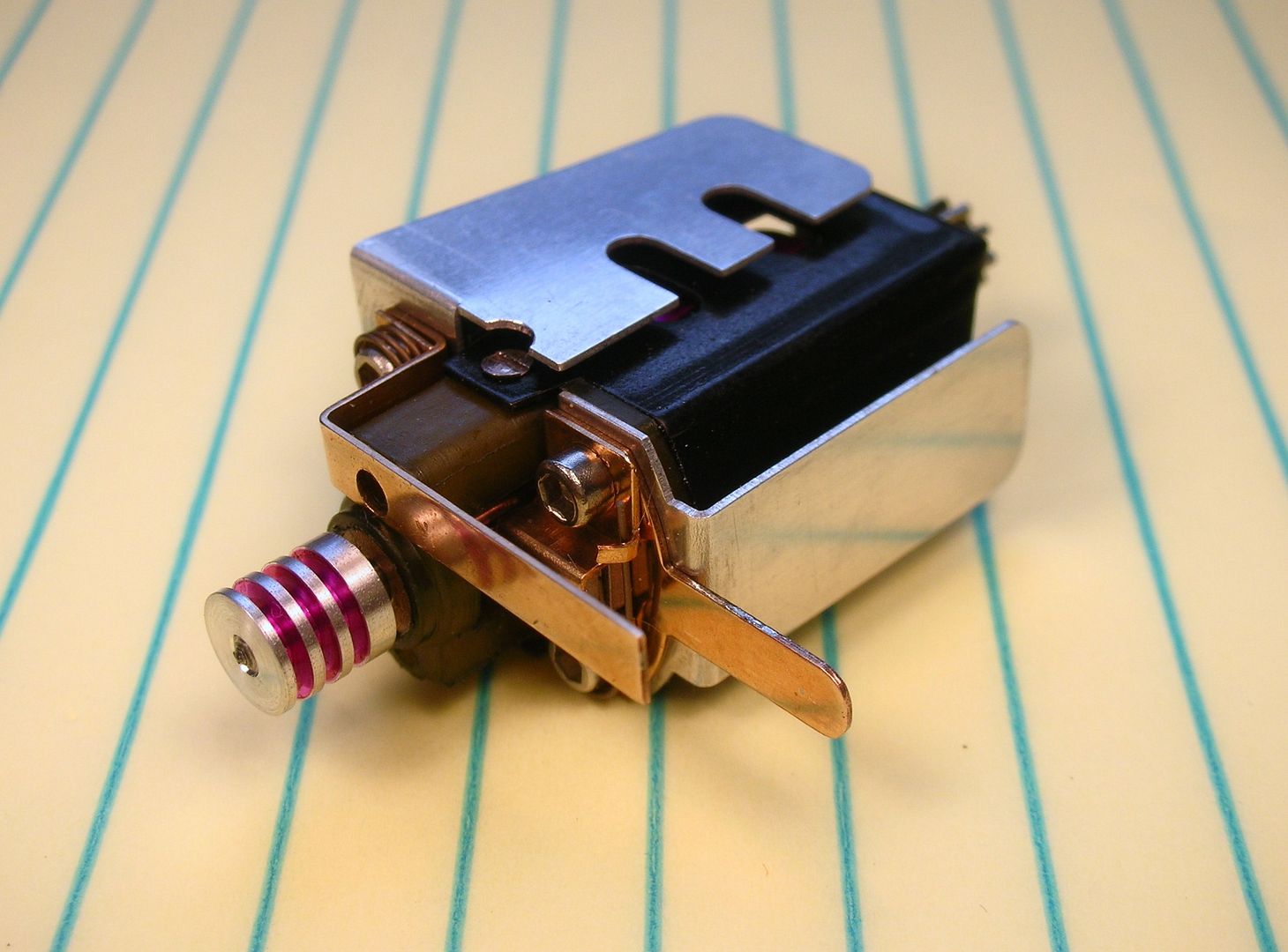

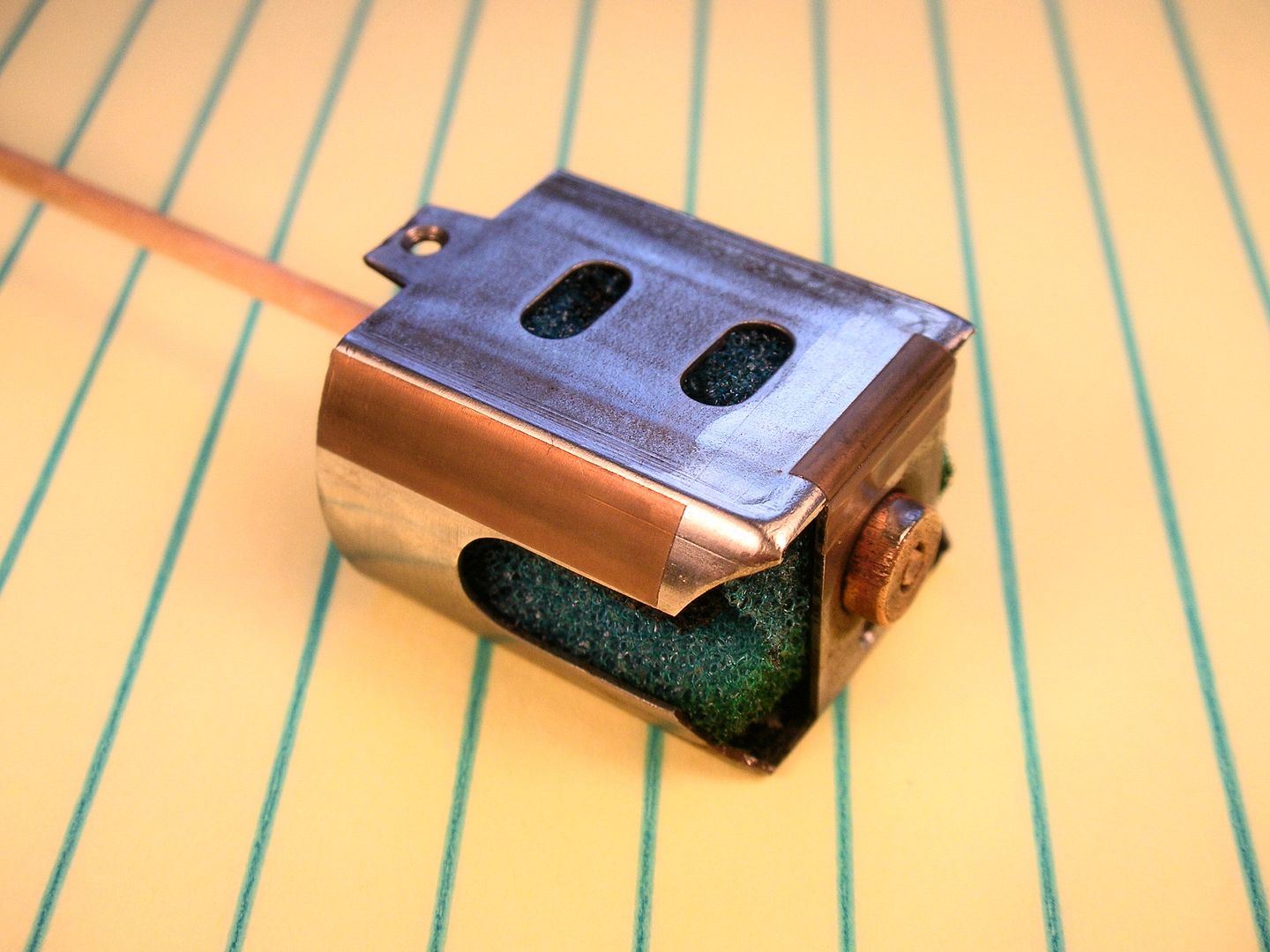

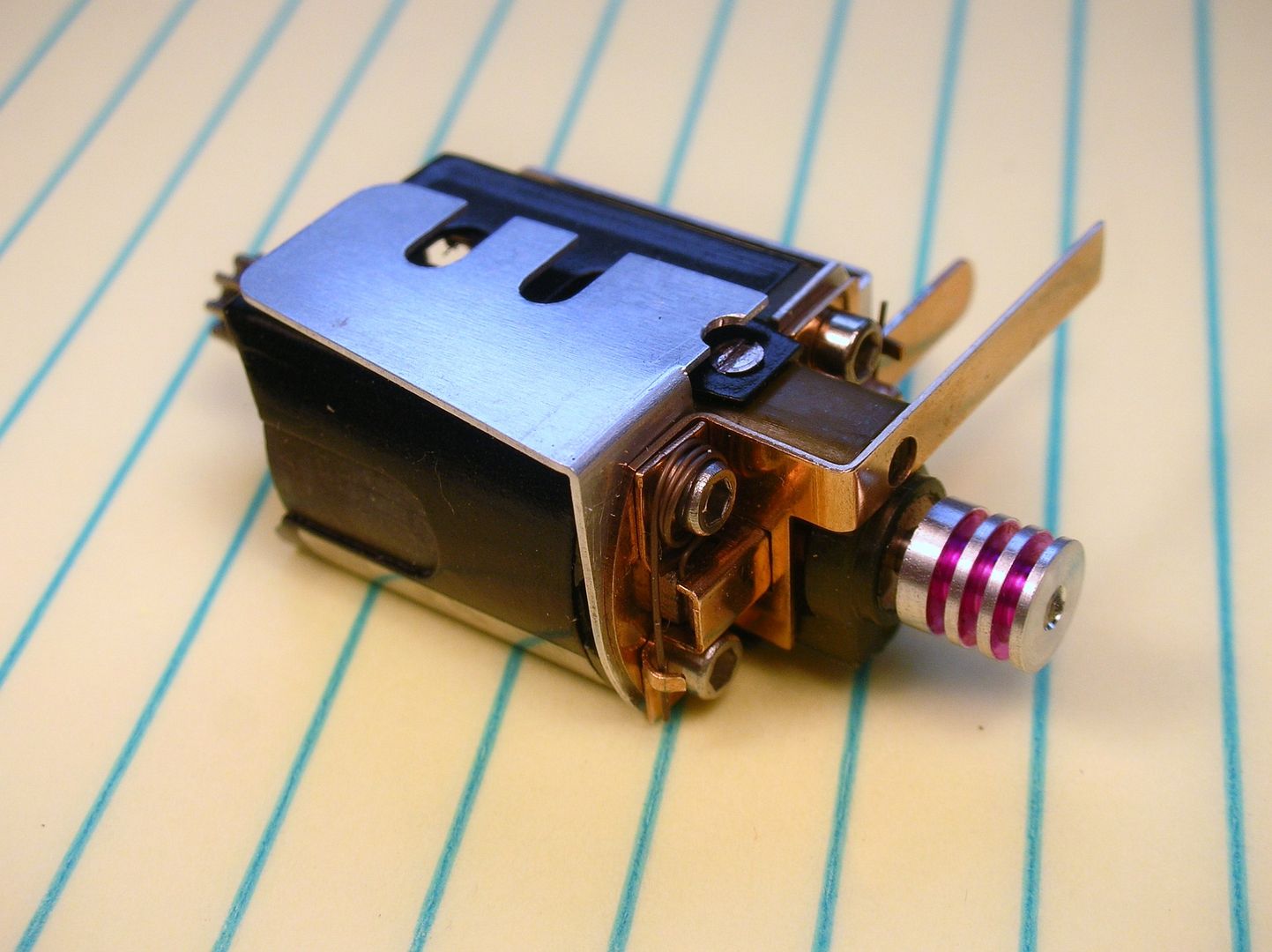

The CEE can's paint was stripped and the areas to be soldered during motor installation tinned with solder and masked for painting:

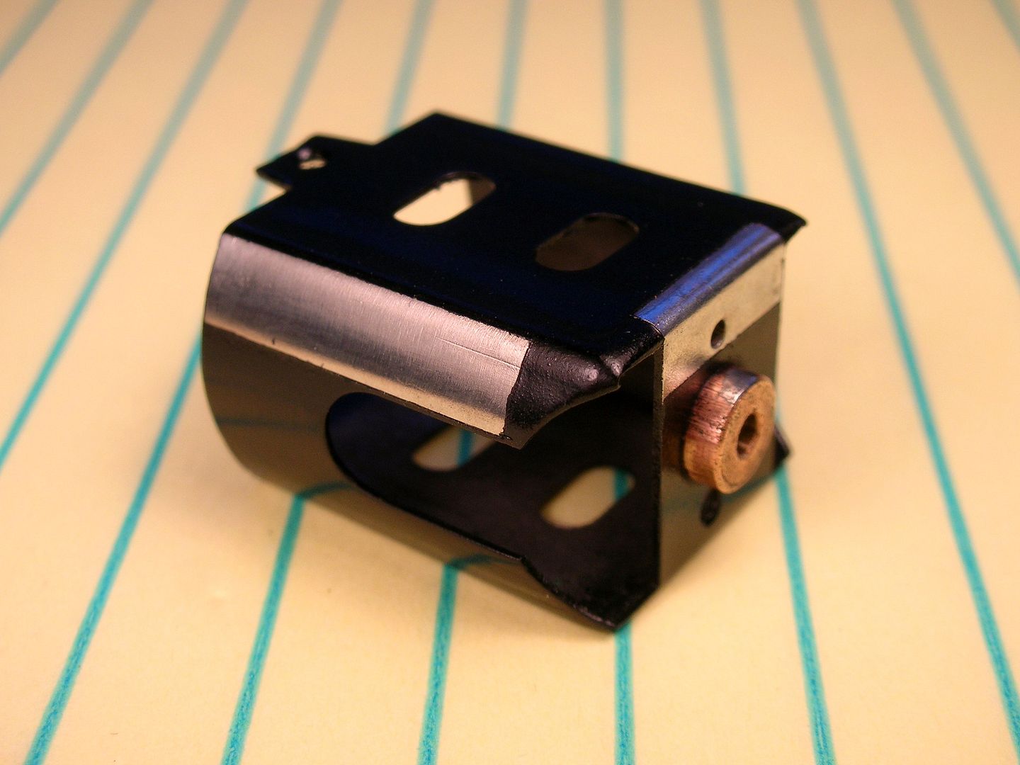

The finished can with a few coats of Krylon semi-gloss black:
I decided to use the GP27 arm since my factory box is marked for a GP27.

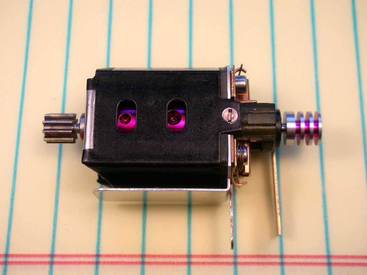

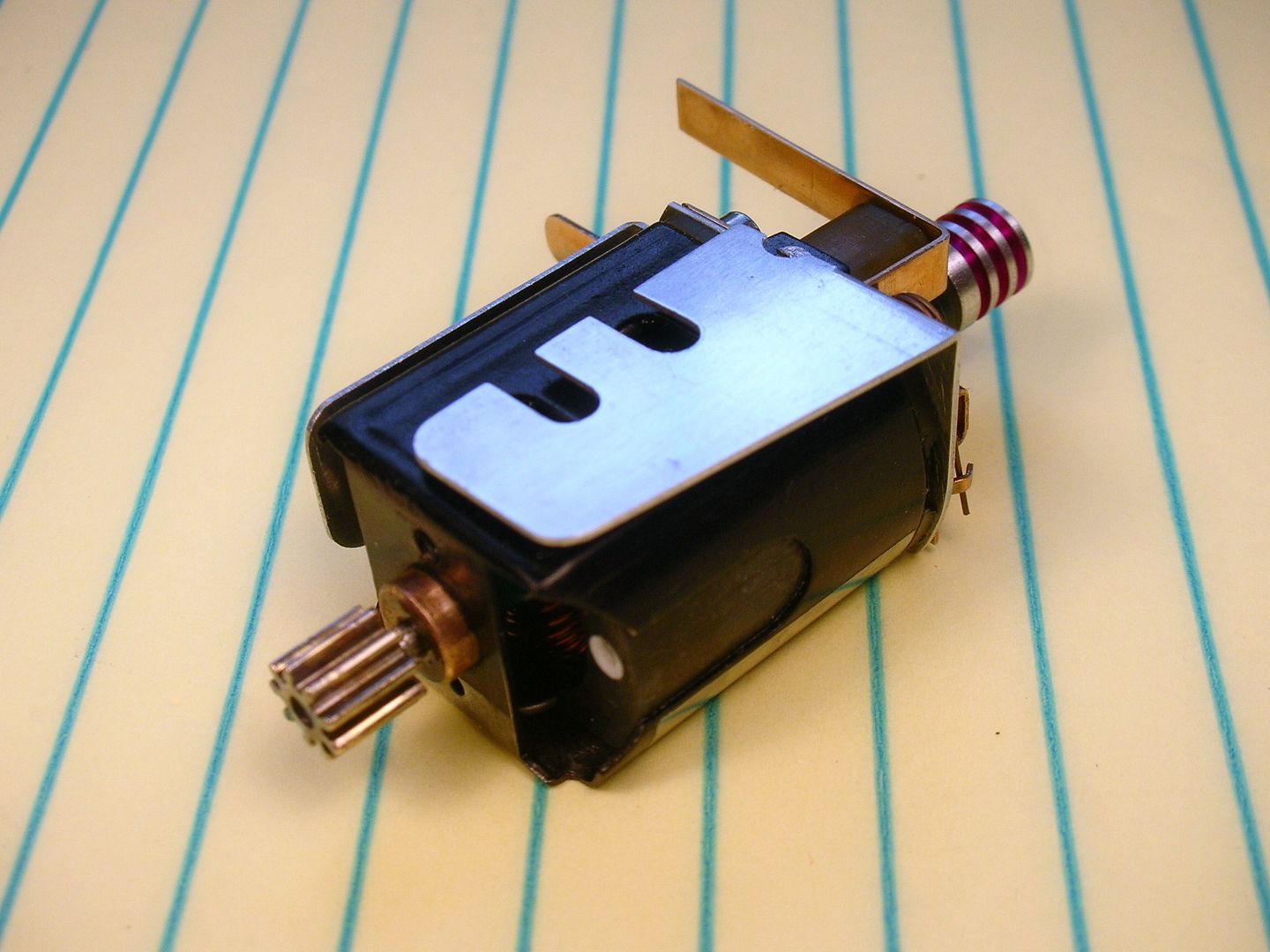

Here is the lovely Camen hand would GP27 arm I showed earlier. I gave it a light comm trim and a fresh coat of Camen purple arm dye:
The finished motor:
I installed a comm cooler because I think they look cool. It can easily be removed if a future owner doesn't like it:
The Champion White Dot magnets and factory 9t pinion were reused:
I love the way a purple-dyed arm looks in a black setup :crazy:

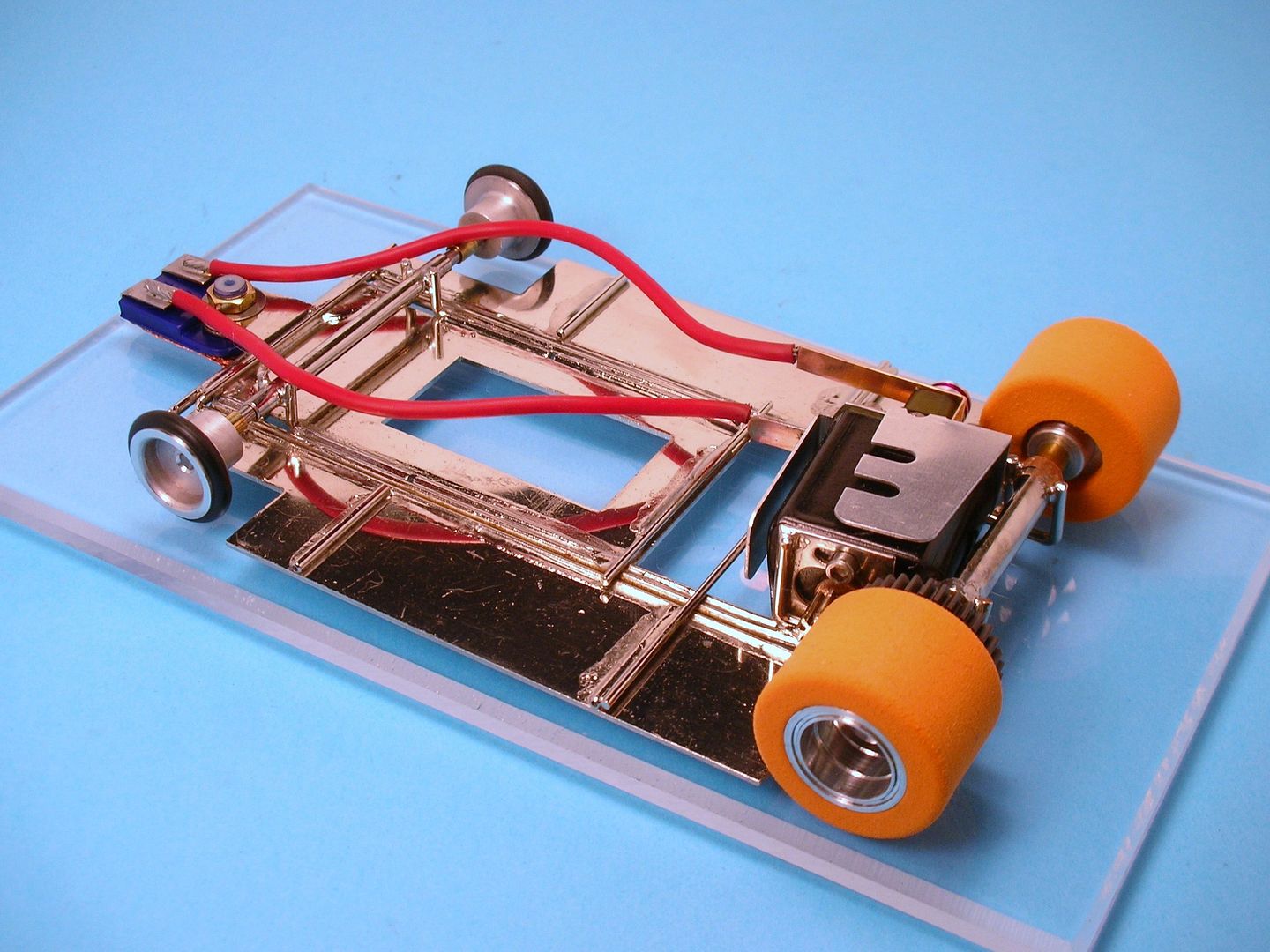

Time to put all the pieces into one lump and get it on the track...

I just saw this post and I believe I can be of some help.
The armature with the C27 tag is a Mura Cheetah Grp 27.
This armature is a Champion Grp 27.
This armature is a Camen Grp 27.

Phil, thanks for the armature pictures. Mine looks like it could be a Mura-Bob Green handwound arm. Whatever it is I think it's a nice upgrade for the Bandito.
Thanks again.

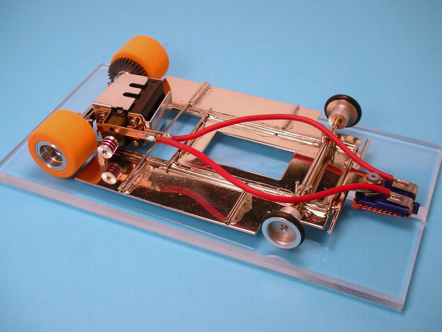

The roller is finished and has seen a little track time, too:
Another look at where it started:
And all freshened up:
Something really cool is being worked on for this cars body. Stay tuned!  :)

#36 dc-65x
  • 7,055 posts
Posted 05 January 2017 - 10:15 PM
It's handles a little loose mainly because of the orange tires along with my very lightly glued track. I'd love to see it on a clean and freshly spray-glued blue King. :dance3:

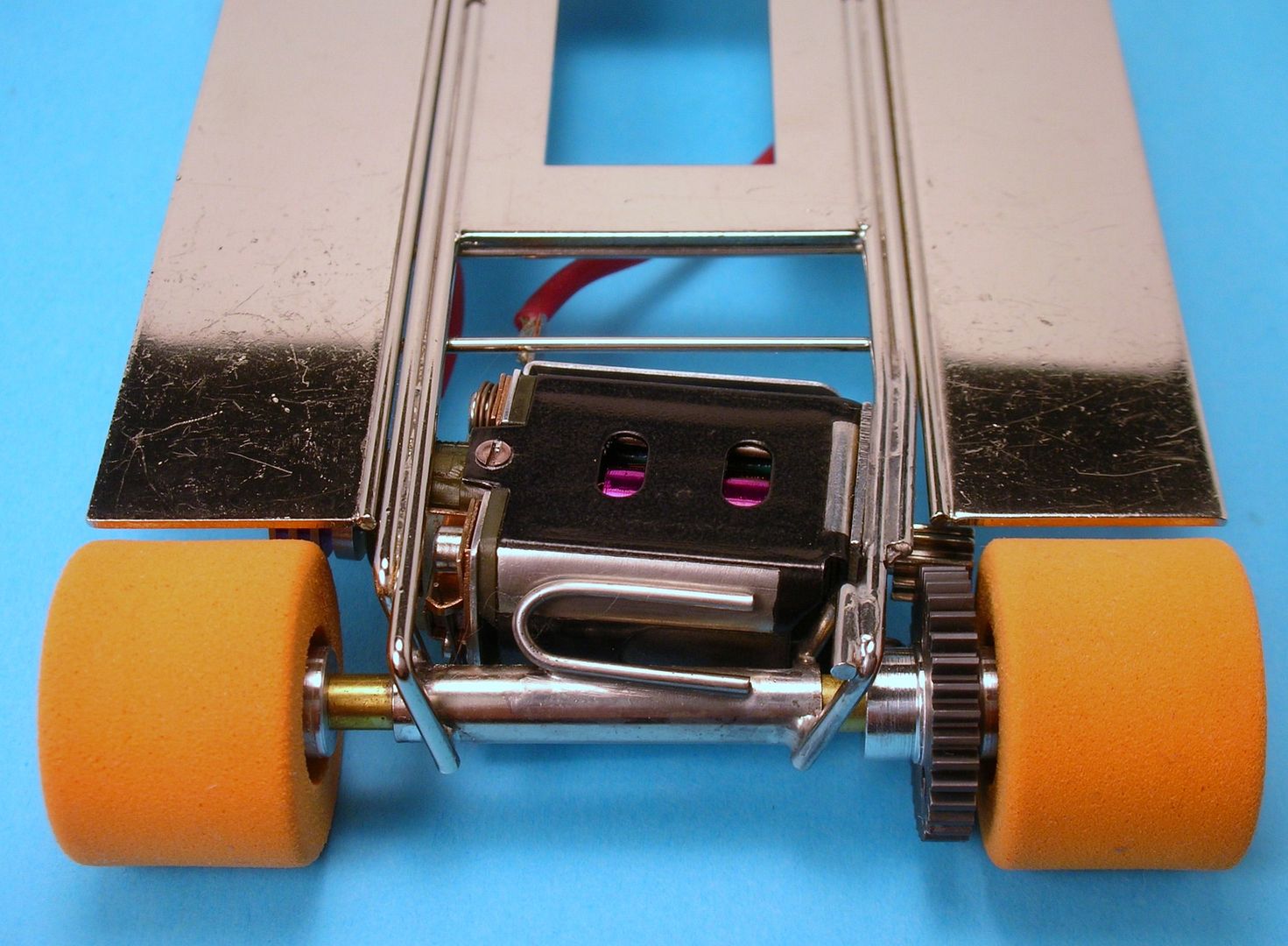

My favorite visual parts are the purple arm/comm cooler dye and the low CG curved brace.  :heart:

Sorry to be late (again!) to the party, but THIS is the arm you have. It's definitely a Mura.
Nice restoration! :good:
