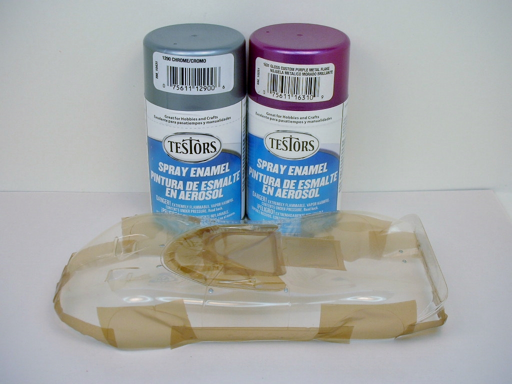

The color Testors offers that's closest to the Honker's color is Flake Purple Metallic and I'm backing that with Chrome Gloss:

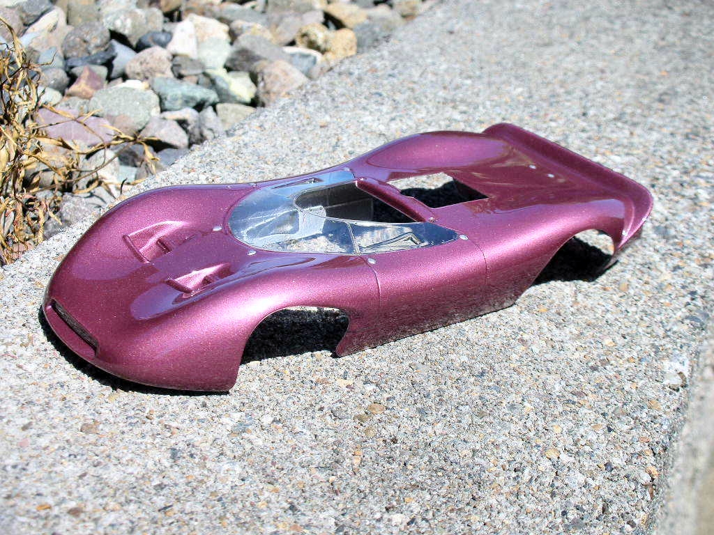

The body ready to go all masked off with my favorite Teflon tape. It's transparency, when holding the body up to the light, helps to see how the paint is covering:
I had to take the picture outside in the sunlight to get the real color. Everything I tried indoors made the picture turn out with either a dark purple or reddish purple tint:
It's obviously not an exact match but it's definitely in the "spirit" of the original color and most importantly, I really like it:   :D

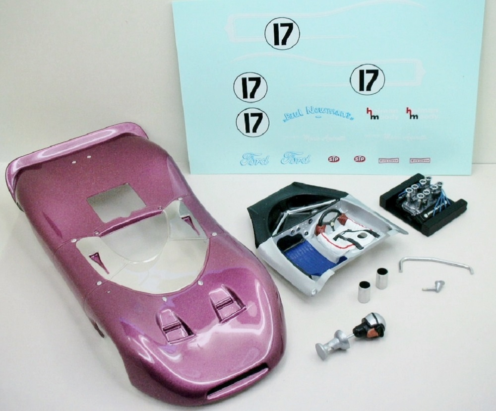

The pieces to assemble the finished body:
Everything is detail painted as best I could. My "shaky paint brushes" were especially active this time leading to lots of back and forth touchups...........but it's done:

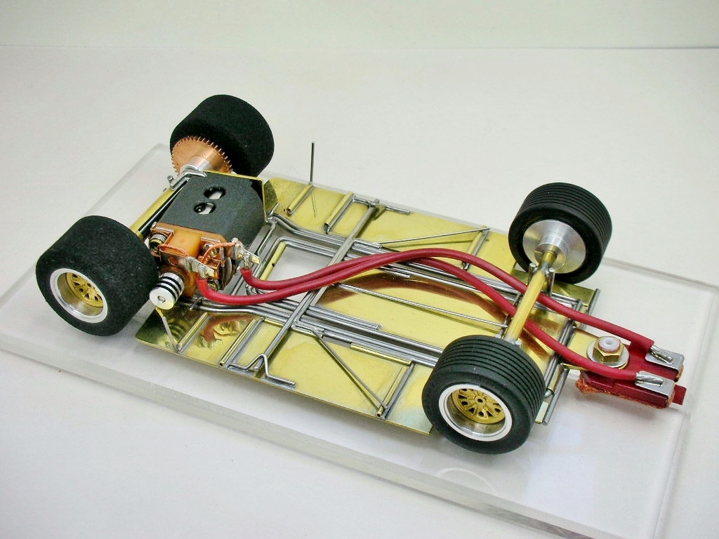

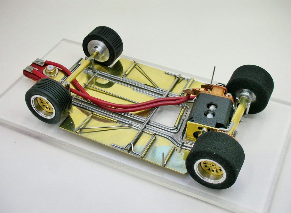

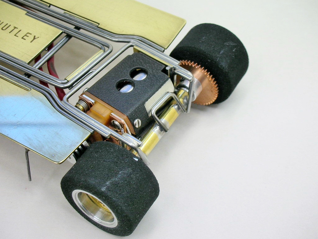

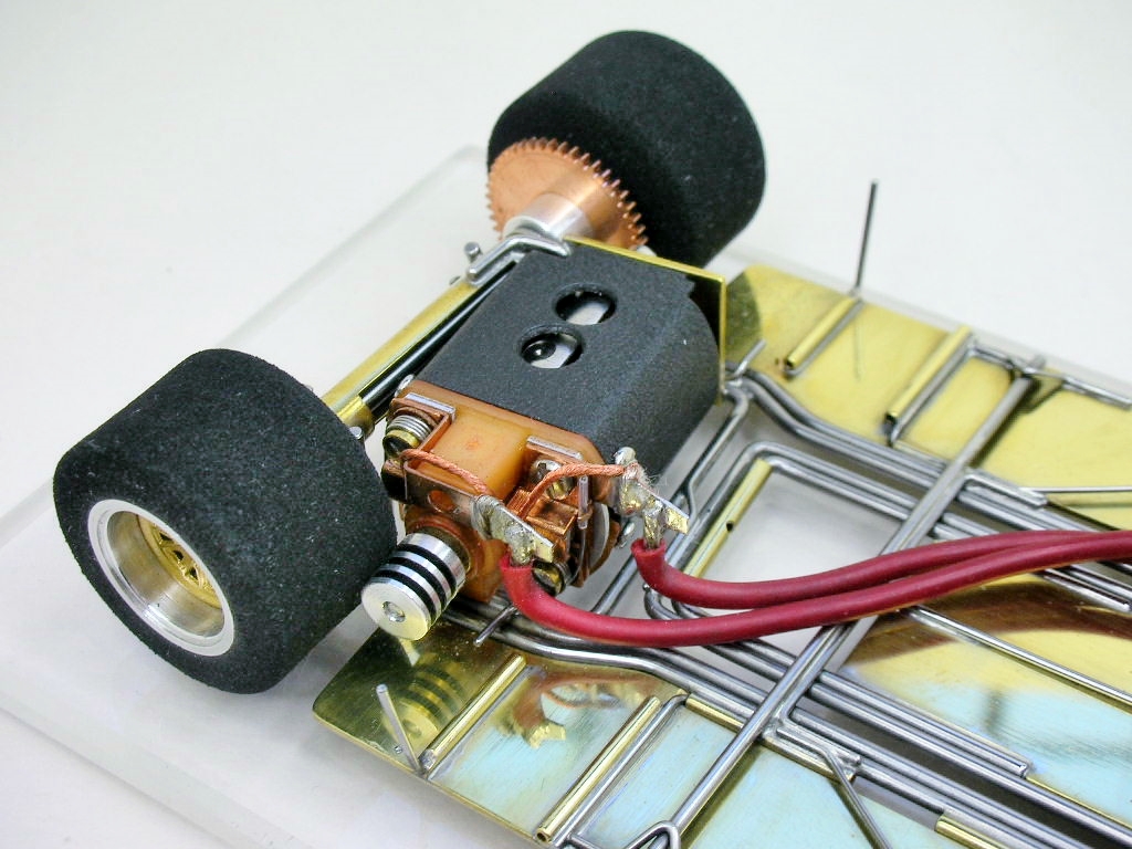

The roller is finished up with Champion lead wires and JET flag:
Fass 45T spur and Sonic 9T pinion gears:

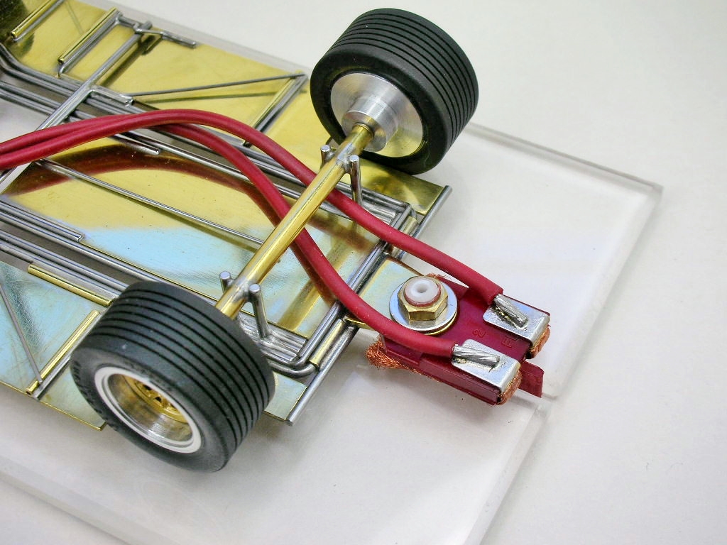

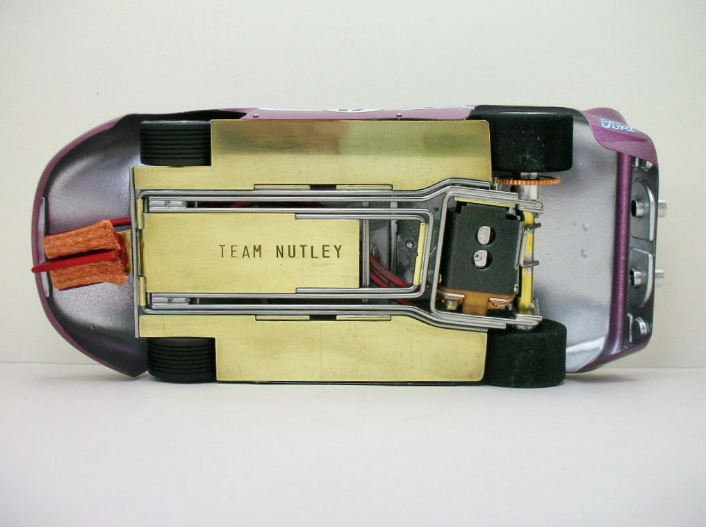

A brace was added so I can solder the motor in place if it (hopefully) runs well after track testing:

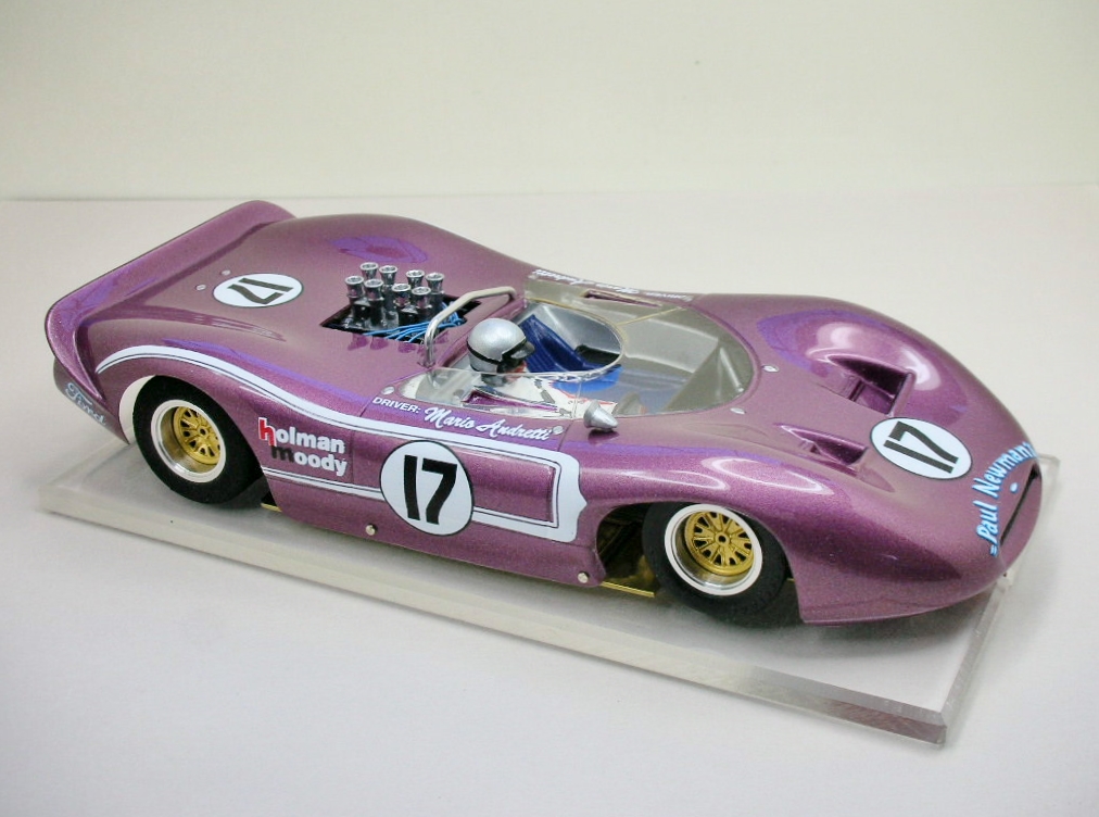

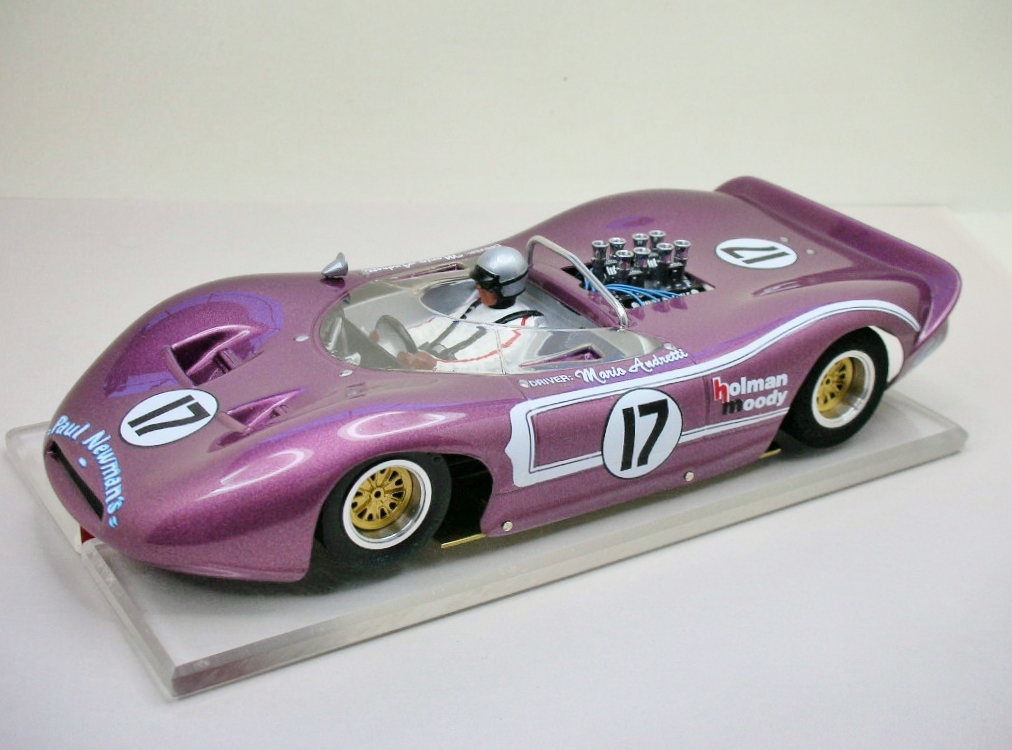

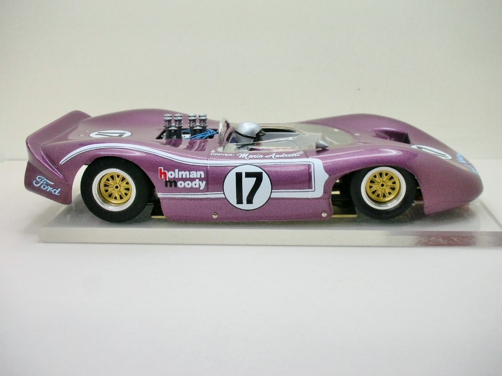

The finished beast:

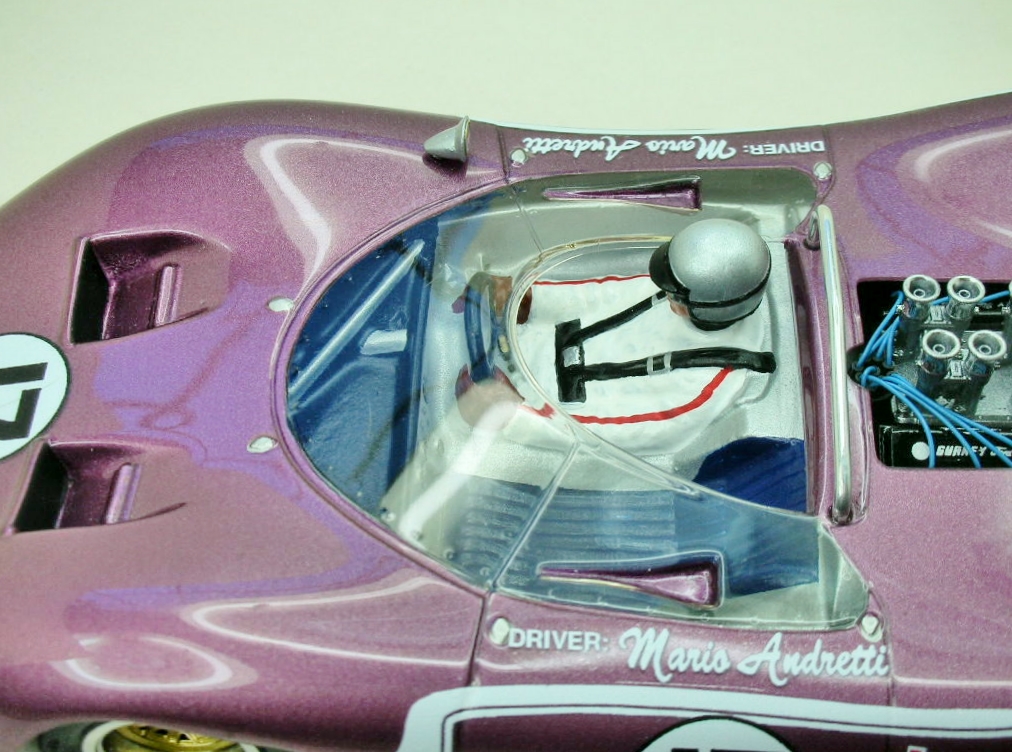

Mario hard at work in the car:

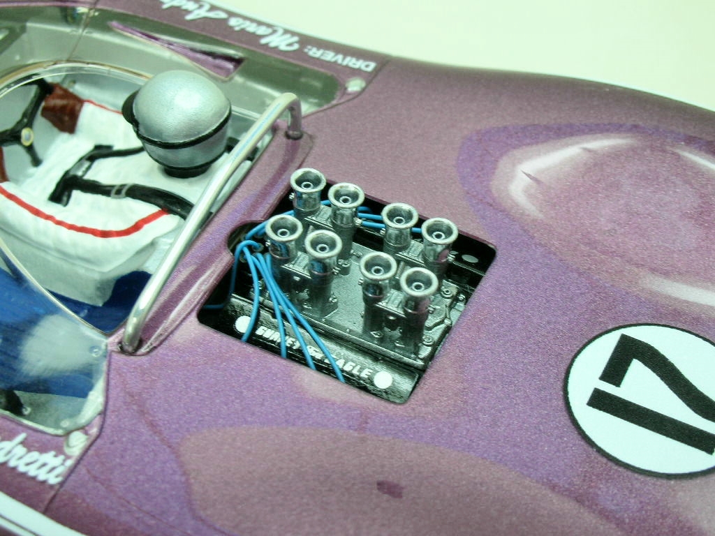

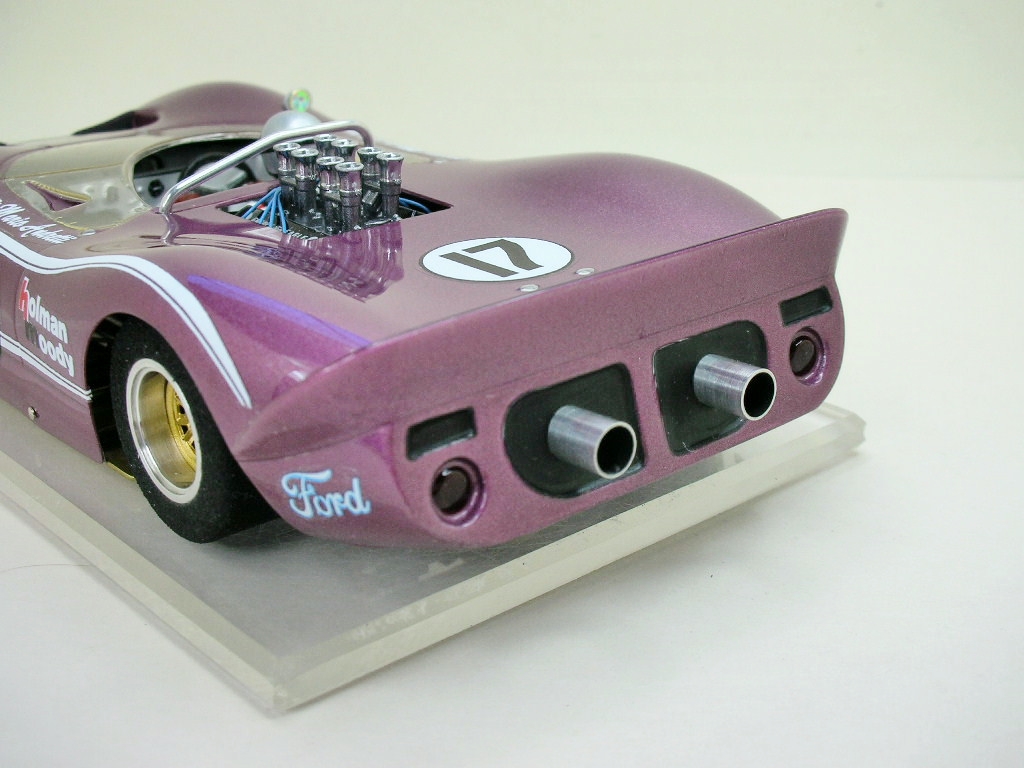

The 377ci ford engine with Gurney-Weslake heads:
The Honker's giant "honk'n" pipes:
A 2 7/8" wide "Pro" type car:

That engine detail is stupendous!!! Including the auxiliary venturis in the Webers is far beyond slot car level. That is model contest stuff.

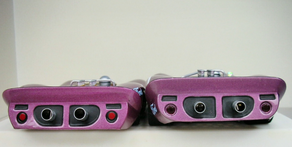

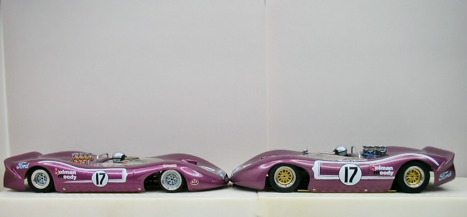

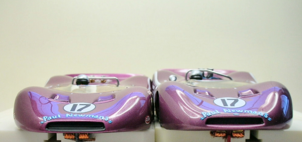

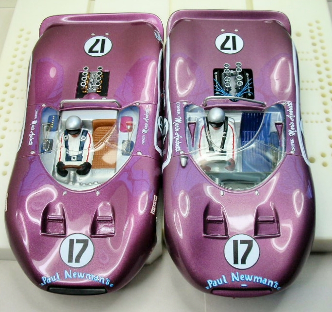

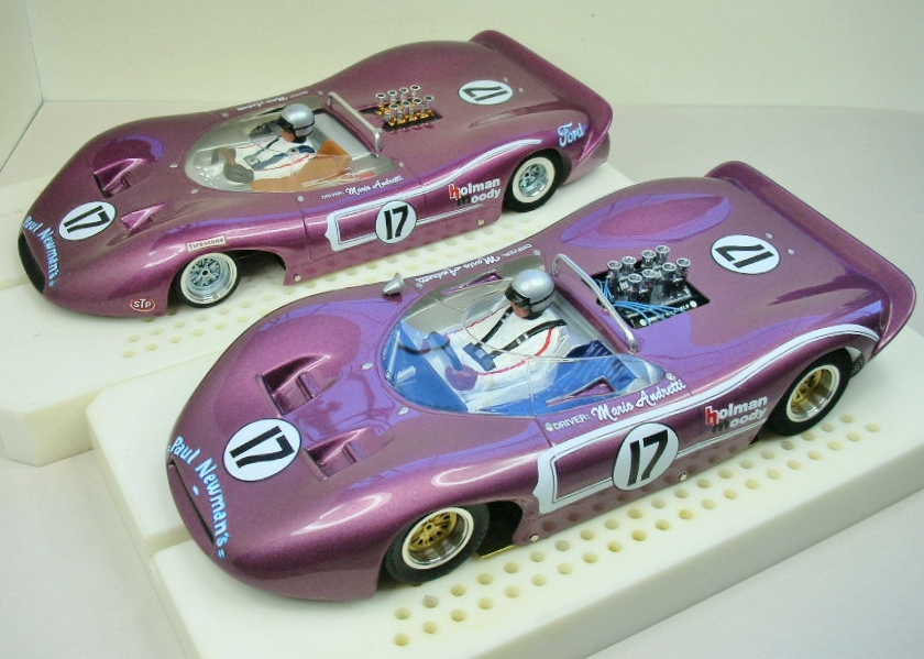

Here's the comparison between the "low and wide" handling body version on the left and the scale version on the right. It really highlights how "squashed down" the handling body is:
A honk'n pair of Honkers   :D

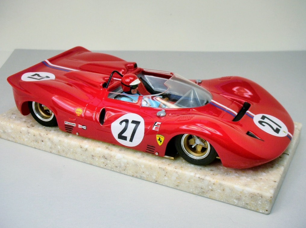

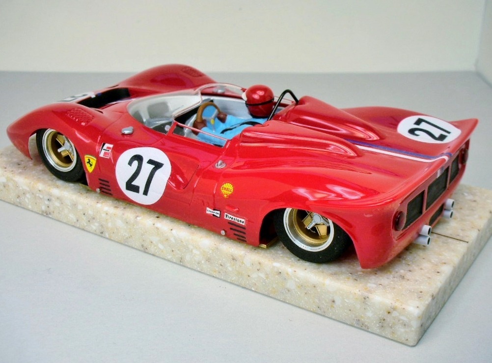

I built a tribute to the Jose Rodriguez Jr. NAMRA Ferrari P4 with the Lancer Super Competition body Mark:
NAMRA - Jose Rodriguez Jr. inspired Ferrari P4 Can-Am build
Simon, I have the Lancer scale McLaren M6 body and I've started building the Matich that I got from my friend Rodney. Unfortunately that project is on hold while I deal with a flareup of lower back pain.   :o
I'm still on the lookout for the scale Lancer lightweight Ferrari P4 and Chaparral 2G.   :dance3:
