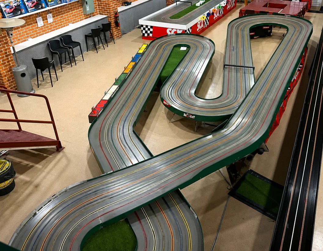

Posted 15 July 2026 - 07:16 PM
Hi,
I am not sure the name of the track but it is the one pictured in the attached image. if someone knows the name of it that would be great to know also for future reference.
The stock gearing that came with my car was 12/36, was changed to 11/36 when the pinion spun (edit i see you were referring to the OP)
I currently have 11/39 on it, yet to drive it will be giving it a go this Saturday.

#12 Dave_12
Dave_12
  • 155 posts
  • Joined: 06-June 24
  • Location:Sydney, Australia
Posted 15 July 2026 - 09:15 PM
Damian 6,500kv is way too much for that small track at Penrith . I have tried with a 9 tooth pinion   GTP body even then way way too much for that track.
4,500kv with a GTP body is just controllable on that track at Penrith.
  • Wannabe80 likes this
