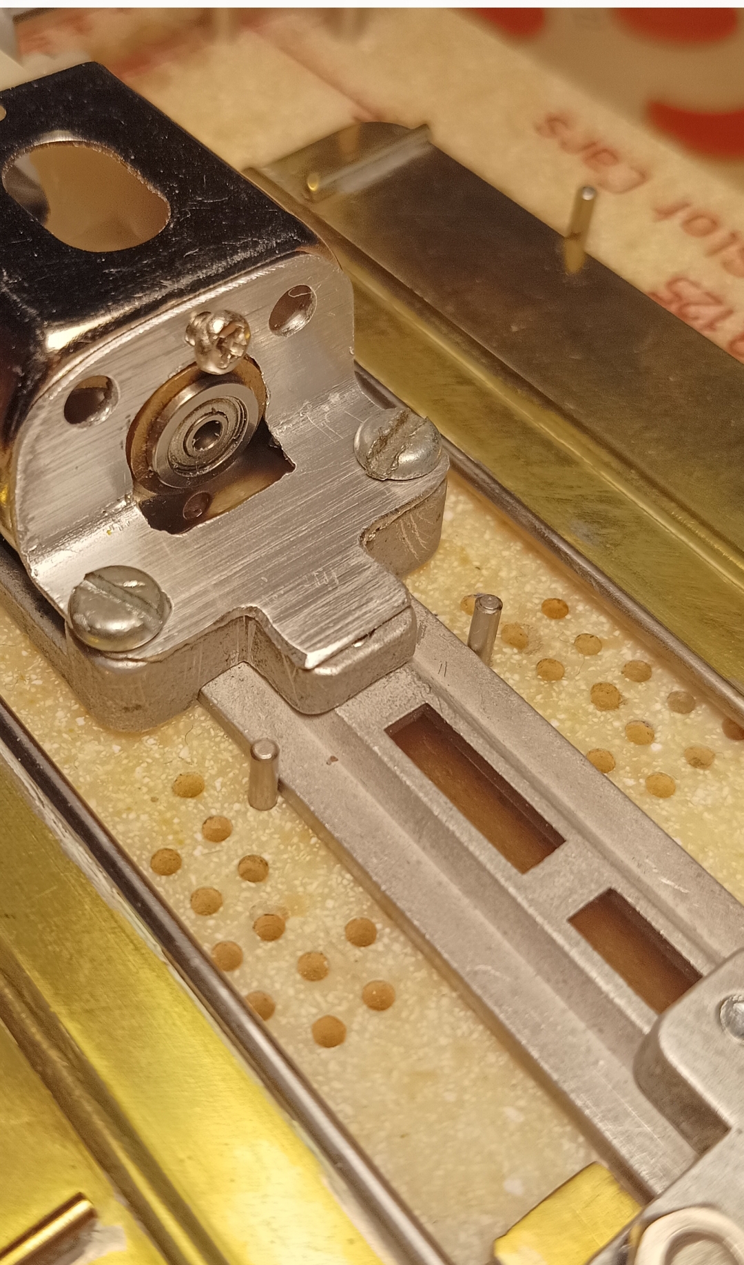

...back to this "lento pede" project, here it is a scratchbuilt rear support for motor stability...

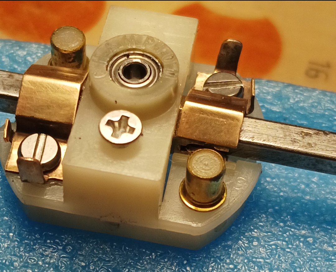

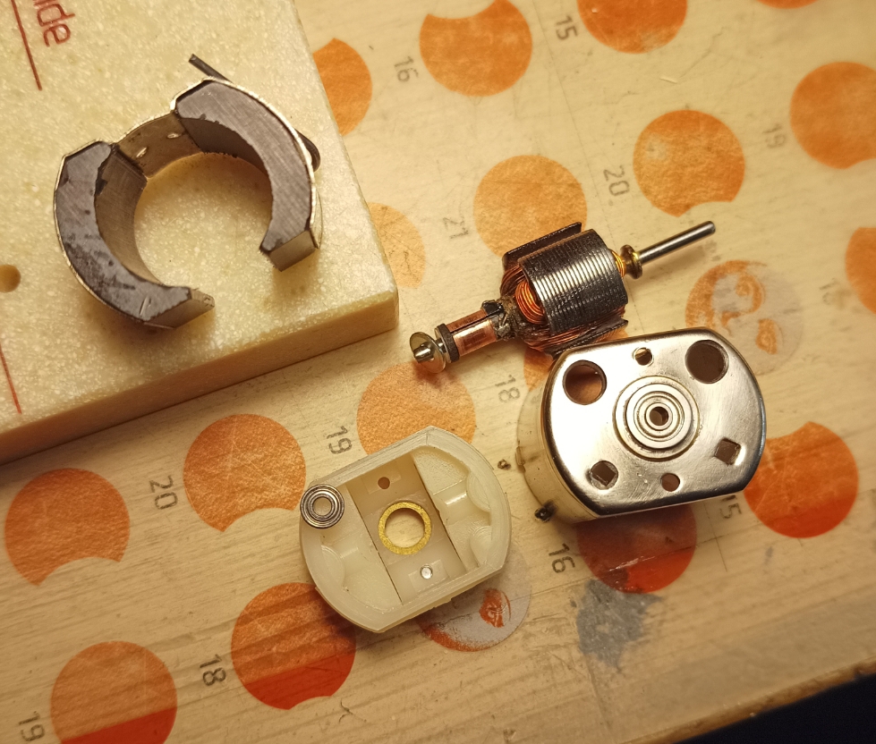

...prepping to solder the ball bearing and it's adapter...

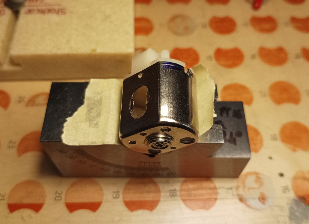

I soldered the bearing into the can using an old (but not bad) arm, the endbell adapter has a very precise snap fit, I will probably glue the bearing with loctite...

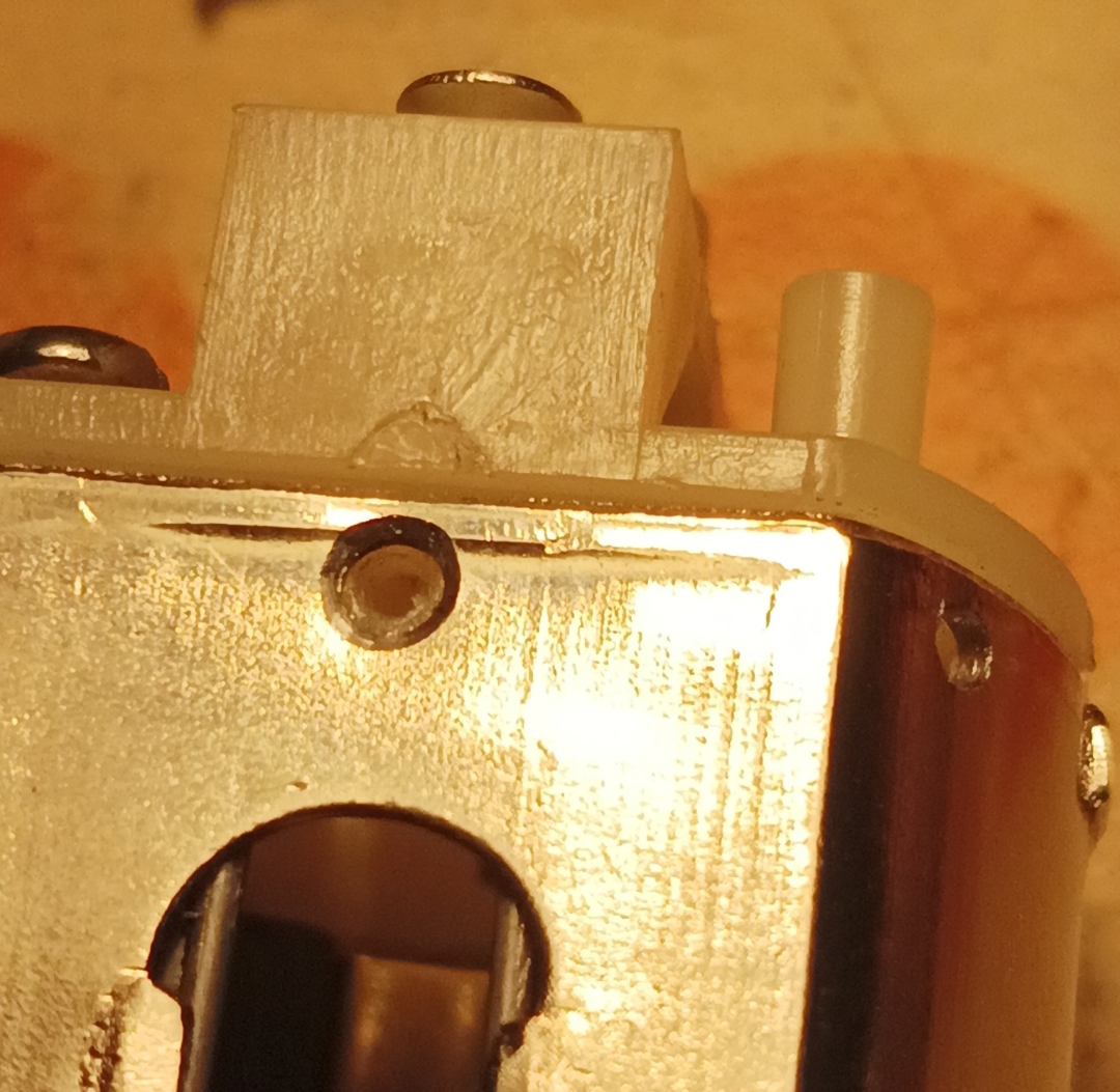

This Champion can already has two holes as standard for fixing the endbell, however I feel more confident if I make two more on the side...

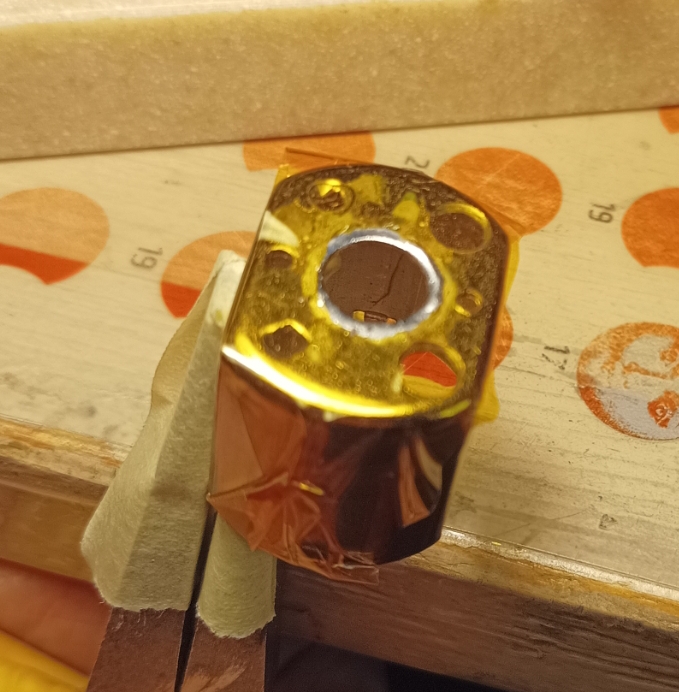

...this hole chamfered for flush...

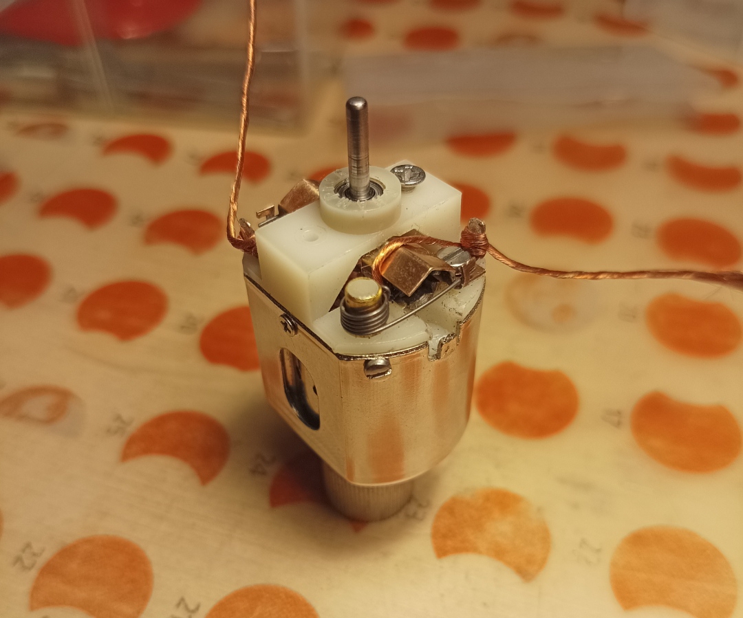

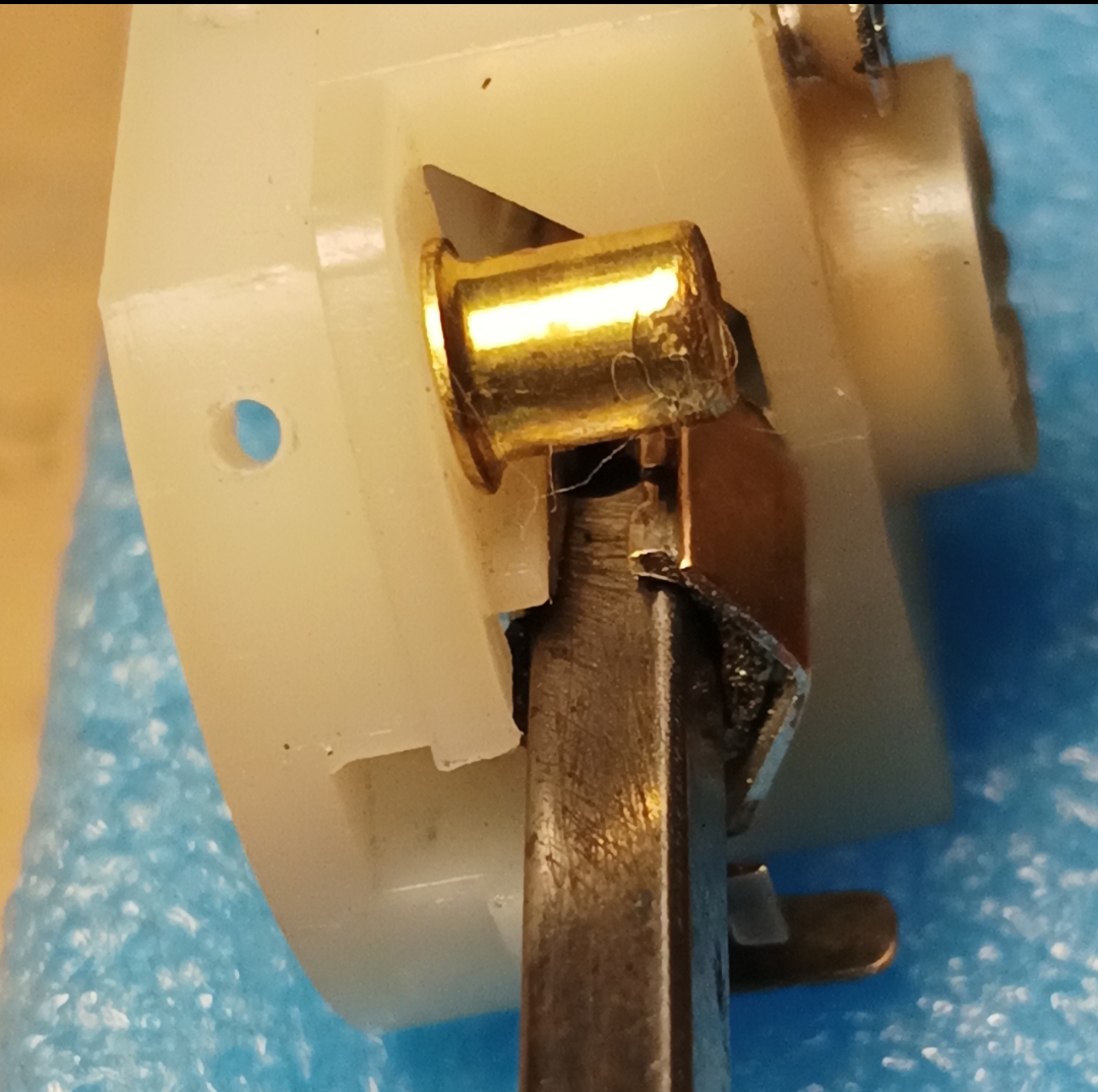

..endbell done, pentroof hoods soldered to the brush tubes and a set of spring post sleeves...
...and made room for the shunts to pass...

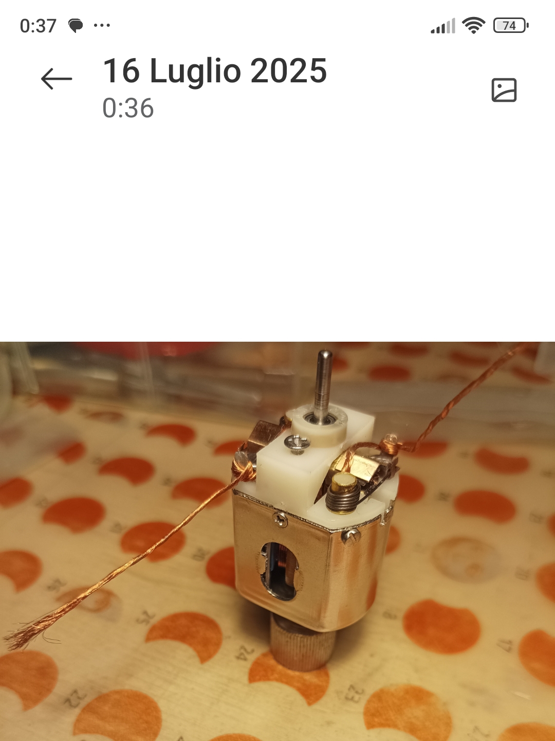

...motor almost done

Posted 16 July 2025 - 12:32 AM
Nice build! Are you going to use spring insulation on the motor springs?  :)
Yes, I used a black insulation on the side where the spring touch the shunt against the carbon..
For the other side I'd like to find some transparent silicon tube...
this is for aesthetics because, in fact, with a single insulation it has interrupted the flow of current and protected the spring where it is hottest

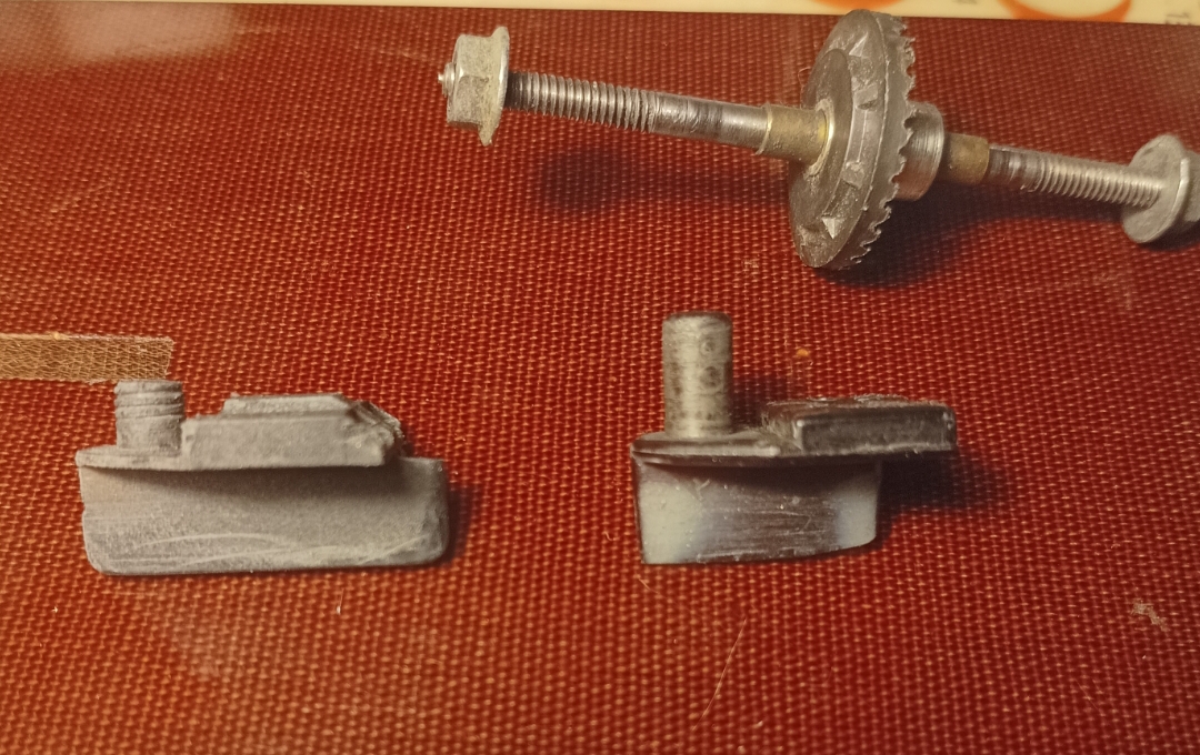

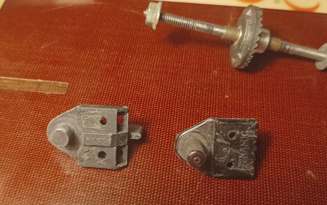

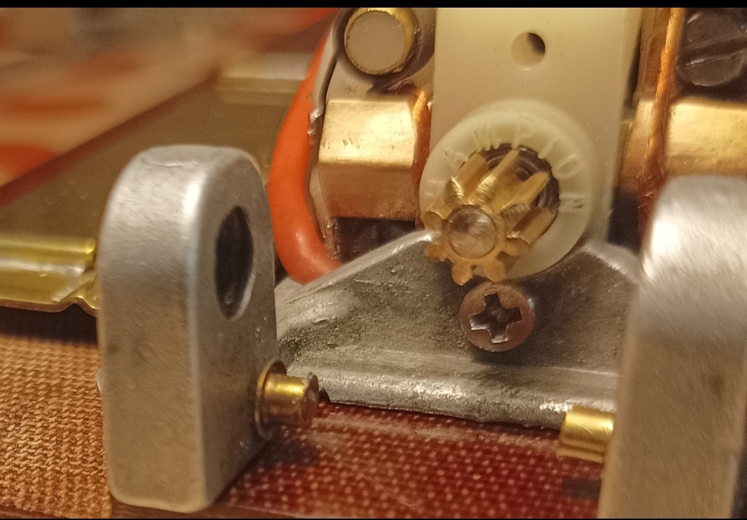

...on the right the original guide, on the left a modern one suitably reshaped...

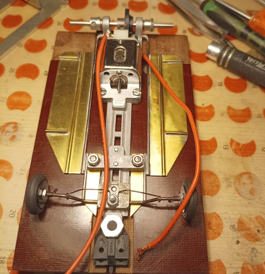

...Let's go ahead and finalize at least the mechanics, after that the most difficult moment for me will come...the body!

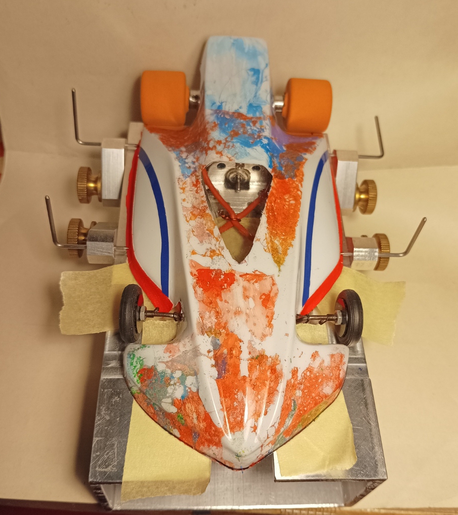

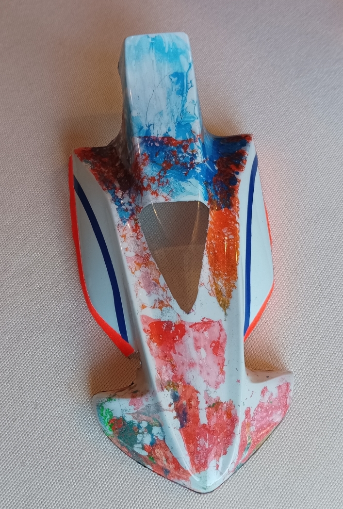

Finally, thanks to the inexhaustible source Dario Gueci, I was able to get my hands on this body that I painted "a la" pop artist...

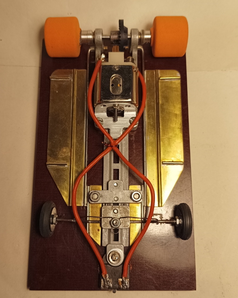

I'm going ti finalize...

...it seems my friend Dario doesn't like the livery of this body, but I'll build it up for a test on the track...

Posted 22 February 2026 - 09:29 PM
Tell your friend, that at speed, this body will look altogether different!  :laugh2:  :laugh2:  :laugh2:

I have to honest Maurizio, the paint job was not one of my favorites either. I am with Dario on this one.
The chassis looks great BTW. :good:
Here are a few paint ideas from Gene's world. Gene has a great line of Thingy bodies.
