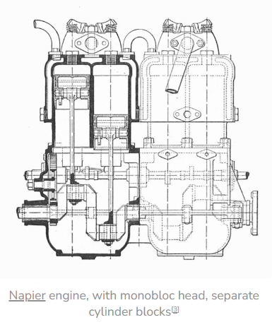

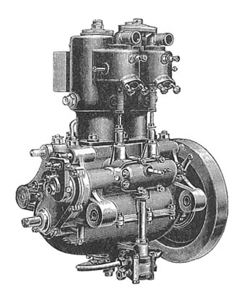

I did not know that Peugeot was ahead of Miller/Offenhauser with the integral head design. A fast Google search did not indicate who first built a block like that with overhead valves. Does anybody know who did it  first?
The original patent for the monobloc design was entered in 1905 by De Dion Bouton.
Napier also had a monobloc design about this time.

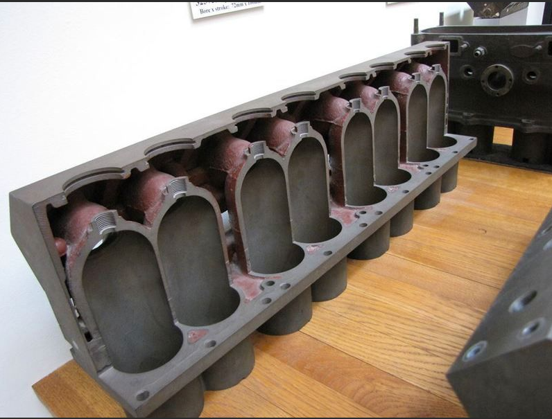

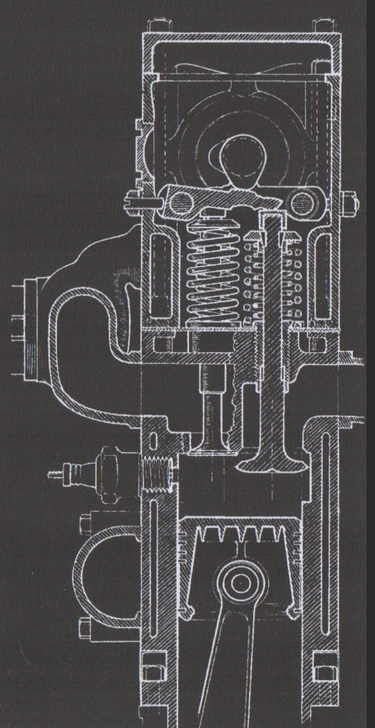

Bugatti also used monoblocs in several of their grand prix cars. This drawing is an original factory drawing for the T-35 and T-37 engines.
This shot shows an unfinished T-59 monobloc cut open to show the domed combustion chambers and angled ports and valve seats.
