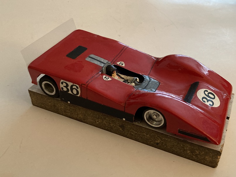

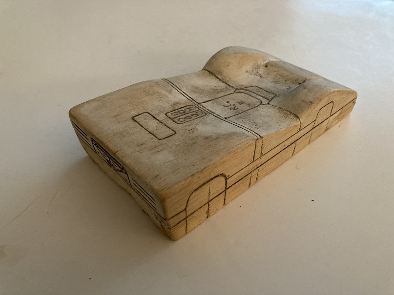

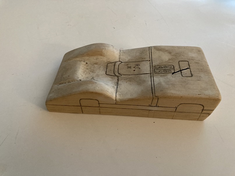

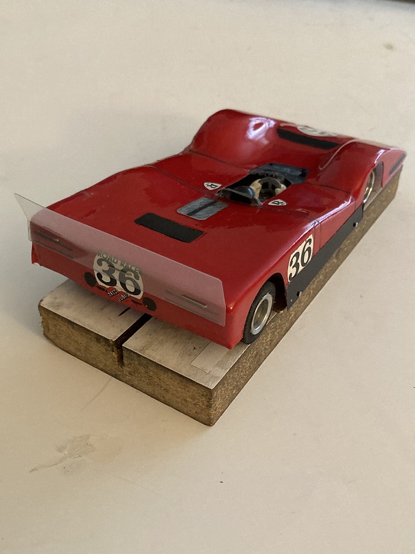

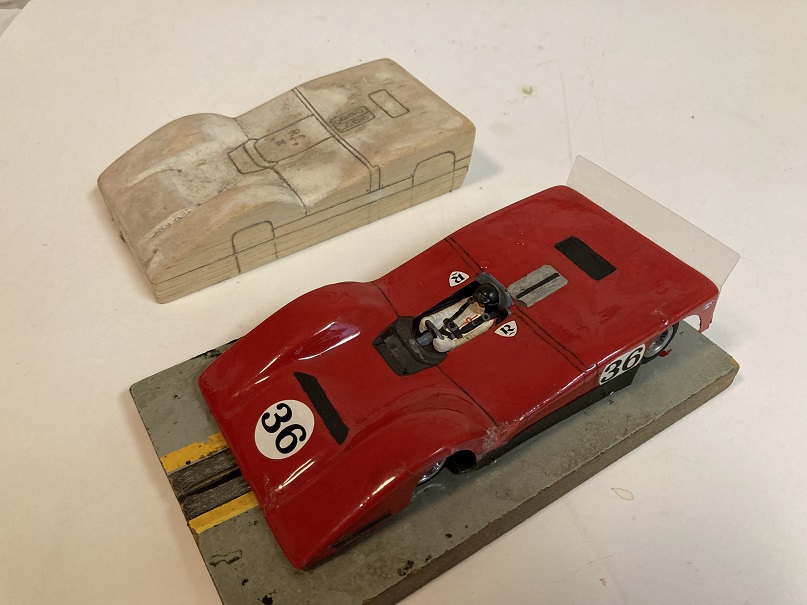

In the early 70's, I found out that Family Hobbies and Raceway in San Leandro, California had a home-made vacuform machine to make slot car bodies, and the shop owner, Don, said I could use it.  I decided to try my hand at making a body mold out of balsa wood.  I carved out a simple wedgy looking Group 7 Can- Am body.
The vacuform machine was easy to use.  Heat lamps were used to melt the plastic sheet, and a vacuum cleaner was used to pump the air out from under the mold.  I am not sure what plastic I used; I think it was .010 Lexan.  I overheated the plastic, which made the body more brittle then normal.
I was able to make a second mold, and made a body from it.  Soon after, Don sold the vacuform machine, and that was the end of my making larger scale vacuform bodies.  I continued to make HO slot car bodies with another machine through the mid 70's.

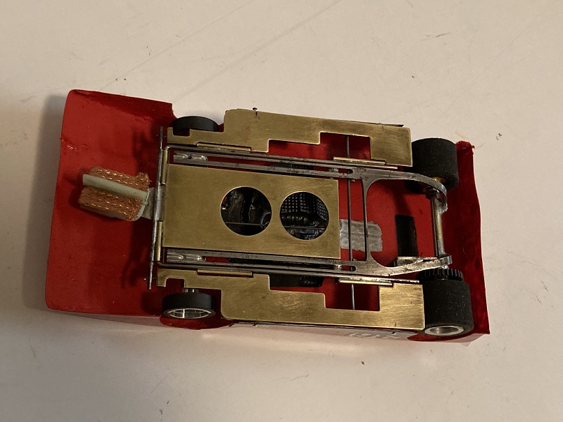

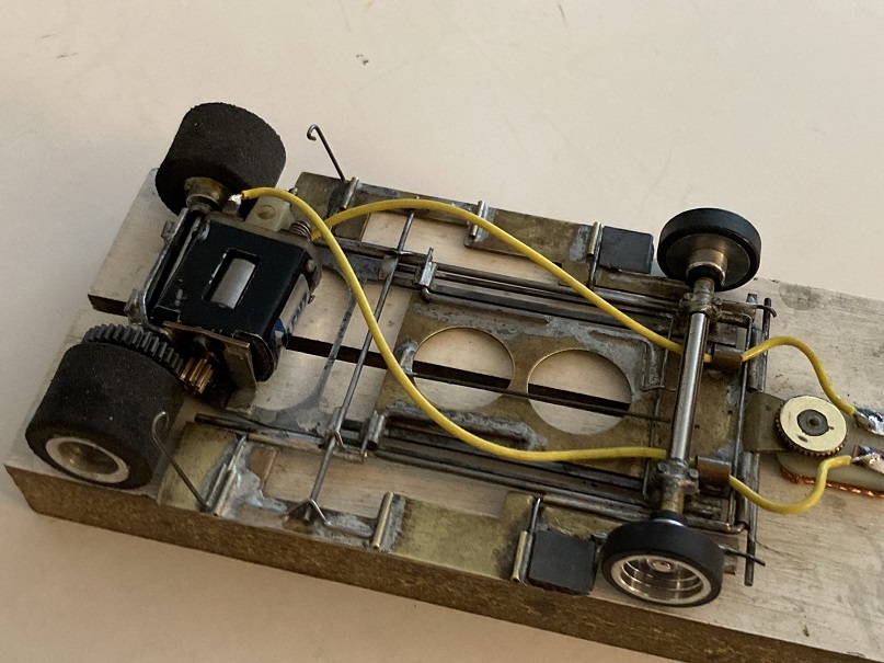

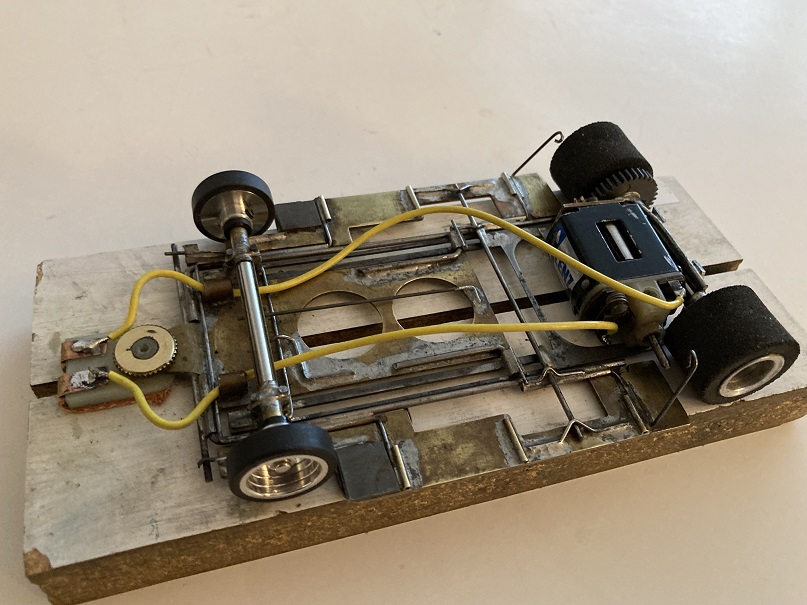

I dug up the Group 7 body recently and repaired all of the cracks and damage.  I found the chassis, which was made for a B-can motor.  A Lenz B-can motor was rebuilt and installed in the car.  Time for a track test.

Great looking chassis & body Rod. Your mold seems to be in good shape too. I might have thought otherwise from balsa.

Nice chassis, did have a similar one.

Is it my eyes, or does that flag keeper/weight gizmo have teeth on it?  :o
#6 Bill from NH
  • 15,318 posts
Posted 18 October 2025 - 04:02 PM
It looks like teeth to me, but it might be a separate serrated washer/spacer too.

This is what happens when you cross-pollinate a UOP Shadow with a Ferrari 612.
Two of my favorites and yours has the best of both. Maybe you can get Victor to pull a few. I'd buy one.
Ahhh,.. YES :)  'Spot-On'
Great body and Balsa work !!
Nice chassis too :)
