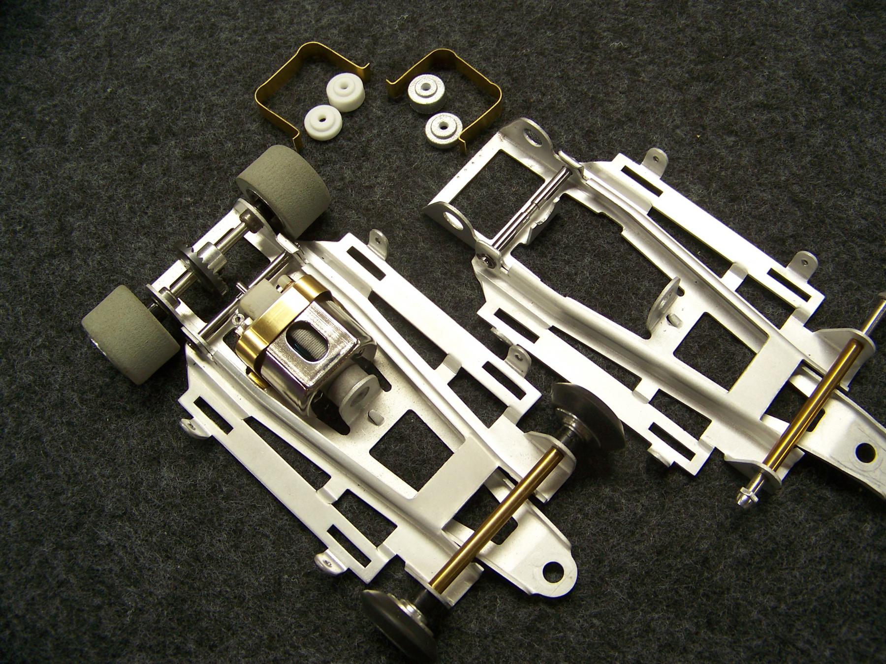

That's correct, Bill. I have made reproduction 26D brass clips with adapters for this IFC chassis.
