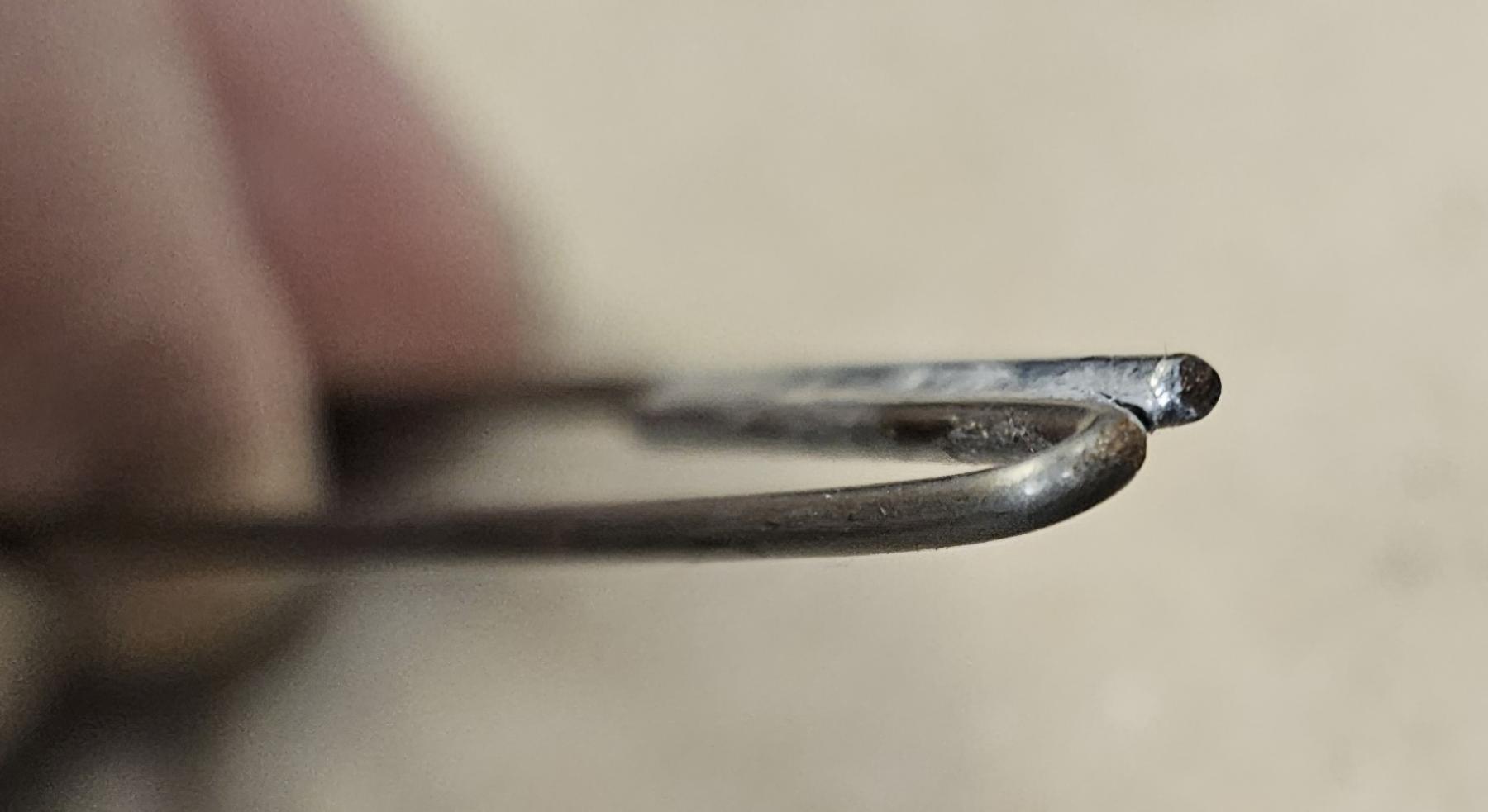

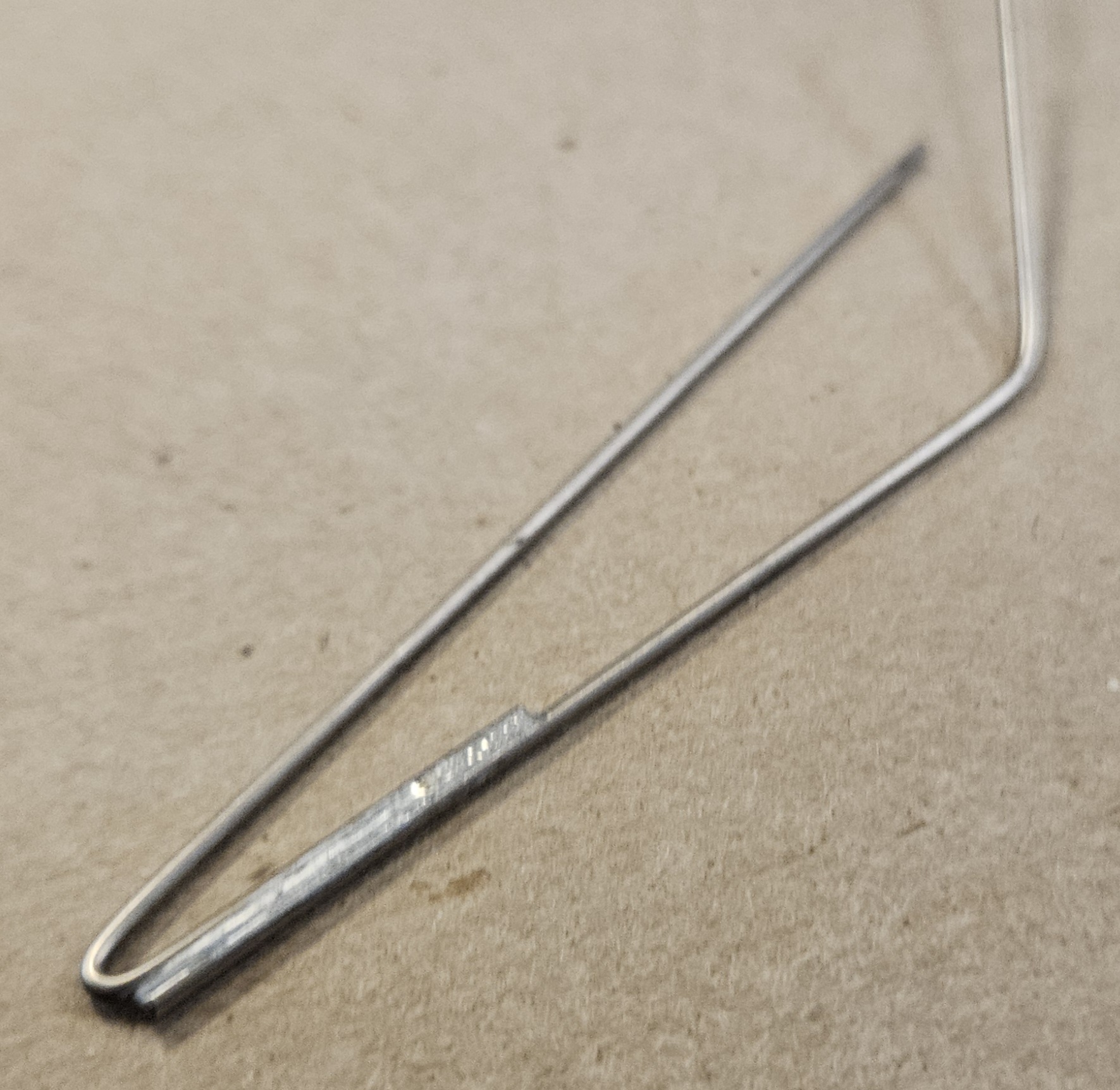

#20 MSwiss
  • 26,238 posts
Posted 30 December 2025 - 11:13 AM
Not an issue.
That's how I test the adhesion when I get a new batch done.
I solder 2 straight pieces to each other and take a pair of pliers and bend one of the pieces, grabbing the wire just beyond the solder joint.
Because in this case, it's .047" wire, I'm able to almost bend it back parallel before the solder started to shear.
With .062", the solder will start to shear a little bit after bending it 90 degrees.
Bottom line, the plating never cracks or peels.
  • team burrito and SpeedyNH like this
