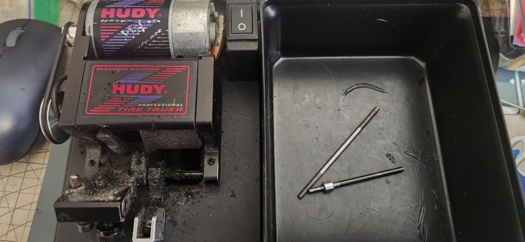

Going to the machine shop to have some modifications to my vintage axle so I can use to true tire using my Hudy tire truer. First, I want the shop to chop one of the thread sides and true and reduce the diameter of the smooth sid

Posted 08 January 2026 - 02:01 PM
Axle pics.

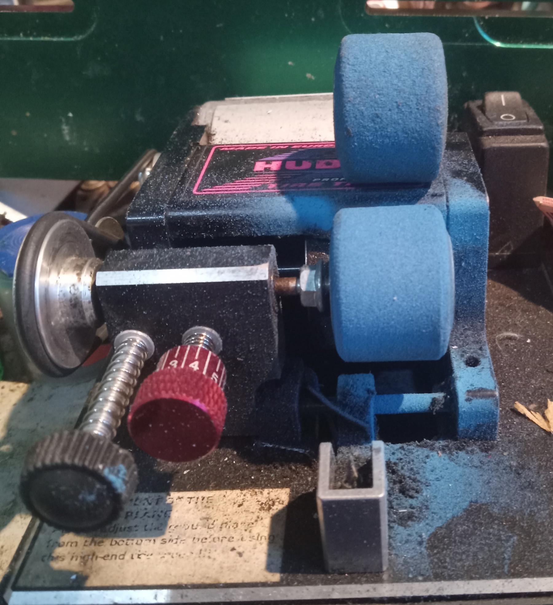

Below is my solution for 1/8" axles from my "Toys for retirement" thread:
Here's my latest "upgrade" (depending on your point of view laugh2.gif ) on the Hudy tire grinder. I bought a threaded axle that was ground down to fit the Hudy. The threaded part ran out of round over .002" (she'a wobble too much, thats'a no good)... so:
1. Replaced the metric bearings with good old "Merican" 1/4" X 1/8" ball bearings. I found some vintage Bill's Hobby House bearing adapters that fit perfectly in the 8mm bore of the Hudy.
2. Reamed out the Hudy pully to 1/8" to fit a vintage threaded axle.
3. I went through my axles and and modified the straightest one I could find.
Here's the result. A dedicated 1/8" axle tire grinder that will true tires up to 1-1/4" in diameter:
KemtronX503Wasp-016.jpg[

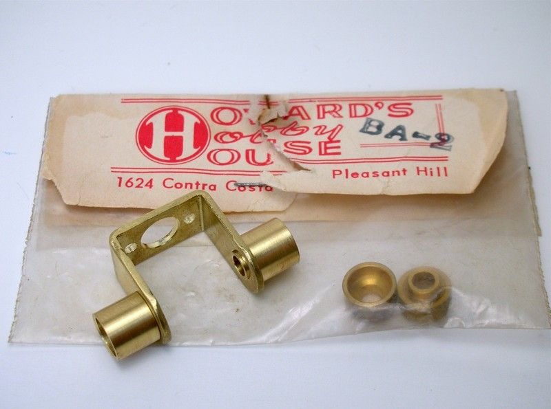

Here are the long out of production Hobby House bearing cups. So what is needed is a simple reducing sleeve to fit the larger hole in the Hudy and a good old 1/4" X 1/8" ball bearing:
  • Pablo, triggerman, Jencar17 and 2 others like this

Perfect solution Rick, thanks for sharing. Easy enough to make a reducer on the lathe.

I like the lock nut, I put one on before I bought a Mid America setup. Dyslexia kicked in and I had the nut on the wrong side. I had discussed changing the bearing with Martin,but I needed to use 1/8" & 1/32". Sure, I could use a sleeve but, I felt lucky and tried the aforementioned method.
#17 Mark Onofri
  • 2,981 posts
Posted 18 January 2026 - 08:10 PM
If you compare dc-65×'s Huddy to mine do you notice anything different? 🧐

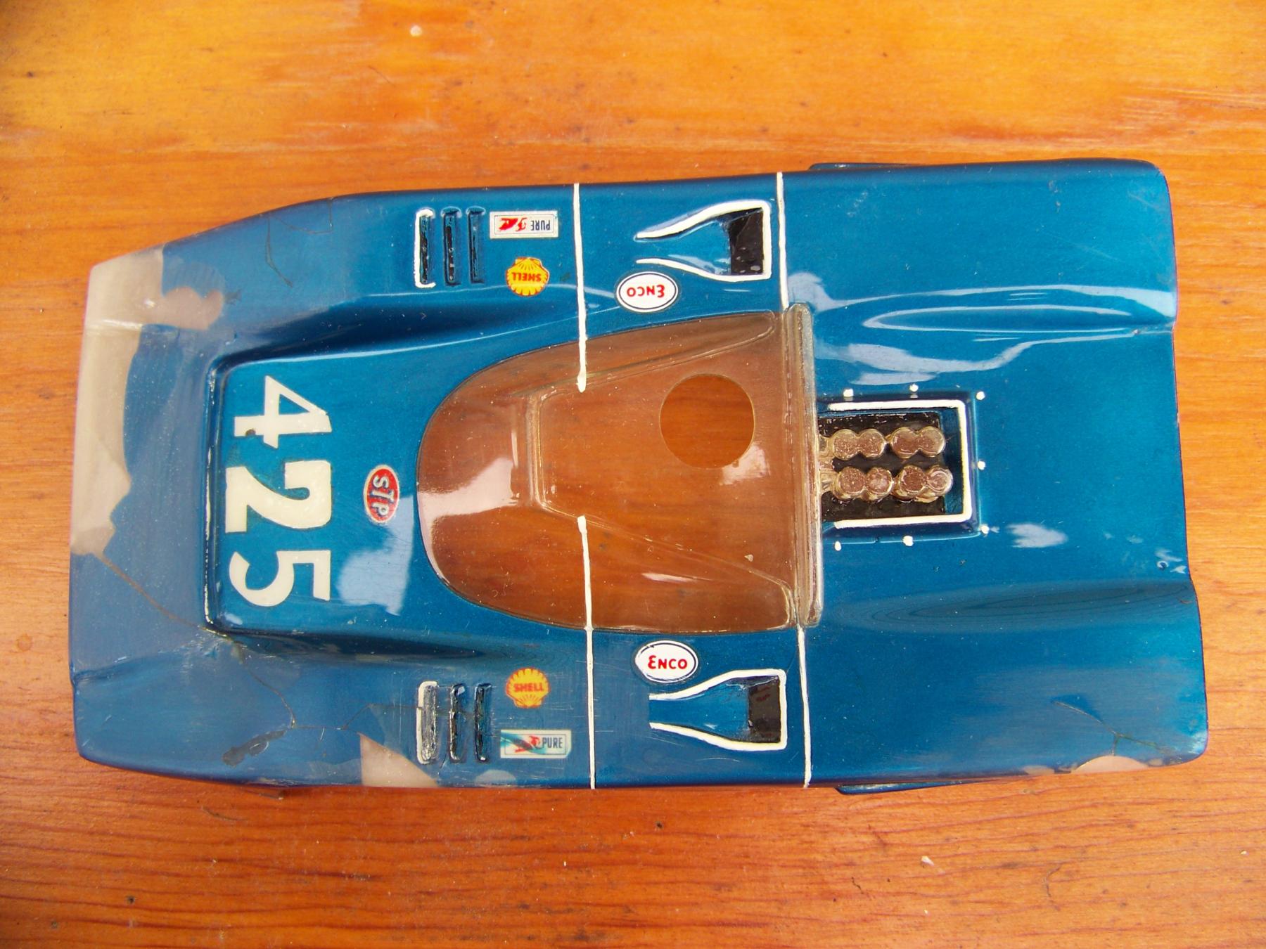

If anybody is wondering about the "McLaren measurements" comment ? I have been for decades now trying to find a replacement M8B Mclaren body to match my childhood race car from 1970.
Mine has had its tail cut off after it got sucked up after being hit from behind in a race.
I am planning to add the cut part back on, with Lee's help.

Is this a Betta body, or another manufacturer's?
#20 Flathead
Flathead
  • 222 posts
  • Joined: 01-January 10
  • Location:London, England
Posted 18 January 2026 - 10:15 PM
Original GT Models (Gordon Tapsel) body Bill.

Ok,I guess no one noticed that I have the adjustment knobs opposite compared to dc-65×'s ?

I got the axle back from the machine shop and they chopped one side of the threads out. Trued the the smooth side so it could fit through the bearings and it fits like a dream. I usually true 1/32 tires and now I can work on some of my vintage stuff. I trued a wheel/tire from the 60's and it worked perfectly. Now, what vintage restoration should I work on? Now that I can cut down my vintage wheels/tires, should I treat my tires to make them softer?
