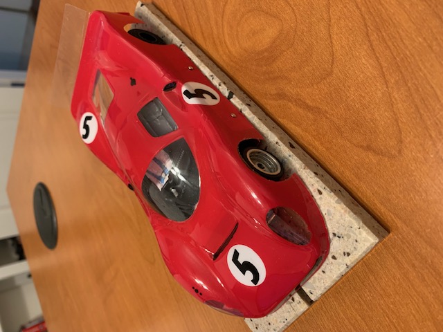

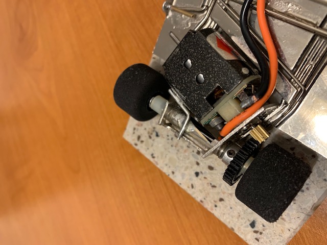

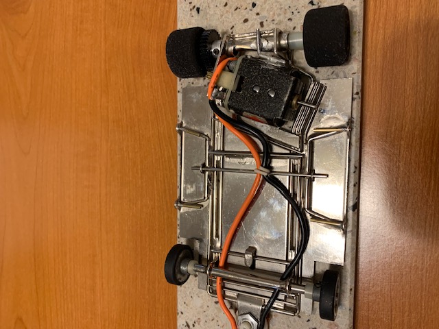

Posted 17 February 2026 - 10:24 AM
Here are a few pictures of the car...
