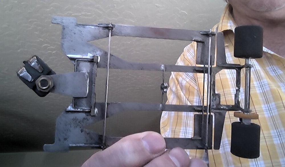

Posted 06 March 2026 - 01:00 PM
For some reason, whoever had the car before me chose to solder full pin tubes all the way across the chassis which kinda negates the flex.

Posted 06 March 2026 - 05:28 PM
The full-width pin tubes may be original. I had a Camen Eurosport chassis that was original with full-width pin tubes like that. Eurosport chassis have very minimal actual movement in the chassis, just enough to allow the large metal areas to flex. Eurosport used unique cobalt motors expressly for that class for a long time, and the motor box size supports that. I recall that Lee built his own setups, and PK armatures were very popular.

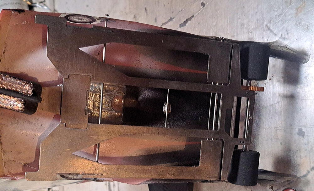

#12 Mudhen
Mudhen
  • 61 posts
  • Joined: 16-November 24
  • Location:Pleasant Hill, CA
Posted 09 March 2026 - 06:44 PM
By the way i did not see it at first but the name HAROLD ROWE is etched on the top of a frame rail. Anybody ever heard of him?
