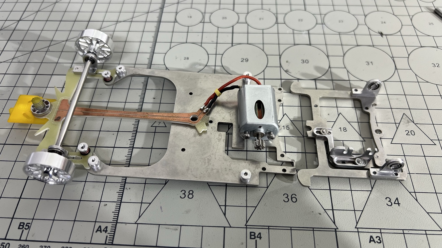

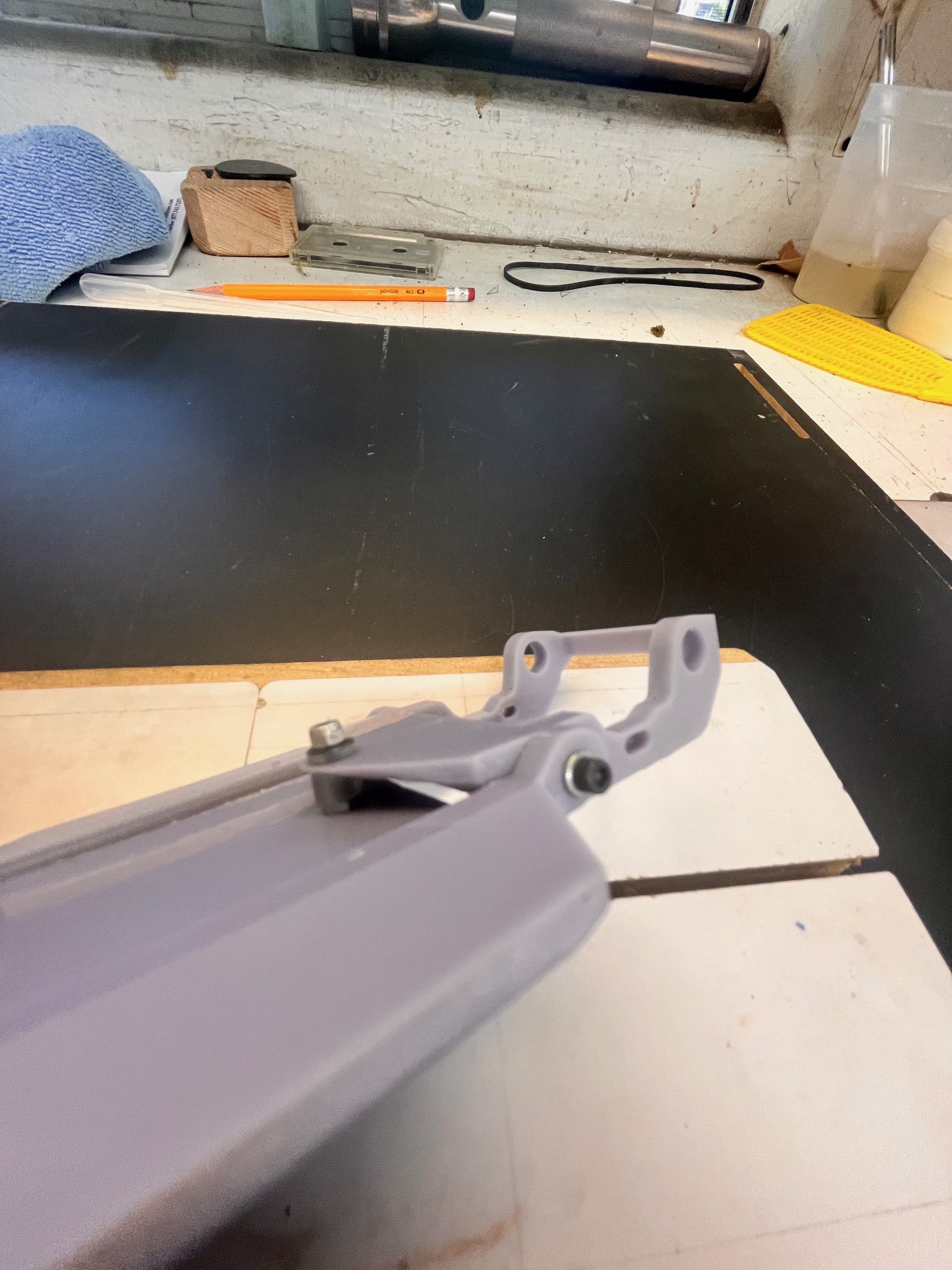

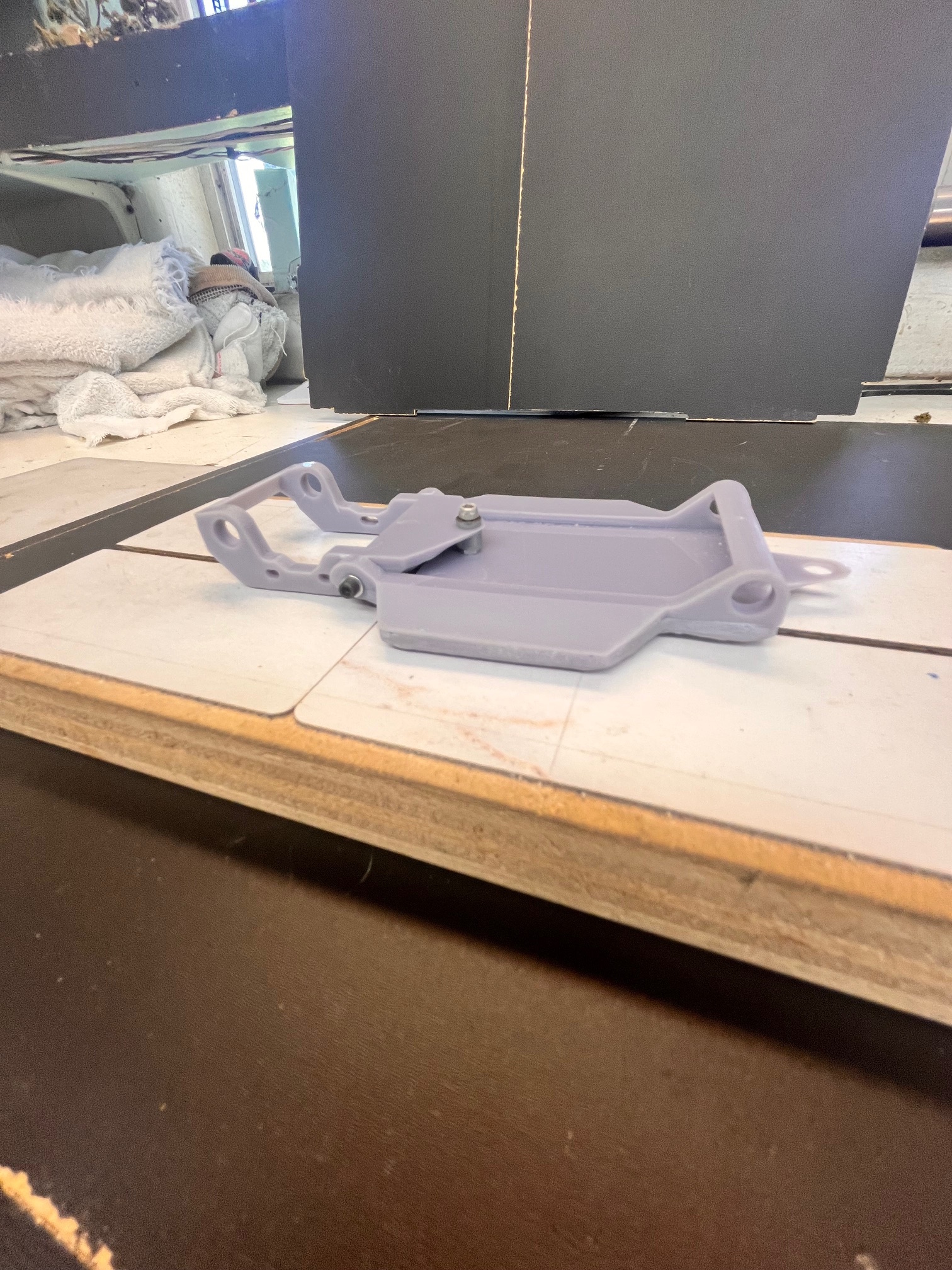

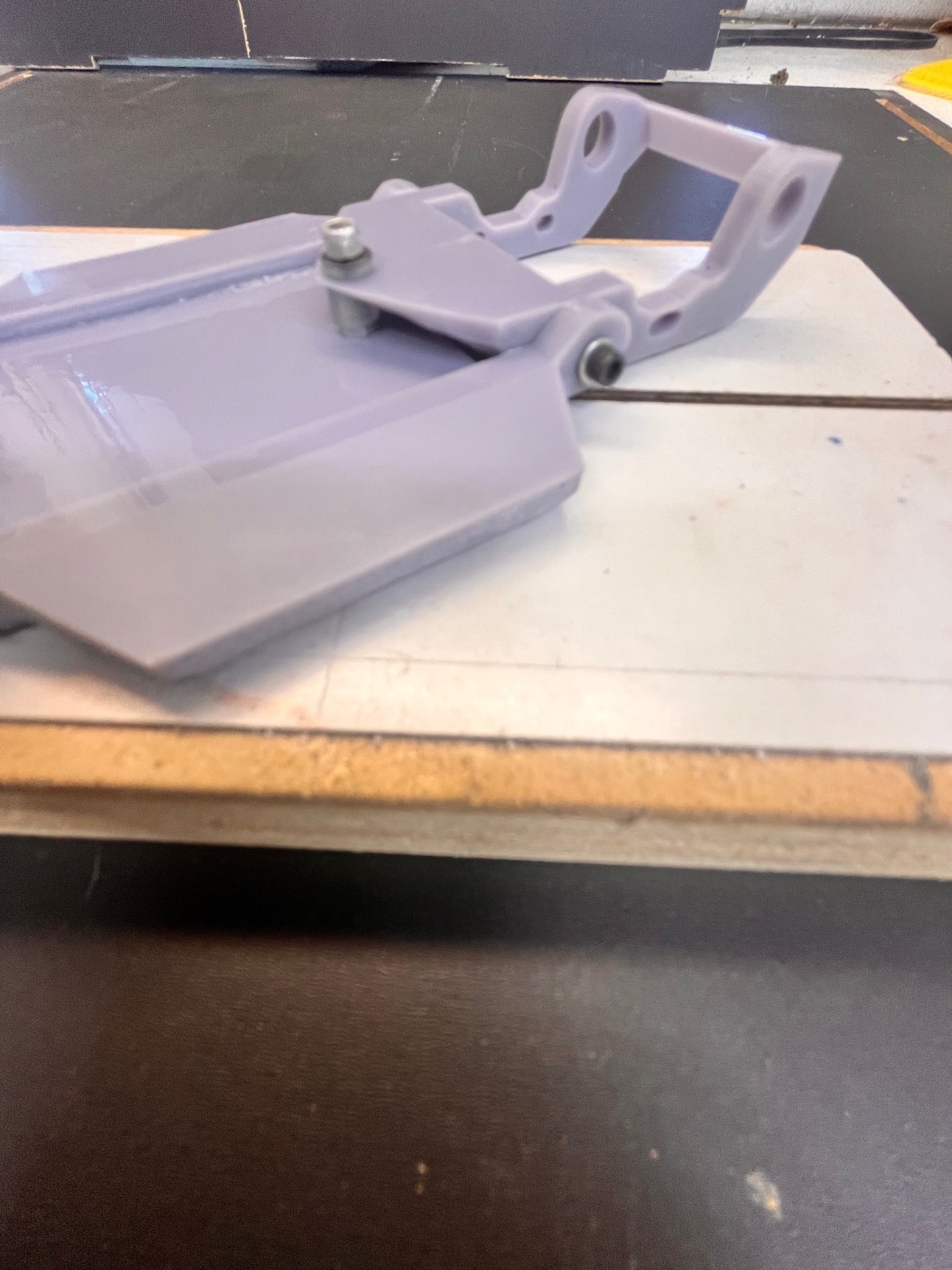

I was looking at my old RC on road car the other day and the idea hit me. I wonder what that kind of "suspension" would handle like as a slot car? Silicone fuel line tubing for the cushioning......probably won't get built until I crash test some other built projects.....

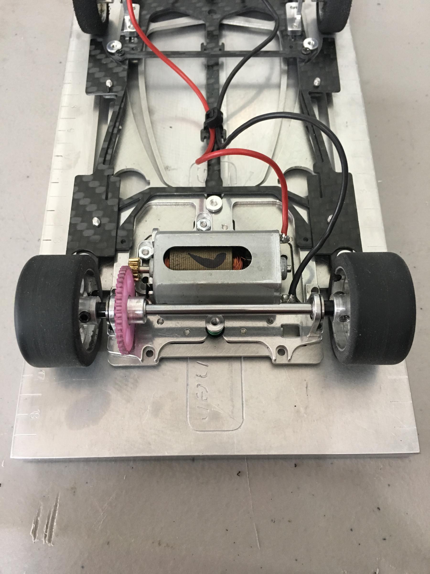

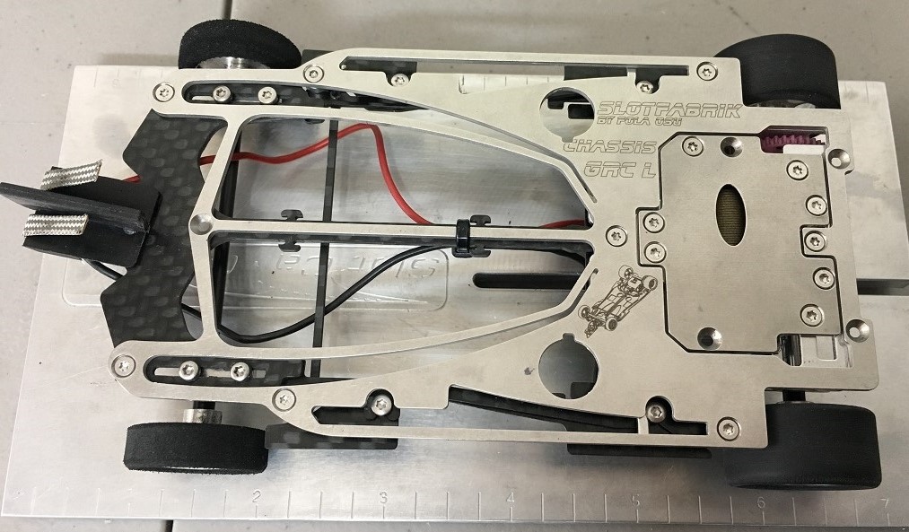

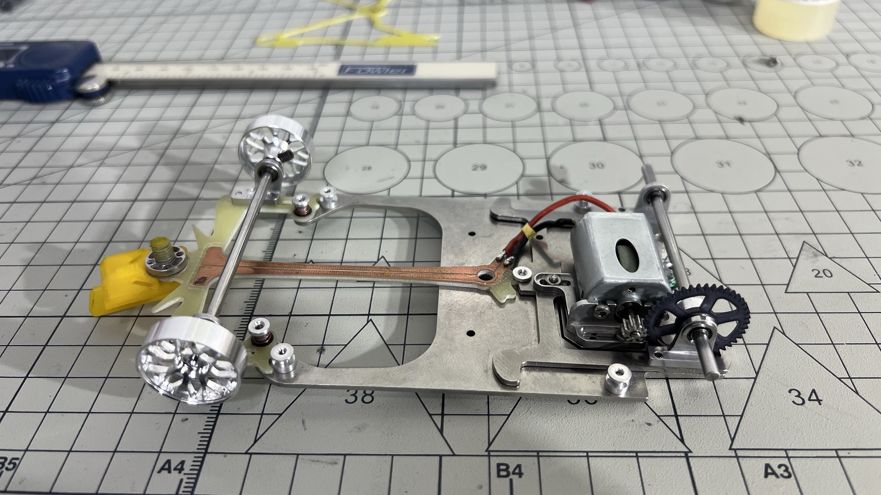

These chassis use a single point with a spring behind the motor. Works great! With the front T-Nut they hold the motor pod in place. You could put a .5mm silicone o-ring on the T-Nut for some more damping.

Who did make this?

Who did make this?
Slotfabrik in Germany
Here's another design - for my C291
  • olescratch and Jaeger Team like this

Who did make this?
Are those wheels machined??
Yes they are aluminum, cnc milled. They look better in person.

Beginning in the late 1980s, on-road R/C cars were just big slot cars. Associated, Bolink and TRC made kits using graphite pans, and pivoted motor boxes. The only difference in design was that the R/C cars had steering. They used foam tires just like the slot cars.

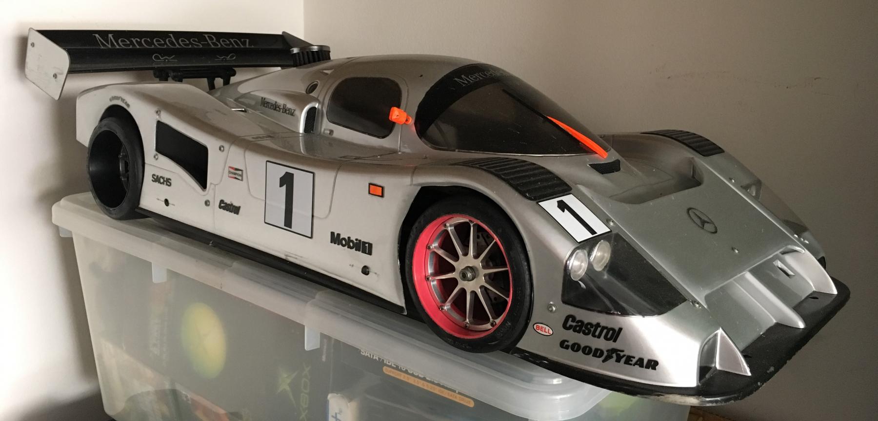

You must be referring to 1/8 and 1/10 scale RC, because my 1/5 scale on road race cars had real steel belted rubber tires. Heres my FG Modellsport Sauber C-291
