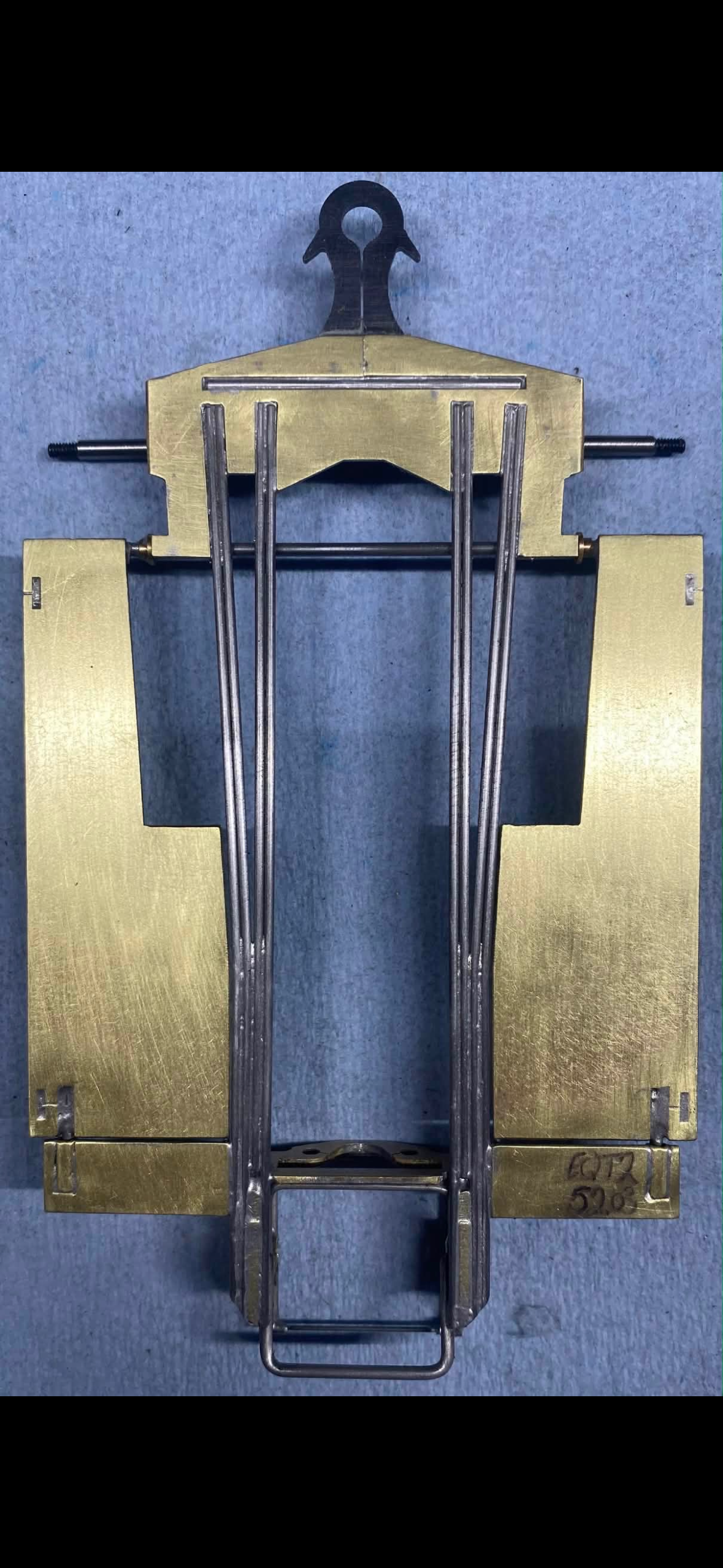

Is it now legal to use keyed parts in chassis building?

From what I know, it has to be a commercially available chassis kit and/or components. Except for original Slick 7 motor brackets of course, LOL.

Keyed parts are still not allowed.

The body mounts are keyed.

Slots for the tabs also appear to be EDM cut.

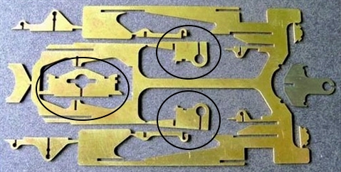

Martin, here is an example of keyed components.  The area's circled make up the motor bracket that are joined with tabs to make a three sided motor bracket.  Basically any two pieces that are machined to fit tightly together.

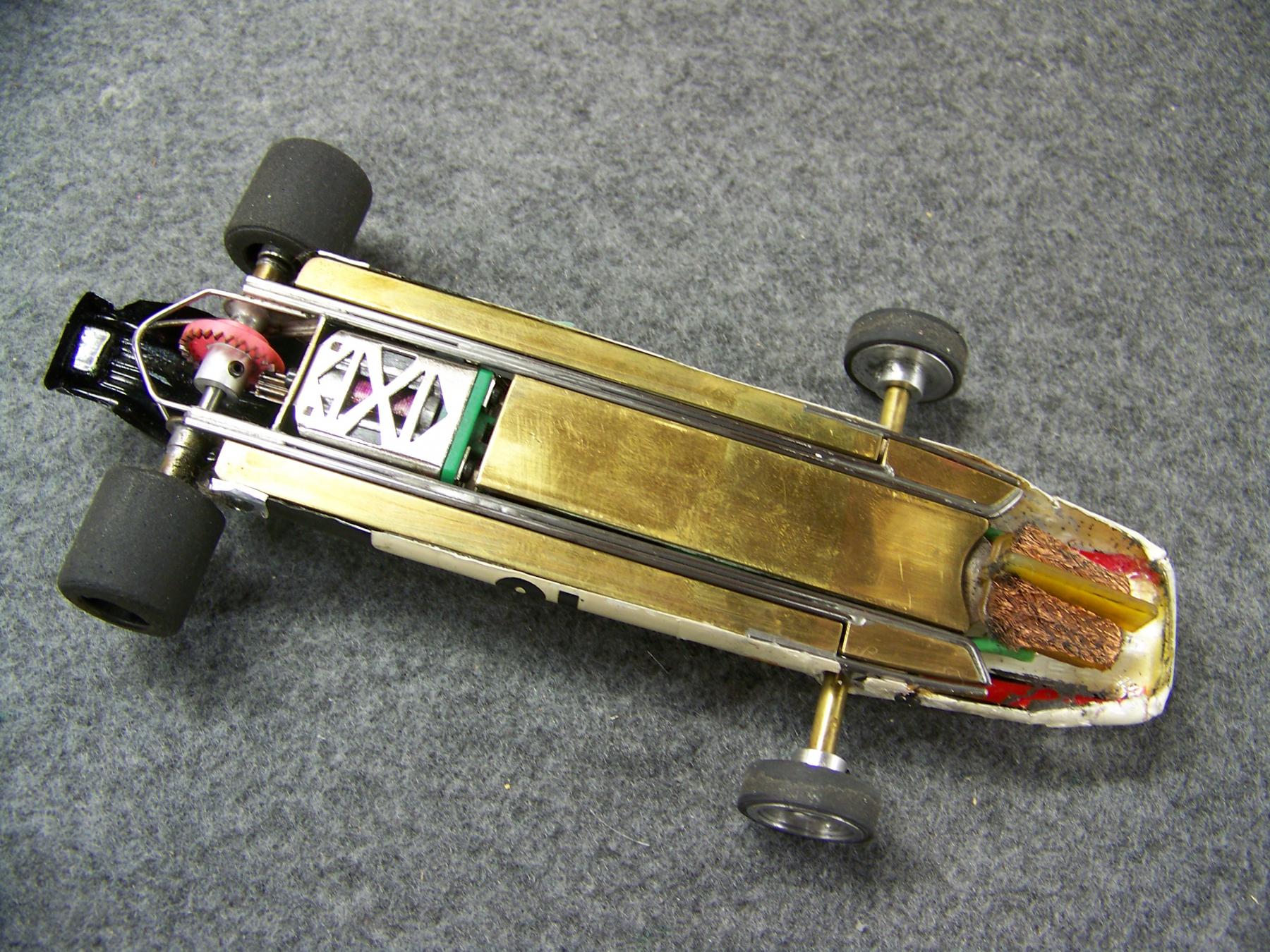

Thanks Jay and Dominic, so in retro racing I assume you want chassis to to made they were in the 60's ? :)
Can you post a pic of a legal retro chassis. All I could find was conversations about what was IRRA legal.  :wacko2:
I build and restore original vintage chassis, have done for 50years. I did read the rules that were posted and I honestly could not build a chassis that I could be sure would be legal. Is it confusing to other would be new competitors or do they just buy a chassis, is that legal?
I would think it best if I saw a pic and just copy that. Who makes these production parts that are legal?
Is this a legal chassis (below) where the main 4 rails are cut (keyed) to the front section?
And what is the part that looks like a rod cut and fit just ahead of the front axle. Is that considered keyed?

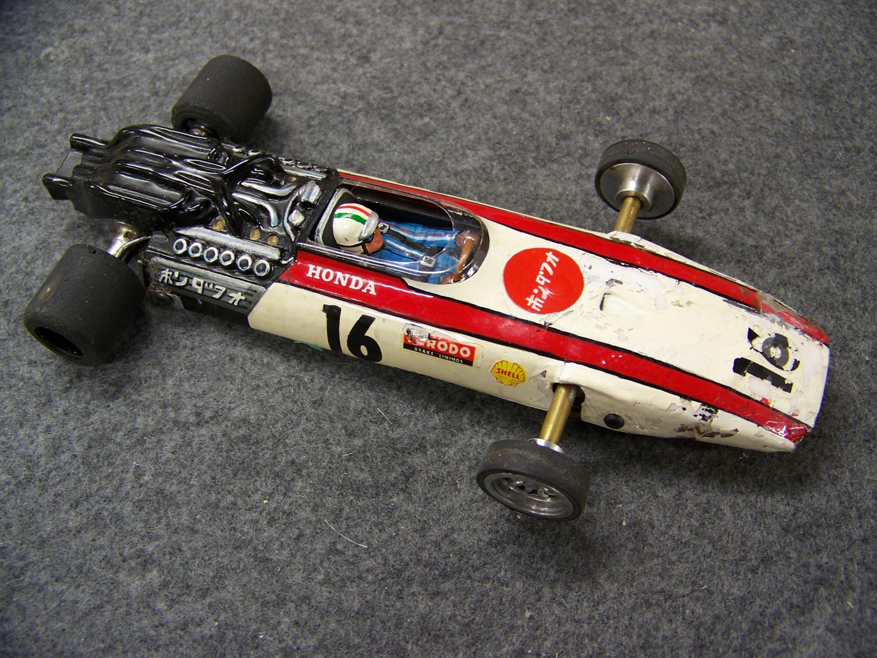

Here's a pic of a recent F1 I built

The picture of the chassis you showed is an excellent example of keyed construction.  Specifically near the outer edges of the side pans where there are small inserted pieces of flat stock to hold pin tubes.  The place up front where the piano wire is emplaced in the front of the chassis bares a closer  look and IMO is really pushing the envelope.

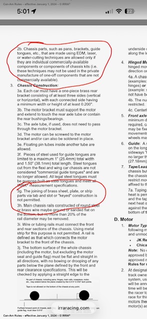

Rules state the joining of brass sheet, strip, or plate. Nothing about piano wire. If that were the case then lots of kits and general chassis builders would be failing tech.
