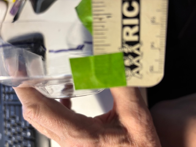

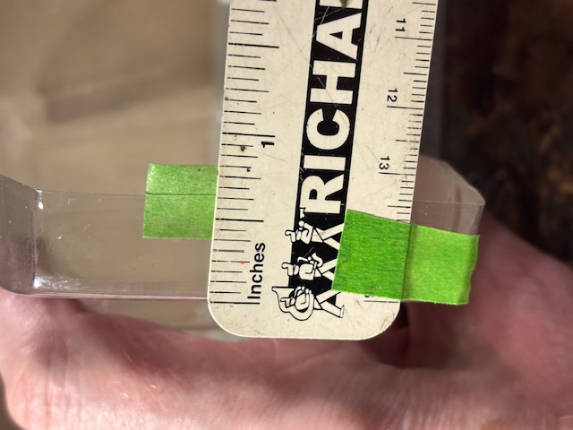

I'm trying not to be a pain here.  It seems either I have rogue DDS bodies or the IRRA people who are responding have not seen a DDS Daytona body.  I have tried to attach 2 pictures.  The body is trimmed to the cut line on sides and front and then cut straight across the back.  The max measurement from the top of the trunk to the level cut is only 5/8" -- the bumper cut line is actually higher.  Therefore, the new rule for the fall requiring a body that has .750" from spoiler to bottom of bumper would mean the DDS Daytona would be illegal.  That is what I'm trying to call attention to.

Dont use the cut line on the back, use you ruler and make a line .750 from the deck lid.

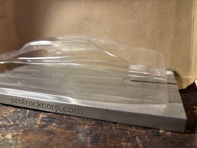

If I did that then the rear of the body would be BELOW the rest of the body and probably drag on the track.  Look at the pictures again.  The DDS Daytona does not have a spoiler at the rear -- the rear of the body slopes down.  The first picture shows the body sitting level on the plate -- the front and sides are cut on the cut line, and the rear is cut level with that.  The second picture shows that rear measurement to be about 5/8".  I have added a third picture (didn't come out the best) to show that that the DDS Daytona, from deck to bumper cut line, is basically 1/2" or .500".
There is already a different rear height for the Daytona in the proposed revision.  What I'm saying is that the deck to bumper measurement needs to take into account the lower Daytona body.  It can't be .750.

I see what you are saying but the mistake you are making is first cutting the sides of the body on the cut line
Ignore the cut lines from behind the front wheel well rearward.  You will have to come up with your own new side cut lines and then mount the upper rear edge of your body to meet the new regulations.  For the Daytona only it is between 1.0"-1.250." from the rear top edge to the tech block. Only then measure down .750" from the top edge and cut the lower edge of the body ("bumper") there.  I don't have a DDS Daytona on hand to check but try this, it should work.
BTW...The body that you've already cut should be legal until the new regulations go into effect Sept. 1st so you haven't ruined a body.

My understanding is that the rear height rule is to prevent serious wedging of the body.  Now you are saying I have to figure out how to wedge a Daytona body, meaning coming up with a random cut line.  How many bodies would I have to cut and mount until I hit the magic number?  Here's a better solution, which I suggested above:  since the Daytona has a different height regulation, have a complimentary bumper measurement, which would look to be .500 by the DDS cut line.
Maybe the IRRA Board shouldn't have approved the DDS Daytona body -- but you did.  Now you are trying to close the barn door after the cows are out.  I understand the rear bumper regulation to prevent racers from removing too much material from the rear, but the fact that the Daytona body does not have a rear spoiler and has a different rear deck profile should inform the bumper regulation for that body, not the regulation making the racer wedge the body artificially.  That's just nuts!
Why don't you just suggest to Dan Ebert that he re-do his mold with new cut lines that would meet your regulation?  Because you know what he would tell you, just as he did when you proposed changing the pull thickness.
It's this simple -- .500 for Daytona.

Chris the horizontal cut lines are a guide, not a requirement to follow.  Most racers rake the body so the rear tires clear while trimming along the fender line.  In some cases raking and slamming of the body was getting extreme so this is why we came out with a min/max rear height on the Charger bodies.  As of September you will be able to trim the rear wheel wells out so makes it even easier for mounting and tire clearance.
The added dimensions were geared towards the Chargers as this is the most commonly used body with the Daytona being second.
Paul, we are looking at some of the other stock car bodies with molded in spoilers to see if the same min/max height and rear bumper/panel dimensions can be used to eliminate any potential confusion.   I'm going to a race this weekend to look at some of the bodies on the wall to confirm this.
**Update dimensions for the Daytona
  • Min/Max height 3/4"-1"
  • Rear bumper/panel 1/2"
