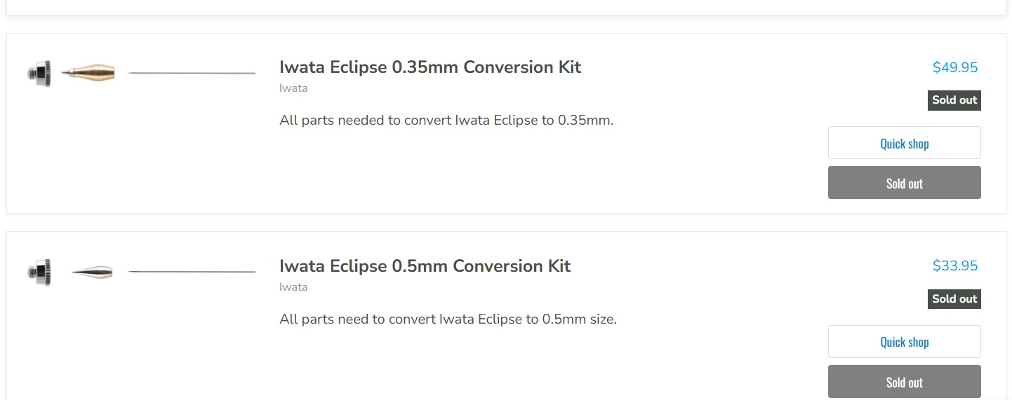

File this under "For what it is worth"...
My Eclipse HP-CS is less than one year old. Recently I had it partially dissasembled on my bench, got my feet entangled with the hose and it fell to the floor... damaged the nozzle and the needle. I ordered a new nozzle and needle, assuming that was all I needed. Therein started a journey that became one step forward and two steps back. The new nozzle has been redesigned.
It requires a new nozzle cap. There is a conversion kit that no one told me about. I learned this searching the website for Midwest Airbrush Supply. Their website is phenominal with schematics, etc.  They are out of the conversion kits and no one else even lists them. I've had to order one piece at a time from different vendors.

Are these the conversion kits?
They've had these for a few years. I bought my HP-CS from Hobby Lobby in 2022 and replaced the stock .35 combo with a .5 kit right after I bought it. I spray mostly metallic and pearl paints and the .5 works better with these type of paints.

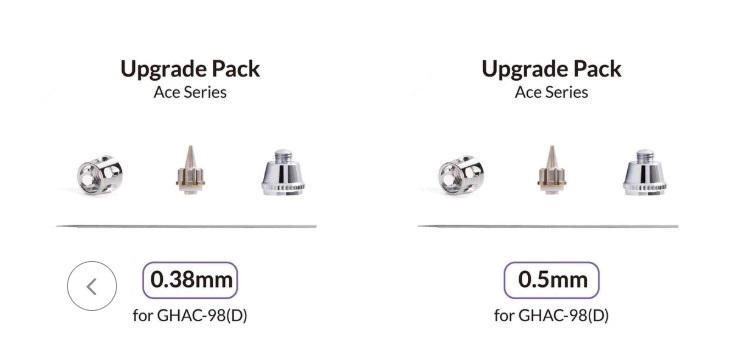

Gaahleri GHAC-99D use the same type of needle, nozzle, cap system as the Iwata. You have to replace all 3 pieces when you change to a different needle size.
Of course. You can't expect to swap a smaller needle for a larger one without changing the nozzle too. However, on the Gaahleri the end cap is universal amongst some models from what I recall.
The issue with the Iwata Bill is that they changed the design of the nozzle - so Milton didn't purchase the original one he damaged, he got the newly designed version, which requires a new end cap.
The bottom line here is, Milton should've done his homework thoroughly before ordering parts, unless he ordered directly from Iwata. And I don't know if that's possible or not.

The current nozzle on the Eclipse is similar to what you would find on Harder & Steenbeck, Badger, and Gaahleri airbrushes. Some of the Iwata models do use a smaller screw in nozzle which is similar to the GSI Creos airbrushes. I guess I'm not following when the nozzle design of the Eclipse was redesigned.
The HP-CS that I purchased 4 years ago has the exact same .35 nozzle and nozzle cap as shown in the .35 "conversion" from Midwest Airbrush. The Iwata web site also shows the same .35 nozzle and cap on their web site, so it doesn't appear that they've changed the design in at least the past 4 years. Follow the link below to see all of the parts that make up the HP-CS.
https://www.iwata-ai...d_model=Eclipse
Yes, you can order parts directly from Iwata. As I recall, it's less expensive to order from Midwest Airbrush or Spray Gunner than directly from Iwata.
