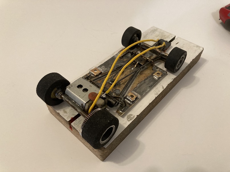

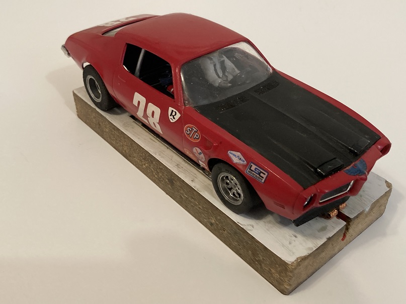

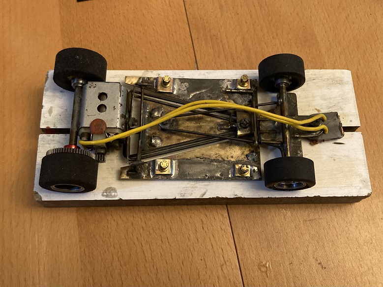

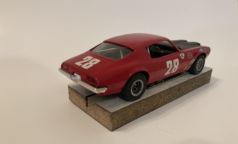

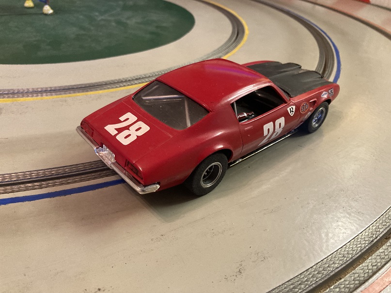

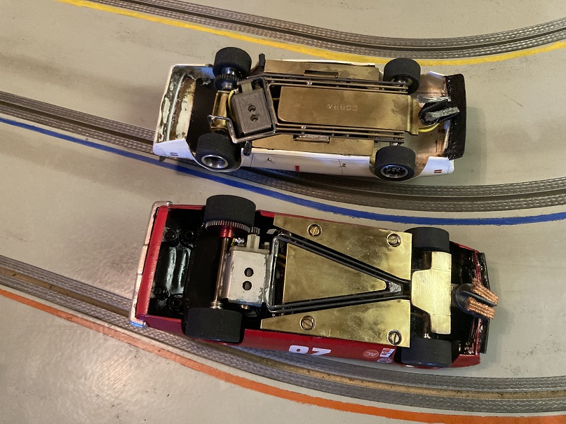

Victor sent me more MESAC parts to build another MESAC TransAm car.  The parts came out of MESAC member Chuck Hooton's box.
I compared the wheelbases of about five pony car models, and the second generation Firebird fit just right.  The wheelbase measures about 4 1/8".

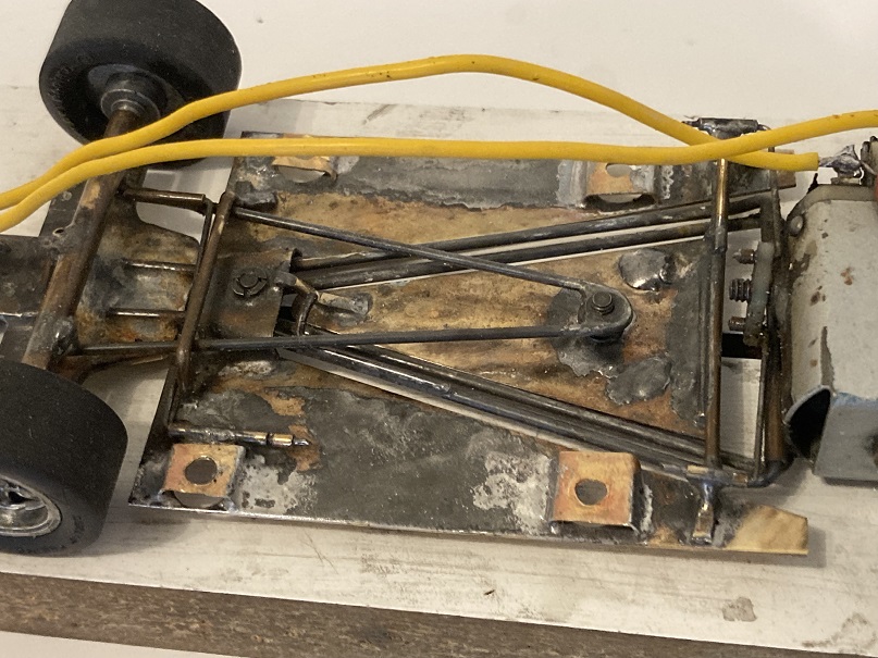

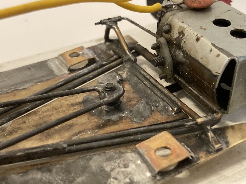

The chassis is one of the most complex slot car chassis we have ever seen.  It even has a Watts linkage!
The chassis as found was tarnished and almost black in color.  I cleaned up the chassis and added the missing body mounting provisions.  All of the running gear was retained.  The tires on the Russkit wheels were replaced.  Gears are the original Welduns.  Axles are aluminum.
Time for a track test.  Thanks, Victor.

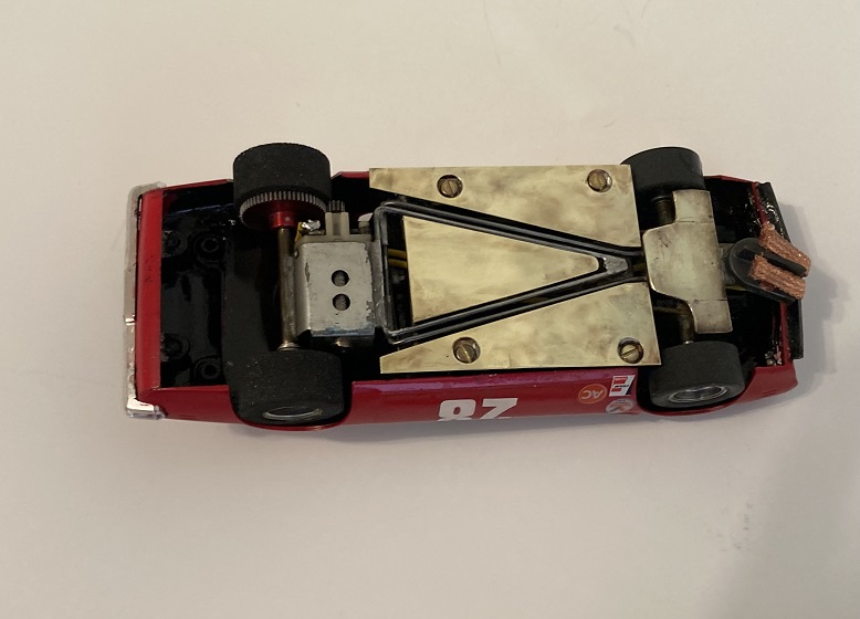

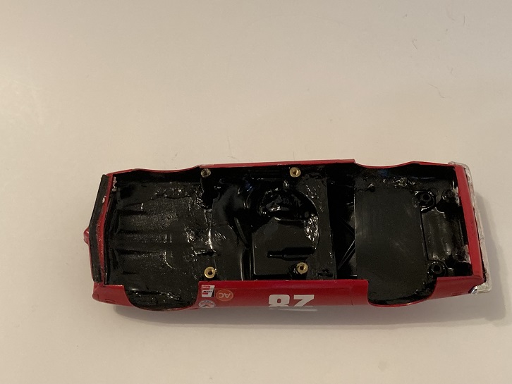

The original issue body has TransAm fender vents and a Formula hood.
Shown with body post nuts trial fitted.
Watts-style linkage.
Body posts.

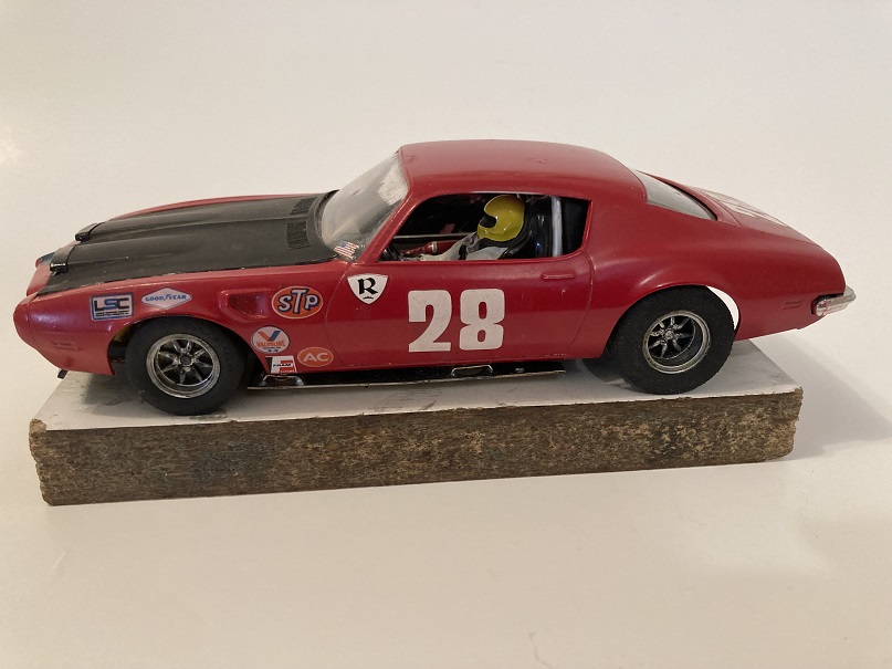

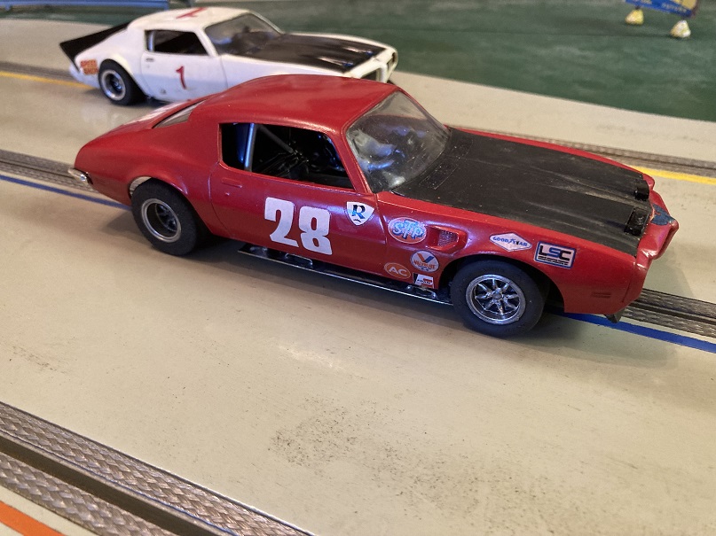

The Firebird is fun to drive and handles great.  It oversteers slightly when pushed.  There is lots of body lean in corners.  The motor is crazy fast with good brakes.  This is amazing since there are light tension motor springs with no heat sink posts.

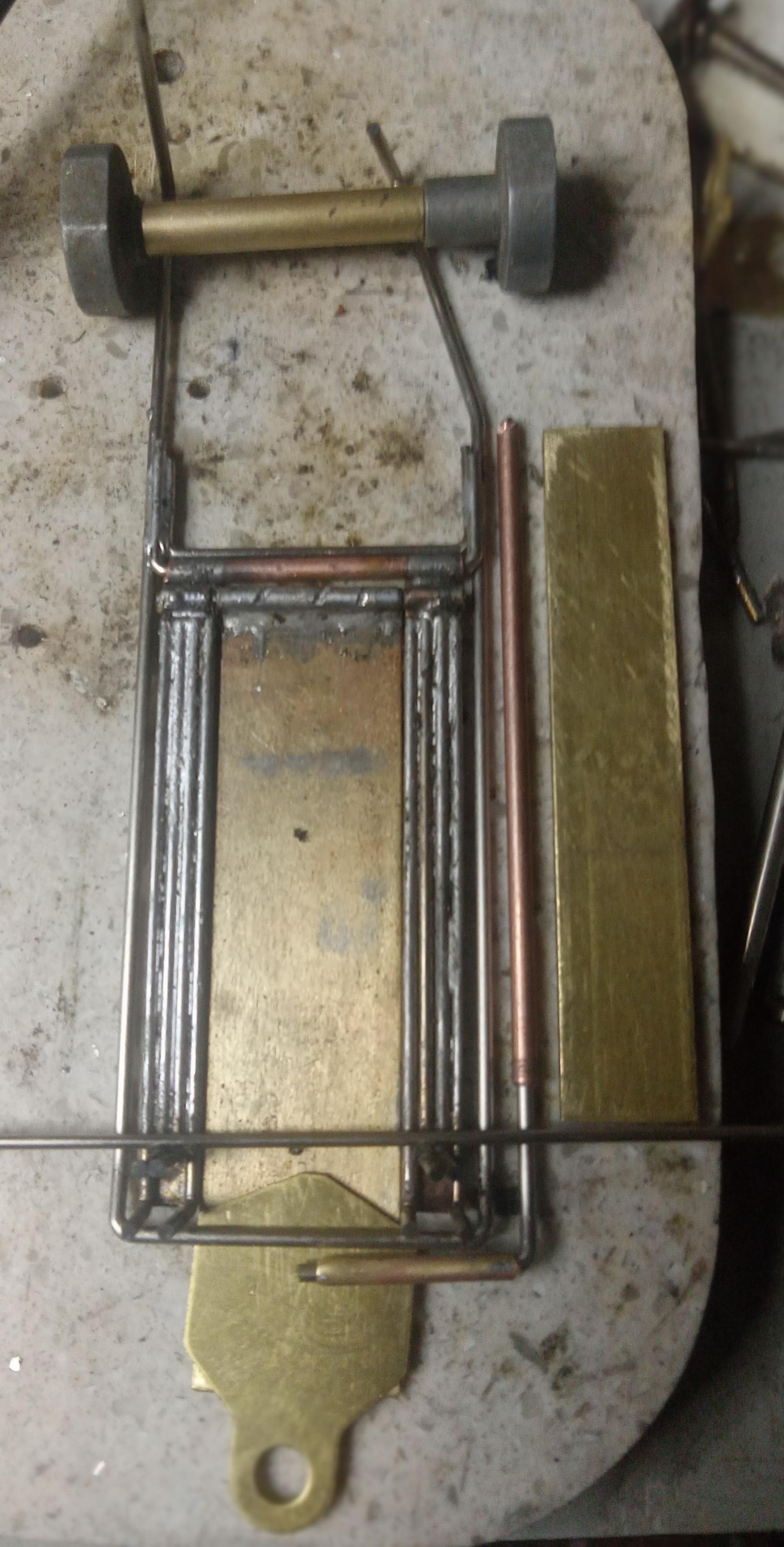

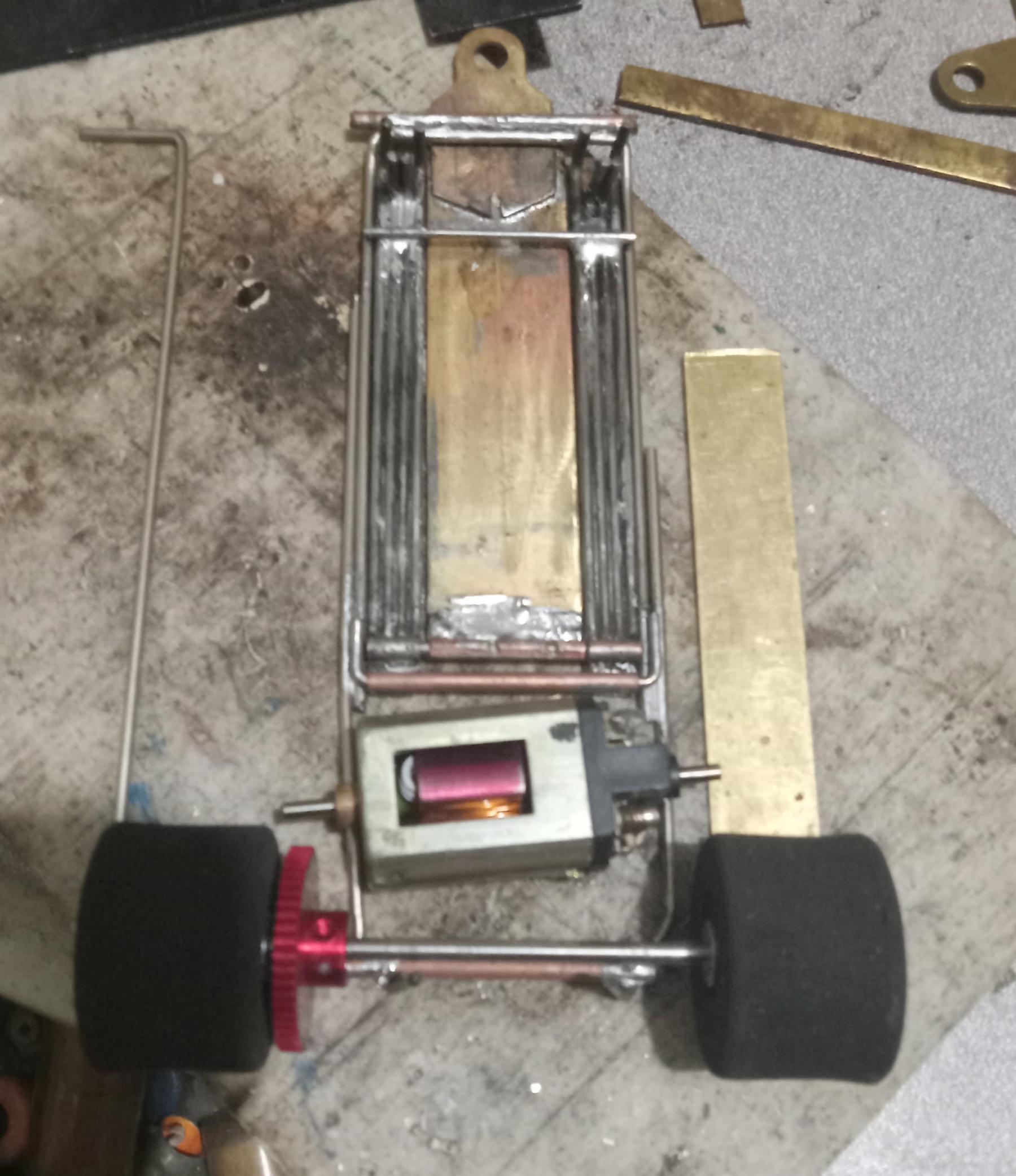

Here's as far as I've managed to get. I'm going for #4 as soon as I get a new jig.
Ps: I stuck a Mura G20 arm in this and it is louder than a dentists drill

Mark, could you post a closer pic of that endbell? and what about magnets?
I love 13UO a lot!
Maurizio Salerno
#8 Mark Onofri
  • 3,034 posts
Posted 12 June 2026 - 05:14 PM
It's got stock magnets and endbell. I just hog'd it out to fit the G20 com. I've been thinking about putting in a set of physics defying magnets from a 103. Maybe tonight. I also thought about C12 hardware. Someone told me that with stock magnets it'd run hot 🤔IDK.
