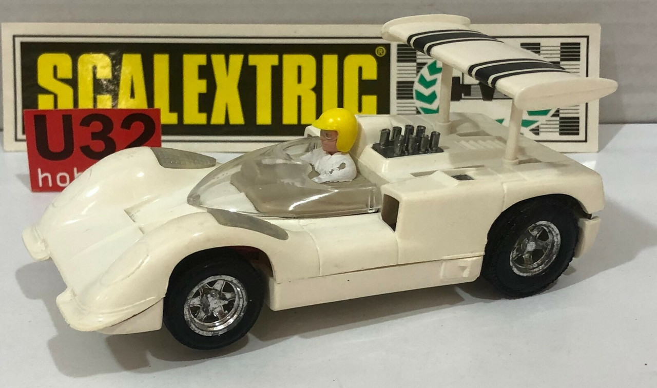

The starting point...  this is not the actual car (this is a shot stolen from "Images"),...the actual car was a bit worse for wear.

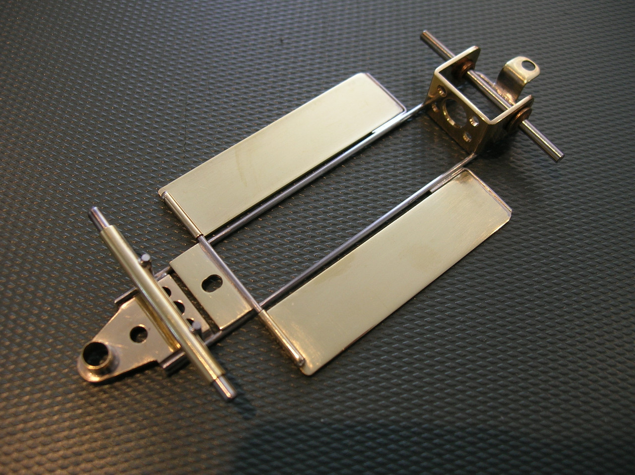

Here is the dismantled car...

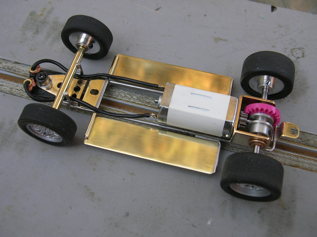

I started with the chassis (the easiest part for me), and a single rail (.047) chassis was built... it has a softish torsional flex, and handles very well with its 18K motor.
And the finished rolling chassis...

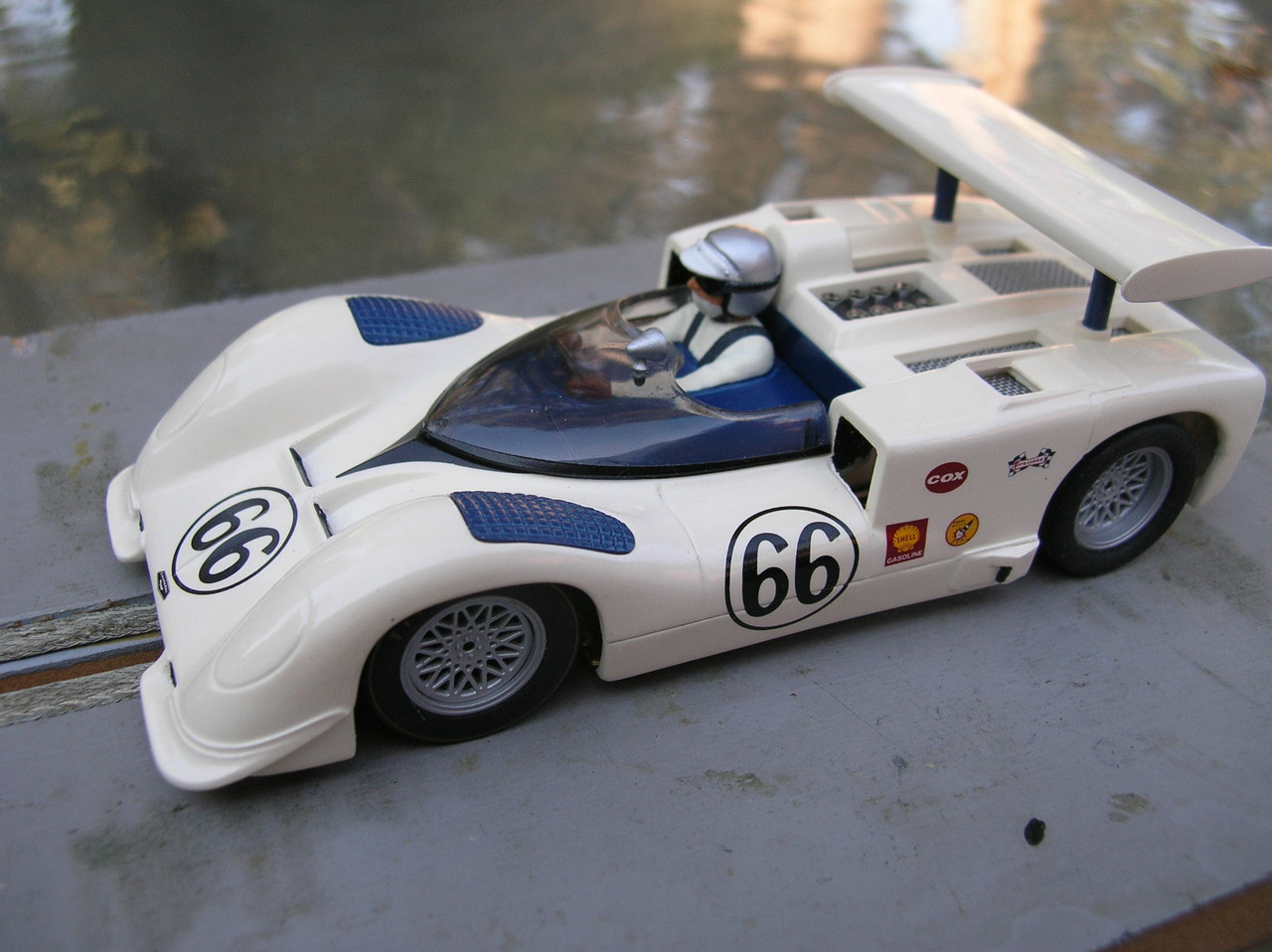

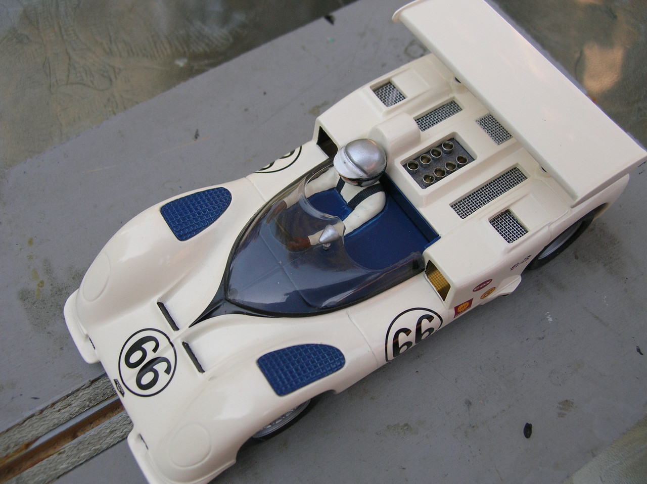

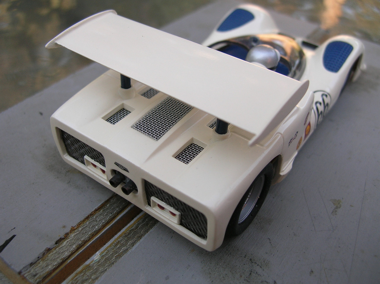

After way too much grinding/sanding/painting, and several bits made/added, I ended up with this.
The mesh on all the intakes/vents is from a Dollar store strainer... looks a ton better than the stock plastic molded bits.

Chris, the finished car looks sharp. The chassis is your usual excellent chassis work.

No Hinges anywhere Mark,.....the chassis flexes not flops  :)
