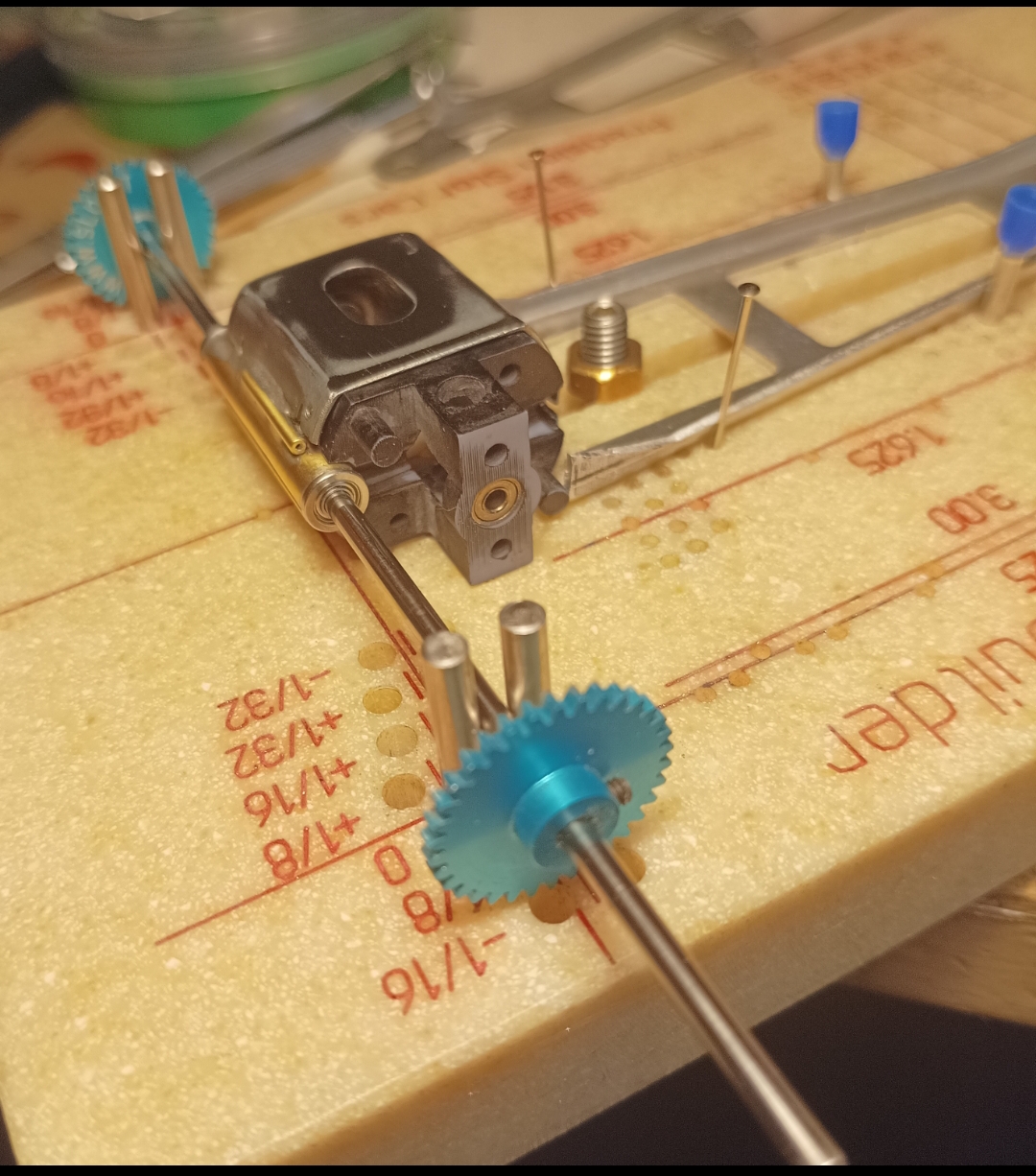

I'm experimenting with using a long armature shaft and a set of gears at each end of the motor, just to make sure the axis is parallel to the armature... (Rick Thigpen's way).
  • Alchemist likes this

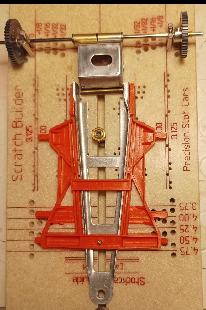

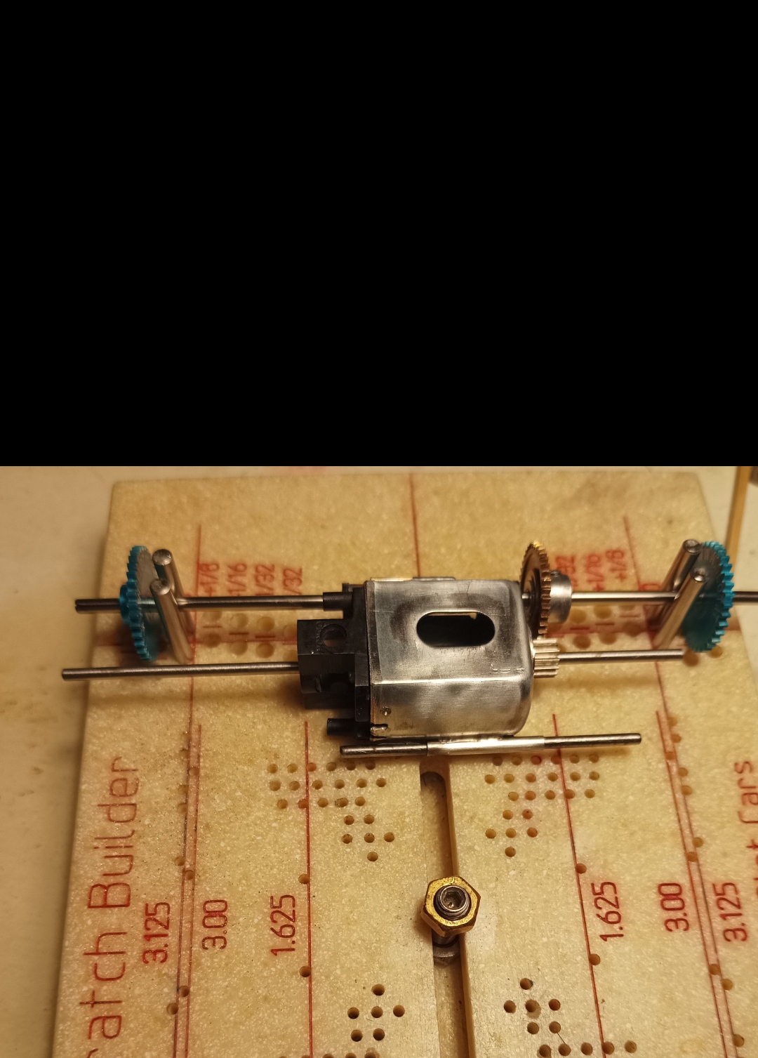

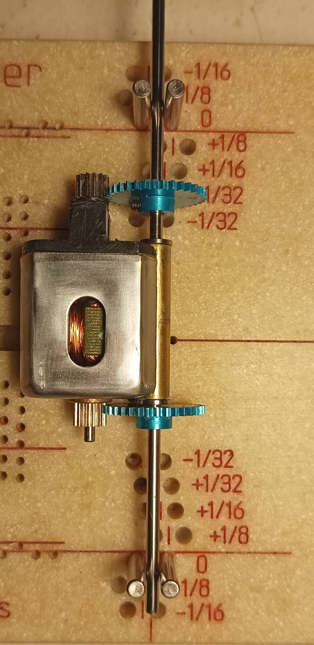

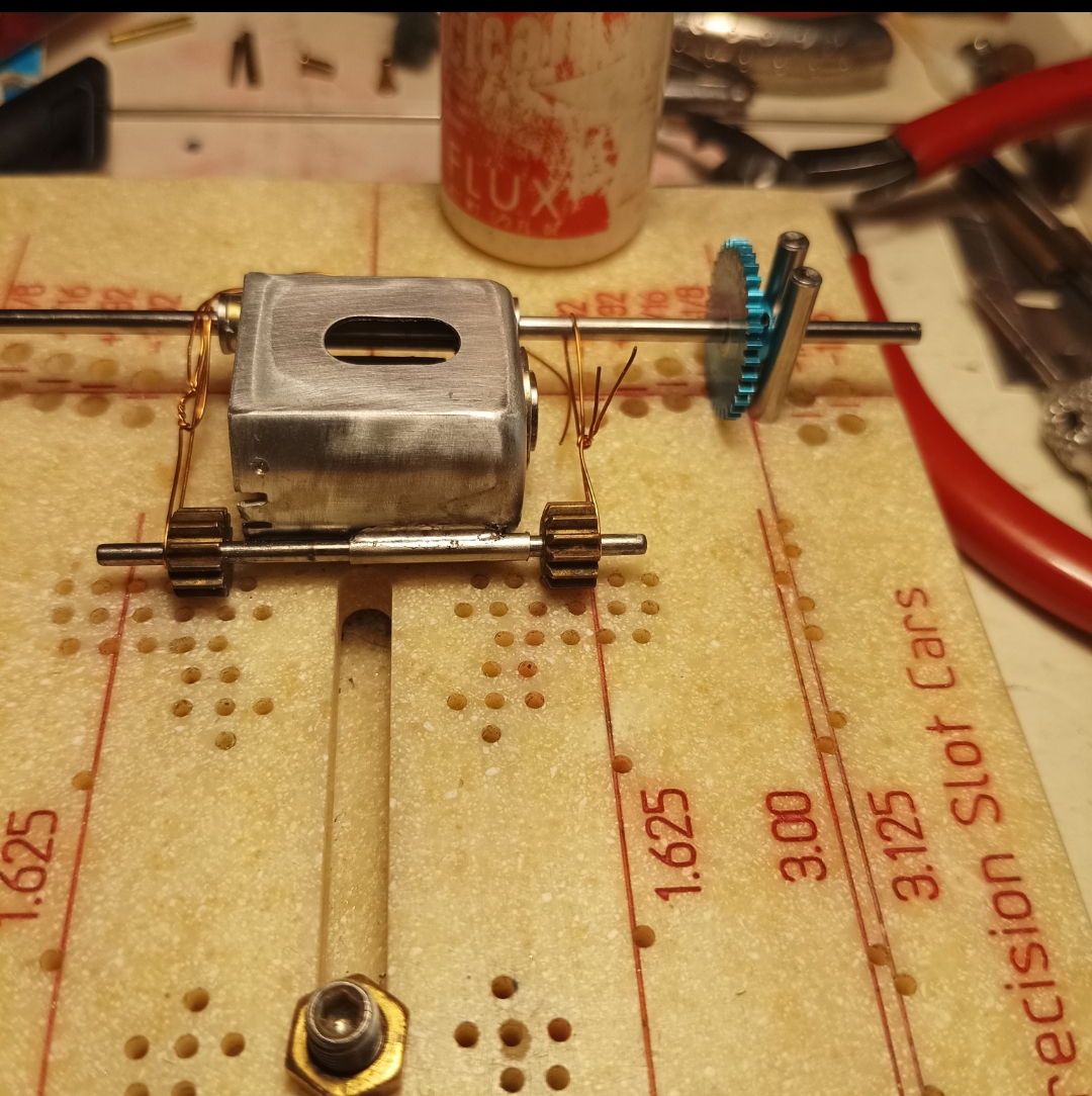

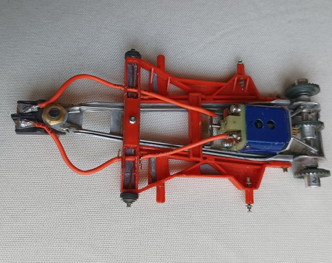

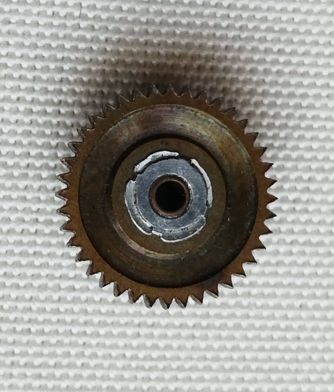

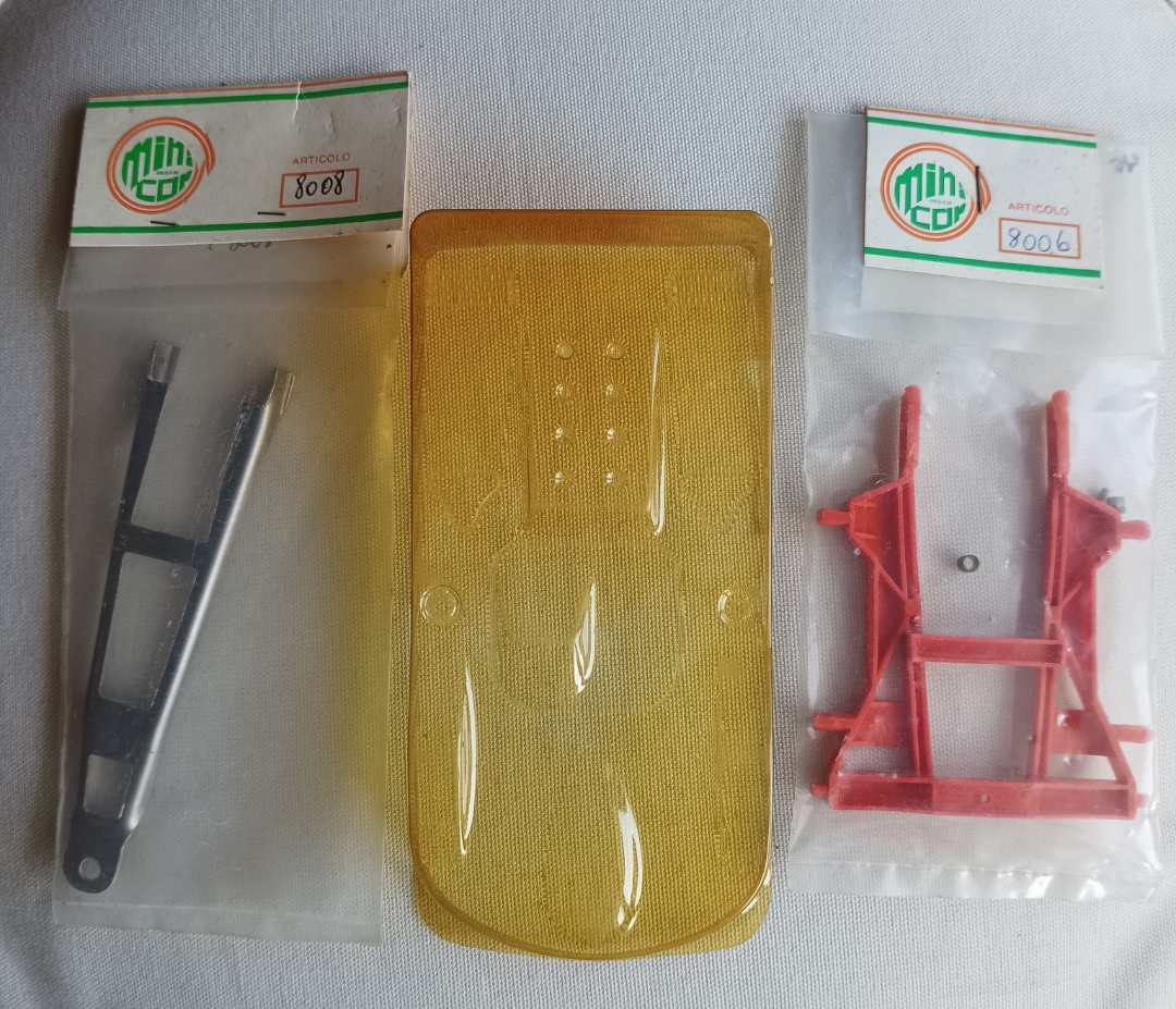

Update: I've had to put the project on the back burner. I'm currently waiting on some 64-pitch Sonic spur gears from a few buddies so I can dial in the perfect gear ratio.
In the meantime, I raided the Mini Dream Car spares box -a true treasure trove of wonders and horrors - and took the opportunity to finally wrap up this "bulletproof" build. Its been sitting on the bench waiting for the right motor setup for ages...

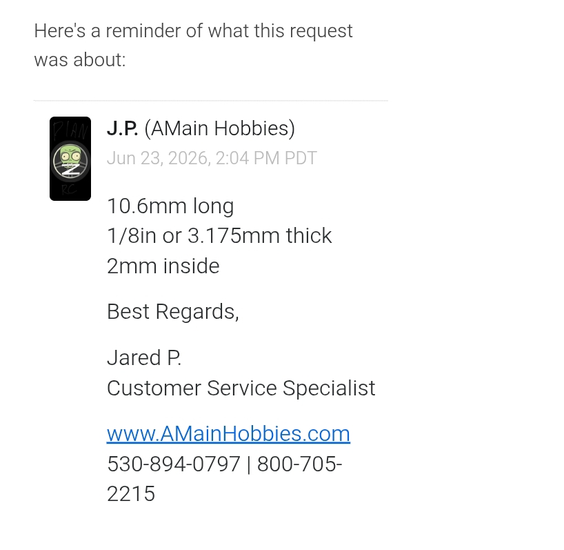

Maurizio, if you can use 1/8" axles, here is a bit of trivia Mike Swiss turn me onto.  In the US, RC pinion gears are made for 1/8" motor shafts with 64P. That being the case, here is a link to an almost limitless number of spur gear options for you. I might add that I've used these gears myself and they are very durable and well made.
https://www.amainhob...-464046/p893730
  • Jaeger Team likes this
#11 Bill from NH
  • 15,380 posts
Posted 18 June 2026 - 12:33 PM
That page also has a 1/8" shaft reducer, but it doesn't indicate the internal diameter.

Posted 25 June 2026 - 01:42 AM
  • Screenshot_2026-06-25-07-41-07-786_com.yahoo.mobile.client.android.mail-edit.jpg

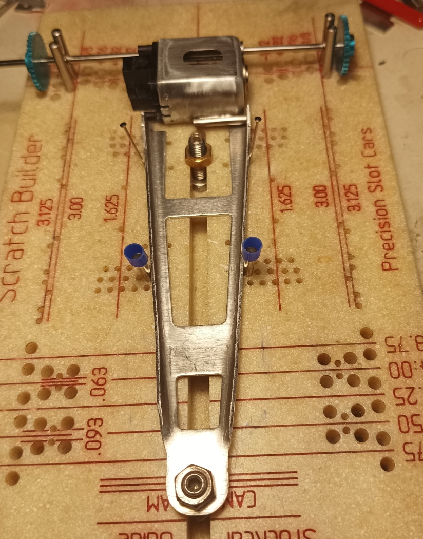

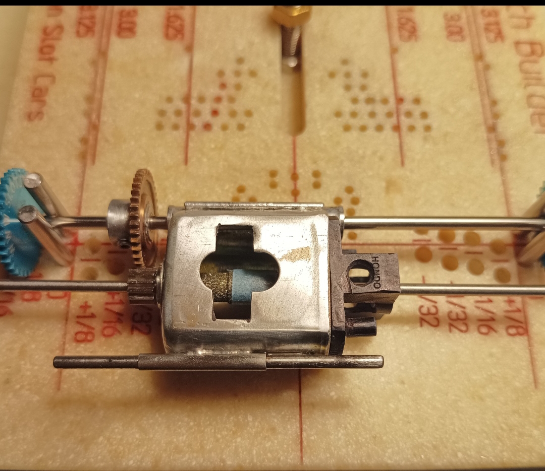

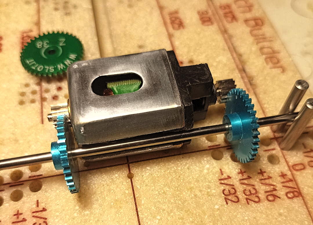

Posted 26 June 2026 - 03:13 AM

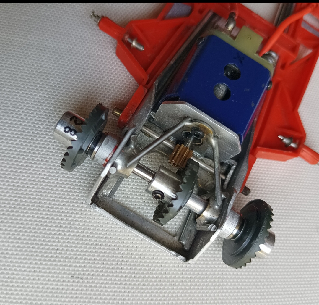

In the end, going through countless attempts and errors, Ive managed to get something here that at least looks well-aligned; now its time to work with the brush and buffer...
Maurizio Salerno
#14 Jaeger Team
Jaeger Team
  • 587 posts
  • Joined: 27-January 17
  • Location:Palermo, Italy

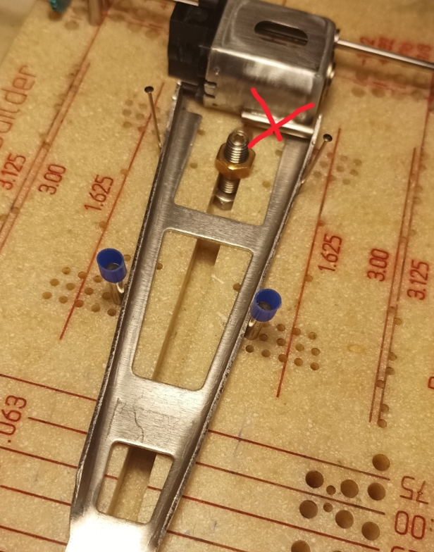

Posted 27 June 2026 - 05:00 AM

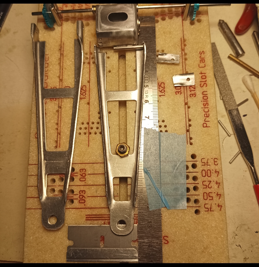

...I roughly shortened the arm to achieve an acceptable distance between the rear axle and the guide pivot...

I'm afraid it's going to require some surgical clearance...

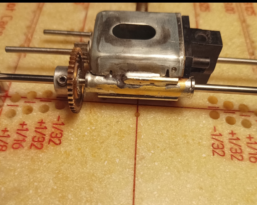

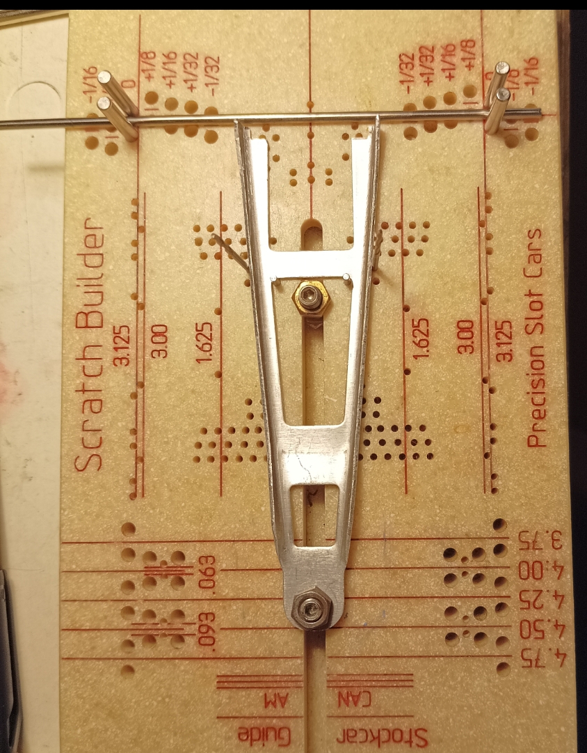

...first of all I'm going to change this hinge switching on a smaller diameter (inner actually is 2mm)
Maurizio Salerno

That's comfy...

#18 Martin
  • 4,671 posts
Posted 29 June 2026 - 12:17 AM
Looking at your hinge tube, I am wondering why it does not go full width of the chassis?
I must be missing something here.
#19 Jaeger Team
Jaeger Team
  • 587 posts
Posted 29 June 2026 - 12:50 AM
The hinge tube was originally designed that way to leave the mounting screw hole for the endbell unobstructed; now that the geometry (hinge height) has changed, there would be room to drill the can lower down. Thanks for pointing that out, Martin

Shortening this small arm, which is inherently "scalene" due to the molding process, is no simple task...

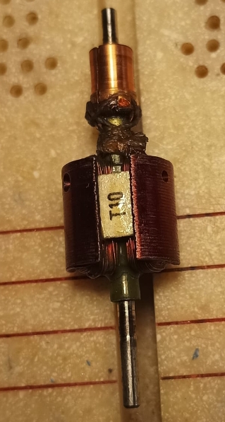

Posted 03 July 2026 - 11:14 AM

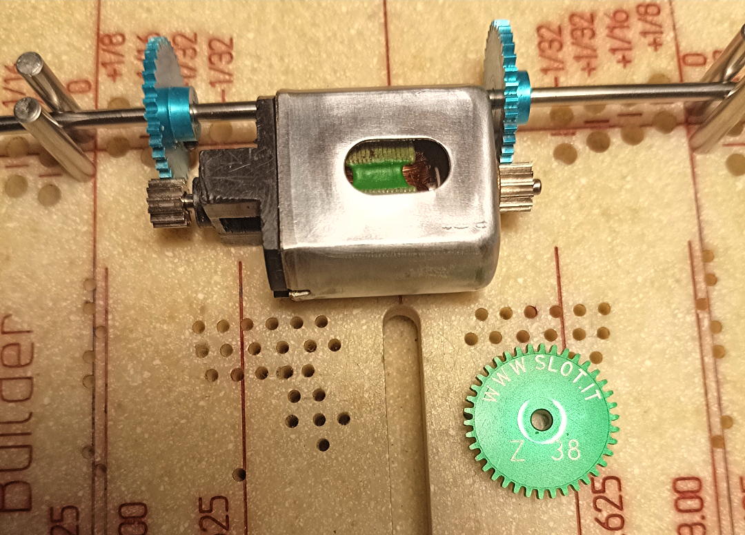

This is the armature I chose for this powertrain. IIRC, we used to use it in Parma setups for a production class (Flexi-1 chassis) back in the nineties here in Palermo.
I'm going to freshen up the commutator...

T-10s were Parma sealed motors in their Deathstar 16D setups & American-wound arms. I don't know who made the arms or what their wind was. I always suspected they were early RJR arms. Dom Luongo may know. The local raceway got some T-10s in the late 1990s or early 2000s. They ran fast. Once they were no longer available, the raceway switched that class to the Proslot Speed FX 16D.
Back in 2010, Ron Hershman said the T-10 was wound by Mura with 80T of 32 or 31 wire.

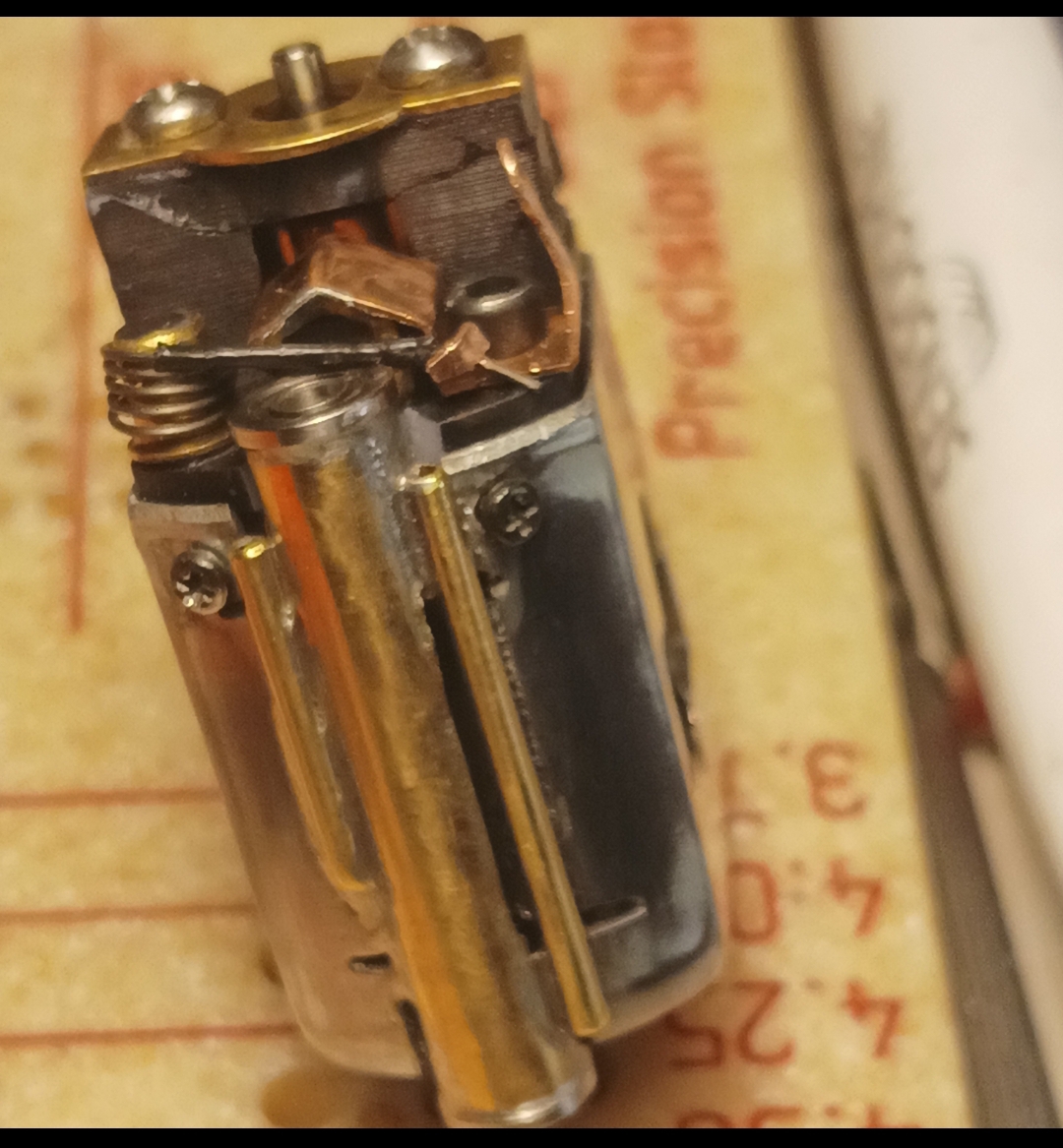

Posted 04 July 2026 - 05:48 AM
Heres the motor, all broken in... It was a real hassle setting the brush spring tension on this hidden brush, and I even had to shave down the brush hood itself just to get enough clearance. On top of that, being the clumsy oaf I am, I dropped the motor on the floor. The endbell, which is a 3D-printed repro, cracked so I had to jury-rig it back together as best I could. Anyway, this baby is pulling a 1.32 amp draw at 6 volts...

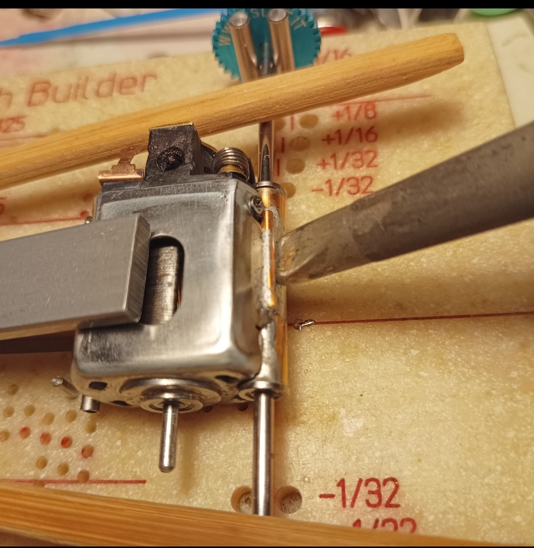

Posted 04 July 2026 - 07:58 AM
...the final touch with the powerful Weller to relax and finely realign everything...

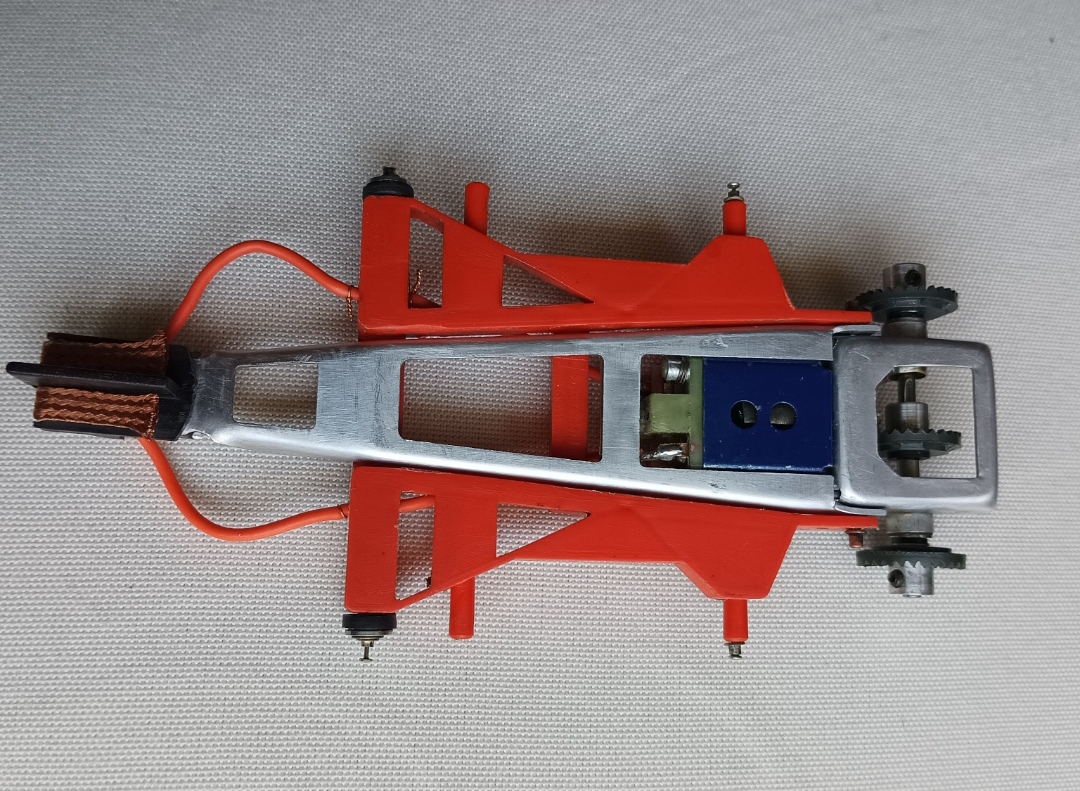

Posted 04 July 2026 - 12:11 PM
The plastic pan has been shortened to fit the arm; additionally, the original hole was filled with baking soda and cyanoacrylate glue so I can lower it for a (near) perfect match. I have to be careful to drill slowly and by hand, because this 3D-printed material melts if you so much as look at it...
