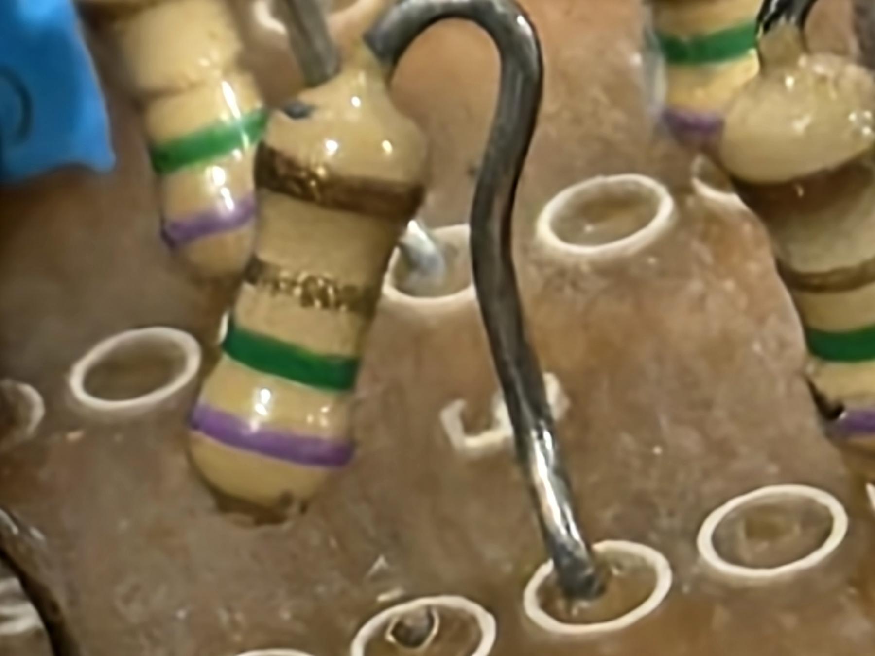

I have been using a older 2011 era genesis difalco controller that was gifted to me when i got back into slot car racing recently.
It is the kind with fixed individual resisters soldered to the board.
It was too on and off for my brushless cars and setting the brakes to full off and the sensitivity to full low, as google suggested to do, sort of fixed it for my 3000kv car made it easier to drive.
Then bought a 6500kv car and it was terrible to drive and kept coming off as slow down for a corner and then back on it and there was nothing and then bang was everything.
Thought the control being sol old was not suited for brushless cars, so i bought a 1350A mid america controller which i am yet to actually try out.
While i was at the track on the weekend another racer had the same old controller and was running a 6500KV wing car and was flying around the track with no problems.
Which lead me to check my control as there must be something wrong with it.
Found that the number 4 resistor is broken and not making contact at all.
Would this cause the control to perform like that?
Google said to just join it with a wire to number 5 for a short term fix, would that work and ok to do?
Would replacing that resistor with one of the same value actually fix the control for use with brushless cars and then i wouldn't need the 1350A, or should i keep the 1350A, fix the difalco and use it as a spare controller.
I have no pic of it, i will take one tonight when i get home and add it to the post tomorrow if i can that is.
Yes it would.
Because with the broken resistor, the controller is not functioning in the lower (slower bands), so it is only becoming 'active' from the 'band' the 5th resistor is connected to and onwards to full power.
Kinda like the 'throttle' only starting a 3rd of the way into the power band,... so quite a sudden and abrupt power delivery. Obviously, when trying to drive slowly, if the wiper goes below the 5th resistor band, it is no longer functioning, until the Wiper makes contact with the Brake band.
It CAN be Fixed by replacing the broken resistor with another of the Same value, which if everything else is ok, it should once again perform like a normal controller :)

Yes it would.
DiFalco's work great with Brushless cars.
Depending on your track voltage and motor kv you may develop issues with the standard (Economy) Brake Pot, although so far, I have not had any.
Hope that helps but as suggested it IS easy to contact Jim DiFalco either here on Slotblog or via his website and from my limited experience, he appears to be very friendly and helpful !! :)

Damian, if you or your track has an ohmmeter just measure one resistor right on the circuit board and that will tell you what to replace it with. 1/4 watt is fine for the size. Did you remove the old resistor? If not un-solder it and remove the short lead that is in the circuit board. Now cut the wire lead that is sticking out of the resistor, bend it in half and solder it in the two holes that the resistor came from and this will restore the controller function.

adding a jumper to replace the resistor will just result in the sensitivity jumping to the next wiper band and not full power or a dead band. Yes, all resistors were the same, possibly 3.9 ohms each if it is a really old controller.

had a look and a search and it seems it is a 7.5ohm resistor.
Also used a multi meter and got 7.5ohm also.
see photos attached, hopefully they worked.

Yes i did and i tested it Saturday and it worked whoo hoo.
They were all 7.5ohm resistors, i couldn't get them without buying a full set of over 500 resistors.
So i replaced the first 2 with 12ohm, then the next 3 with 10ohm then that is all i had time to do before i went to the track to test it.
It worked great, it was hard to believe this entire time i was driving without the first 4 bands working, i just assumed it was the way the older controller worked with brushless cars.
I actually dropped my lap time 0.2 too which i was surprised about.
Last night i changed the rest around, and will test it out in 2 weeks.

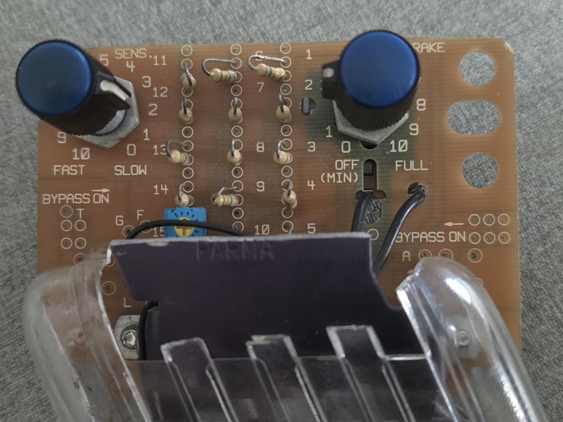

So the control is now as below.
Bands 1/2 are 12ohms
Bands 3/4 are 10ohms
Bands 6-9 are 8.2ohms
Bands 10/11 are 7.5ohms
Bands 12-14 are 4.7ohms
Band 15 is the factory trim pot set at 24ohms as that is what it was set at.
I bought a new 68w digital temp  soldering iron station, wow much easier than a hand held pen type iron that is for sure.
Thank you to all for the help and to Jim for sending me the instruction booklet for this controller, it's not one that can be upgraded with the 30 band upgrade though.

Interesting you have now also changed the 'Curve' of the controller, compared to how it was.
I would probably have tried it prior to making such a change but if it's working for you and you are happy, then it's all good :)
There is no way to try it without actually doing it though.
Unless you meant try the controller with the first changes first?
If that is what you meant then yes, i did try the controller with the first 4 bands changed to 12,12,10,10.
It worked great, i could feel the drop from the 10 to the 7.5.
I'm hoping the new changes will make that drop less noticeable and a more smoother curve. It does have the adjustable trim pot which i can use to tame the curve a bit more if needed.
If it does not work i can just unsolder them all and put all 8.2's back in as they are much easier to get a hold off than the 7.5 that were in there.
Looking forward to getting back on the track in a fortnight.
