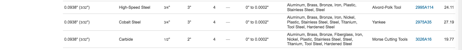

OK... depending how exact you want the fit, I'd start off with a .0938" (3/32") reamer for a possibly tight slip fit or .0940" for more of a slip fit. How close to the axle size do you want? Be aware reamers are sized nominal size up to +.0002".
McMaster-Carr has them. They might be expensive but they'll last for years in your application.
  • Fergy and Mudhen like this
