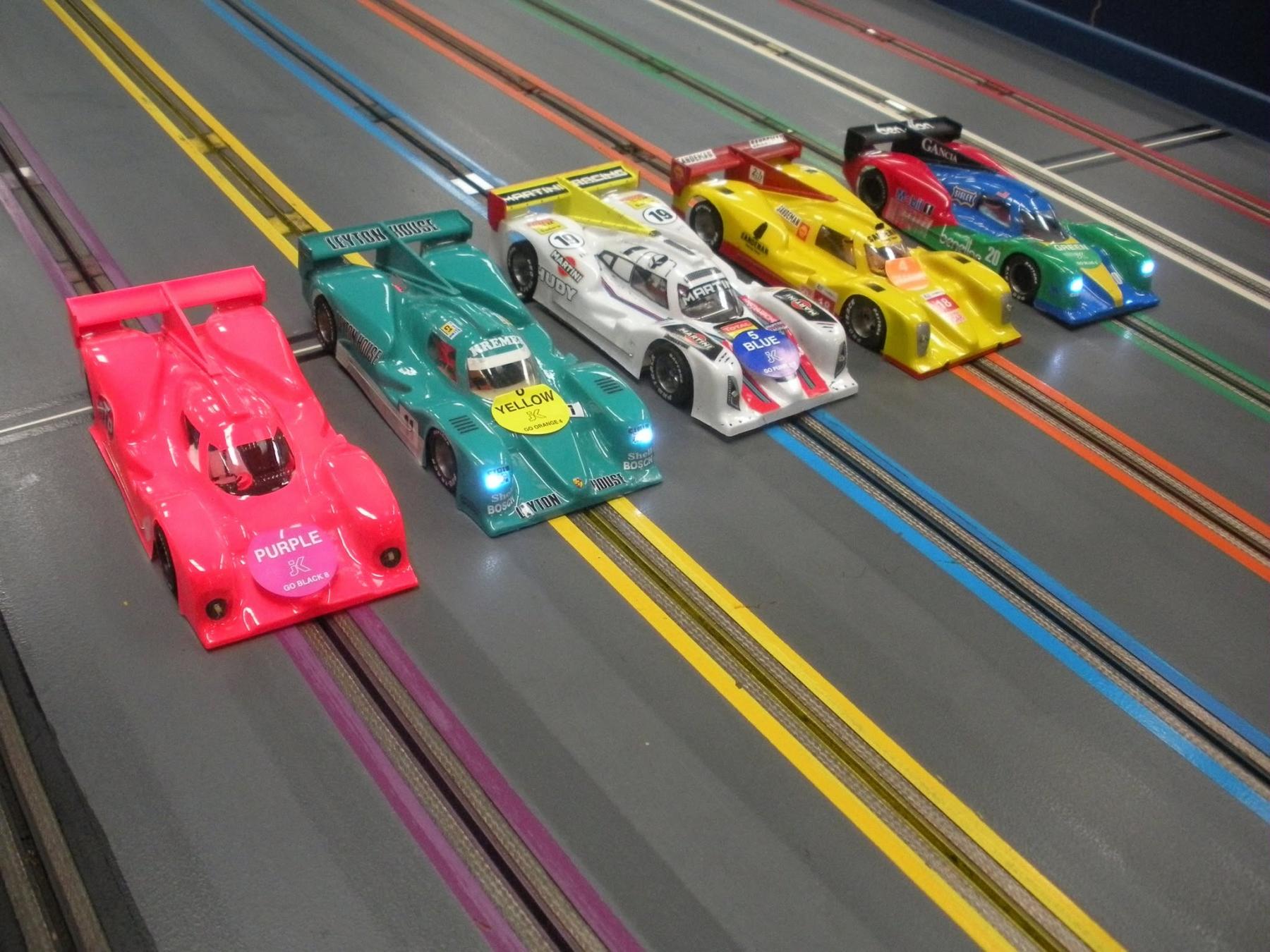

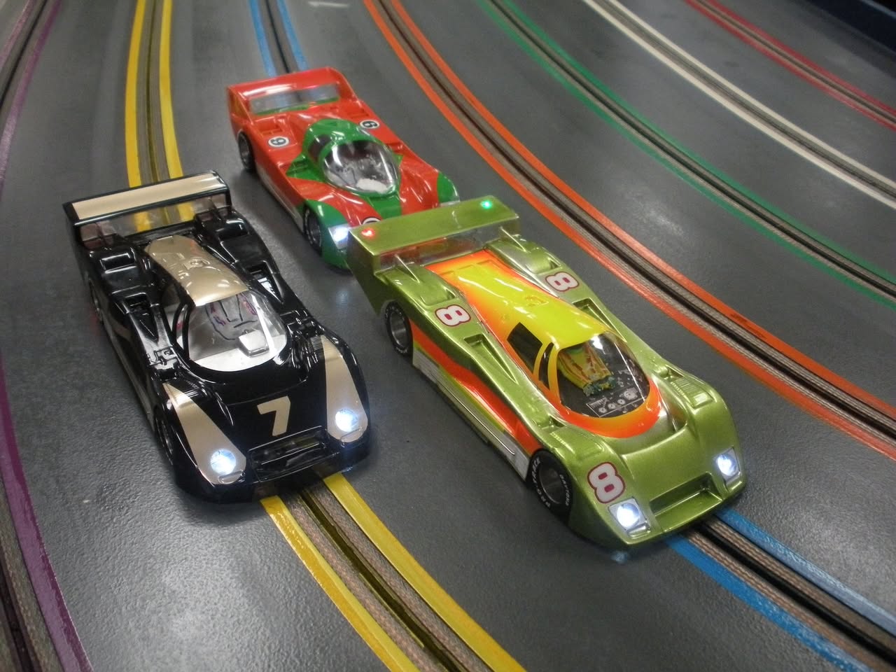

In the past, we have had enduro races with lighted cars. Everyone chose to go the 3v coin battery-powered route.
Details on the cars, the results and so on can be found on The Raceway Cleveland TN Facebook page.
Mounting for the lights is fairly easy using either flat pieces of Lexan or cardboard.
