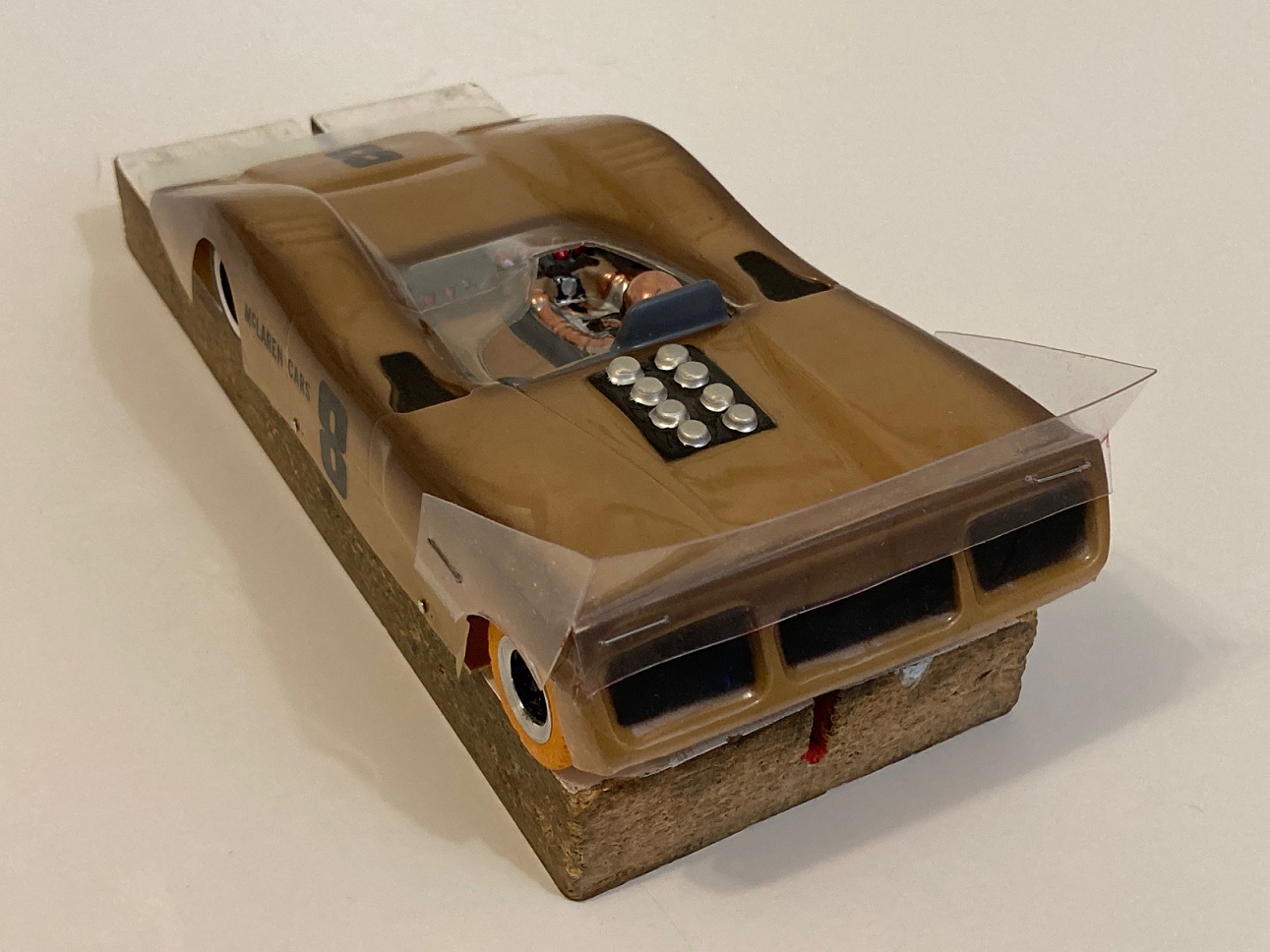

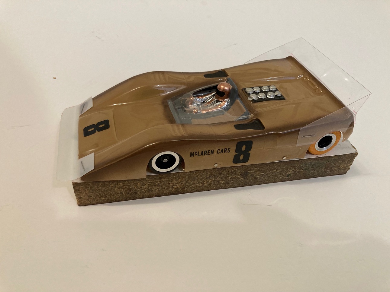

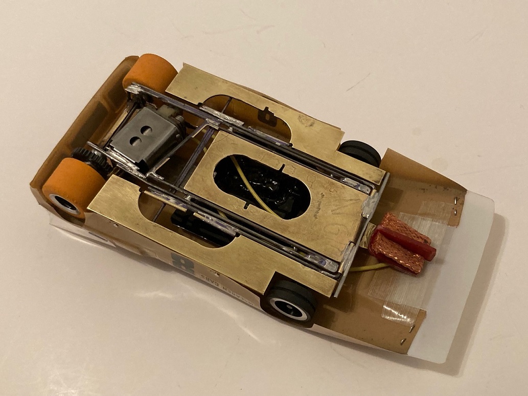

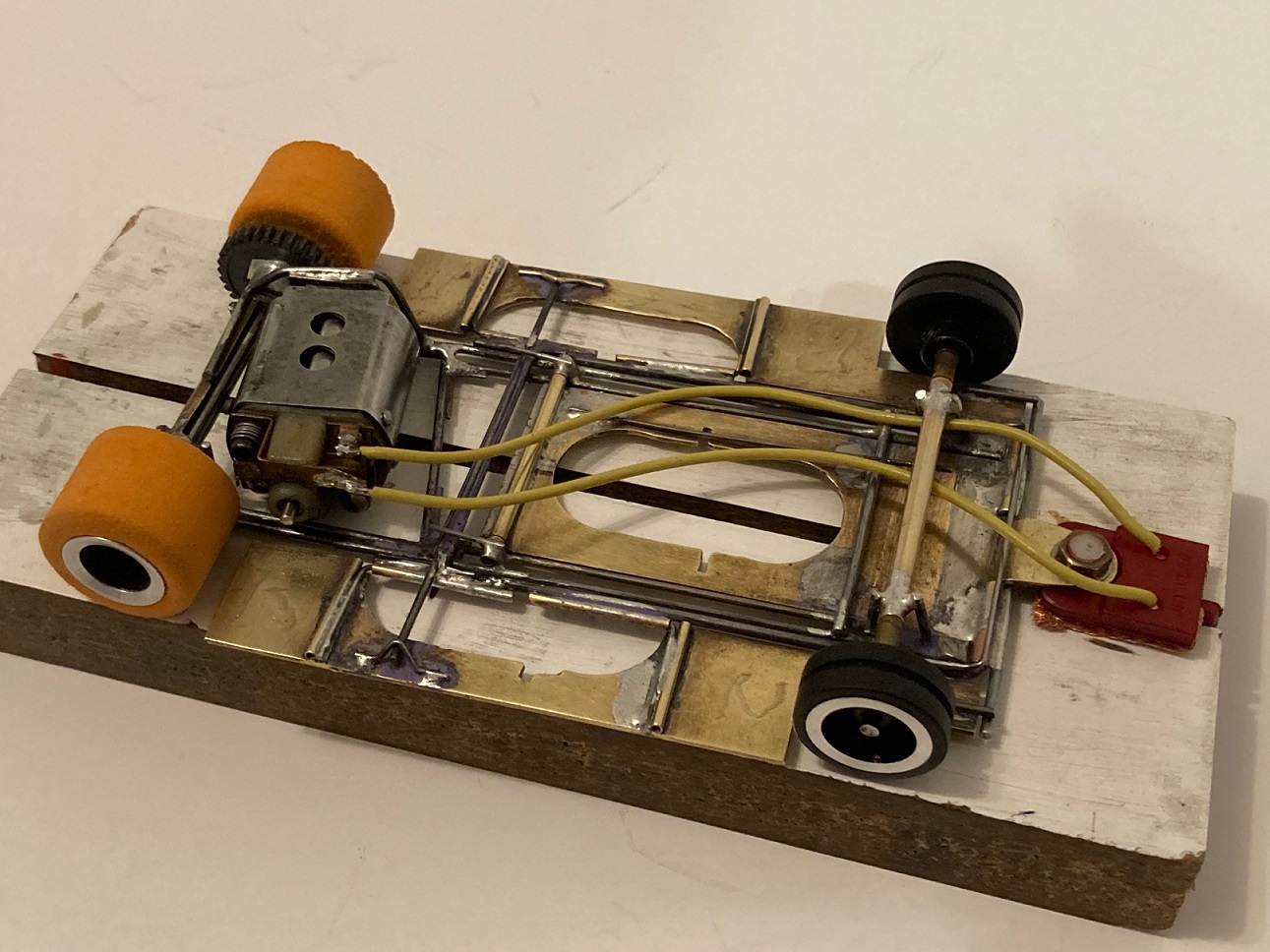

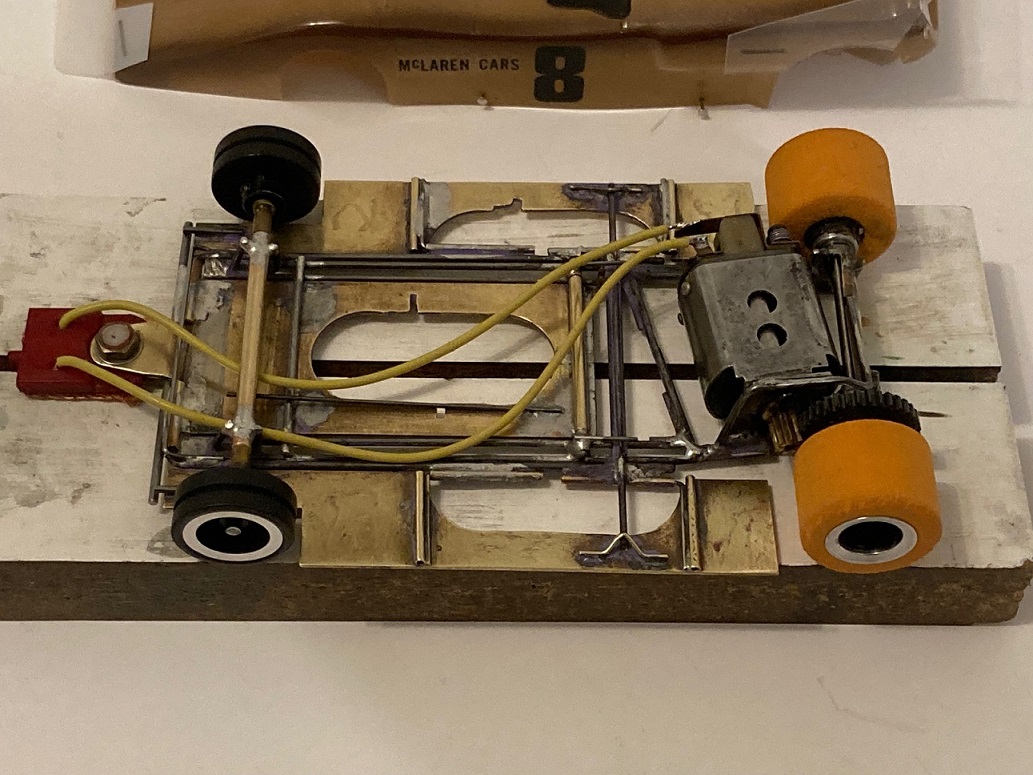

I rebuilt one of my high school and college friend's slot cars that he gave to me. Robert built the car around 1970 and ran it through 1975. The car was originally built for the monstrous 200' Oakland Speedway track.
It took me some time to rebuild the chassis. The plumber and front axle tube were missing, and the hinges were rusted shut. The chassis was also a little tweaked, so I had to keep making adjustments even after I thought everything was aligned.
The new body is a Champion McLaren Mk 8. An Aguirre air control kit was added. The interior is an AB Slot Cars brand.

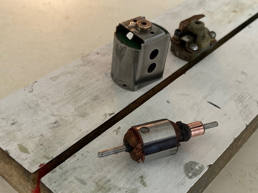

The car was originally run with an early C-can motor with a Steube 25 single armature. Robert always ran Steube armatures in his open class cars. I do not have the original motor, so I built one with parts I had available. Sorry, no Steube armatures left, so a Thorp open armature was chosen along with an early Mura C-can setup. Magnets are long Mura magnets.  he motor draws less than 2 amps on the analyzer.
Wheels and tires are Riggen for 3/32” axles. The car is geared 7/34 with a Cox spur gear. As the rules called for back then, the tires measured from edge to edge a maximum 3”. Hubs were shaved a little to achieve the 3” rear width.
Time for a track test.
Car shown with a March 1970 MCS race report.
Motor parts used.

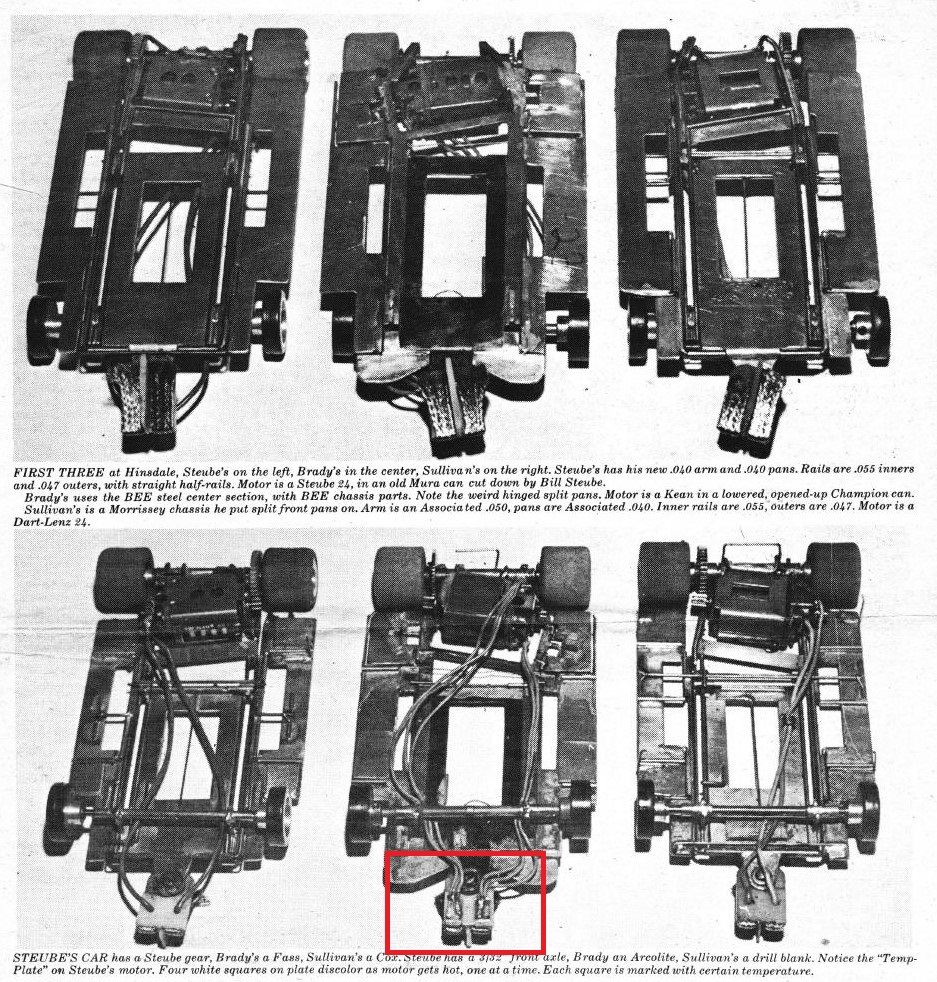

Lead wire clips: Here is the earliest documentation I've found showing their use:
It's from the Model Racing Journal coverage of the January 1970 Pro race at Hinsdale. It shows the top 3 cars 2 of which have the lead wires pushed into holes in the flag and the center car of Brady using wires soldered to clips.
This suggests that lead wire clips in early 1970 were not quite yet common practice and stuffing wires into the guide flag holes was still done. It probably didn't take long for clips to catch on as they are so much easier to work with.

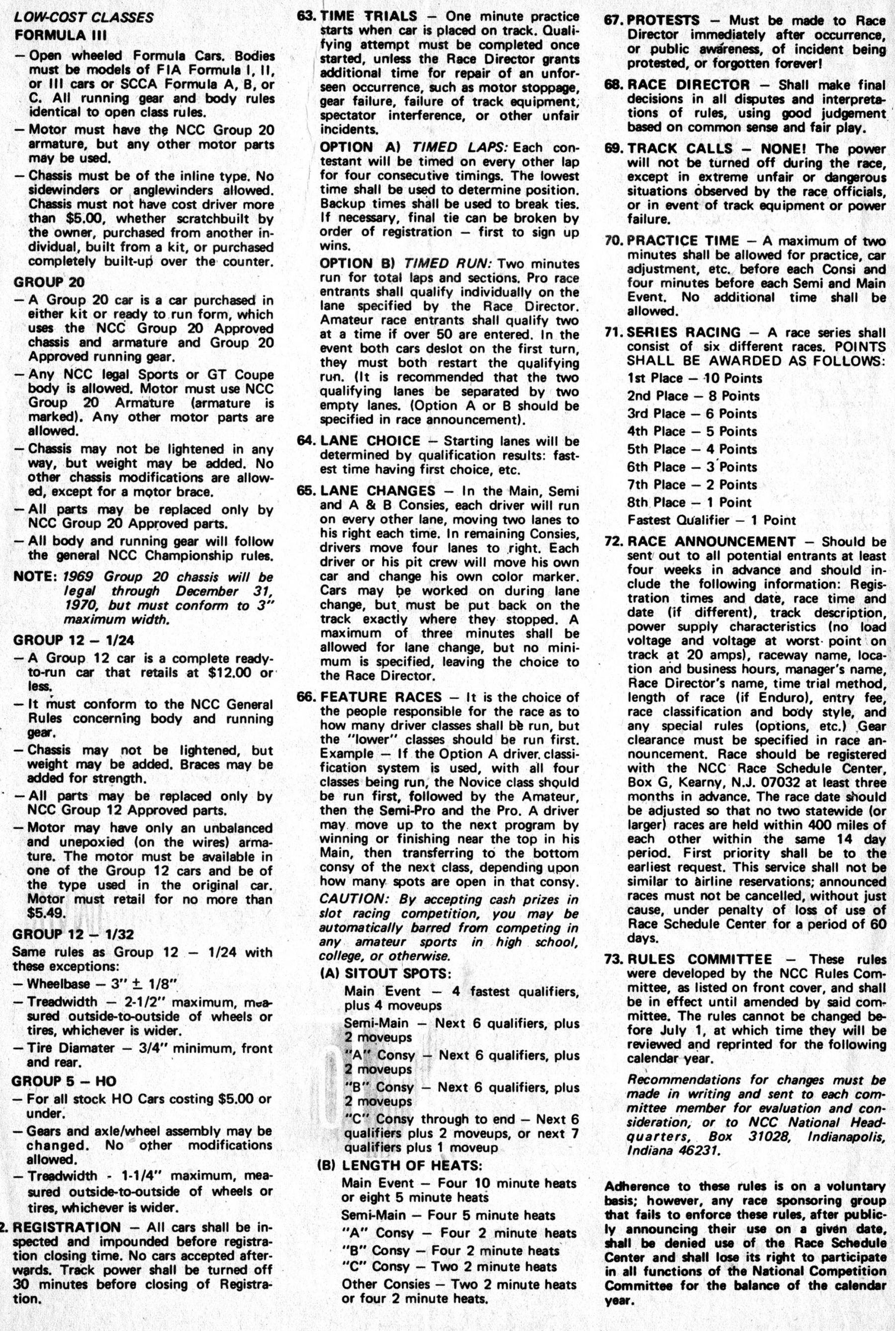

Maximum width at the wheels: Here are the NCC rules as of January 1970 showing that width to be 3" maximum:
Beautiful car, Rodney, and thanks for sharing it with us!   :good:

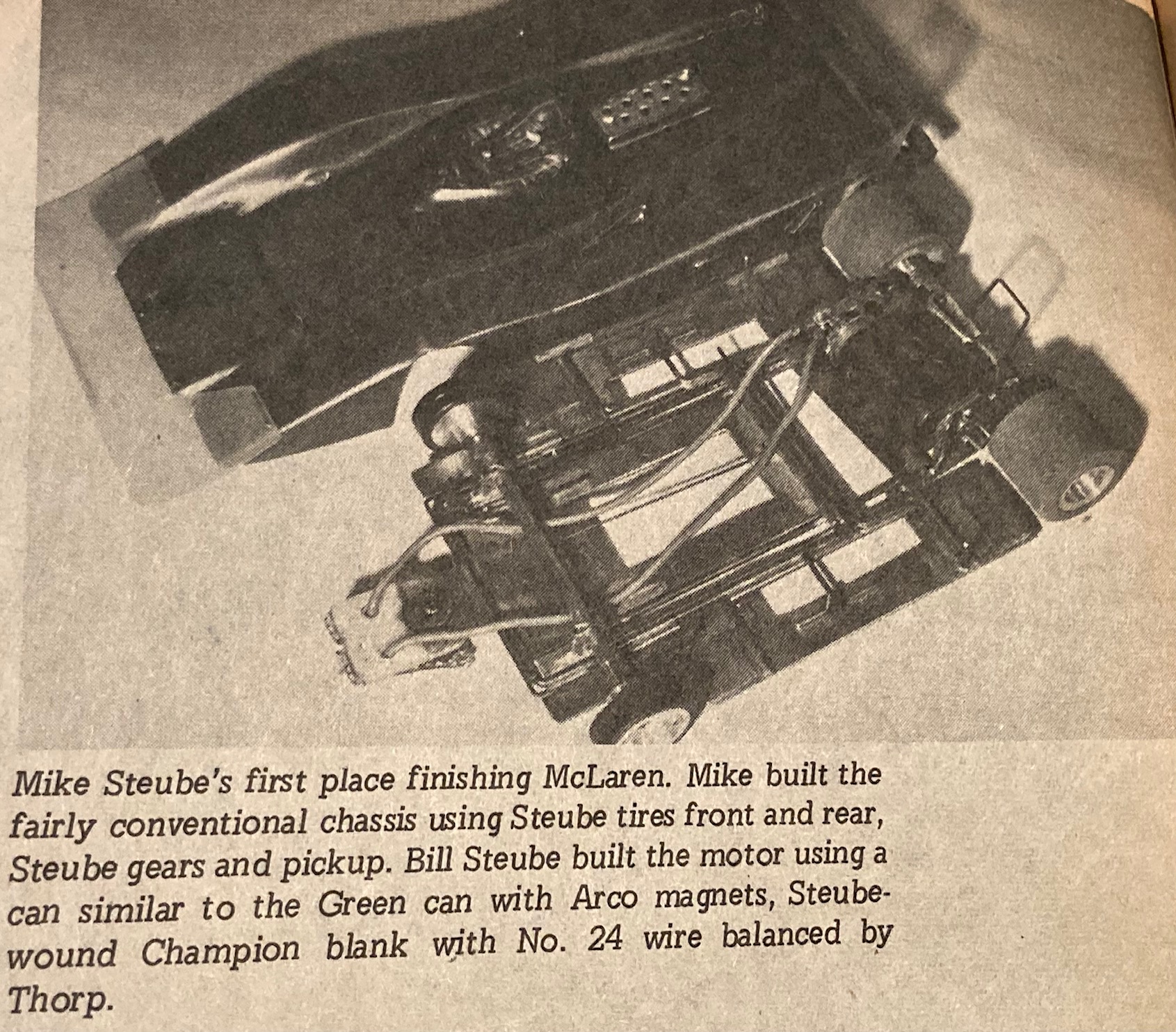

Here is a picture of a Mike Steube race winner from a June 1970 MC&S magazine.  Note the lead wires through the guide.

The car is fast and fun to drive with neutral handling.  Modern tires were used for the low track glue conditions.  The chassis has good flex and makes it easy to drive.  The steel main rail car of the same era drives more tail out.  The motor has a good torque range and is easy to drive.  Robert always built nice slot cars.
