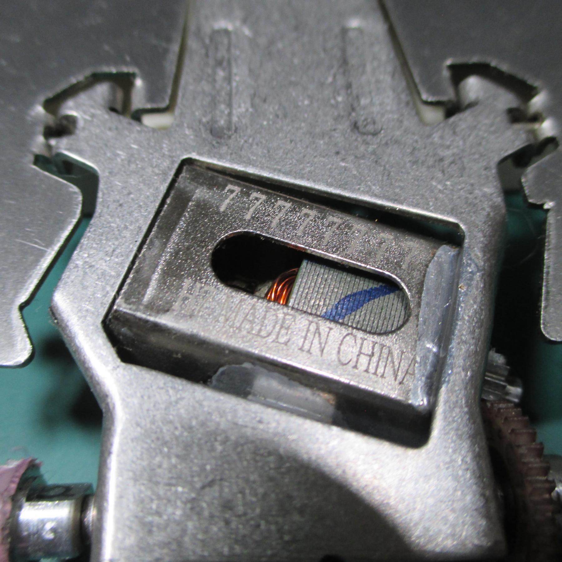

Why is the rectangular opening on a JK 1/32 C5 chassis too short for a JK Hawk 7?
The opening is .925" long and an FK can is .990" long, requiring the gear end of the motor to sit atop the lip
Am I missing something here?

Is there a reason you can't enlarge the opening?

Sure I could hog out the opening. But why would they make the opening too small for the motor it was designed for (Hawk 7)?

Are all FK motors .990?  I'm at work and can't measure one.

FK"s are all approximately .990" long.
That chassis came out 2 owners ago.
If Pablo wants, I'll give him Jerry Kulich's #.  Lol
We raced them in approx. 2013 at my last location.
I forget what motor we used.
It might have been a Hawk 6 or Proslot minimotor, which both have a real endbell and are much shorter.

Mystery solved, thanks Mike  :sun_bespectacled:

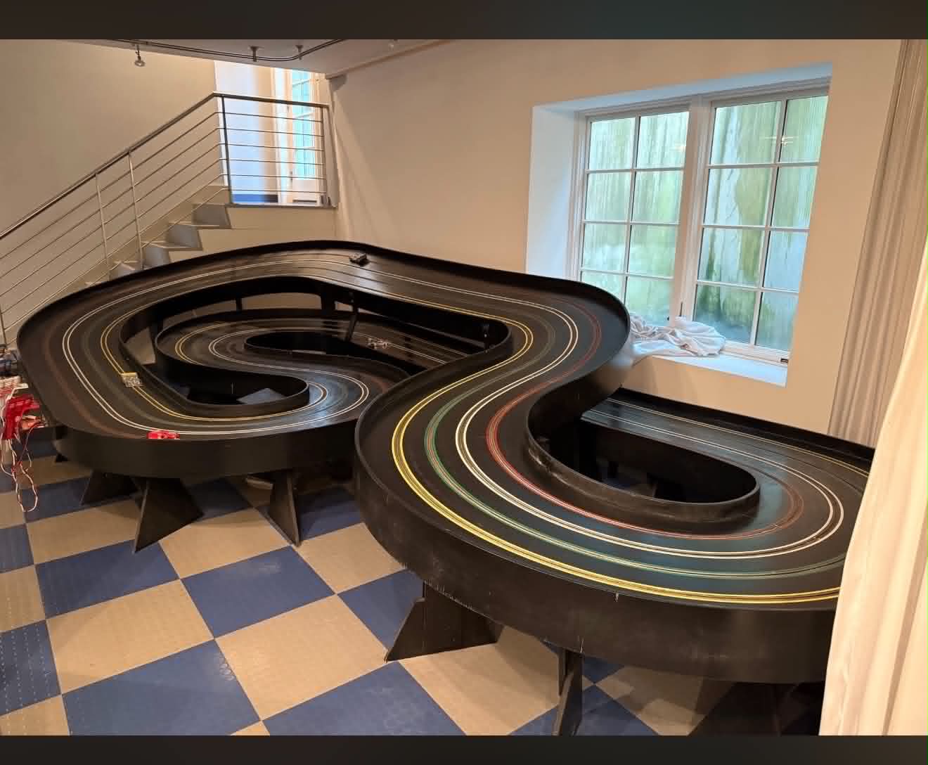

Next question - for a track like this, Hawk, or Hawk 6?
What ballpark gearing for .700-ish wheels?

#8 MSwiss

#9 Pablo
  • 18,597 posts
Posted 21 July 2026 - 03:54 PM
Track isn't set up yet. I'm just now setting up some cars for it.
Chattanooga, TN home track.
I did a Slotblog search Hawk vs Hawk 6, I'll try a Hawk 6 and gear it conservative.
Thanks for solving my quandary, now I can live happily at ground zero  :D

Posted 21 July 2026 - 05:51 PM
I haven't run a track as short as this one looks, but my gearing guess for an H6 is 4:1 min. There was an early arm for the hawk that looks to be about a 30K motor, but today the main difference is the Hawk has ceramic mags, and the H6 poly neos.
#11 Dominator
Dominator
  • 3,158 posts
  • Joined: 19-September 07
Posted 21 July 2026 - 06:39 PM
I would start with 64 pitch 10/36 then try maybe 9/35.
72 pitch 11/42 or possible 10/40.
