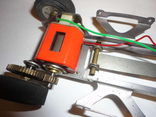

Gear ratio was 2.4:1, but not sure of the number of teeth. Still looking for my Manta Ray to check the rest.
Now that's strange: My Manta Ray was in my Manta Ray box, and not in the Astro=V box...

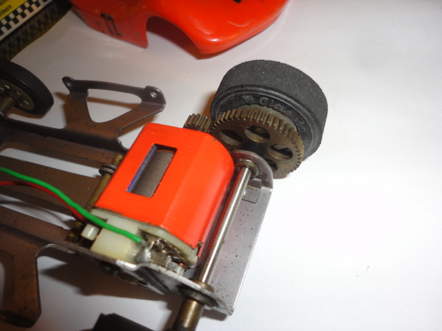

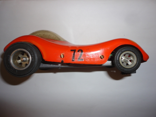

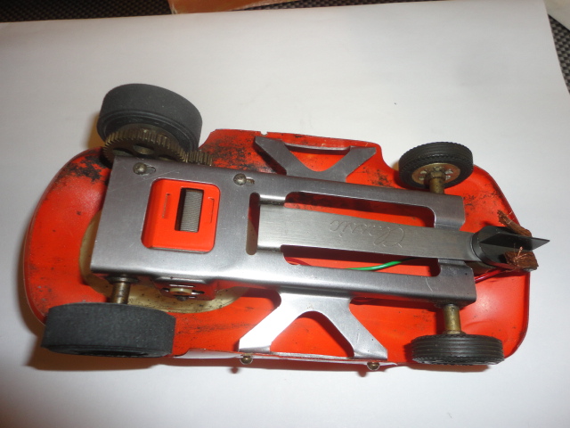

Rear tires are 1-1/4" x 3/8"; Fronts are 1" x 1/4" - on mine, which I think is original, they're both black; I think later versions had colored sponge tires. Pinion is 18t if memory serves, which would make the spur gear about 44t. I'm sure somebody here will be able to give you the exact sizes.

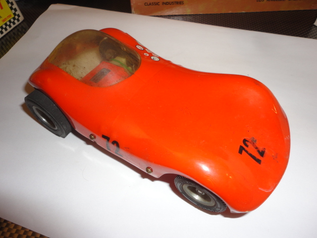

Here are some photos
  • Bridgehampton66 likes this

I think the gearing was 3:1, with a 16T pinion and a 48T spur. IIRC, that was pretty much standard gearing for a 36D sidewinder back then.
#5 don.siegel
  • 5,954 posts
Posted 21 July 2026 - 10:59 AM

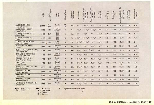

Mike, I got the 2.4 figure out of the RTR Roundup article in Rod & Custom; couldn't confirm anywhere else. Cox was 3:1 as you say, but some of the others were lower numérically as well.

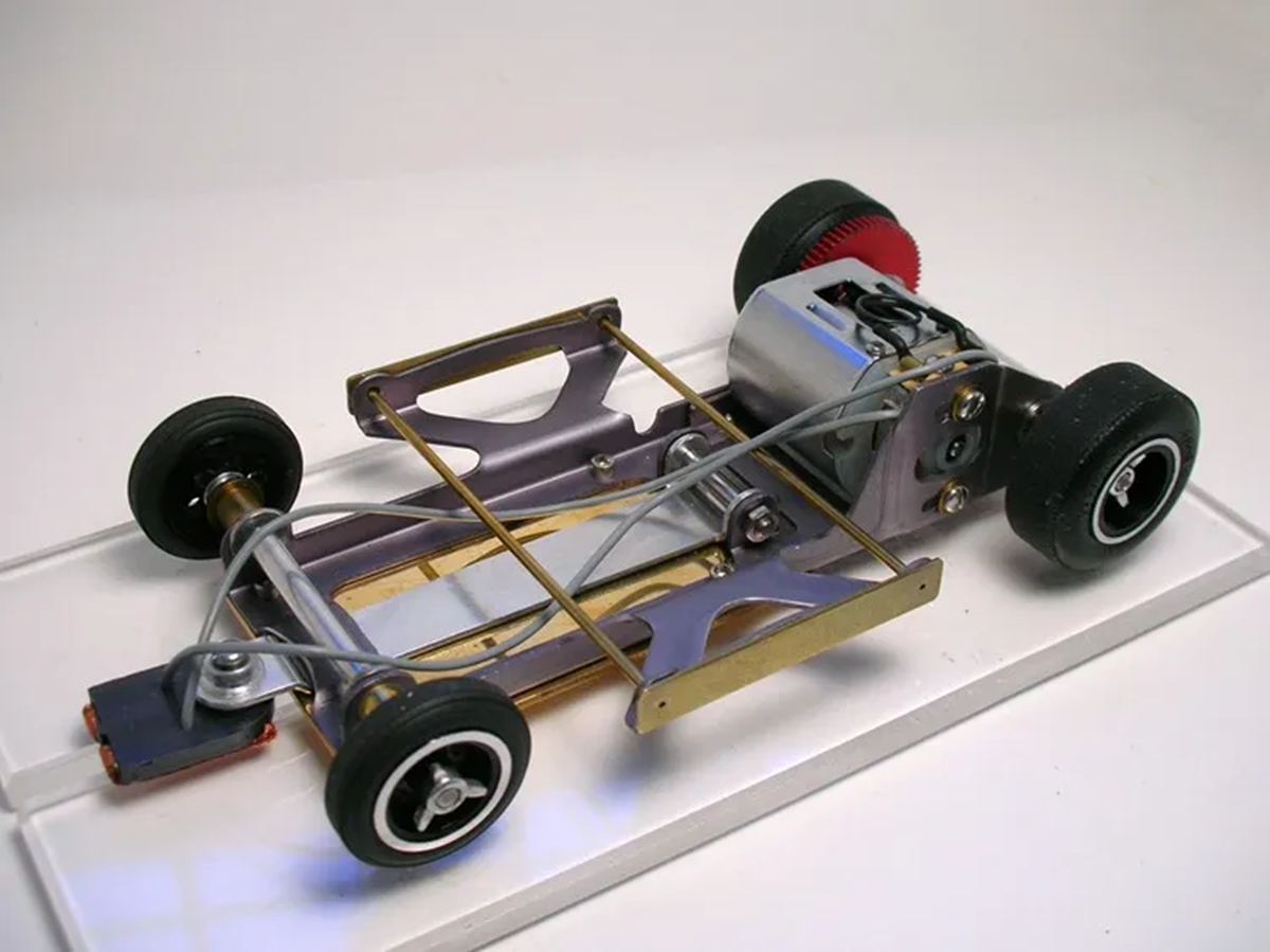

Here's a link to my modified Manta Ray that might be useful:
Manta "RAM" Ray
  • Jencar17, Tex and Bridgehampton66 like this
