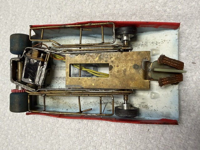

Second chassis need help ID.
Out of my vintage collection. Selling out of my personal collection to build my wing program.
More to come.

Looks homemade using an over the counter bracket and drop arm. :)

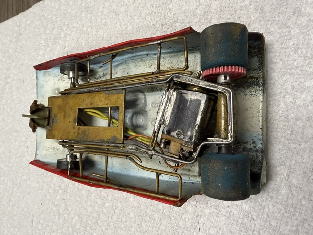

The drop arm. motor bracket, & the pre-bent piano wire in the center section all appear to be Ferret-made items. If the bracket isn't engraved FERRET on the back, these pieces were made for Phaze III.

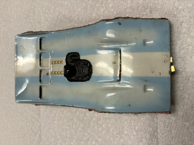

That Dynamic Porsche body was a popular wing car body in the East for a while after the Lancer Porsche coupes were no longer available & before the O/S Ferrari was made.

As the other Bill has stated, the drop arm, motor bracket, and piano wire main rail all look like a Phase III chassis which would have also had brass strip batpans. It looks like someone has removed the brass strip batpans and fabricated brass tube replacements. The motor looks like a Champion 16D, quite possibly a 517.

I raced Phaze III brass chassis as my weekly race cars on the Modelville Hobby Monarch track in Framingham, MA from 1969-75. These were the raceway's "spec" chassis from Rehco. You could buy them as both kits & assembled chassis.
