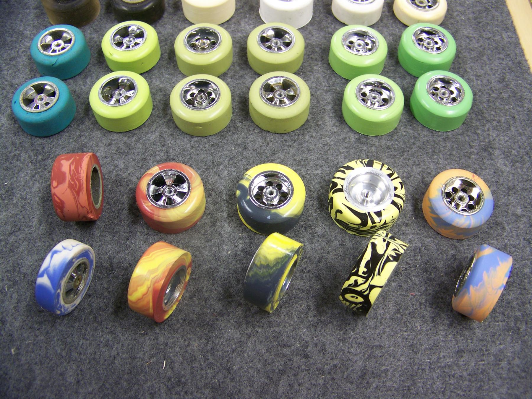

#9 Martin
  • 4,673 posts
Posted 30 August 2026 - 09:28 AM
Here are a few in my stash, hope they brighten up your day? Remembering these were made and sold in the psychedelic 60's :)
