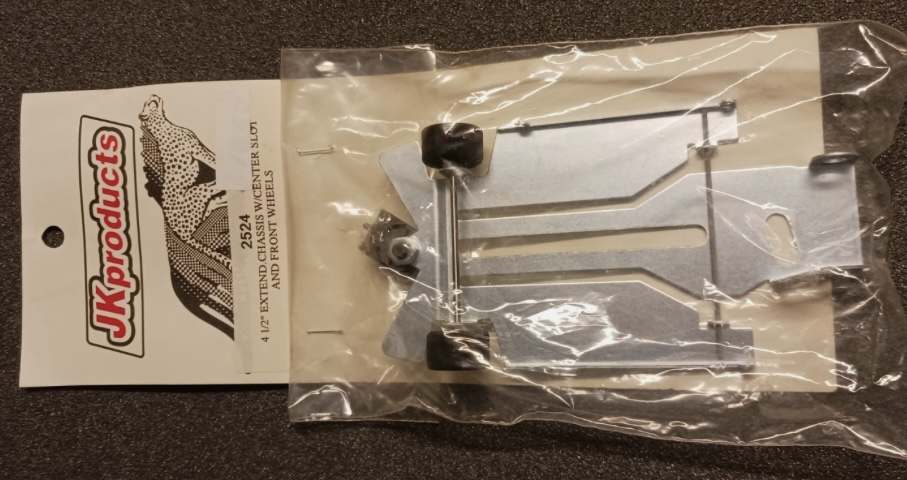

Wondering if anyone could help me identify this chassis. It seems to have some JK Products DNA involved, but I can’t seem to find anything on the internet to match.
Thanks.

JK Extender chassis.

The JK ‘extended’ chassis I found appears to have a long cutout aspect in the center section. Were these two variations on the same (model) theme?

Yes, there were two versions of this JK 4.5" flexi. One with a slotted center, one with a solid center. These two chassis shown are the early version with the up-turned front ends for the guide lift. The later versions had a straight front with a coined area providing for the guide lift. The revised front design came out during the late '90s. I don't recall any differences in handling for the different front ends. I preferred the chassis with a slotted center because you could stick a screwdriver in it to remove most chassis twists or bends.
Locally, we ran those chassis on a trioval with stock car bodies. I would think they would work on hillclimbs and other tracks, too.

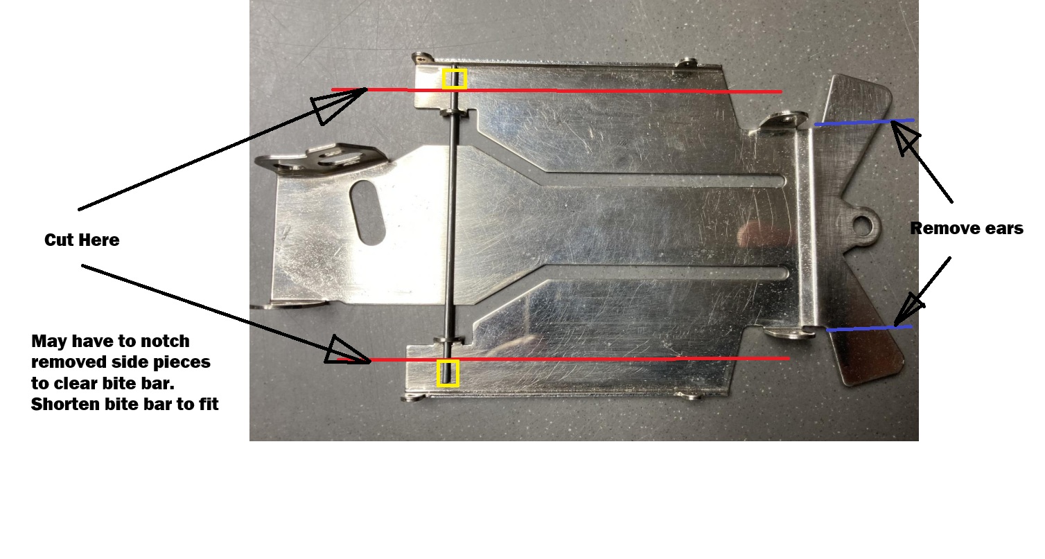

I was club racing as well when these were being sold cheap. They made good hardbody oval chassis with the pans narrowed. Cut the body mounting flanges off so you can re-solder them farther in. If you have to cut through the bite bar loops, you can move the bite bar a little farther forward. Test fit the cut piece on top of the pans before soldering on. You will probably have to notch out where the bite bar is to clear it. Plus you will have to shorten the bite bar to fit between the new side positions. Be sure to measure how narrow the pan needs to be narrowed before cutting, and leave enough material on the cut sides to solder them back on top of the pan. You will find this method gives you a little more height for the body pins so you have more meat along the sides of the body.
