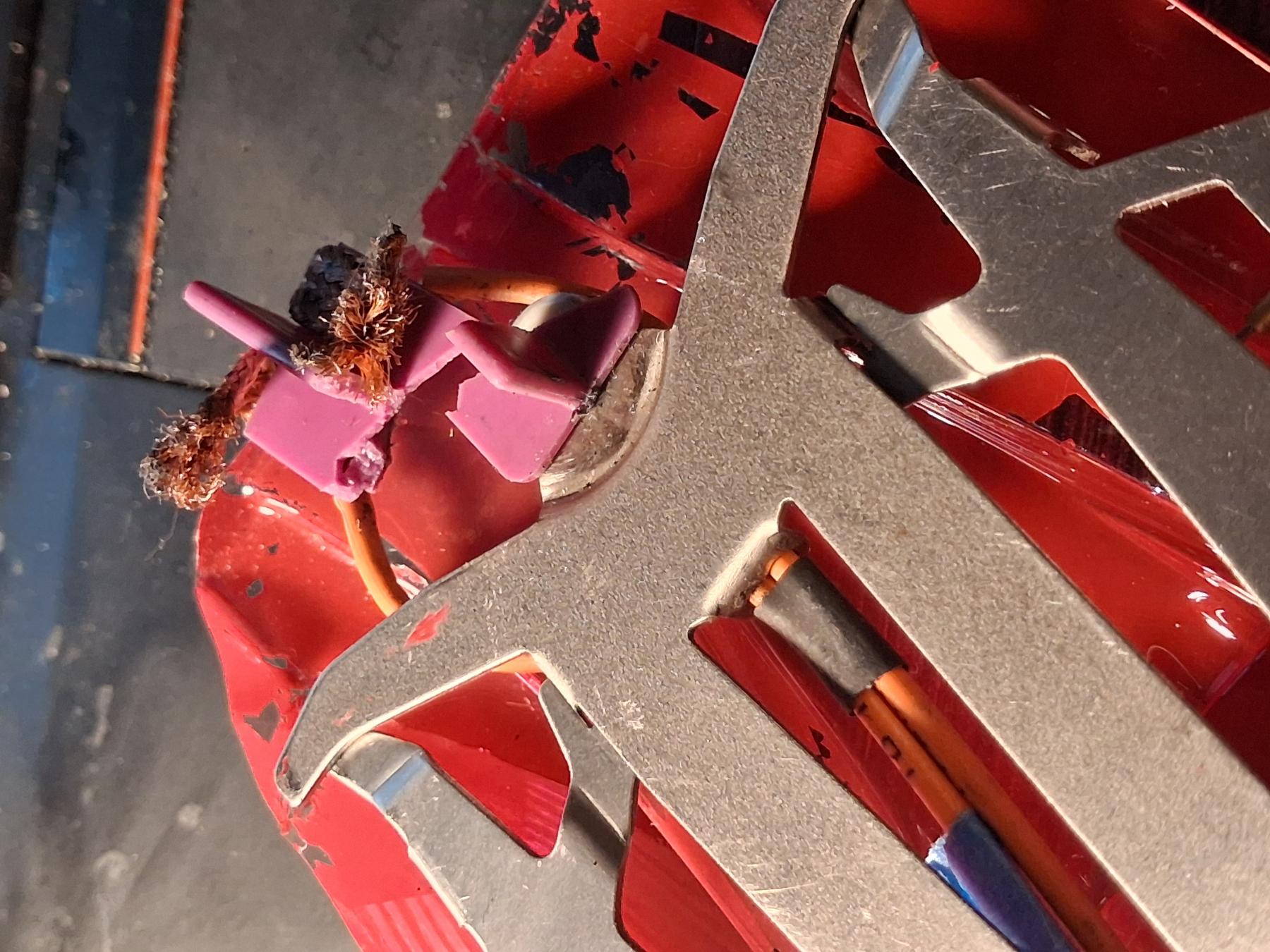

Background; at the track last week, I gently cleaned off my wiper panel with a clean, dry piece of terrycloth. When I hooked it back up, it would no longer go all the way back to the stop without gently goosing it resulting in a few wild rides around the track and a wall shot or two. I took it home and opened it up but I saw nothing openly weird so I put it back together and shazam, it now operated normally.
So today, I hit the track and once hooked up, I literally hit the track as my car took off and bongoed the wall head on, hard enough to break my nice Cahoza guide, something that I have never done before. Josh came over and we checked a few things, and it seemed to be OK, so back on the track, only to go nuts two laps later and wall shot another car. The power to the car issue was intermittent, but completely unpredictable, (i.e. it didn't matter if I was on the power or not). I can recognize defeat, so home I went.
I am now looking at the controller and there is no burnt anything, but my wiper is contact is loose in its hole, and the arm is bent ever so slightly up where the wiper contact goes through. Also, the wiper arm goes all the way to the screw holding the control panel on. Are these the culprits? Or could it be electronic issue.

Usually you can expect the guidepost to break & the chassis to bend. Your photo doesn't look like either. I'm wondering if that guide didn't have an internal flaw to break across the middle like that. Whose guide is it? I used to boil nylon guides before using them. That is something I learned from RC racers.
  • Mudhen likes this

Posted 20 September 2026 - 06:41 AM
Look at the burnt mark next to the braid, a clue?
It was / is a Cahoza guide, and it had a long thin blade, and was pretty lightweight compared to say, a Parma.

As has already been mentioned, guides usually snap at the post. A hard hit might bend the chassis or guide tongue, too. I've had many crashes into track walls and some spectacular airborne wrecks where my car has left the track altogether and landed on the floor some distance away and often under the track, and yet I've never had a guide break like that. That's also an odd burn, and I see other blackening along the length of the guide's braid pocket indicating a serious short. The opening description of the controller problems indicate a chain of events, so it's possible there are multiple contributors to the end damage.
I'm suspicious there's more than a single fault involved, but not being there and not being able to perform failure analysis of the bits involved, I can only speculate. Hopefully Jim can diagnose the controller from photos and at least get that portion of the mystery sorted.

I hadn't noticed that a solder joint on a lead wire was in contact with the chassis. Due to the age and waveyness of the track, the chassis flexed just before the bank, ~=3.5',(BlueKing)and 💥 wall shot from hell. Evidently the chassis had contacted a braid which resulted in full voltage. It was a IRRA type chassis and, it bent the guide thong 90°. Not to say that it's your problem but I just thought I'd share this with you and everyone else. Stupid simple things that if overlooked can ruin your day.

Use motors with buss bars, if possible. Otherwise, be very careful that when you solder leadwire to motors & guide clips that you don't strip off too much wire insulation. All you should need is about 1/8" max.

No one is making value judgements here. In MY experience, the Parma guides that I used in ye dayes of olde, were pretty much bulletproof. The wall shot that took out the Cahoza was a total, head first million MPH smack. And the Cahoza guide was, to be honest, a really thin bladed guide. I liked it. That's why I used it. I have looked at the wrecked car, and I wonder if arcing occurred in the process of the wreck, everything, guide braid, lead wire, came together in an instant and shorted out. I agree that I have never before seen a guide with obvious scorch marks, and the leading edge of the chassis, where the guide fits through the hole, there is a roughness that is not on any of my other chassis, and suggests being burned, although there are no obvious burn marks. The violence of the wreck may have done that.

Remarkably enough, only the tongue seems to be bent. Like I said, it was a straight on impact.
