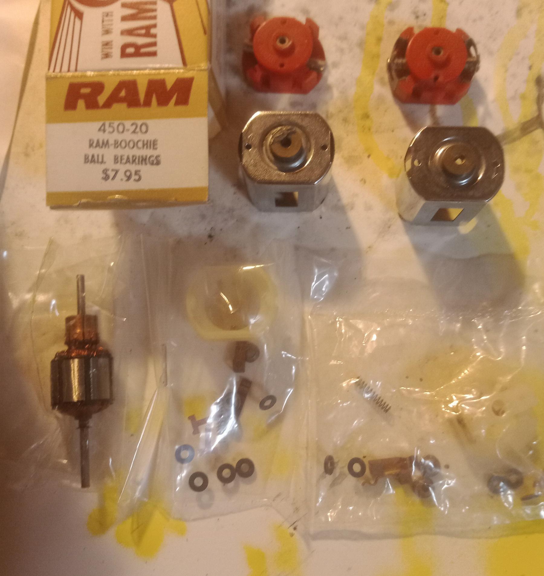

Should the ram conversion(s) be included here? If so, would you like me to post them?
#30 Bill from NH
  • 15,318 posts
Posted 15 November 2023 - 11:03 PM
Was there Ram conversions for the Hemi cans?  I have one for the Mabuchi 36D. Simco also made 36D & 16D endbells for the Pittman style brushes.
#31 Mark Onofri
  • 2,981 posts
Posted 16 November 2023 - 01:21 AM
Yes ,the two (2) variations that I have are. And also, yes, they both are set up for Pittman style brushes.
#32 Bill from NH
  • 15,318 posts
Posted 16 November 2023 - 08:44 AM
Post your photos. I have never seen the Ram kits available for anything other than Mabuchi cans.

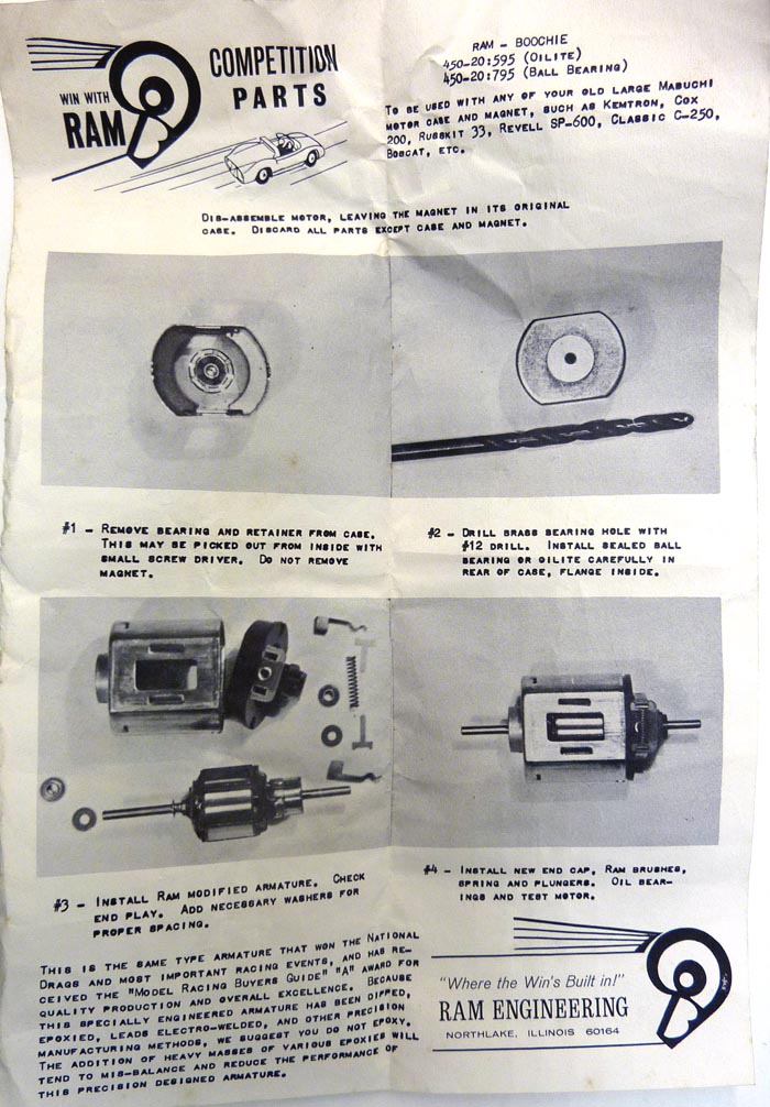

#34 Mark Onofri
  • 2,981 posts
Posted 18 November 2023 - 02:53 AM
Although it says,Rambuchi, it's for Igarashi. Only difference between the two (2) kits is bb or oilites. Unless I'm very, very wrong.

#35 Eddie Fleming
Eddie Fleming
  • 3,028 posts
  • Joined: 27-April 14
Posted 18 November 2023 - 11:55 AM
Does anyone have a photo of one of these motors with the Ram brush assembly installed on it?

Marc Onofri,
"Although it says,Rambuchi, it's for Igarashi. Only difference between the two (2) kits is bb or oilites. Unless I'm very, very wrong."
You are very wrong. :)
The RAM kit was specifically designed for the 1965 Mabuchi FT36D motor.
  • Tom Katsanis likes this
#38 Mark Onofri
  • 2,981 posts
Posted 21 November 2023 - 01:13 AM
Thanks TSR,
Evidently (probably)they switched the endbell?
#39 TSR
  • 42,307 posts
Posted 17 December 2023 - 10:47 PM
The RAM kit always came with its own endbell, made of stronger white plastic than that on Mabuchi motors.
The Igarashi can motors from Strombecker were not yet known and marketed, either separately or in kits or RTRs, when RAM produced that kit.
Of course the kit can be used to modify the big Igarashi/Strombecker TC24/Hemi, but it was never designed for it.
