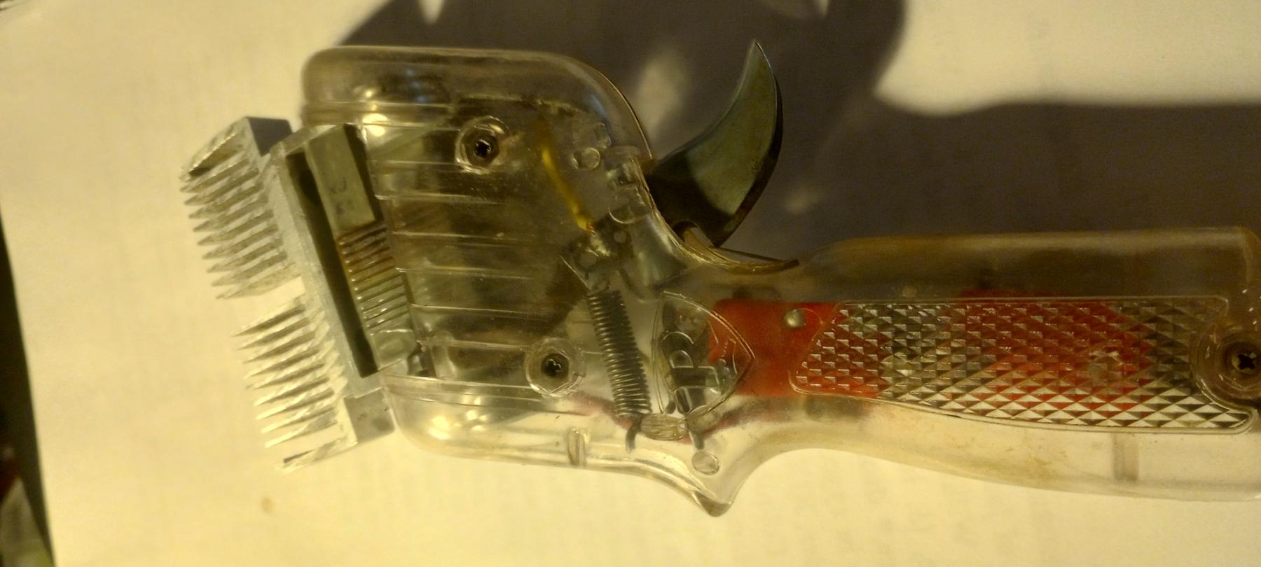

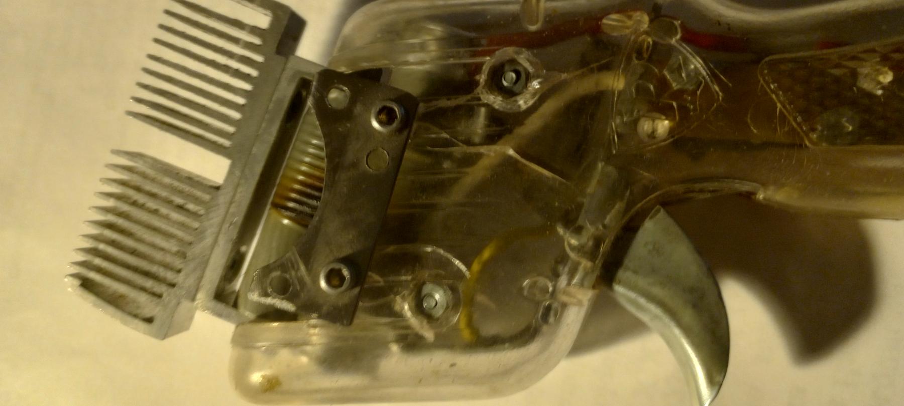

#25 LtDan
LtDan
  • 36 posts
  • Joined: 20-February 26
  • Location:Northern CA
Posted 25 February 2026 - 08:59 PM
A yes the Parma with the 2 micro switches here is a couple of pix of mine with the top heat sink and I made the internal finned one that plugged into the lower resistor. Also the bracket on the left side was a small 12 volt fan that I mounted on that bracket. The fan died recently
Dan Calhoun
