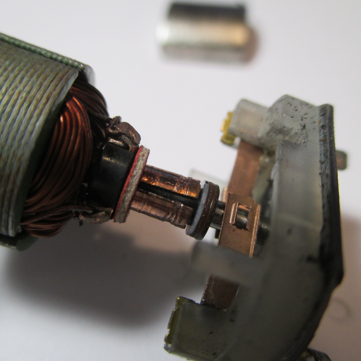

#135 Pablo
  • 18,582 posts
Posted 30 July 2018 - 08:04 PM
Let's investigate this motor failure. Why did a brand new motor - never even been on a track - drop BOTH brushes out? I've been racing FK motors for years and never seen this until now.
Motor is out of the chassis.....
Despite using my inspection flashlight, 3X reading glasses, and geezer goggles, the brushes are nowhere in sight. So I'll now remove the endbell and take a look.
#136 Pablo
  • 18,582 posts
Posted 30 July 2018 - 08:47 PM
No wonder I couldn't see where the brushes went - they got pulverized and splattered all over the EB :laugh2:
Comm failure combined with brush failure = "poof"
Never even got to test it on a track, my axle "anti-magnetic" experiments were for naught, and I made myself a fool by ordering carbon fiber axles in anticipation of the Phoenix being "the next best mouse trap". I think the only thing got trapped is, me :laugh2:
#137 Bill from NH
  • 15,323 posts
Posted 30 July 2018 - 09:00 PM
In the photo, the top comm segment appears to have partially lifted from its binding material. If so, the comm could have eaten soft brushes. Hang onto the magnets & can for a future build.

Posted 31 July 2018 - 04:23 AM
Hi Pablo,
     From the (very nice) photos, it looks as though all the coms segments have let go from the phenolic core.  These coms are sort of like the old Mabuchi coms, with the plates just sitting on their core, instead of forming the inside of a copper shell with "dovetails" to help key them to the phenolic after slitting, the way modern "actual" slot car motors are done :)  I'm surprised that more of these motors don't suffer the same fate as yours did, but many/most DO last for the expected lifetime of the motor.
***Here's the thing, phenolic resin is very tough stuff...like REALLY tough stuff.  Just as your photos show, it's most often not the phenolic itself that fails, but the connection ("bond") between the copper shell and the phenolic.  When (*I think it was) Gunther Faas figured out how to improve the situation by dovetailing the inside of the copper shell before filling it with phenolic, com reliability took a major leap forward.  I have some Faas com shells that haven't been filled, and they look fully like those we see today.  The only thing that has changed on some coms is the number and shape/geometry of the dovetails, with some having 12 instead of 6.  Personally, I have my suspicion that doing that many dovetails can make for a slightly weaker com than having 6, but it may also be the depth and width of the dovetails.  The rocket scientists can figure that one.  :)
Anyway, these Phoenix motors are basically like hot-rodded Falcons.  They may have a good balance between magnet strength and wind and still last OK, but the basic setup is being "asked" to do significantly more than your average sealed motor.  You may have just been unlucky, or maybe there will be *on average* more failures like this with them???
  • Pablo likes this

#139 Pablo
  • 18,582 posts
Posted 31 July 2018 - 07:23 AM
At least it failed at home, not during a race  :crazy:
