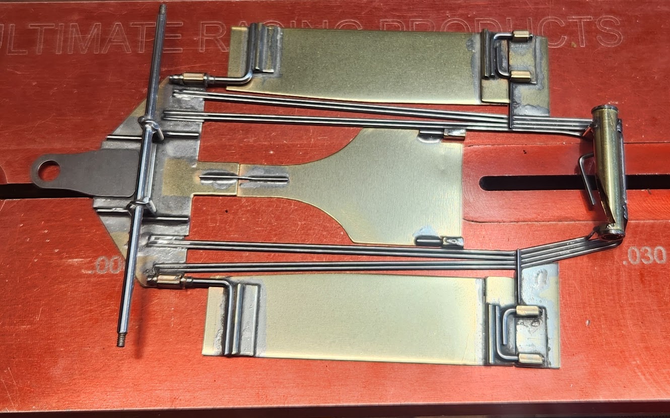

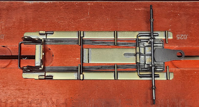

Couple new chassis for me as I get ready for the Checkpoint Cup.
Angle winder coupe.  8 rails of .039, 4" WB, .900" GL.
F1 split rail chassis.  Slightly different from the one I won with at this years Checkpoint cup.  8 rails .047, 4" @B, and .900" GL.

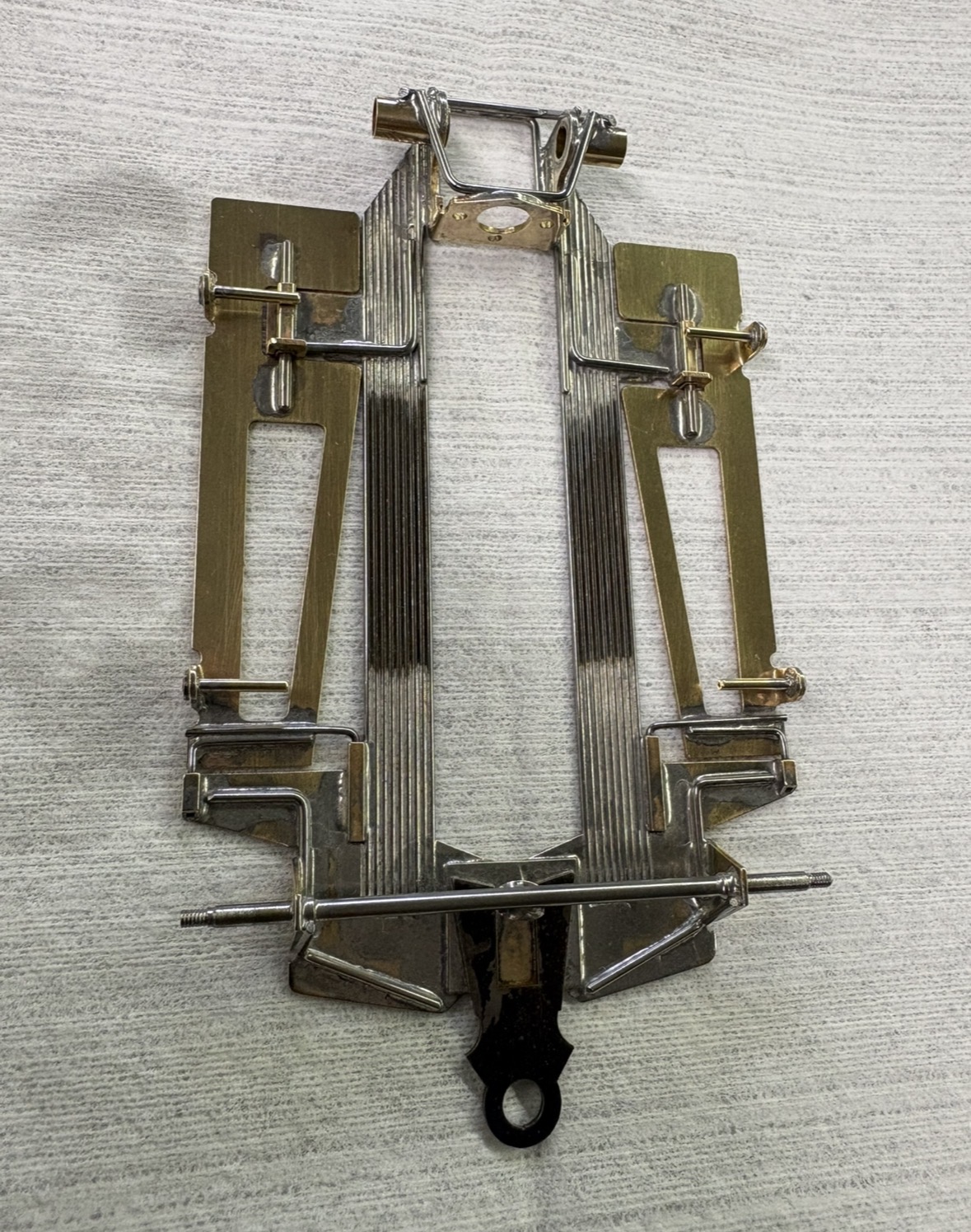

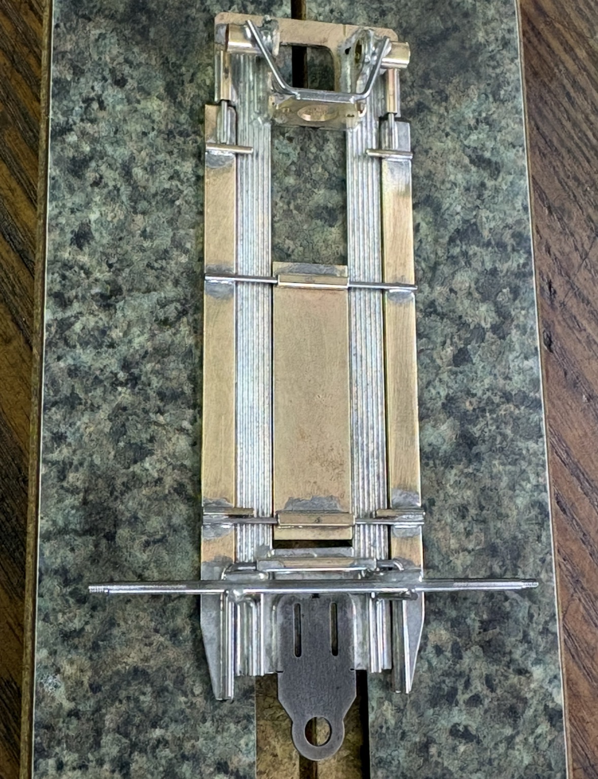

14 Rail .039, .060 Nose and Side Pans, Swiss Tongue, Motor Bracket, and Bracket Filler. 4 WB. The pan movement is similar to a JW car I have.
10 rail .047, 6 rails piano wire and 4 brass. Swiss Kit with .060 side pans. 4 WB, this is an updated version of my last R4 winning F1.

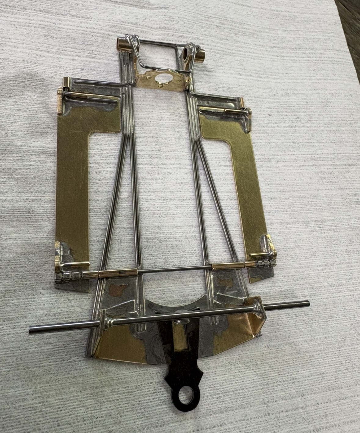

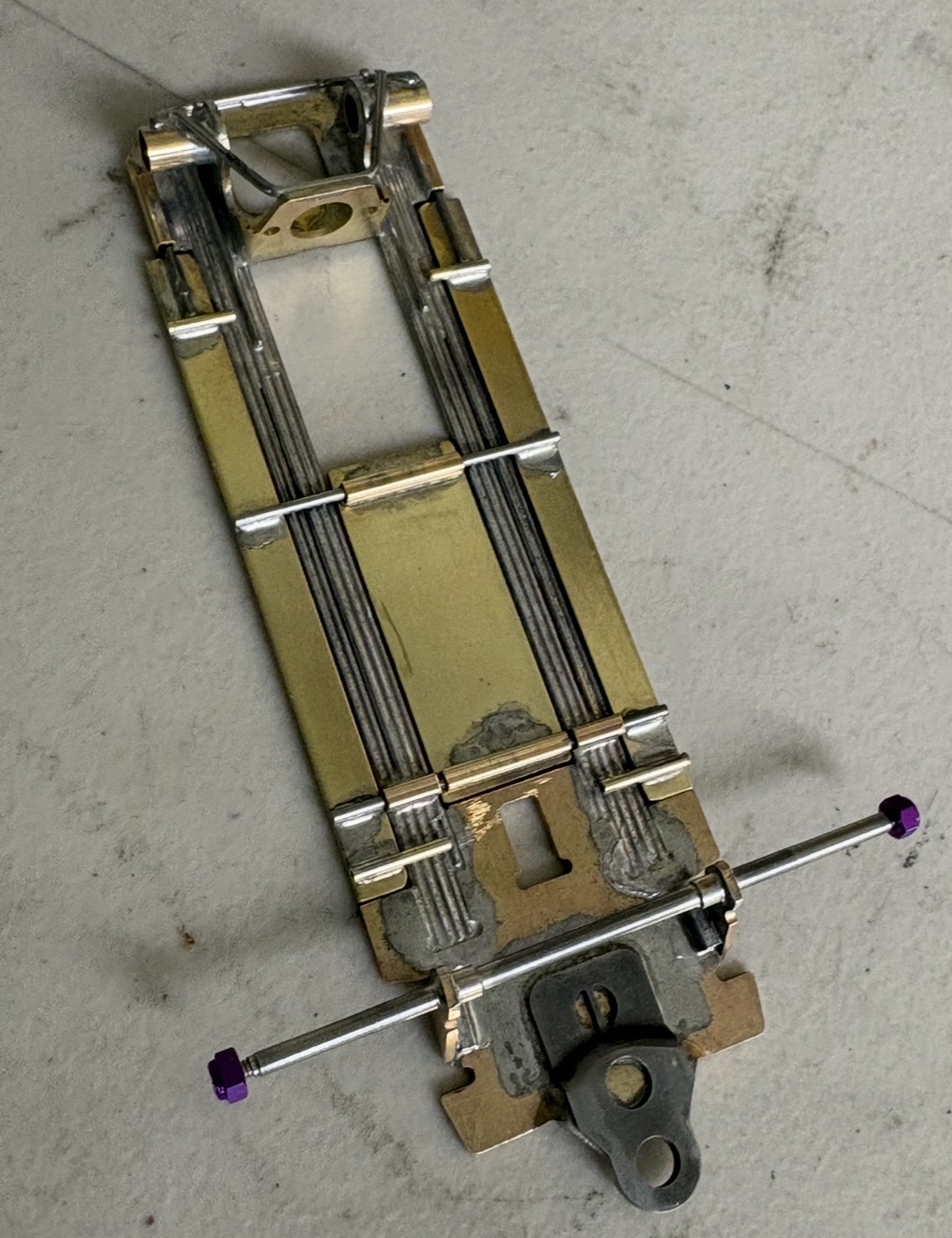

New Can-Am, this uses a torsion plate I had made years ago. Chicagoland 3/4 Bracket, Chicagoland Pin tube mounts, DHMI Guide Tongue. 55 grams.

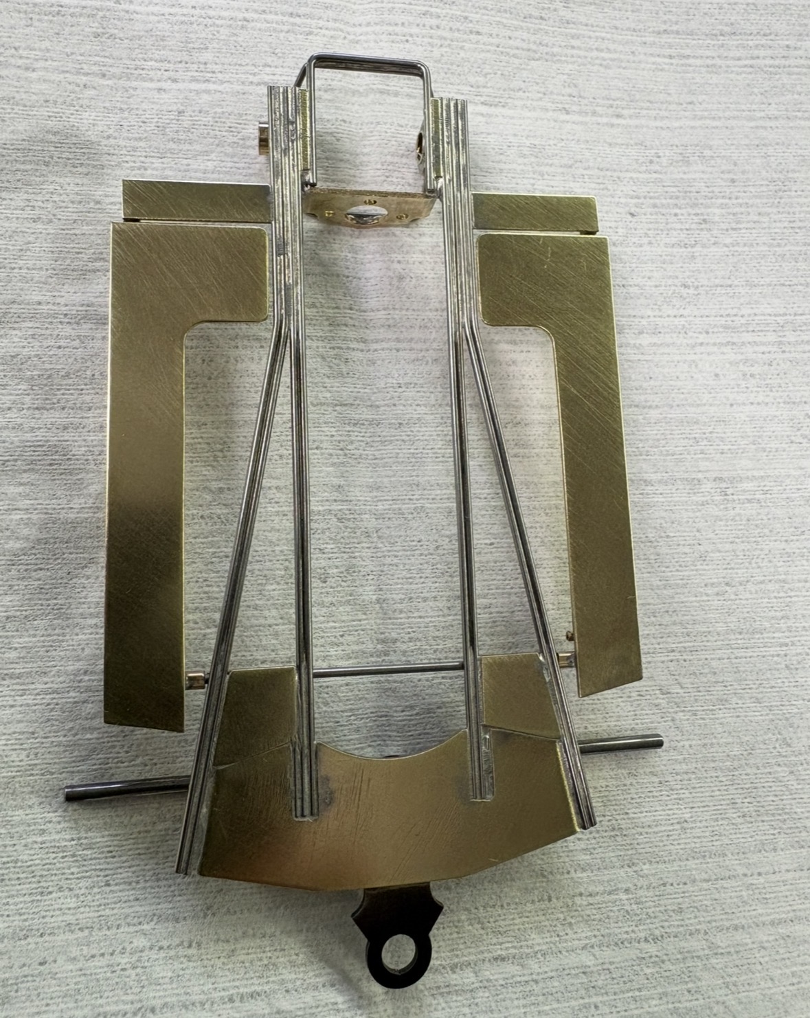

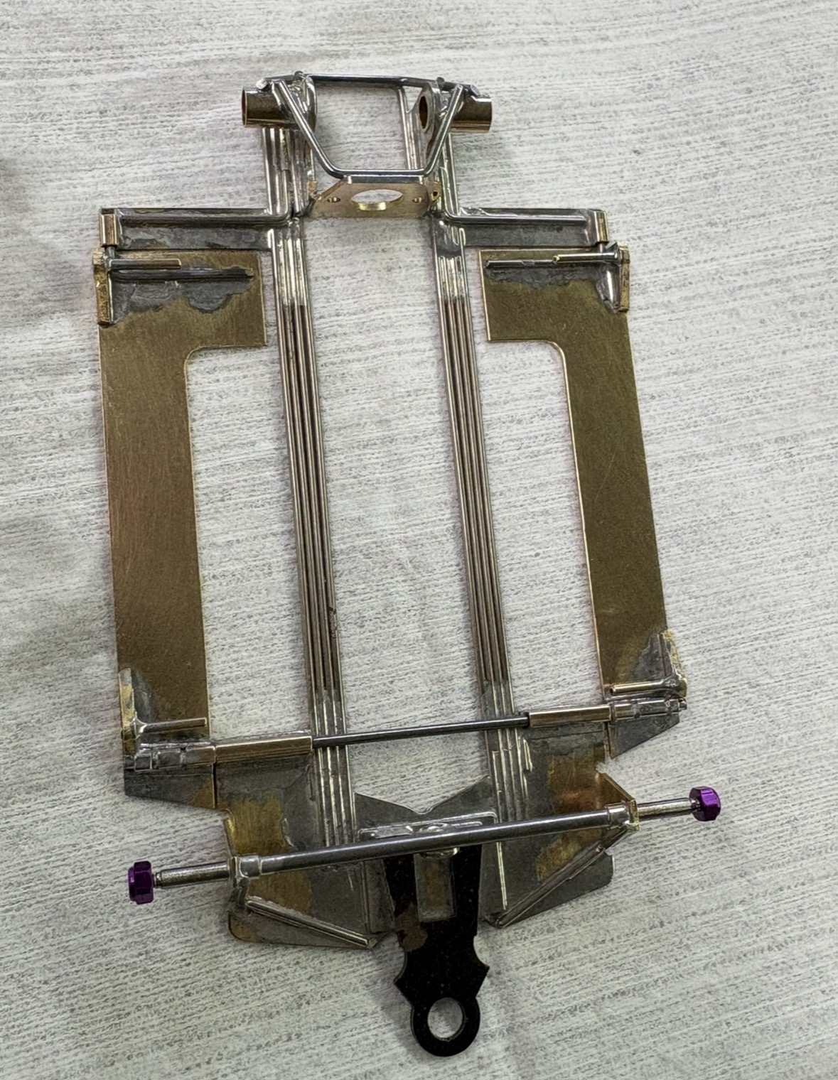

Nose is another one from a torsion plate of mine, R-Geo side pans, DHMI guide tongue, Chicagoland motor bracket. Car is 56 grams. The pan mounting set up is based off of stuff GVP used to do.
