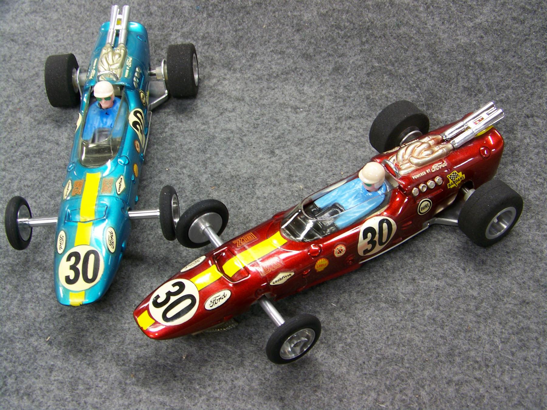

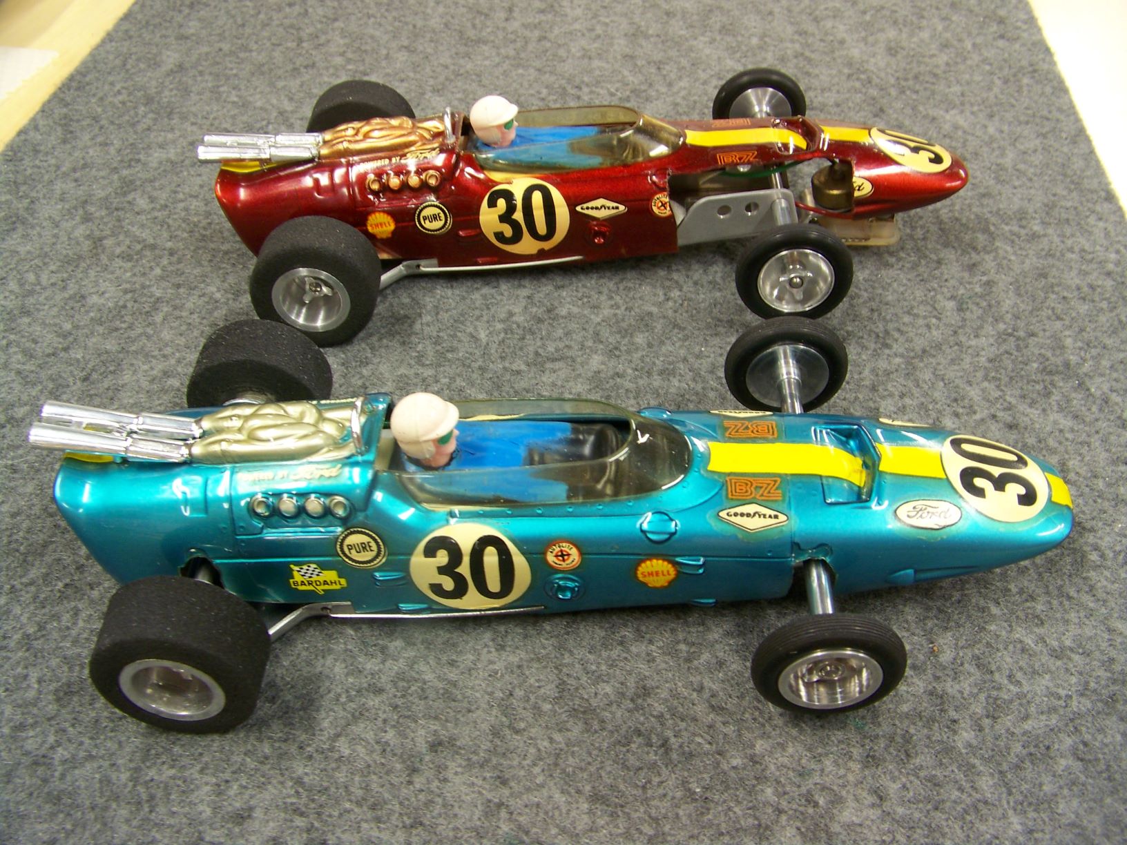

The BZ beater gets a stable mate.
Always wanted one in better condition than the beater and this body was pretty good.
Fixed the small splits that seem common added the pipes and driver. Cleaned and tumbled the chassis grooved the O-ring front tires as before and put in a NOS BZ motor with 10 /31, and she is done.

How that big motor fits in there, I don't know. But I love it  :D  :heart:  :heart:
#28 Martin
  • 4,649 posts
Posted 17 October 2020 - 09:47 PM
Yep it is a good fit (as in no extra room) I did have to trim the driver a few times to get him high enough to clear the motor and move the wires to a happy place.
Pablo, these are those O-rings you sent me. They fit the stock BZ wheels even better, thanks again.
Love the old mid 60s Indy cars too. I think BZ/Lancer made a nice looking car.

That turned out nice.    The 36D is a stuffed fit in that body.  It takes a special vac form driver  to even fit one in.      I've always wondered why they didn't order a few thousand 16D and design the frame for the 16D.  I guess these cars came out late and design and tooling money for new stuff was getting tighter.   I do like these cars and the great single stage paint that has a candy look.

Matt, you mention the driver which is the only driver that make fitting that 36D in possible. I did manage to match the blue in some ares as the paint very often pops of in spots. Then I gave it a flat clear coat to hold it all together.

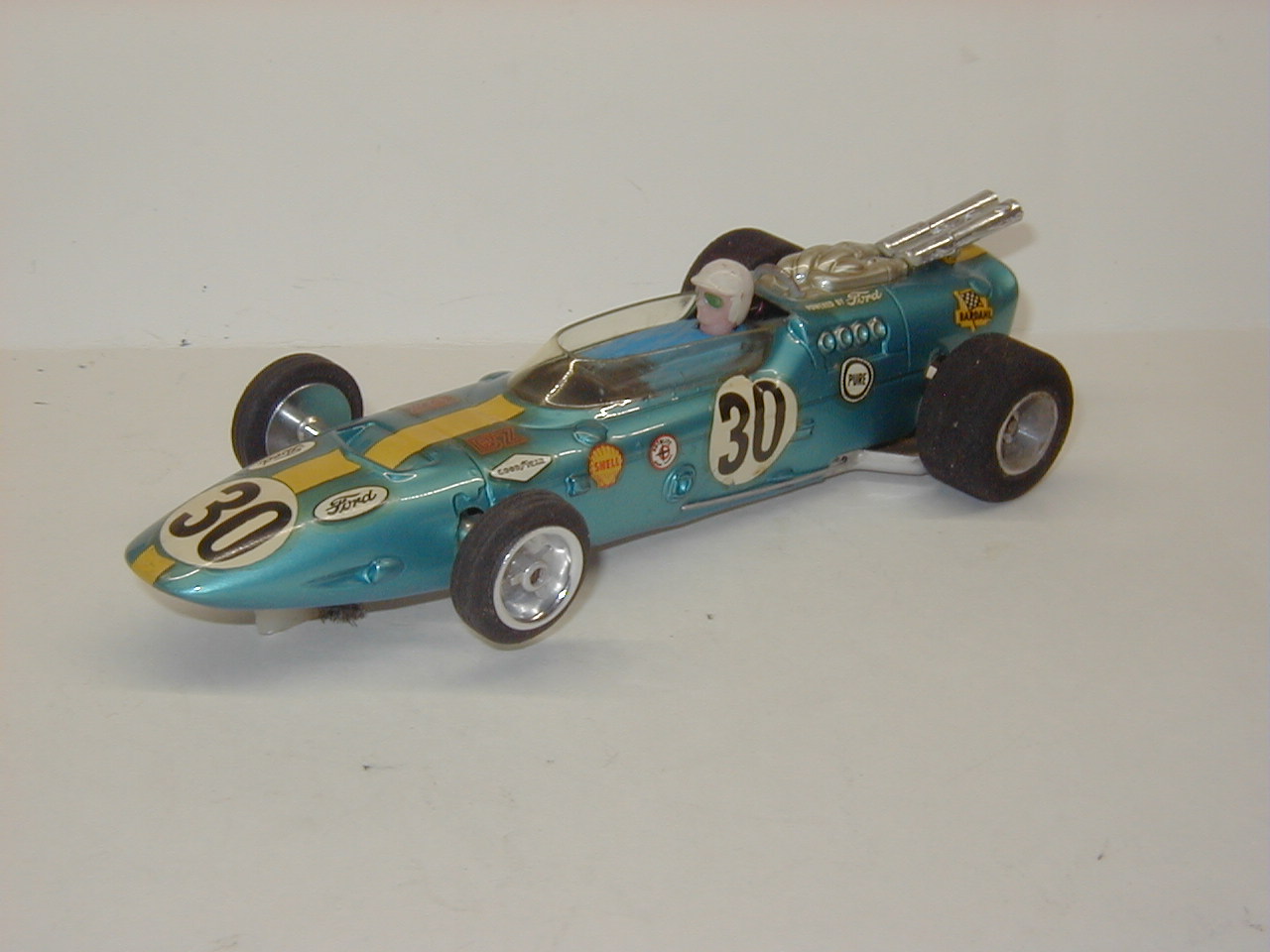

I have one that is a pretty close match to the lighter blue.   I know Don Wedding has one that is a bit darker and his is MIB.
This is Don's.   Very nice isn't it?

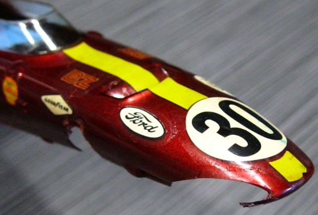

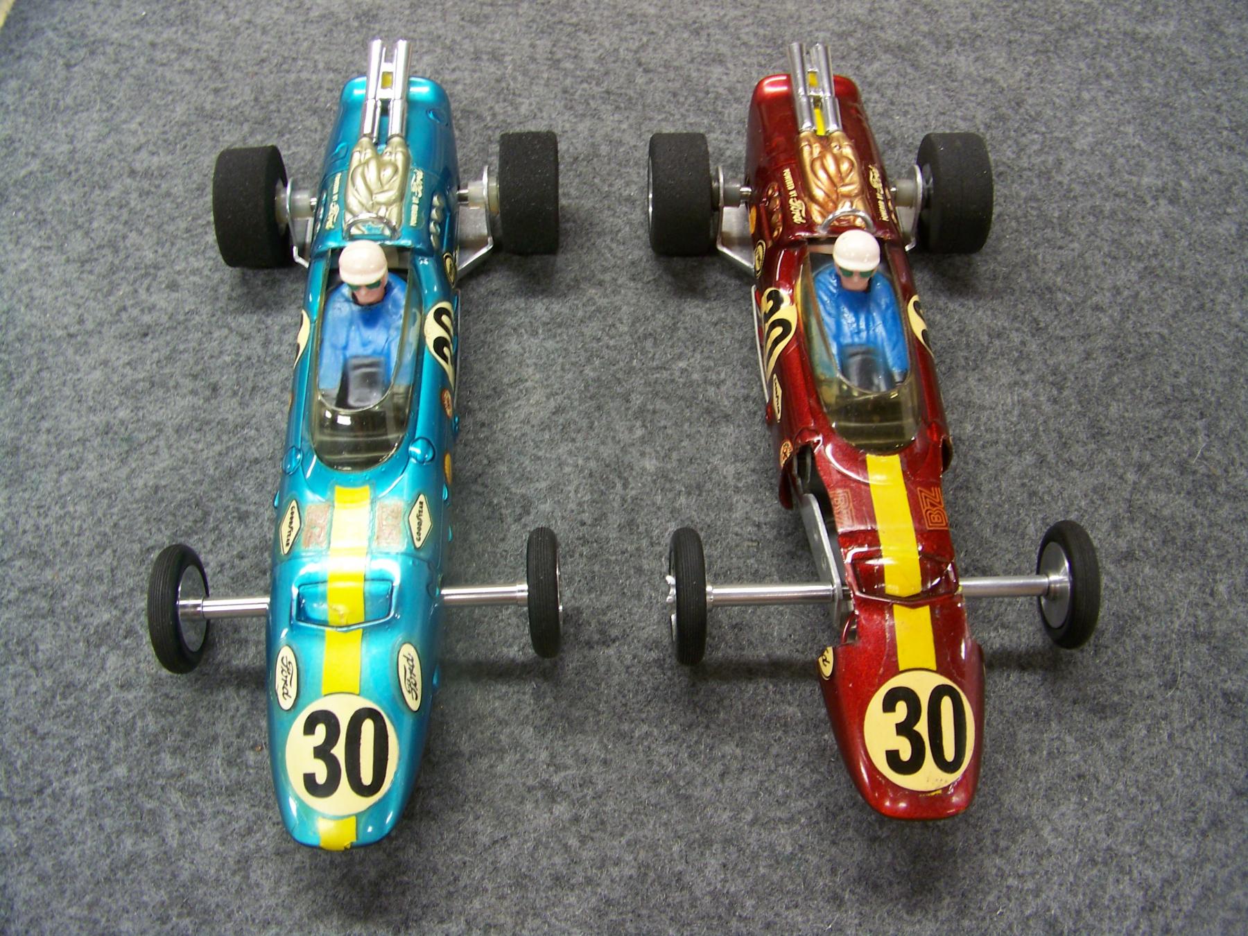

It did not come easy, but with help from a friend, long story. But I finally scored a better BZ beater to replace the body I started with. This one had some issues as well, but it looked like an easy fix.
Main issue was a chunk missing from the nose. I used silicone putty to make a quick mold from the good body. It is not perfect and I still need to back the patch up with gold to try and get a better color match.  Because it is repaired with clear epoxy and the epoxy is thicker, it is hard to get a perfect color match, but it is so much better than the first body that I started with.

#35 MattD
MattD
  • 3,561 posts
  • Joined: 13-August 11
  • Location:IN
Posted 13 December 2021 - 09:36 PM
That's a great repair.
  • Bill from NH likes this

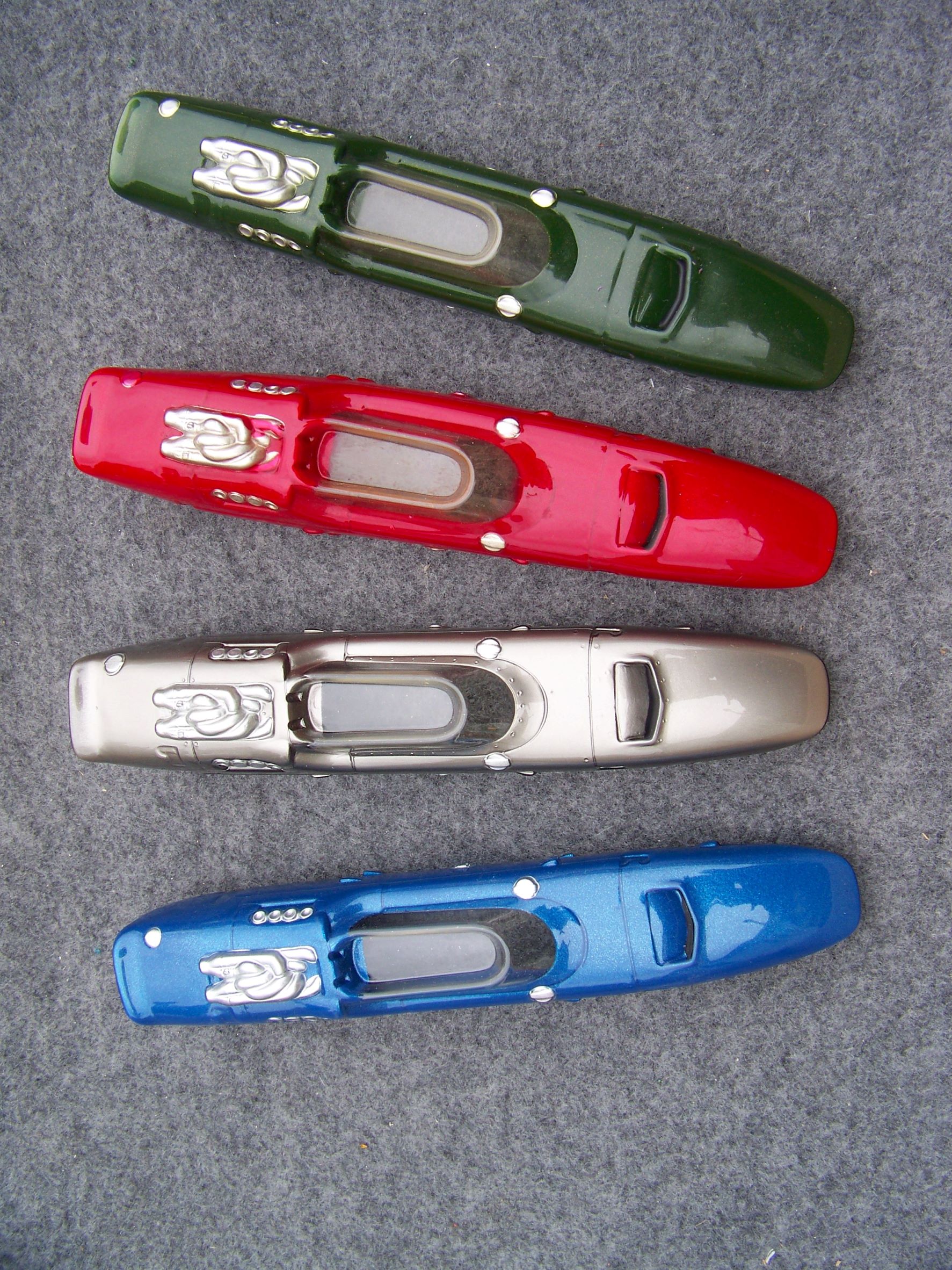

While we are on the subject of Watson Fords Lancer did some really nice pre-painted bodies. Shown here.
I am not sure if this is all the colors, they may have done a yellow too?

#41 MattD
MattD
  • 3,561 posts
  • Location:IN
Posted 16 December 2021 - 01:49 PM
That red would have made an eye catching rtr back in the 60's.

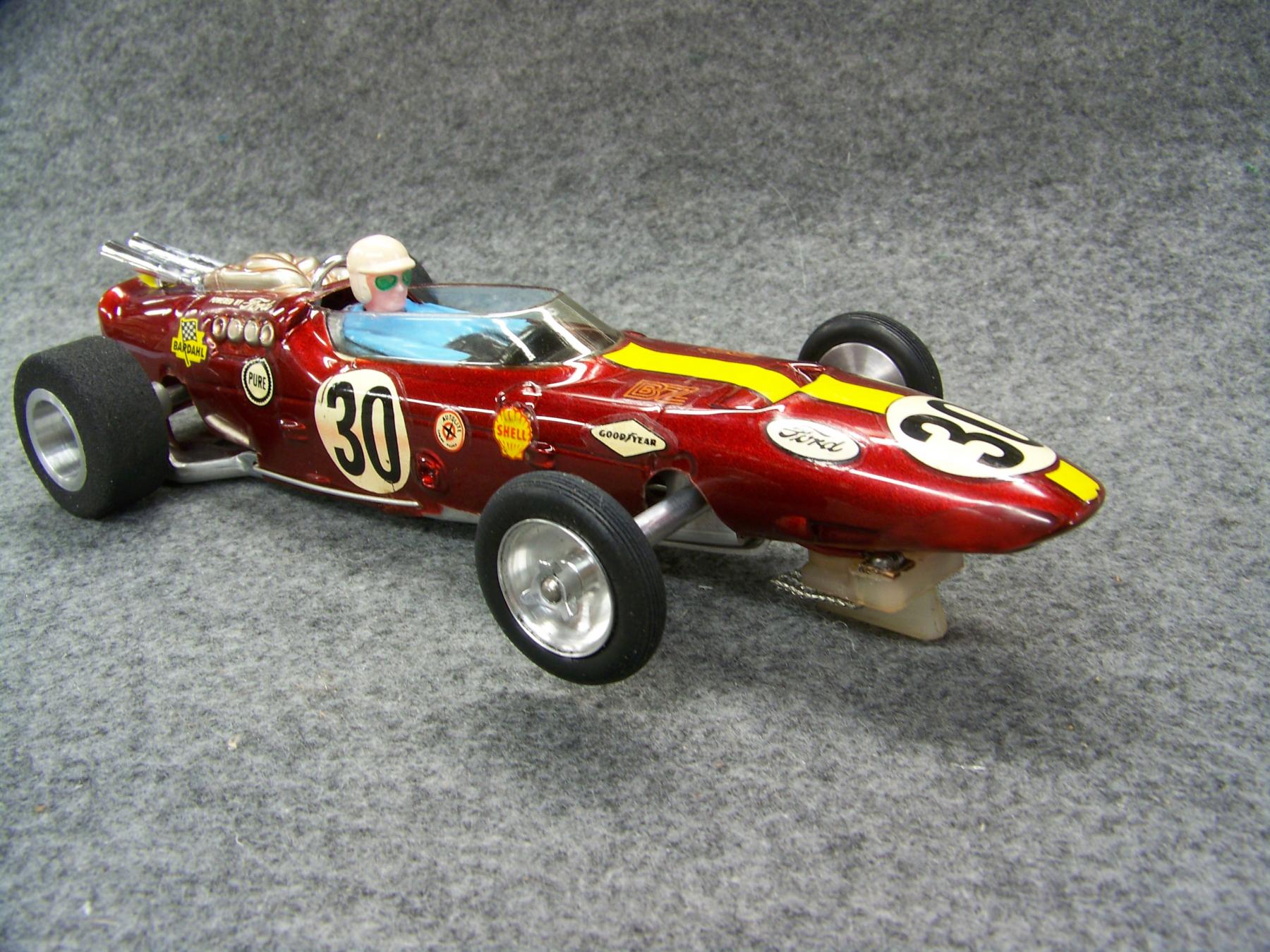

Thanks to Pablo I got the fronts on, and this beater is rolling again. Still looking for a broken body I can patch the missing parts in with but for now its a cut-away.
I did figure out how to tread the fronts, I did mess up on the first one, Where do you get those fat o-rings ? I will have to get some more. Rt front side good,the left I messed up a bit.
I hope this does not sound too ridiculous but I got a box of  'O' rings from a hardware store and they were in sizes that could be use I think on a slotcar.
Hope this helps Allan

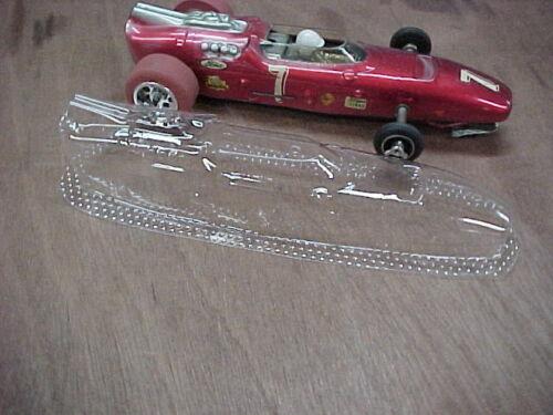

Just for info I found on Ebay US a guy doing clear repops of the Watsun Ford and another selling a body for $9.99 with no bidders on Ebay I know of someone in the UK who has a painted Lancer one for sale.
Let me know if you need this info.

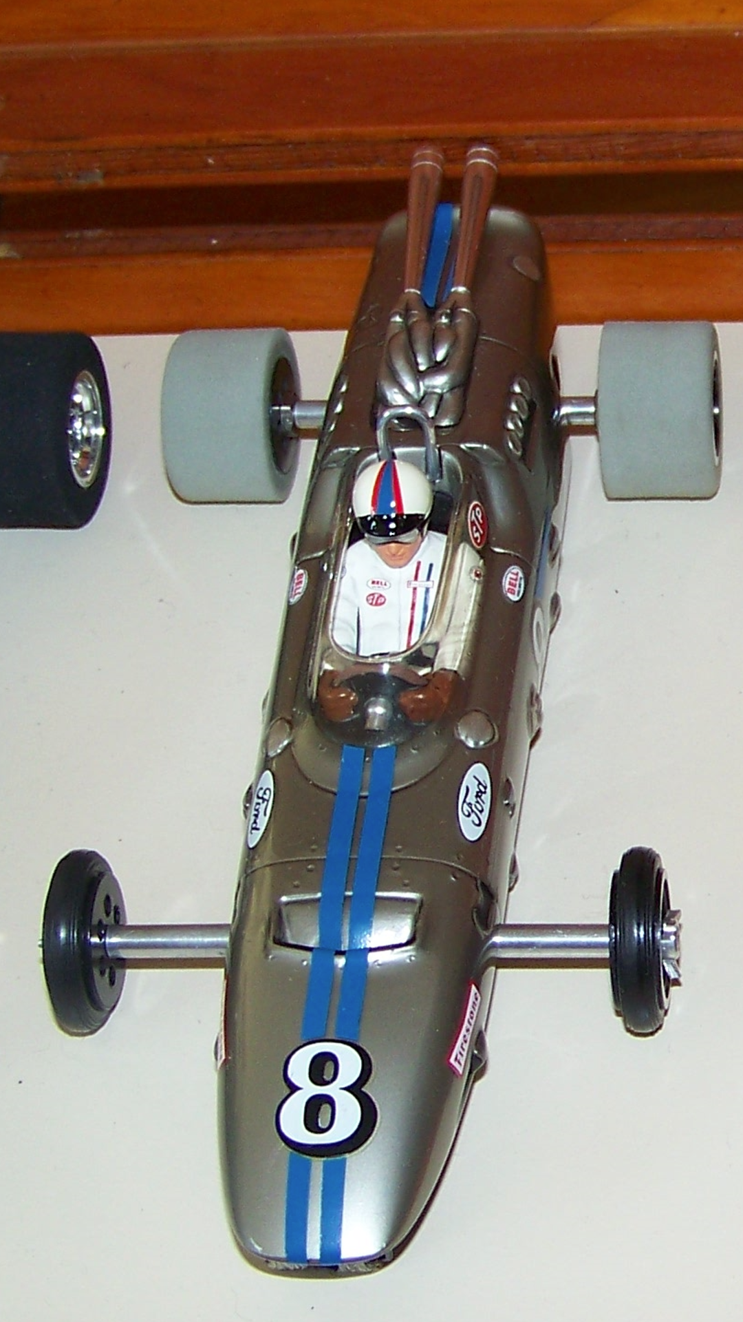

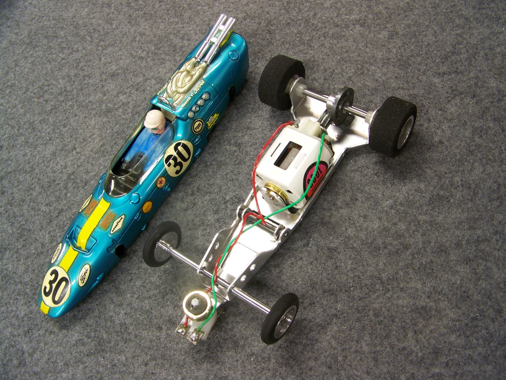

This is another Watson Ford I did some time ago with a pre-painted Lancer body. It sits on a JAD chassis.

#48 Martin
  • 4,649 posts
Posted 16 March 2026 - 10:46 PM
Hey Mark, its your basic JAD/Riggen chassis like this.
