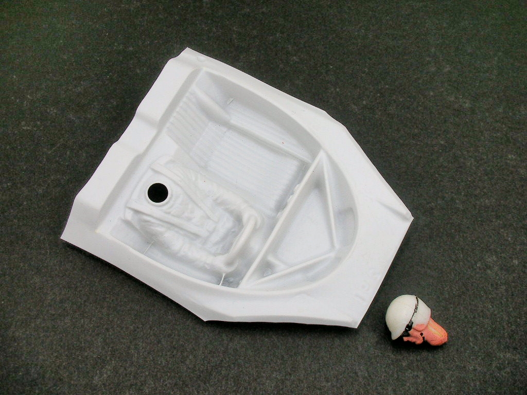

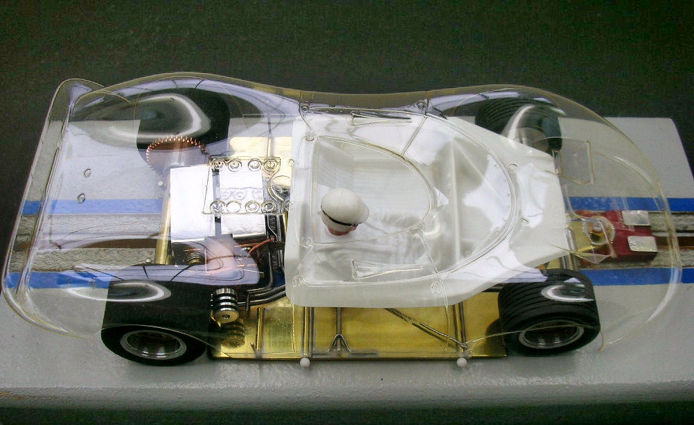

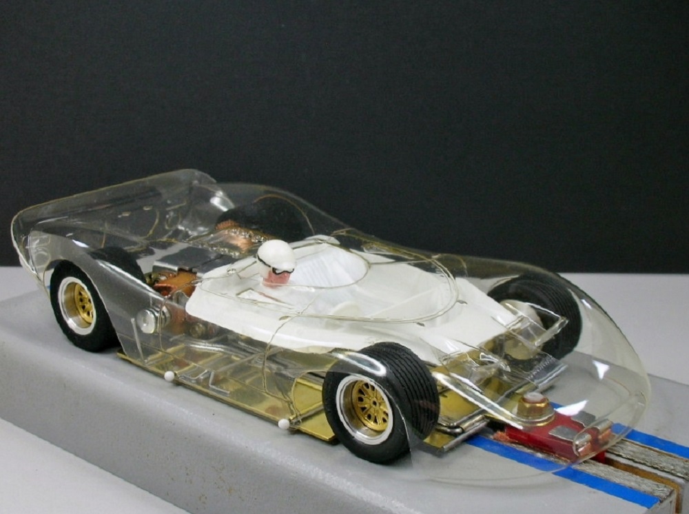

Here's the repop Lancer Ferrari Can Am interior and my current favorite driver's head, vintage Russkit:
It fits this body amazingly well:
Even though the Honker is a very low Can Am car, the scale version is tall enough to fit a full depth interior.
With the shortened buss bars I can solder the lead wires on their sides and angled downward to fit under the interior without putting a sharp bend in them:
I'm hopeful this car is really going to come together:

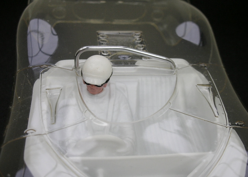

I'm not a fan of the molded in roll bars in the body or interior either Dave.   :D

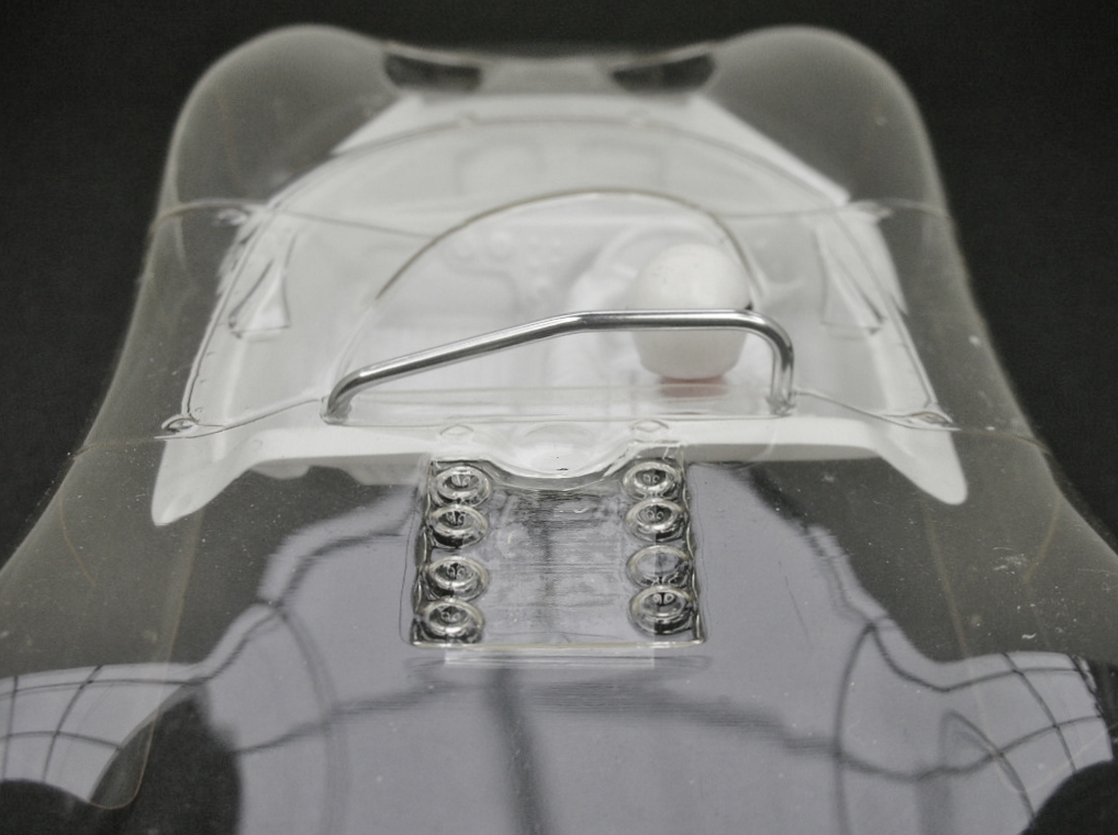

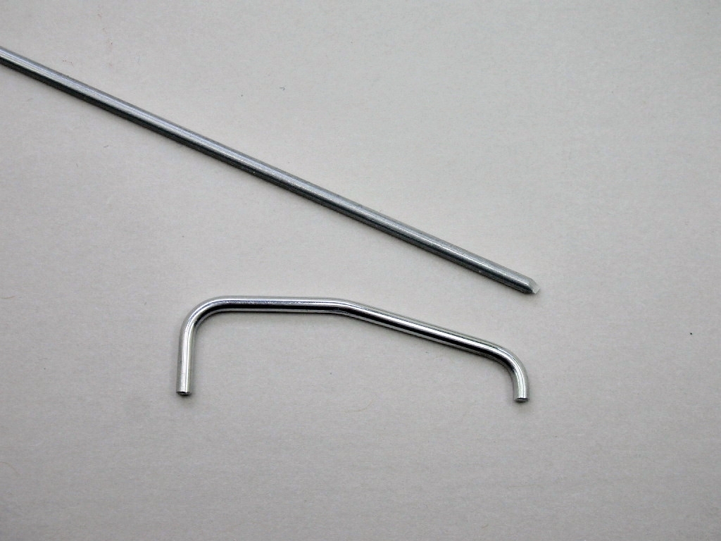

Now seemed as good a time as any to make my roll bar from 1/16" aluminum rod.
The body has deep molded in recesses where the roll bar has to fit so it had to be bent precisely. The third time bending one was a charm:

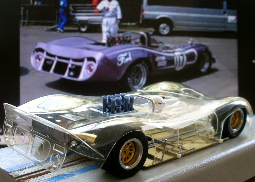

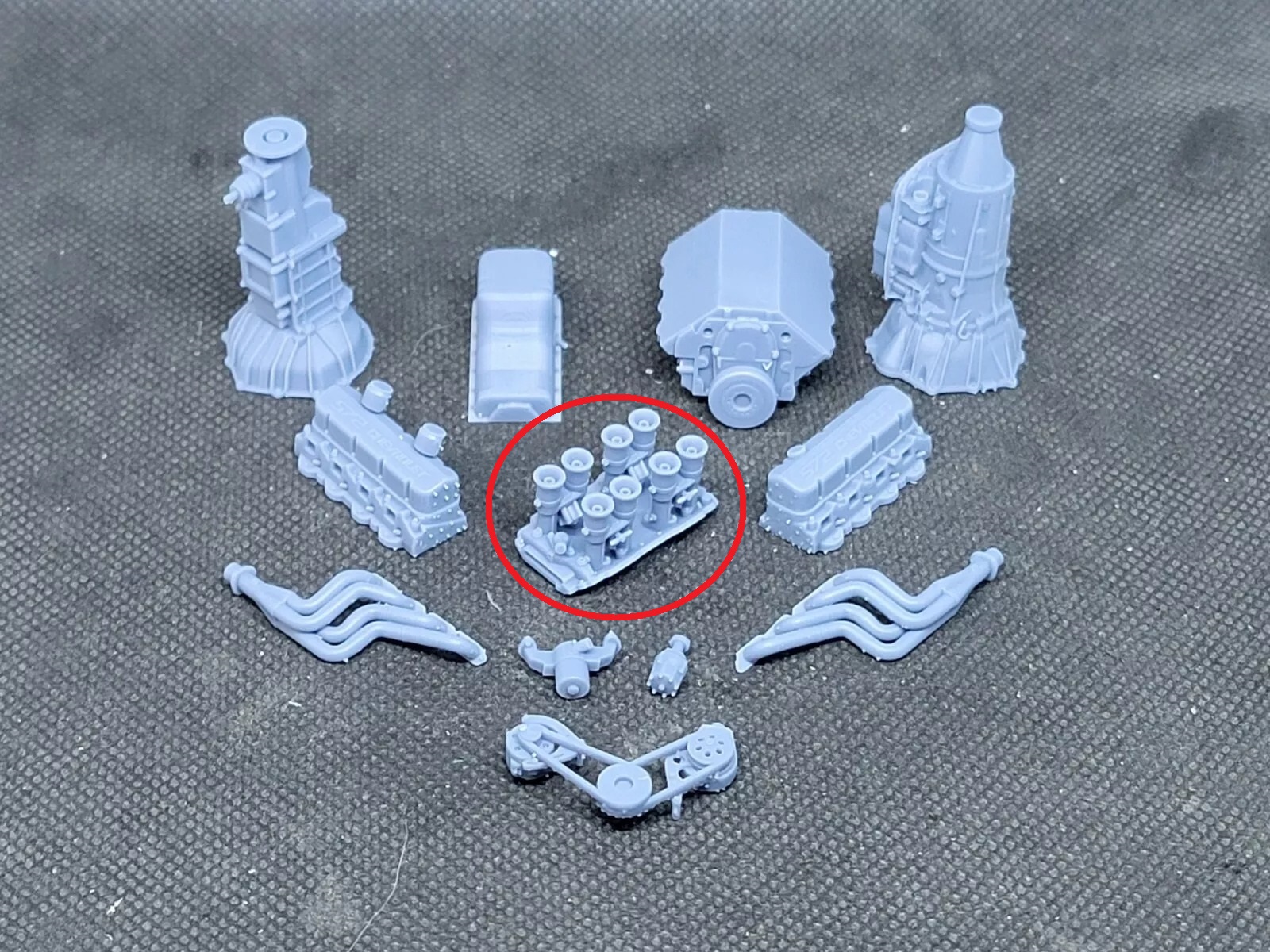

I believe the Honker initially had an opening just large enough to clear the carburetors. Later that opening was enlarged greatly as shown below:

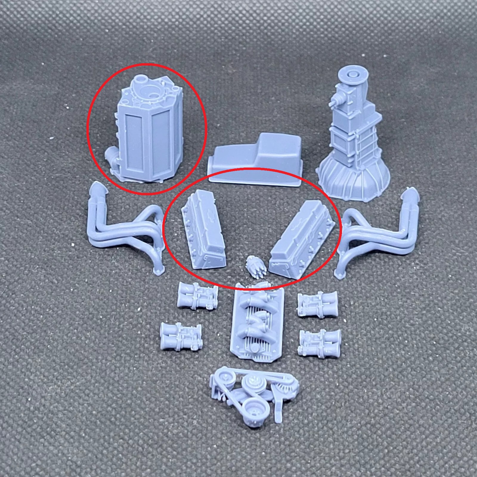

I struggle at the art of plastic model making but I wanted to do a bit more than just velocity stacks or even Weber carbs with stacks. I found some nice model engines on eBay.
I used the manifold and Weber's circled in red from this big block Chevy engine..............
.................and the block and heads from this small block Chevy engine:
Yes, I know, the Honker used a Ford Windsor engine but only the valve cover will be seen and I have a fix for them.

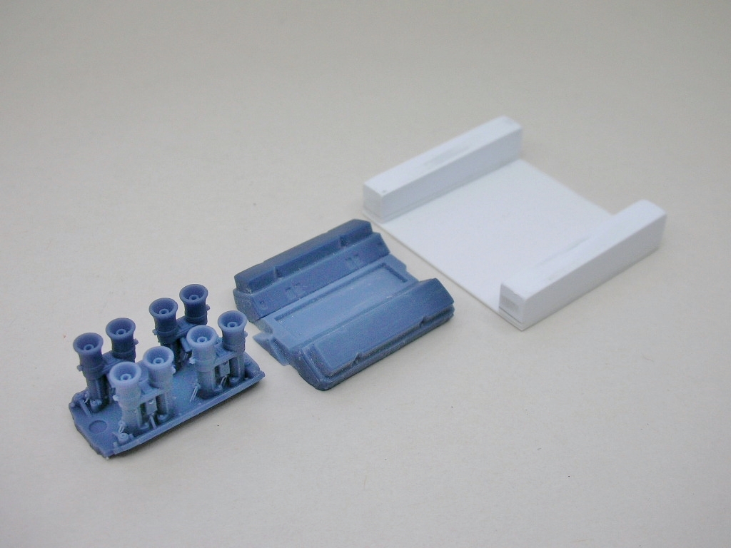

With the heads glued on the bottom of the block was sawed off:
Now I have an intake, heads with valve covers (with the Chevy emblem sanded off...   :crazy:) and a little tray made of Evergreen styrene bits to mount them under the body:
honker body (2).JPG :
This is "the look" (as my friend Rodney calls it) I'm going for:
It almost seems like the body was an afterthought that just got in the way of that glorious engine.......I love it.   :D
This is about as far as I'll be going but for you modelers out there, you can really get into detailing all the goodies the Honker's body work exposes.

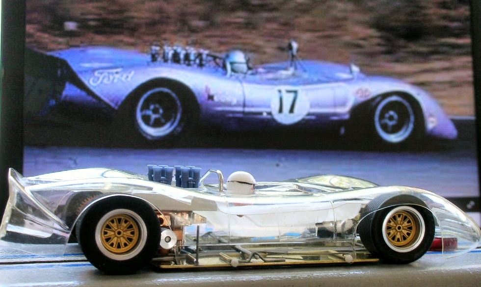

The aluminum block 427 was slated to go into the Honker, but never did. Years ago I asked Holman about why they didn't at least test it, and his response was that they knew the chassis couldn't handle it  The car was originally designed for a 3 litre Cosworth DFV motor, and to run in Europe. This is the car as it originally appeared;
They made it into an open cockpit car, and made a long list of modifications trying to make it a competitor for the American Can-Am series. Here it is, still with the Cosworth motor, and wings like everyone else was trying in Can-Am;

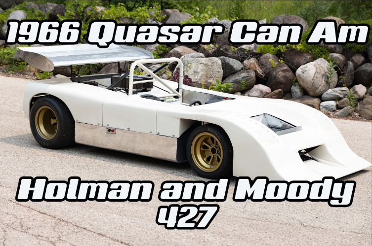

The big block eventually went into this car that Holman-Moody had previously designed and built from the ground up;
And Rick; I wouldn't loose any sleep over it. At this point, you have gone well beyond the limit expected in a slot car.

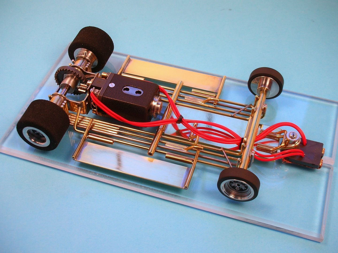

I built a period "korrect" Pro car version of the Lancer Super Comp low and wide Honker. That "era" was early 1968 and here is my Steube inspired roller:
I might be wrong but I don't think comparing my scale anglewinder to the inline is what you had in mind. But it might be interesting "apples and oranges" comparison.

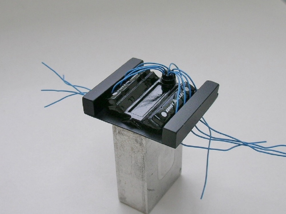

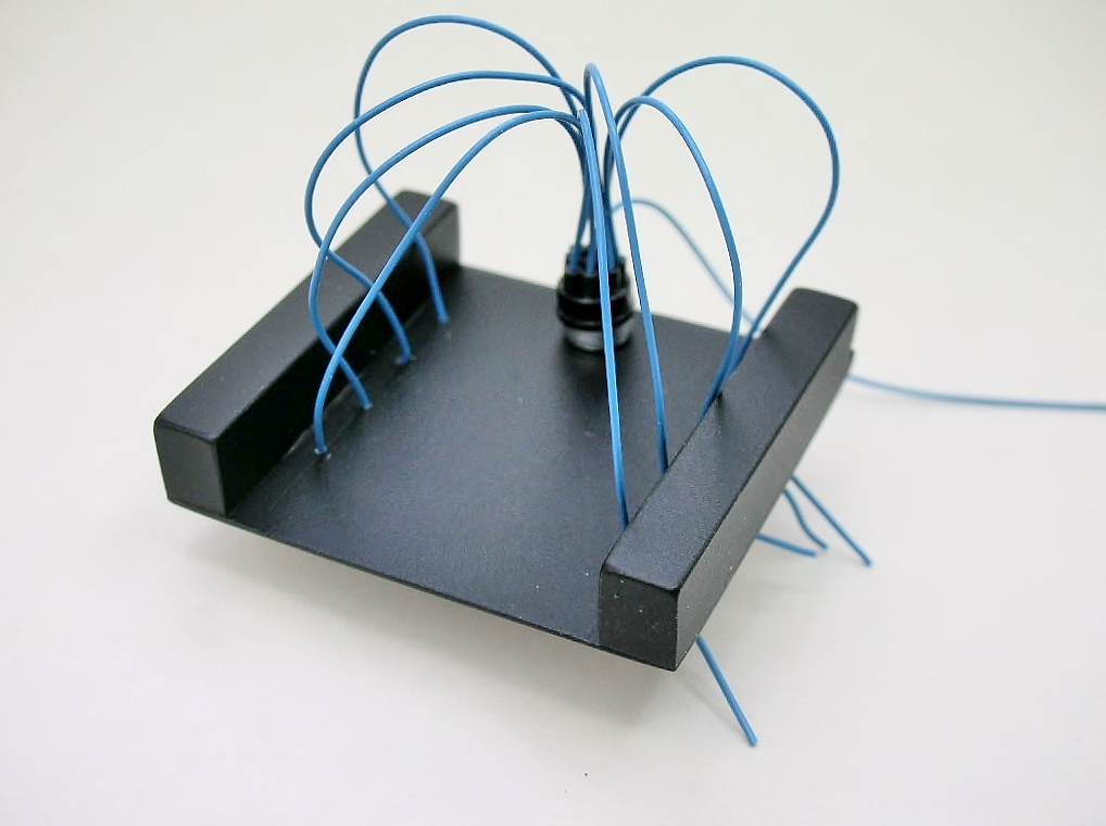

To spruce up the engine a bit I found this really nicely made pre-wired distributor:
It's available with a variety of spark plug wire colors:

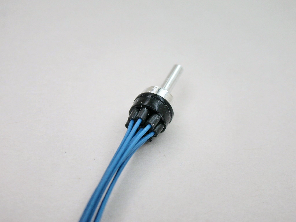

I drilled 8 holes under where the valve covers will be for the wires to fit into:
YIKES!
Once the intake is installed I can pull the wires the rest of the way down:
