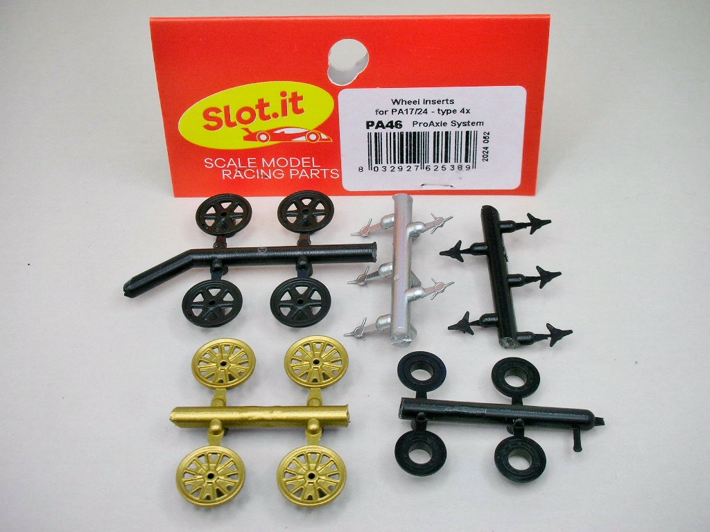

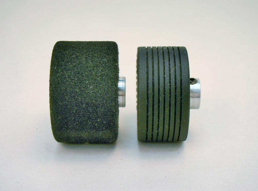

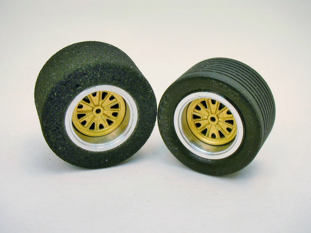

With the motor ready to go I moved on to the wheels and tires.
The current restored Honker uses these wheels:
I found these very similar wheel inserts by Slot.It:

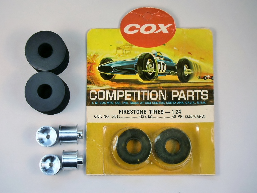

For wheels and tires I'm going with the same setup I used on my previous build, the scale body King Cobra.
Reproduction Russkit extra wide rear wheels for the fronts and the "mythical" super wide for the rears. Front tires are Cox Firestone rears and Alpha humongous donuts for the rears:

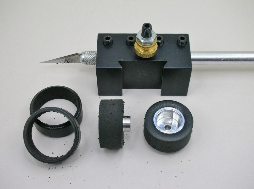

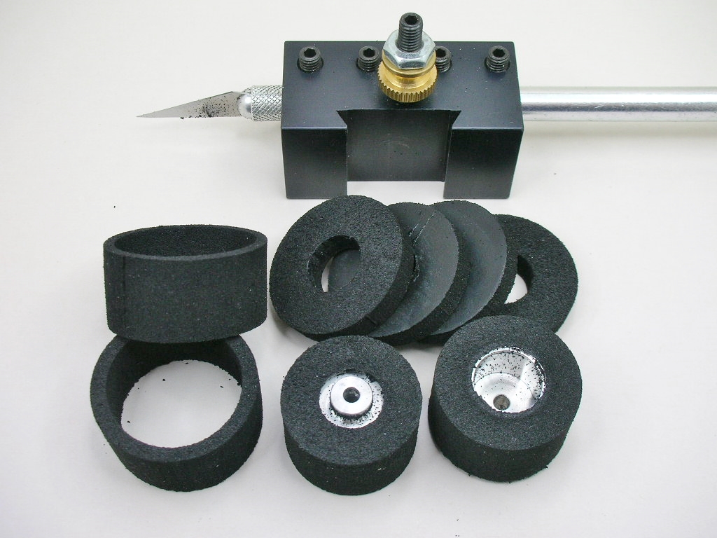

I'm really liking using my little hobby lathe with an X-Acto knife to closely trim tires. I can get the tires really close to finish size to minimize grinding:
I've always liked gold wheels. In the 70's I painted the centers of the American Mags on my Datsun 510 BRE TransAm tribute car gold. So I'm leaving these inserts gold:
I cut treads in the Cox front tires. A MESAC touch I really like:
Now I can assemble the roller and get the body mounted.
  • Pablo, Tex, justDave and 3 others like this

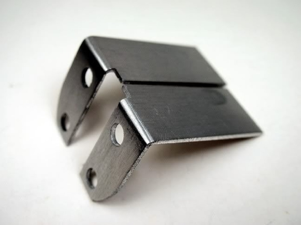

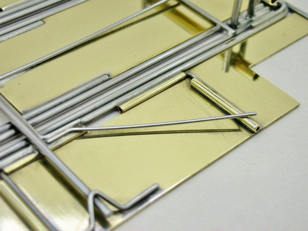

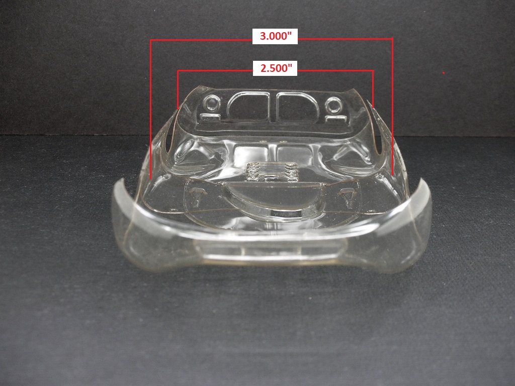

With the wheels and tires on the chassis I mounted the body. The bodies relatively tall sides and thin plastic allow it to lean way off center and flop side to side like crazy.
I installed little L- braces at the back of the pans to stop that:
Also, the bodies sides are tapered. The body is 3" wide at the top and tapers to just 2 1/2" wide at its bottom:
This squeezes the pans on the 2 7/8" wide chassis and pulls the pans all the way up to their stops. I installed wire springs to stop that:
With the body mounted it now has nice "loosey goosey" movement but stays centered on the chassis.

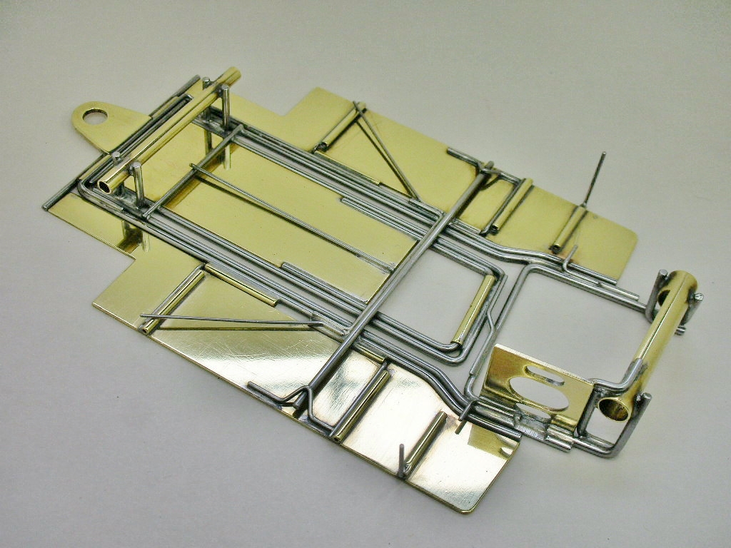

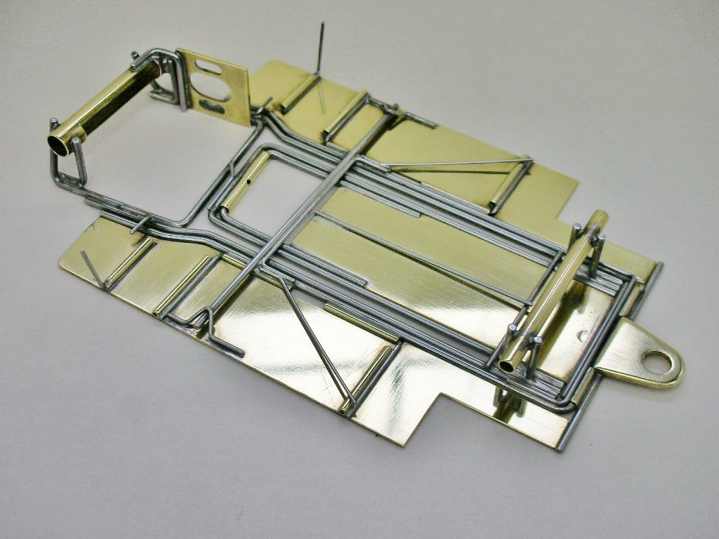

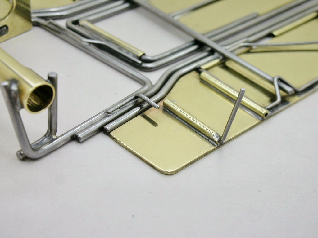

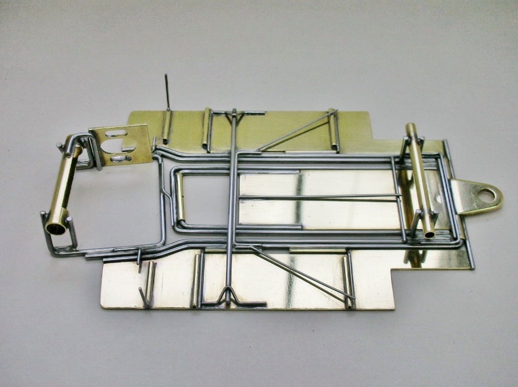

Speaking of the chassis here it is all spiffed up:
  • Pablo, Jencar17, Tex and 8 others like this

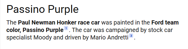

We are talking about this color ? Love this color.
#117 Eddie Fleming
Eddie Fleming
  • 2,968 posts
  • Joined: 27-April 14
Posted 16 May 2025 - 10:23 AM
Am I correct in thinking that was the same color used on Fireball Roberts Ford's in 63/64?
Eddie Fleming
#118 Martin
  • 4,361 posts
Posted 16 May 2025 - 10:33 AM
Sure looks like it to my eye  :crazy:
#119 Dave Crevie
  • 4,806 posts
Posted 16 May 2025 - 02:01 PM
"We are talking about this color ? Love this color."
That's the color. I wouldn't be surprised if it is the same color on the #22 Ford Galaxie. Couldn't find any verification of that, though. Here's what the web says on the Honker. (I spelled Passino wrong)
I don't know if there is a model paint that matches. Rick, if you did a body already, I would go with whatever you used. I'm sure it is close enough.

You could ask Holman-Moody to confirm Fireball's paint. Hemmings.com indicates it was metallic lavender chosen by Passino.

Thats sounds correct Bill " metallic lavender chosen by Passino" my wife says its Lavender too.  :good:
Dave "I would go with whatever you used. I'm sure it is close enough"  This is Rick we are talking about , I do not think "close enough" is in his vocabulary.

The Honker II color was the same as used on Fireball Roberts' H-M stock cars and was called "Passino Purpole" after Jacques Passino who ran the Ford performance ...
