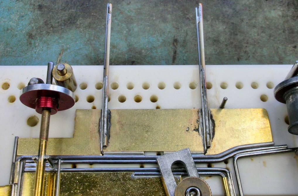

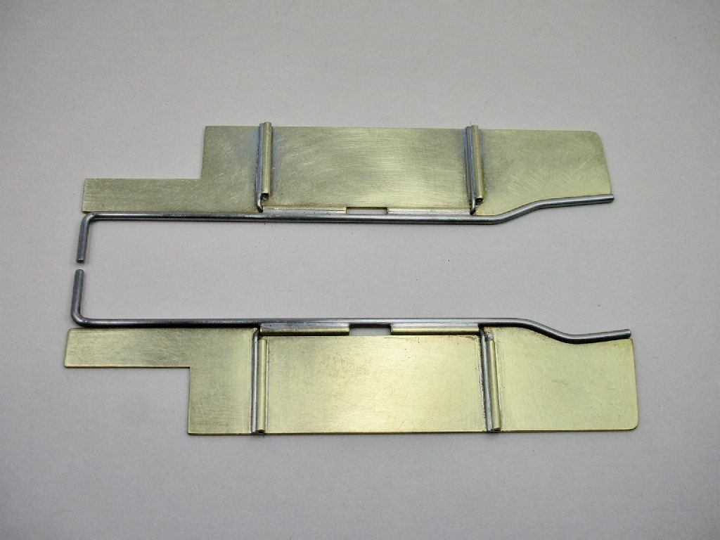

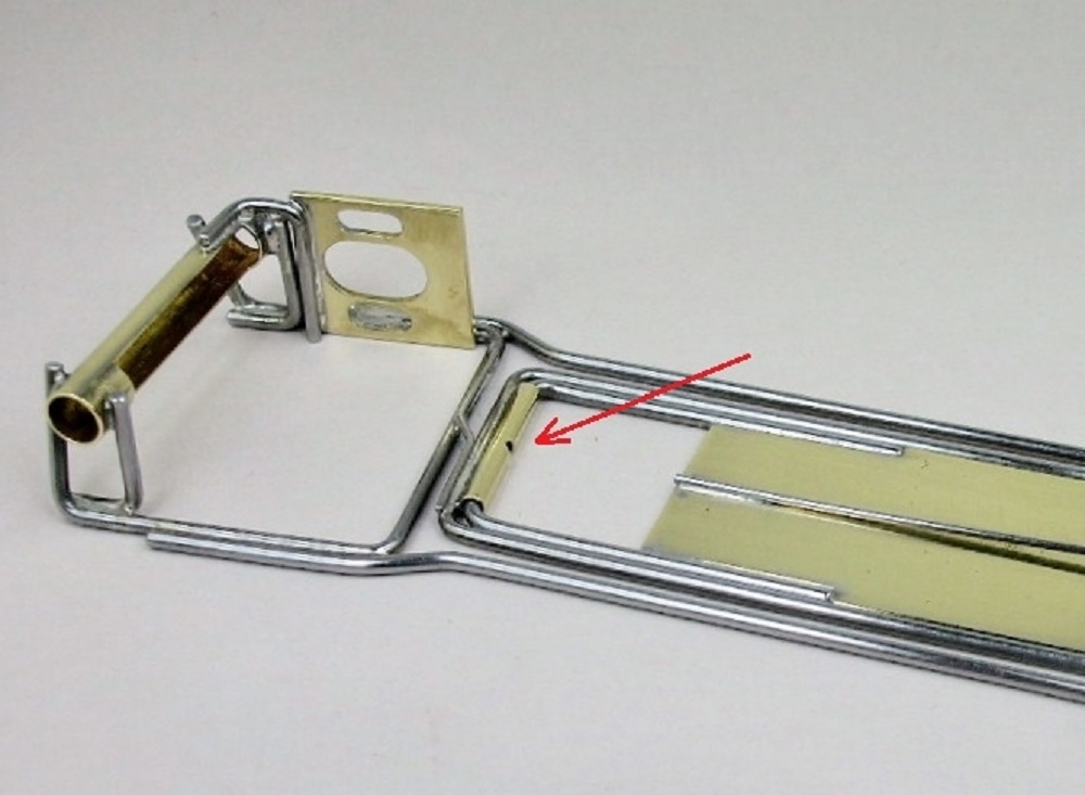

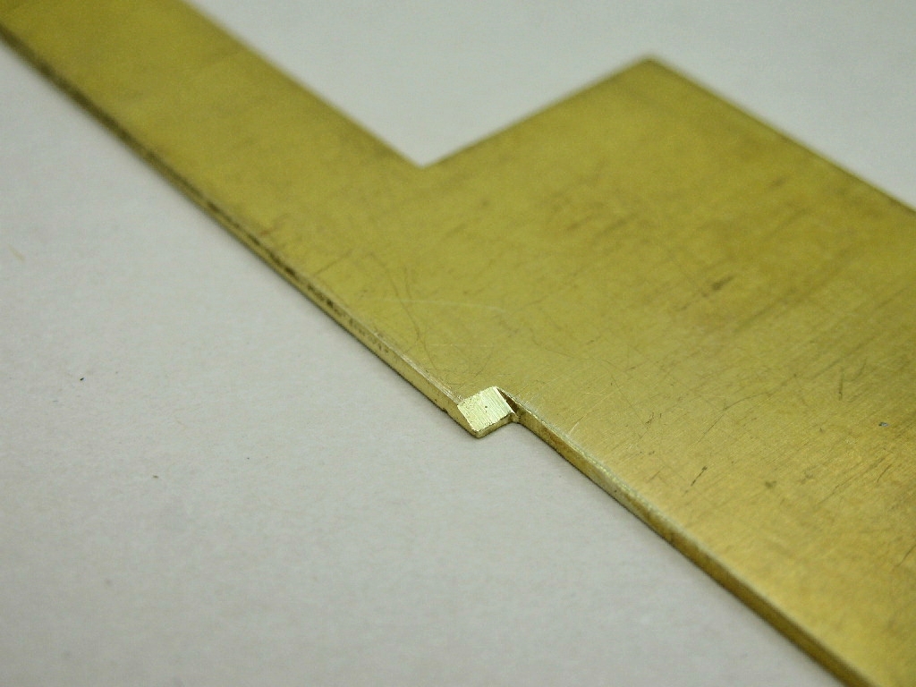

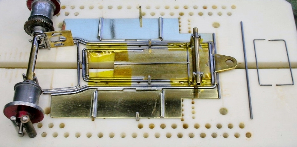

Now the pans need a little but important detail................
............a chamfer to allow room for the .032" piano wire pan hinge:

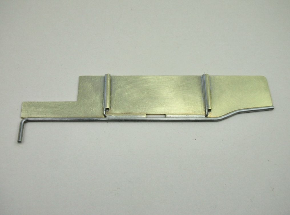

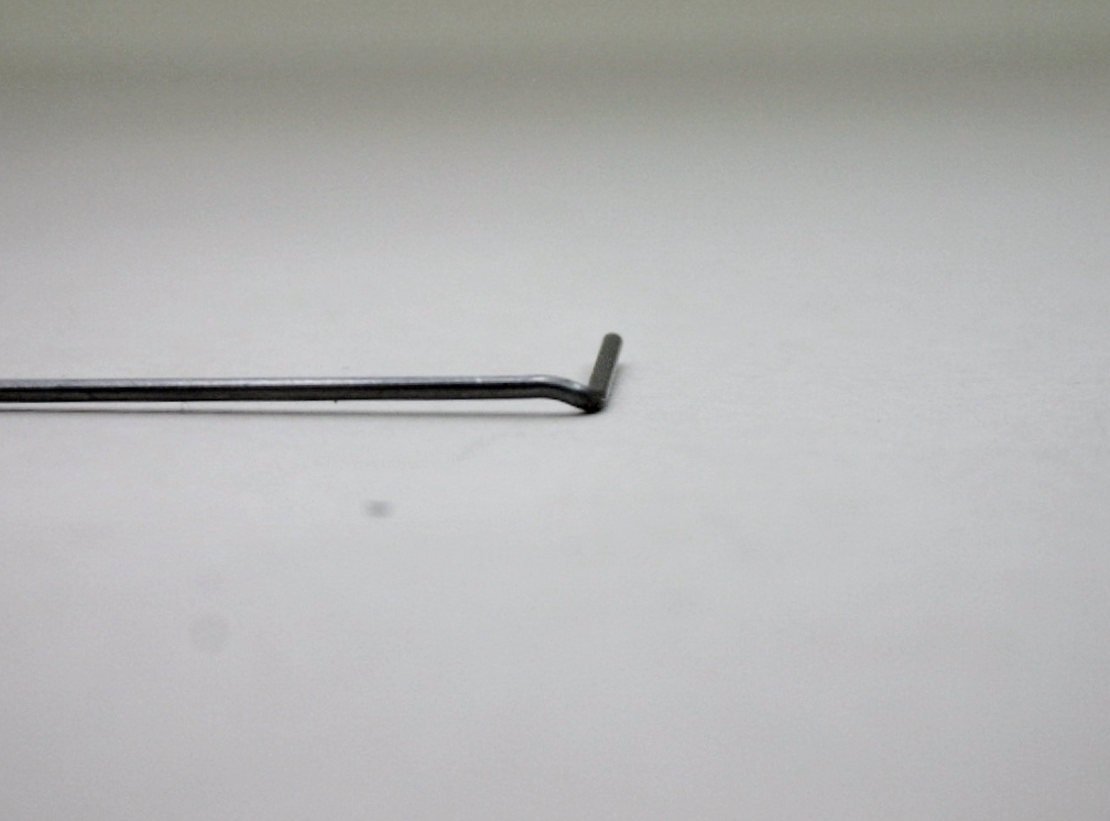

The the end of the hinge that attaches to the pan gets a little kink to allow it to sit flat:

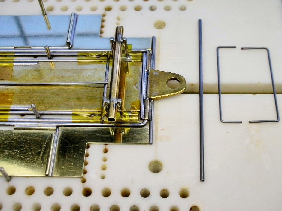

My jig setup to attach the pan hinge tubes to the plumber rails. Note the Kapton tape to prevent me from accidently soldering the plumber to the main rail:
Plumber rails ready to attach the pans:
  • Pablo, Tex, Alchemist and 3 others like this

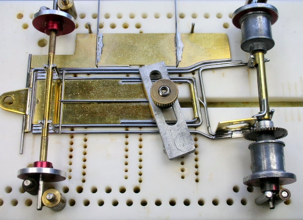

#59 dc-65x
  • 7,055 posts
Posted 17 April 2025 - 07:59 PM
Thanks John.
I appreciate the thought Mark but I'm more of a Persistent builder than a Pro builder. I keep plugging away and eventually it seems to work out.  :crazy:

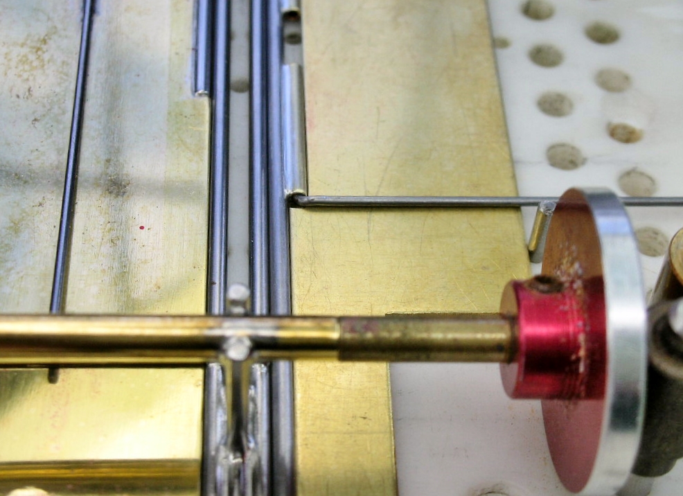

I like to solder the pan hinge wire lightly on only the one side where the body mount pin tube will go:
The pin tube is held in place by soldering to the end of the long hinge wire. Now I can run the soldering iron tip on top of the hinge and pin tube instead of on the pan itself:
That make cleanup much easier:
Time to tie the two plumber rails together:
  • Pablo, Tex, Slot Car Rod and 2 others like this

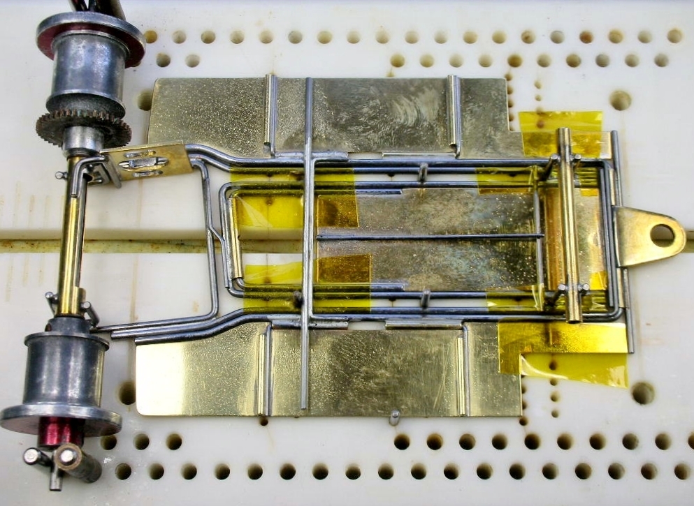

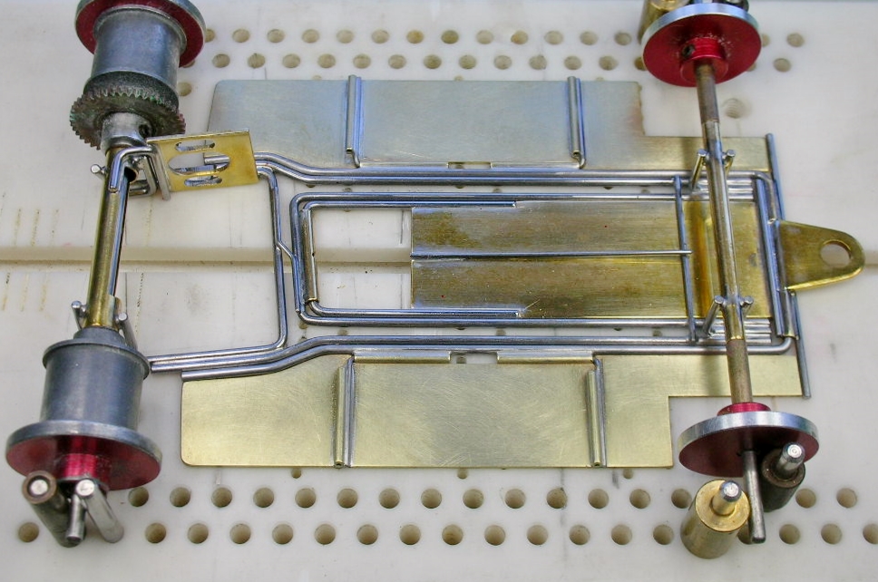

#61 dc-65x
  • 7,055 posts
Posted 22 April 2025 - 12:38 PM

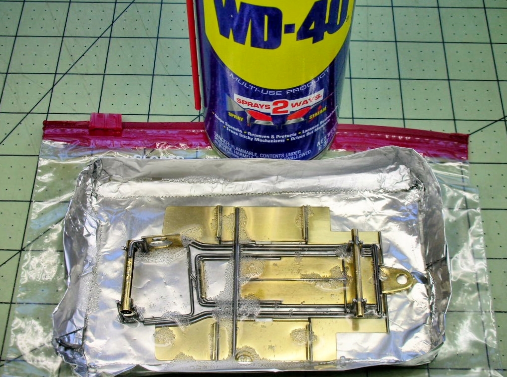

Thanks Larry. Using Kapton tape eliminates the worry of the aluminum foil slipping out of position. I used it here to solder the gizmos that tie the 2 plumber rails together:
All soldered up and acid flux splattered everywhere:
A quick wash with Dawn, high pressure air blow dry and into the WD-40 soak:
  • Tex, Fergy, Bill from NH and 1 other like this

I think I know, but what is the WD-40 soak for?
#63 Jaeger Team
Jaeger Team
  • 503 posts
  • Joined: 27-January 17
  • Location:Palermo, Italy
Posted 24 April 2025 - 03:36 PM
...so it can penetrate and break down and prevent rust, grime and others contaminants...
Maurizio Salerno
#64 dc-65x
  • 7,055 posts
Posted 24 April 2025 - 05:07 PM
Yes, I'm trying to keep the hinges from rusting shut. After washing and blowing the chassis dry I use Stoner's Gust and blow out all the water and crap-O-la I can out of the hinges:
I also drilled a "blow hole" in the blind drop arm hinge to help clean it out and get oil in:
  • Pablo and Slot Car Rod like this
