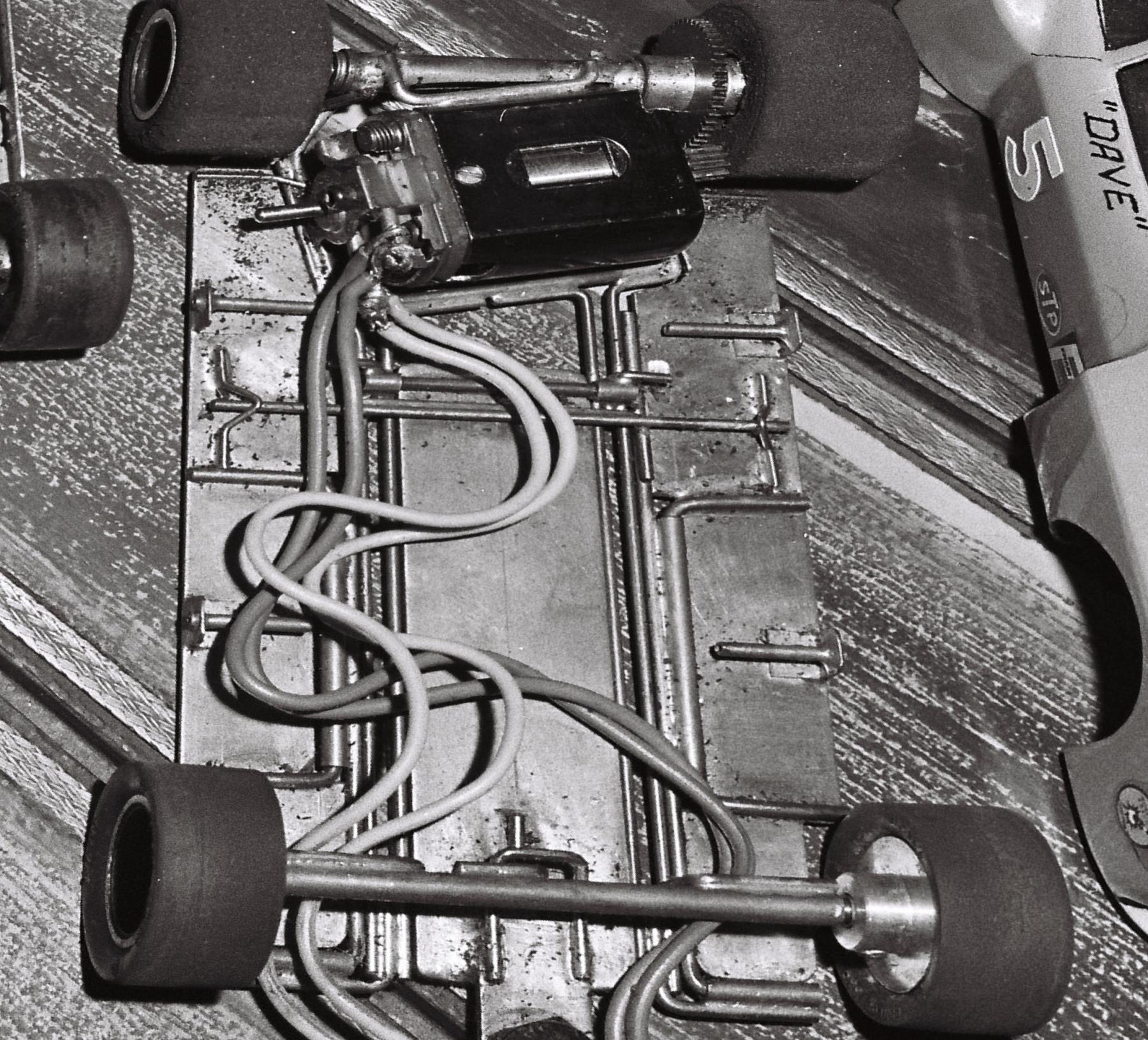

This is a MESCA with a 13. I'm going to guess that the motor in the photo is a shortened 12

Looks like a Champion 16D can & endbell to me. Note factory screw-mounting hole on top of the can.

Would it be possible to post a photo of the rear of the chassis? And, are the front wheels hinged?
Billnh, have you ever tried to enlarge a photo to match the real part? I've done it many times but I didn't have a chance to do it with this one. Pretty sure it's a 13.
#15 Bill from NH
  • 15,318 posts
Posted 17 September 2025 - 09:13 PM
I don't think Champion ever had a 13, can or endbell. But I've been wrong before. Where did
the photo in post #12 come from? The chassis is neatly constructed. Is it 1/32 or 1/24? It
looks like it has 80 pitch gears.

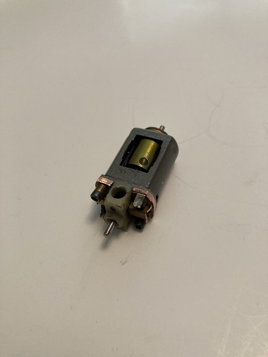

The motor is a modified 13D with an NCC20 armature, cut down Mura B-can end-bell, and mystery cut down magnets.A quote from Rodney's Porsche build

The 13D motor you posted above is not the same as what you posted in post #12. Put whatever you want in your cars.

I can see why Mark saw it as a 13D size motor. It does look narrow, but cannot tell if is the camera foreshorten things or did someone section a Champion can, "shortened 12" as Mark suggests?
The MESAC folks did like their 13D motors that we know.

Billnh, the photo was in this magazine. Amazing its survived this long.

I've been studying this for what seems like hours and hours. 🙄 One thing that has become apparent is the chassis wire(s) magically change size. Highly possible that the motor, shape shifted too. I started to lay out the pieces parts for a MESCA build and to say it's a tight fit would be a understatement.

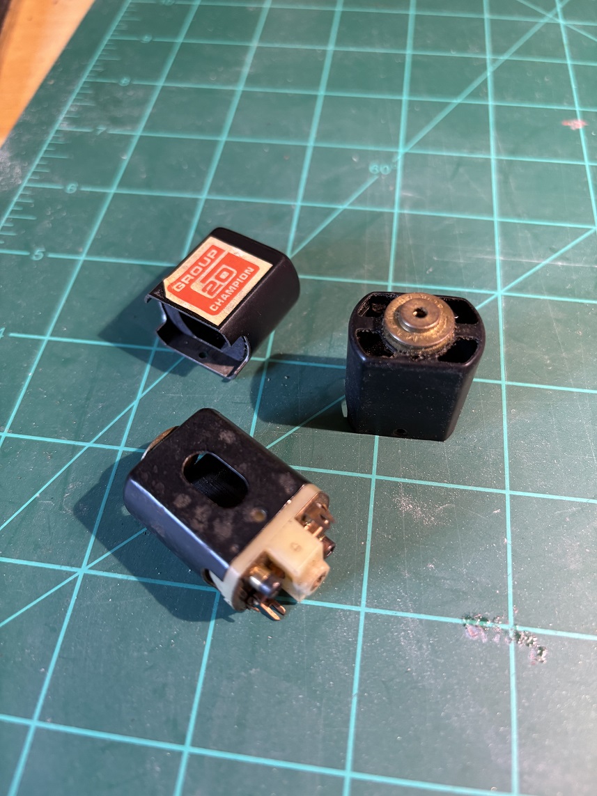

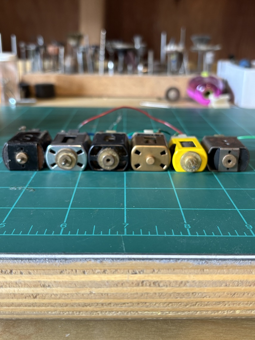

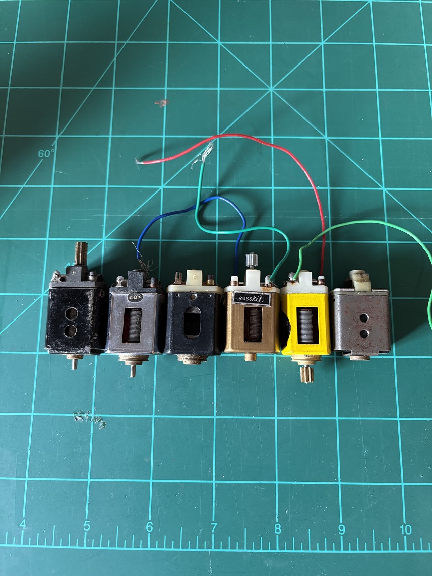

Victor says the motor is a Champion.  He says the Champions were a popular motor with MESAC and the armatures used were Group 20.  Victor supplied these motor pictures.  I will ask Victor for pictures of the bottom of the car.
Motor size comparision

Those look like a B-can, a 13D, & 4-16D size cans. The RVK car in post #! is a full sidewinder with a 13D can, the anglewinders shown do not. Could some of the later-built MESAC cars have also used C-cans?

Isn't it an A-can on the left?
