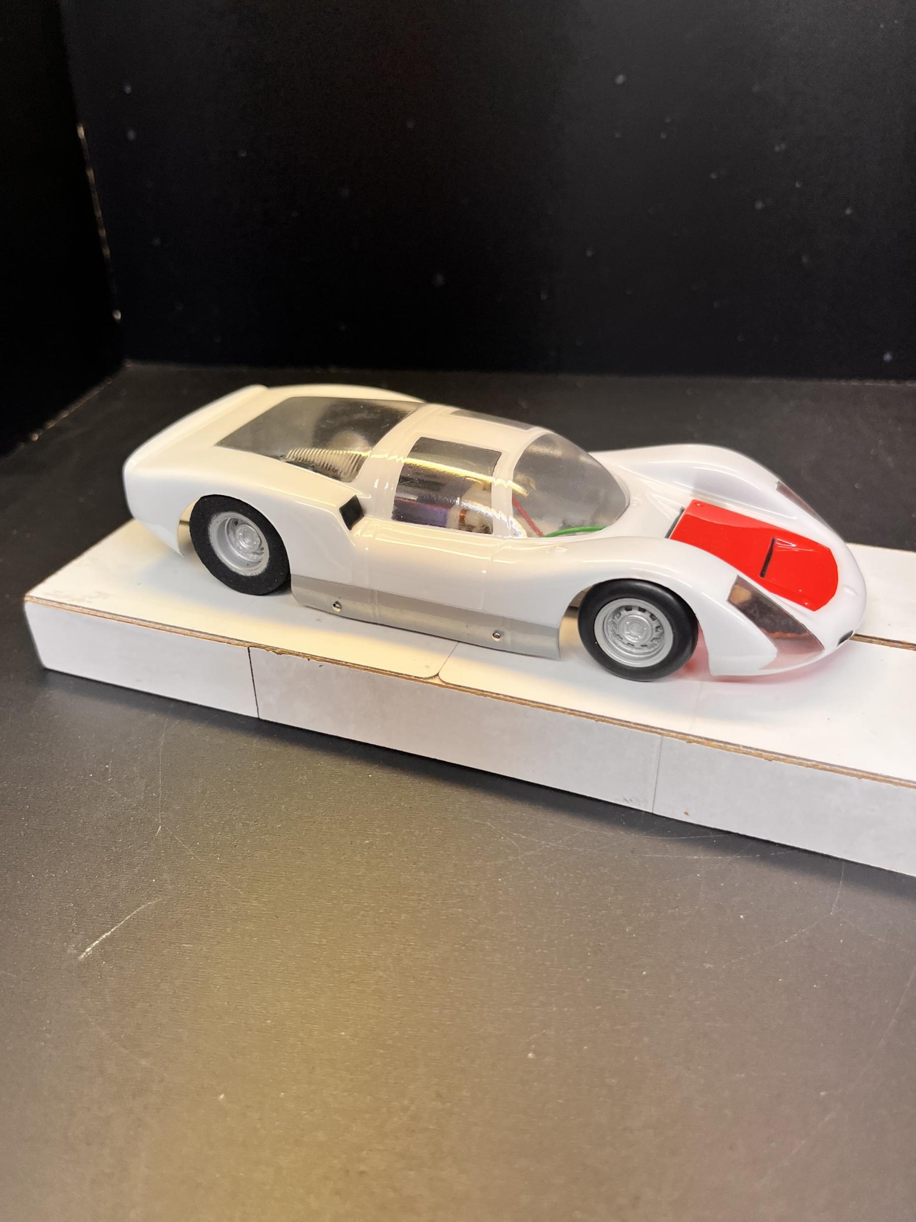

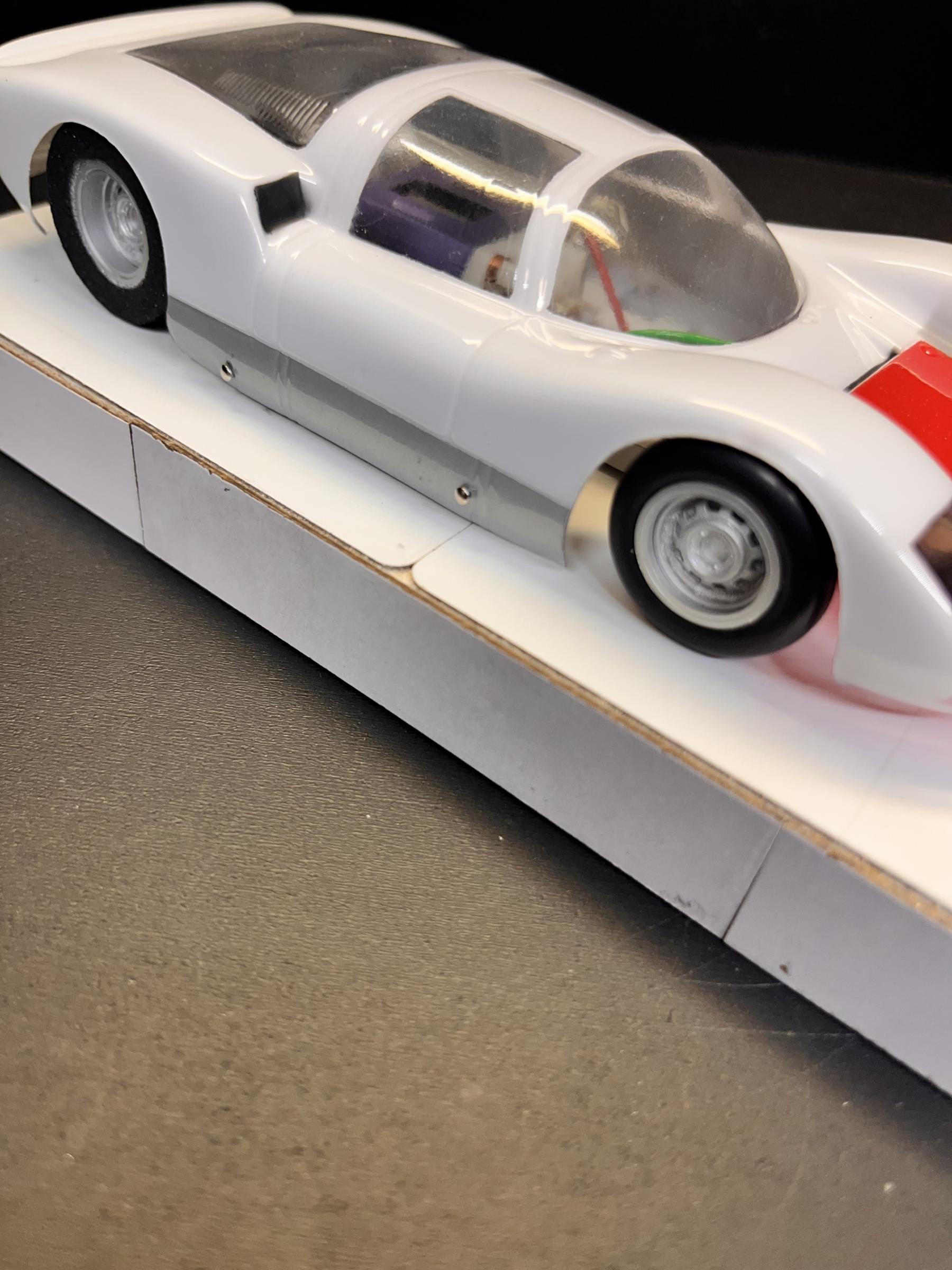

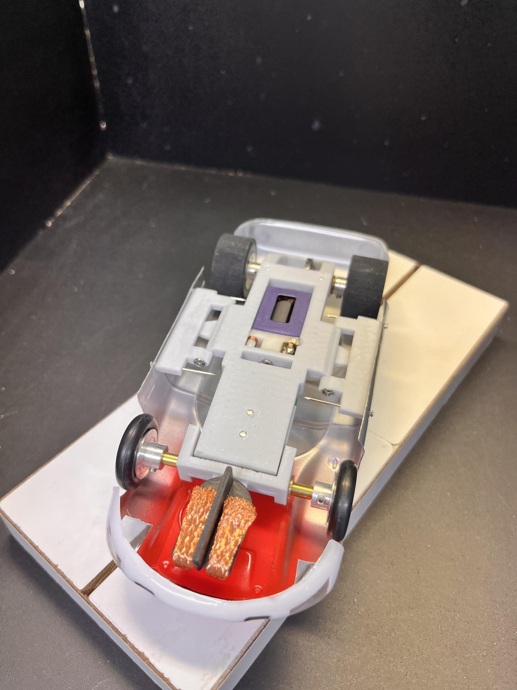

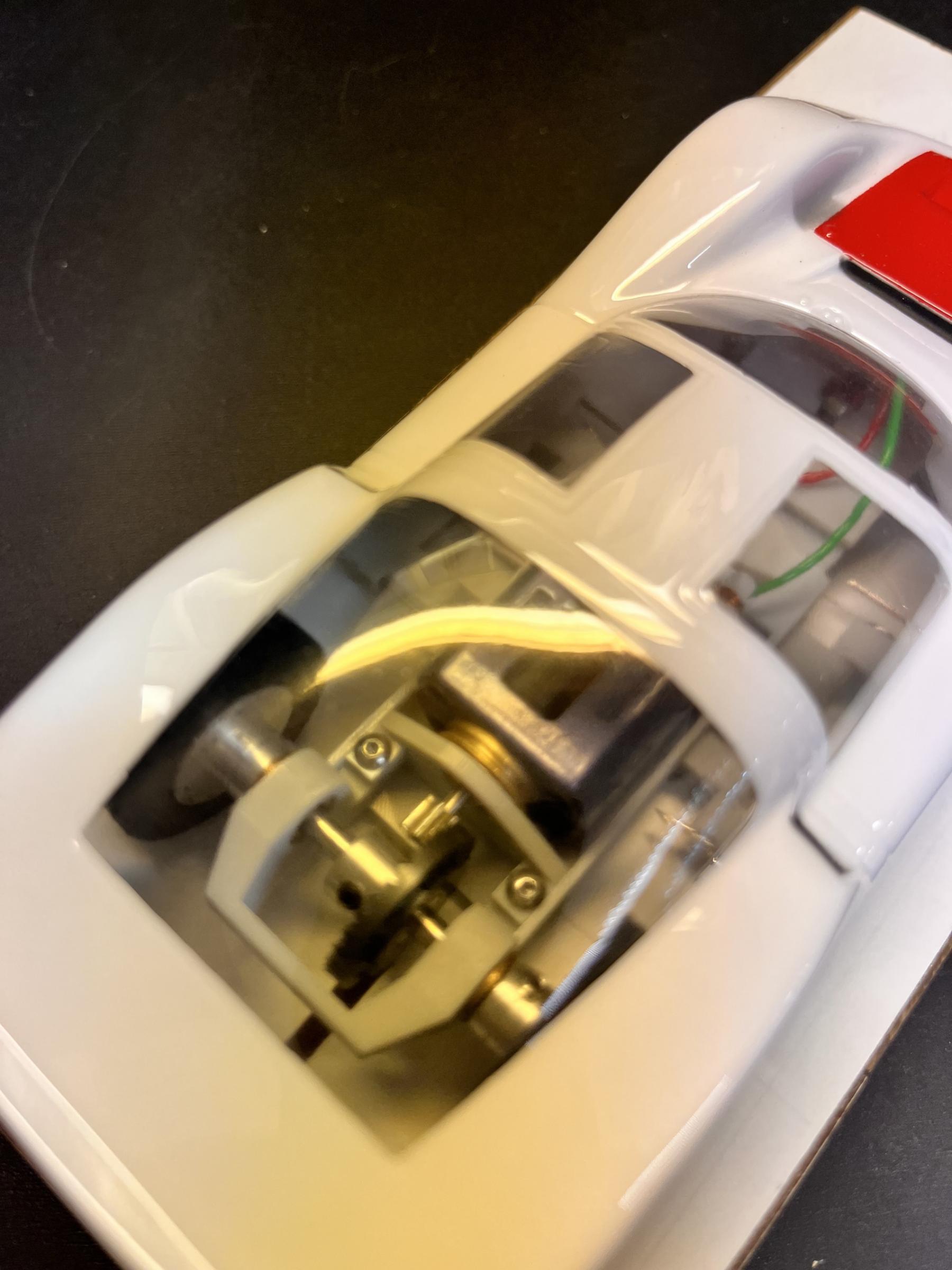

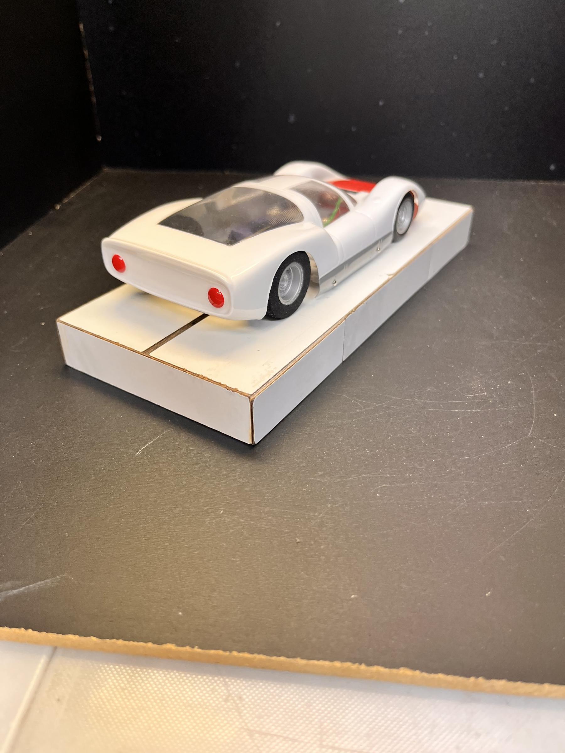

After looking at Steve's "Popsicle Stick" car I think maybe this is the place for some of my latest projects. Because they have resin printed chassis and repop bodies I'm thinking they aren't really vintage even though I use old 16D and 26D motors. The wheels are generally made by me and the tires are fresh. When I run out of Cox guides I use new ones from various companies.
Some times I try to mimic chassis' done by the brass and solder guys and sometimes I use production chassis  from Dynamic as inspirations.
Here is the latest. Dom has a Porsche 906 available and I've always liked that car since Russkit came out with the Carrera sidewinder so I grabbed one and built a car around it. Still needs decals and looking for an interior but it's ready for track testing.

Posted 06 September 2025 - 04:57 PM
This may be a Slot Car some day!! The real 2C

Posted 06 September 2025 - 05:03 PM
Very clean and tidy design Paul ... love it!
#4 Bill from NH
  • 15,352 posts
Posted 06 September 2025 - 07:16 PM
Great job building the Porsche, Paul. My first commercial slot car I bought in 1967 was the Russkit Porsche Carrera kit, The body & original motor are gone, but I've saved the rest of the parts. Someday I intend to restore that car. As you get closer to completing the Chaparral be sure to post photos of it on here.  Steve Okeefe is a phenomenally talented builder with most any material.

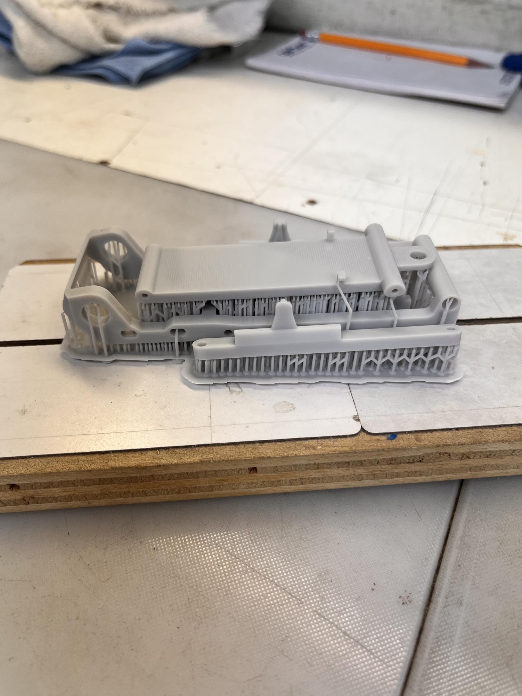

Posted 07 September 2025 - 09:06 AM
Jim the frame is resin made on my resin 3D printer. I know just enough of a software called Blender that I can design and make a chassis to play with. This one has a rear pod design similar to one I made to go with a Dynamic front tongue and axle mount. On this one I changed the front half to be simpler and stronger for the material used.
The material is a water washable resin that will break fairly easily. I call my chassis “one crashers”! But some designs have made it through several wall hits surprisingly. And of course I can always print spare parts!!

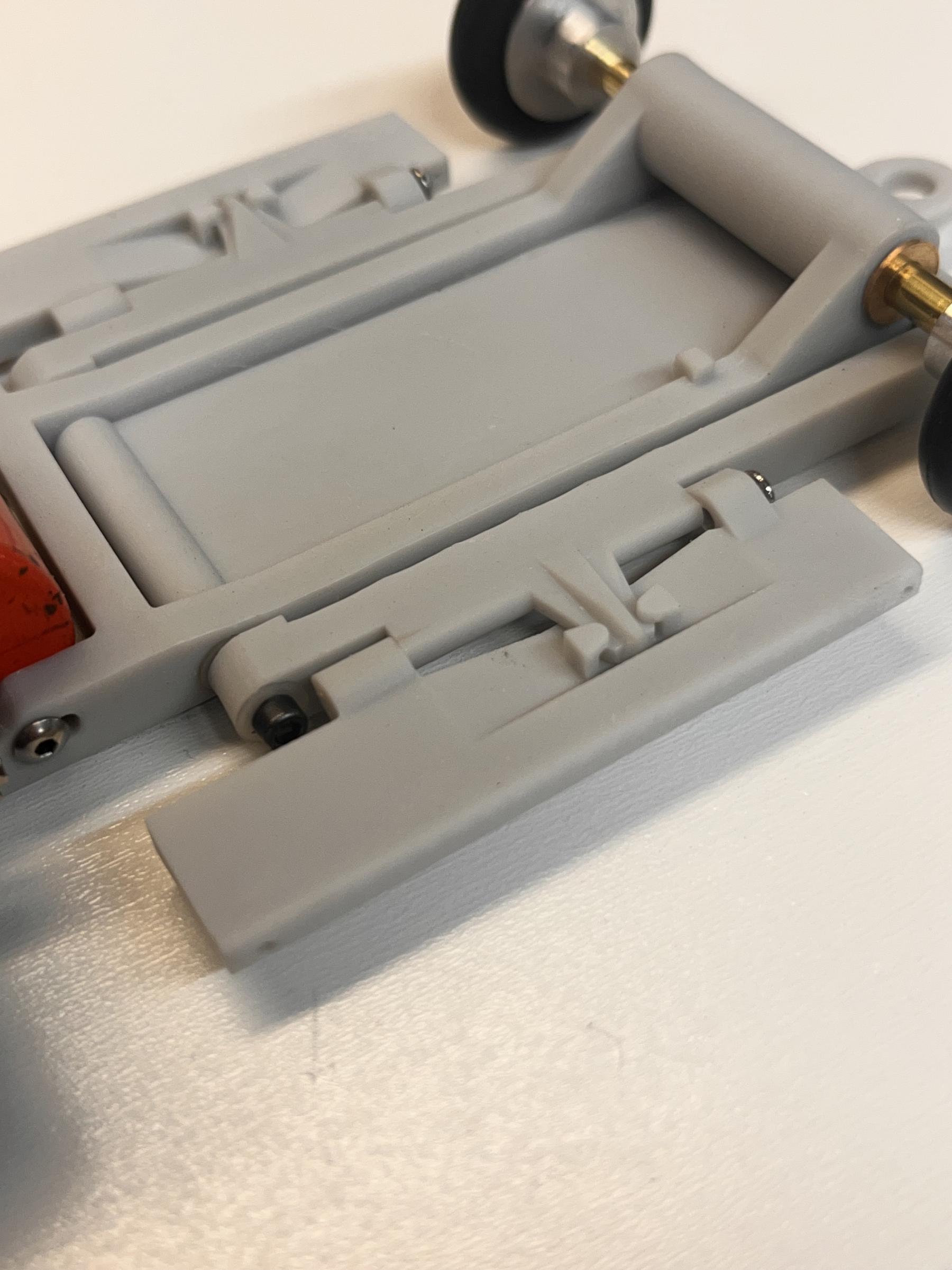

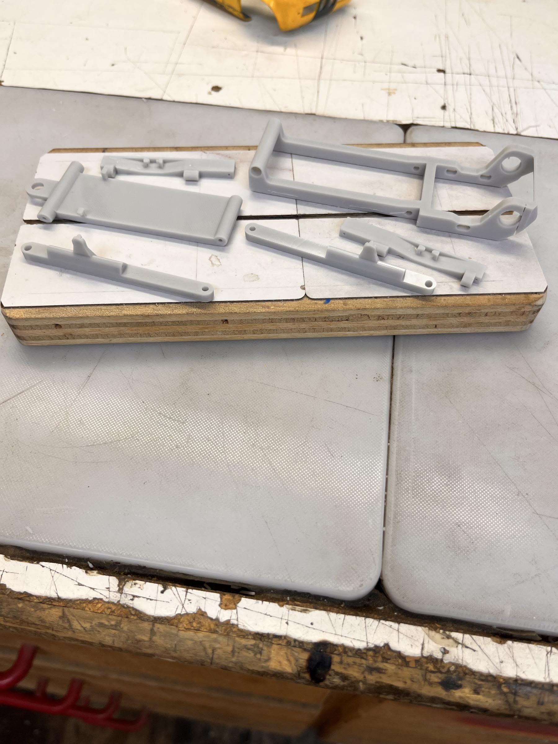

Posted 08 September 2025 - 09:49 PM

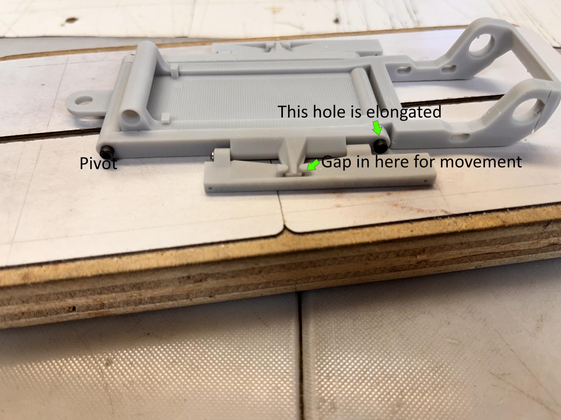

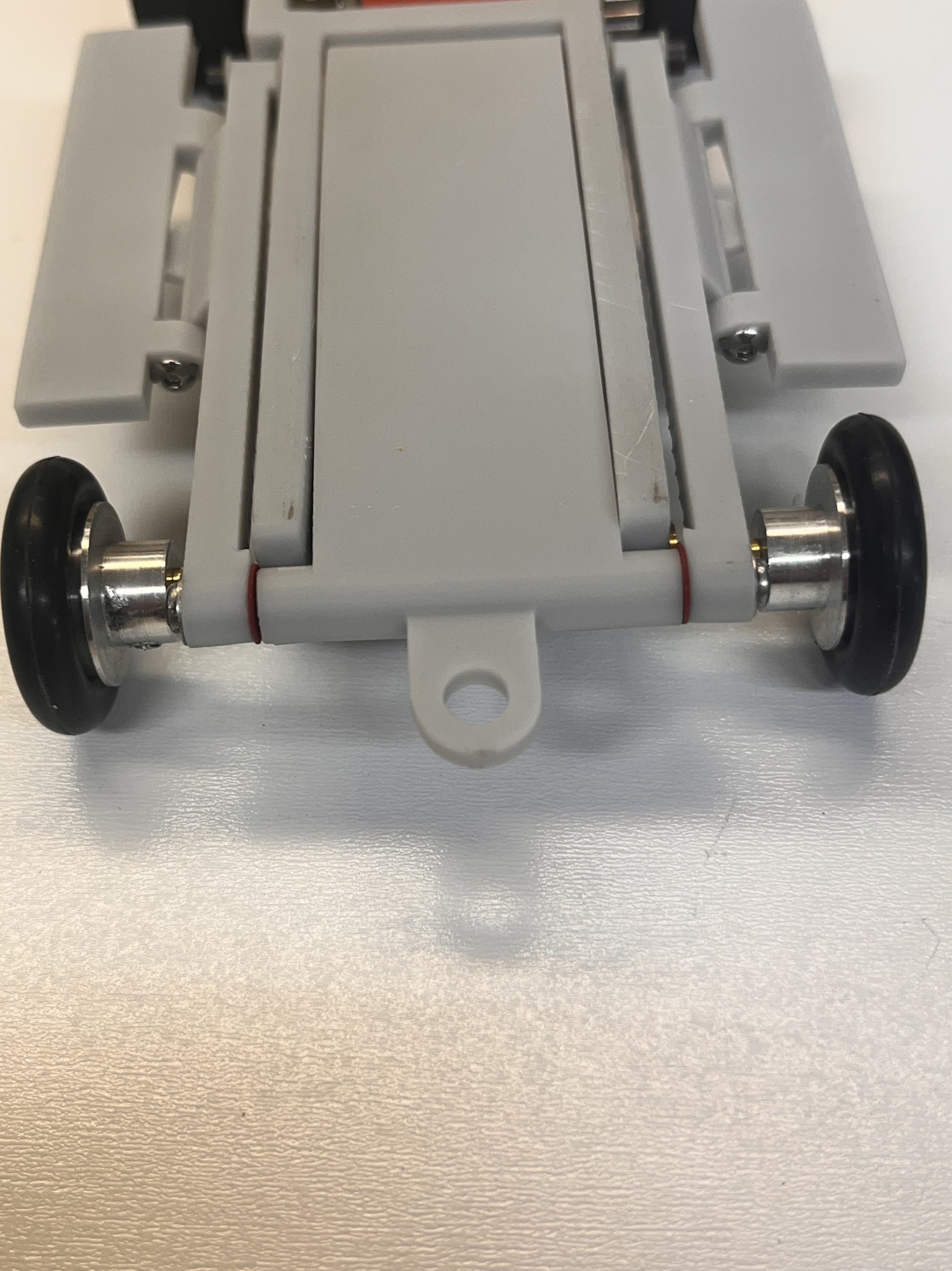

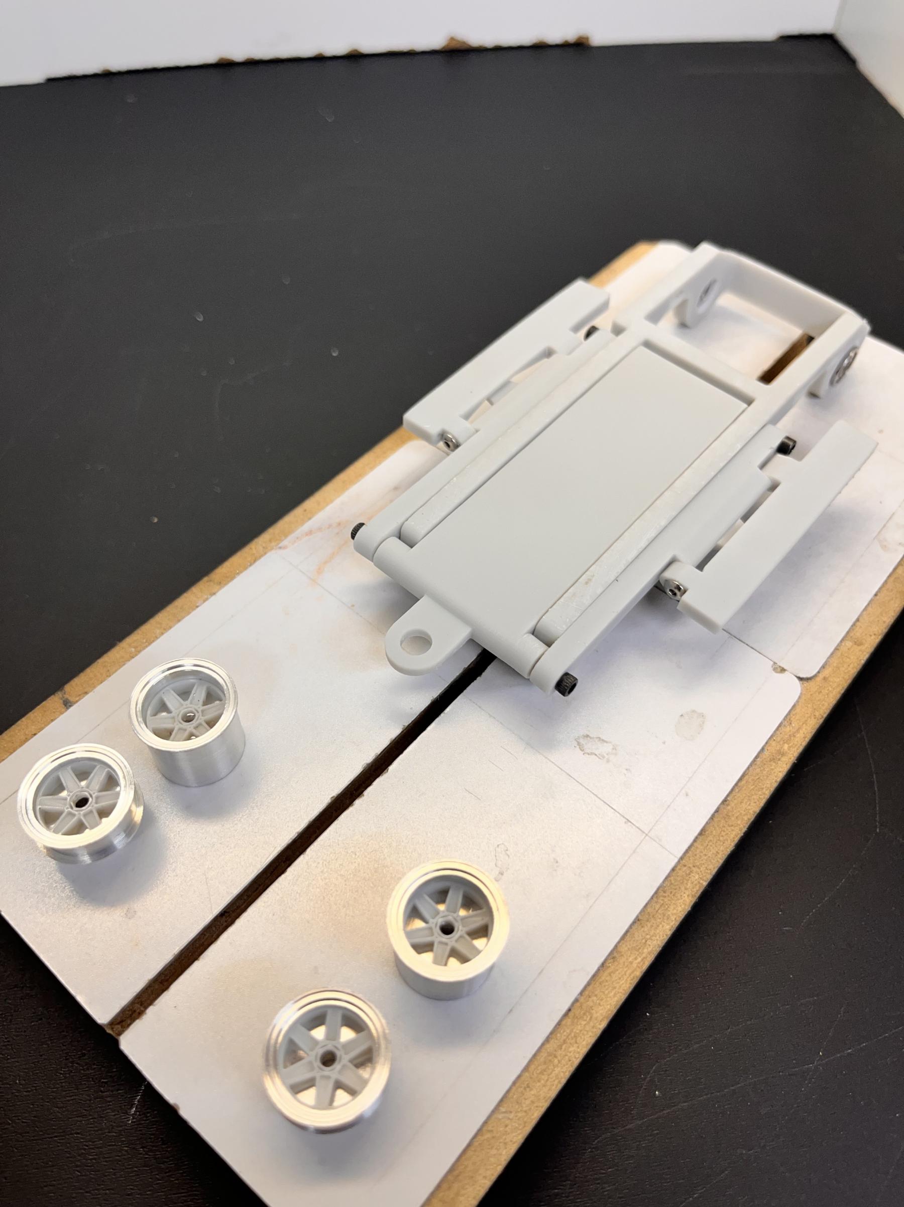

Here is the first shot at the next project...........I've already changed a bunch of stuff on it since these pictures. :wacko:
  • vfr750, Bill from NH, NSwanberg and 2 others like this
Paul Nadeau

Paul, are the rear bushing/bearing holes 1/4" or 3/16"? Which size cans will this chassis fit? Is it wide enough for a FK can? (130 mm)
#13 pn6
pn6
  • 200 posts
  • Joined: 13-December 19
Posted 09 September 2025 - 08:34 PM
Bill they are actually 5/16 x 1/8". I have plenty of 1/12 scale RC front wheel bearings which are that size and work great. I usually have to make the holes a tad bigger than I need as they seem to come out smaller after printing. Everything is done in metric because Blender seems to be easier for me to use that way. 7.94mm is 5/16 so my holes are actually 7.96mm and I still have to clearance the holes but it's all in the fun!!
This chassis is for a 26D can drive. Is an FK like a Retro Hawk? That's the only "new" type motor I have.
I haven't printed it yet but I've beefed up the front axle mount area by a bunch and the rear a bit.

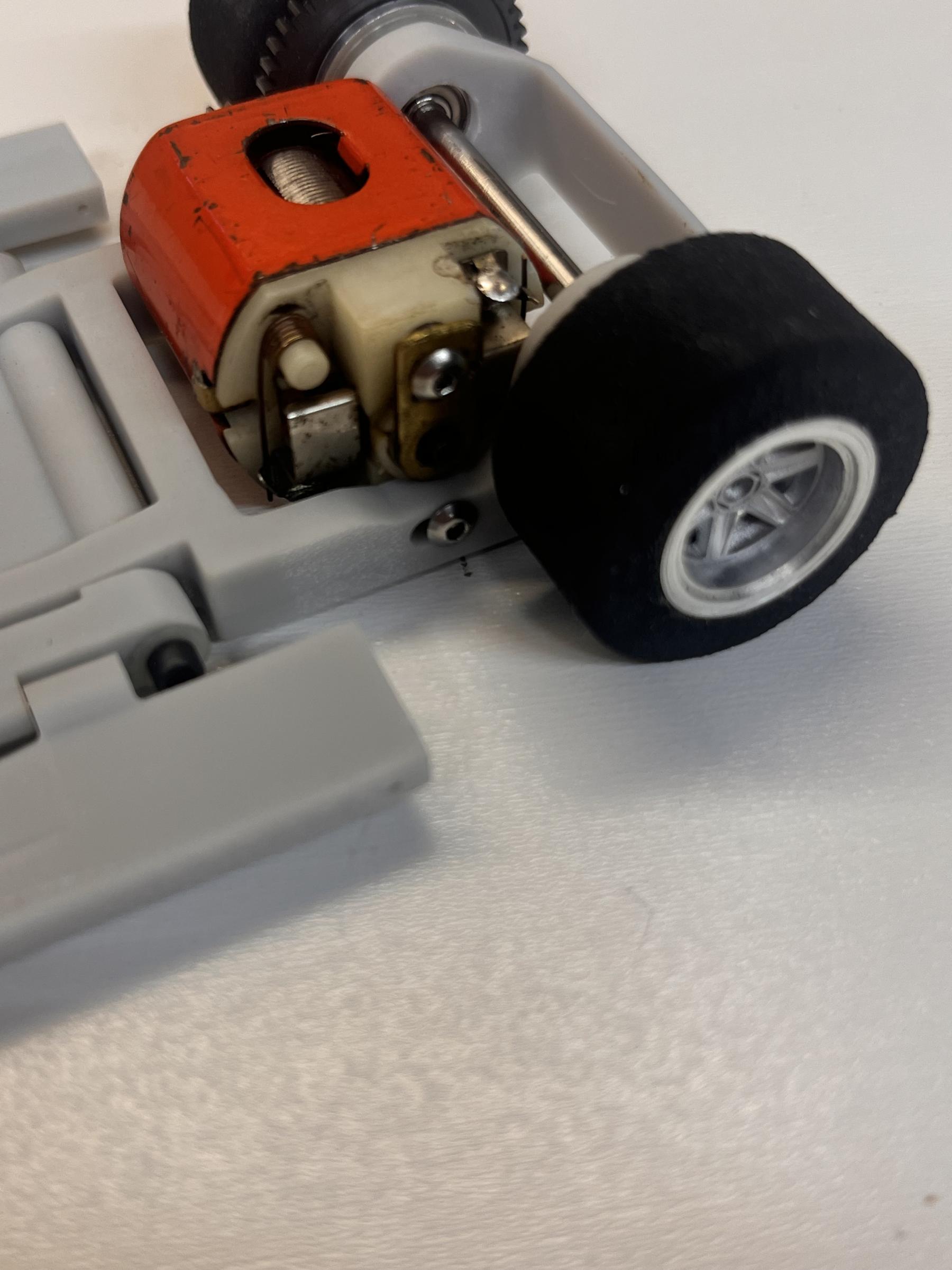

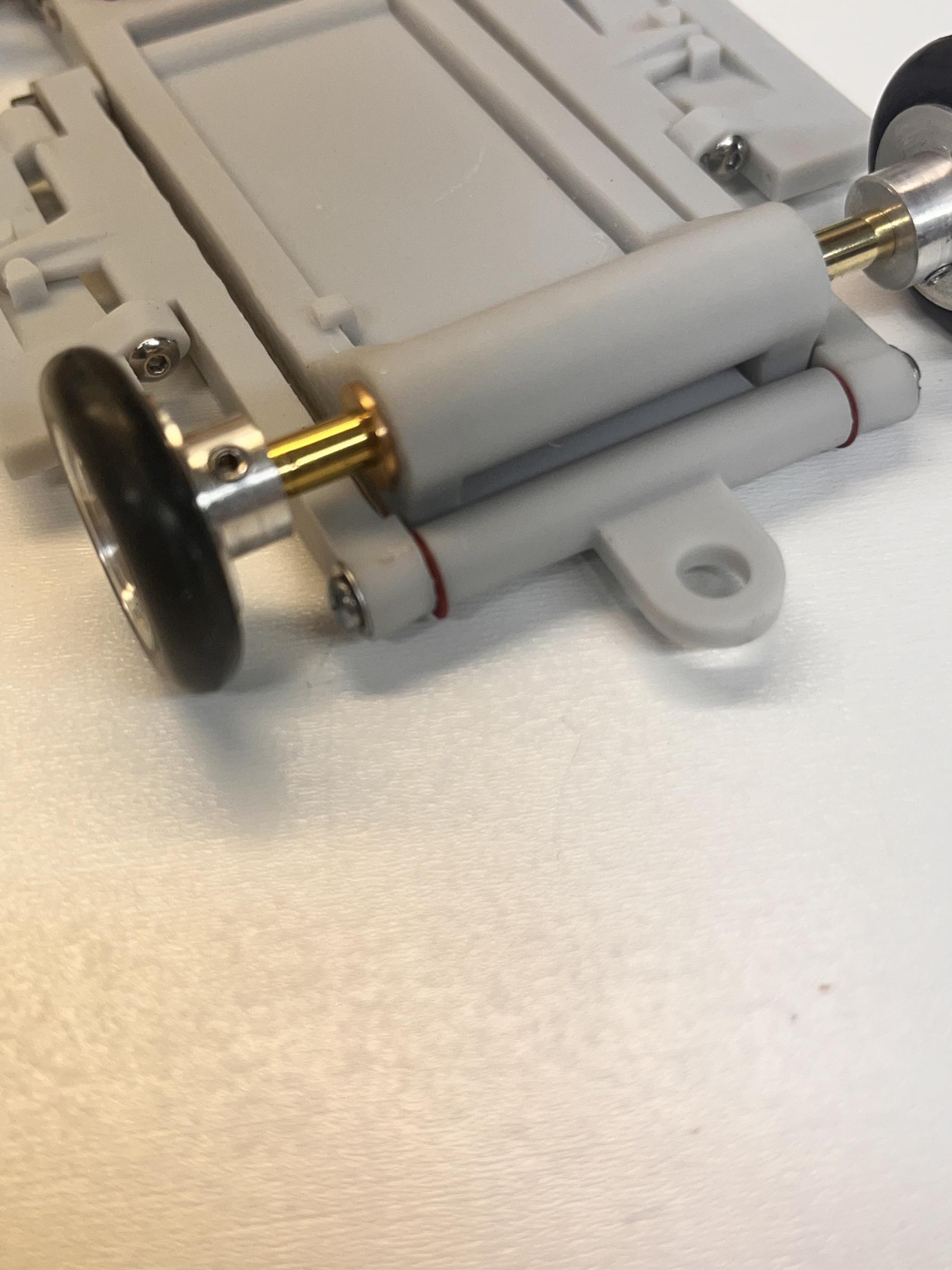

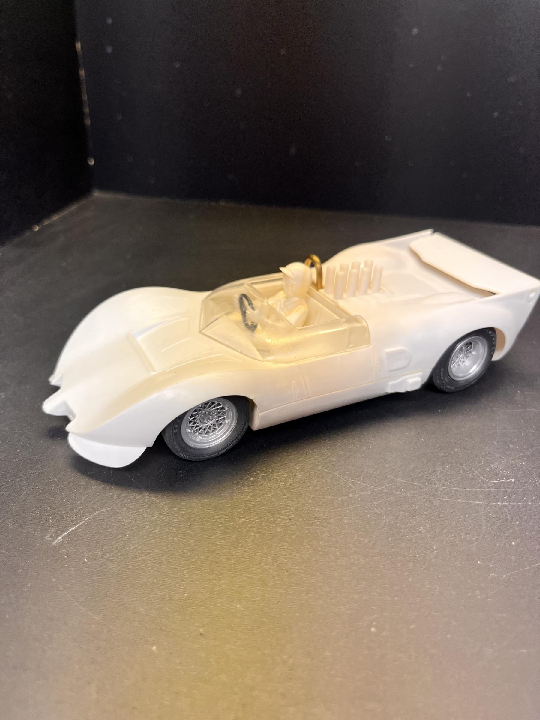

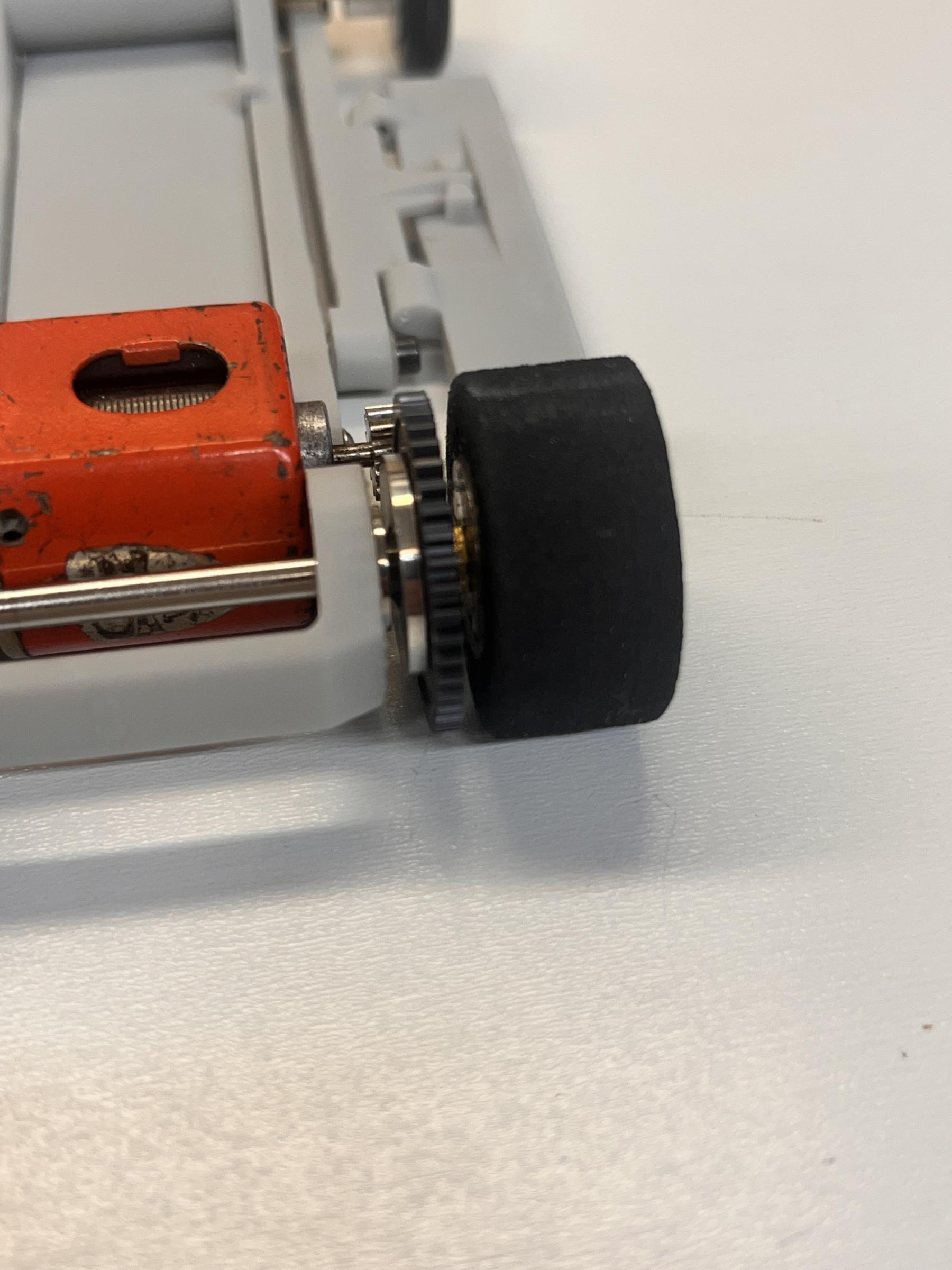

Posted 24 September 2025 - 09:51 PM
I've updated the chassis and was thinking of using a glued together IMC T70 model for a body but it's just been long summer with too many other projects. Obviously it's going to be a Lola.
  • Pablo, Tim Neja and Slot Car Rod like this

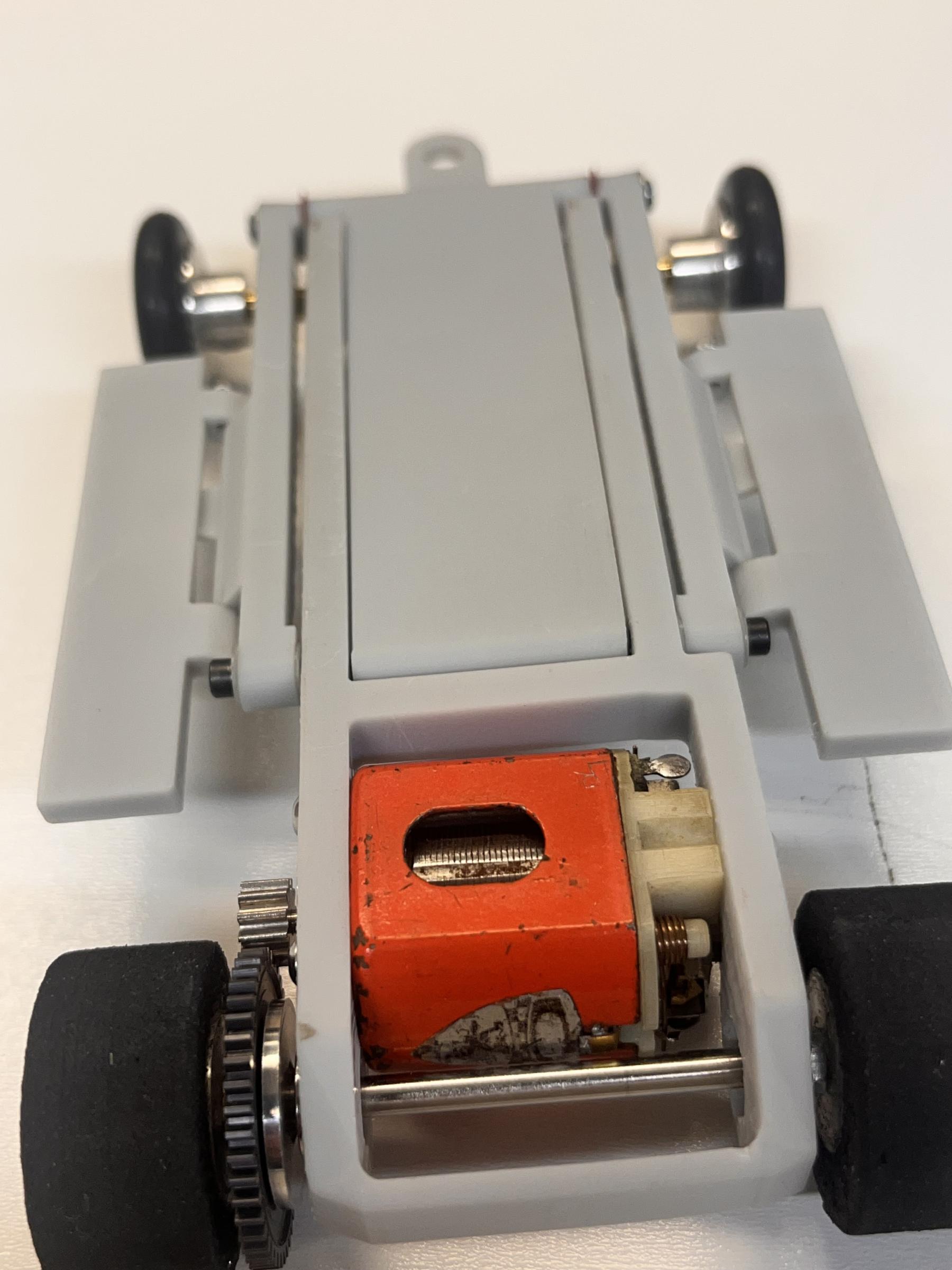

Posted 18 October 2025 - 03:32 PM

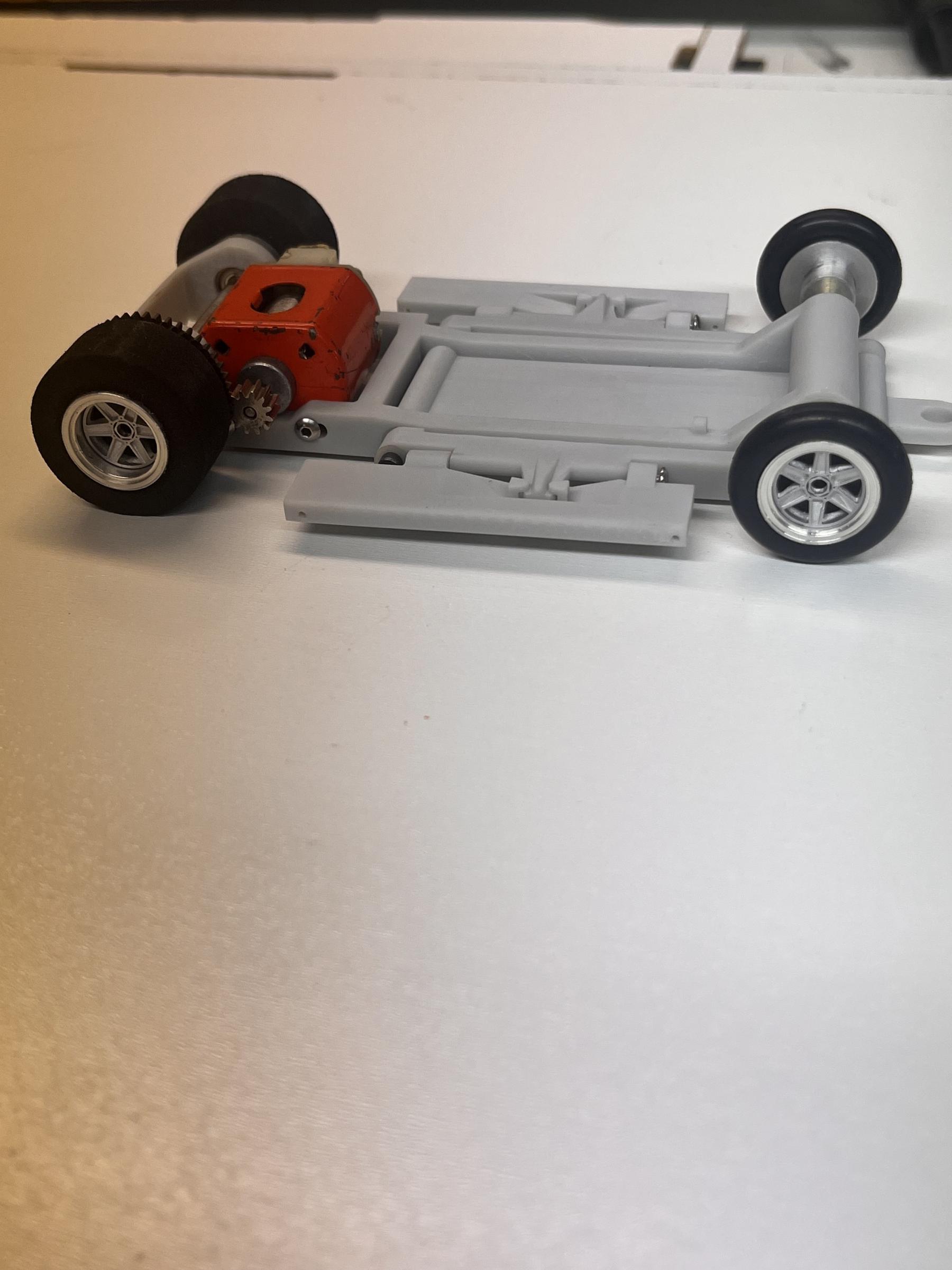

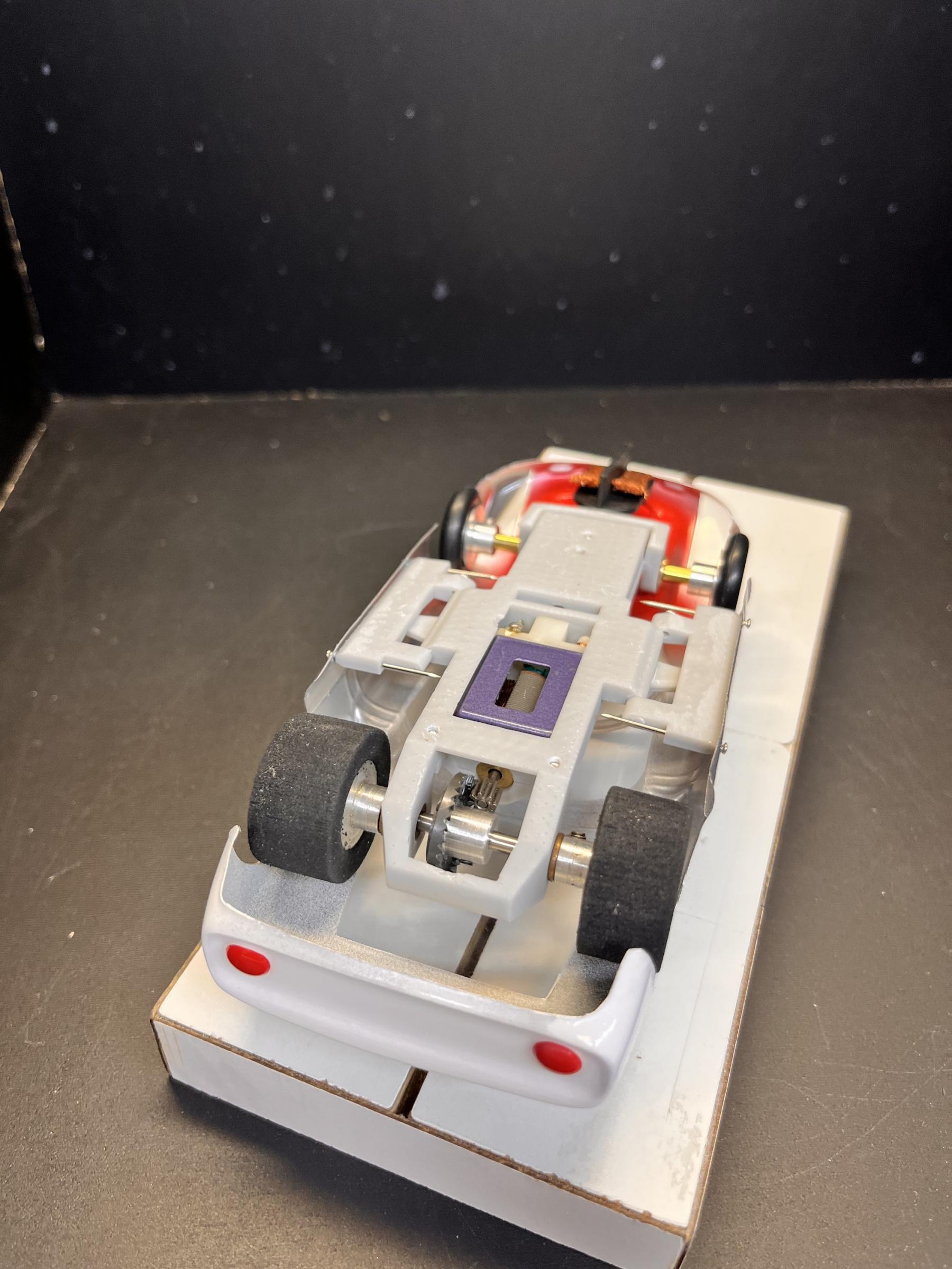

Ok so here is an actual test car. I hope to get to the track soon. Sure wish there was one closer!!
  • vfr750 and NSwanberg like this
Paul Nadeau
#24 Bill from NH
  • 15,352 posts
Posted 18 October 2025 - 03:48 PM
The chassis looks good Paul! When you get to test it on a commercial track, take some sheet lead with you in case it needs more weight here & there.
