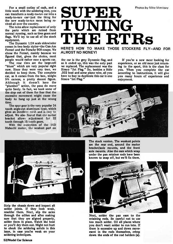

OK, it's cold and what better time to get going on some long overdue builds.
First up is a Dynamic anglewinder. This one is going to be a Model Car Science build.
#2 Mark Onofri
  • 3,023 posts
Posted 27 October 2025 - 08:41 PM
Here's the first page. What I'm planning to do is not a 100 point restoration but, something that I won't feel bad about putting into the wall.
#3 Mark Onofri
  • 3,023 posts
Posted 27 October 2025 - 08:52 PM

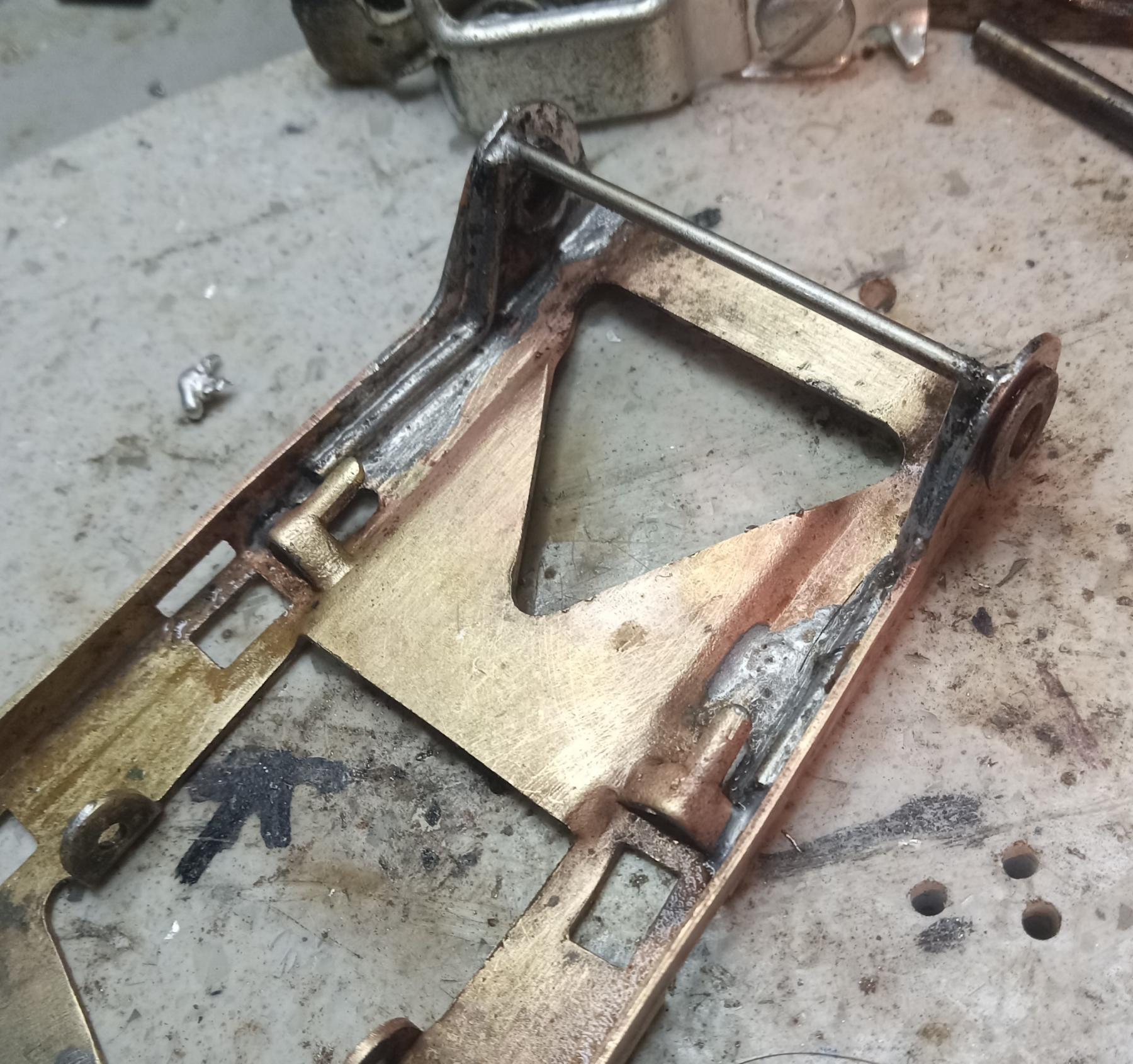

So, here's what I'm starting with. It was cheap and it's perfect for my intentions. H. R. Rod sent me the other pans and there perfect for this build. I needed one for a much better chassis so I'll just switch 'em out.
Thanks, Rod.

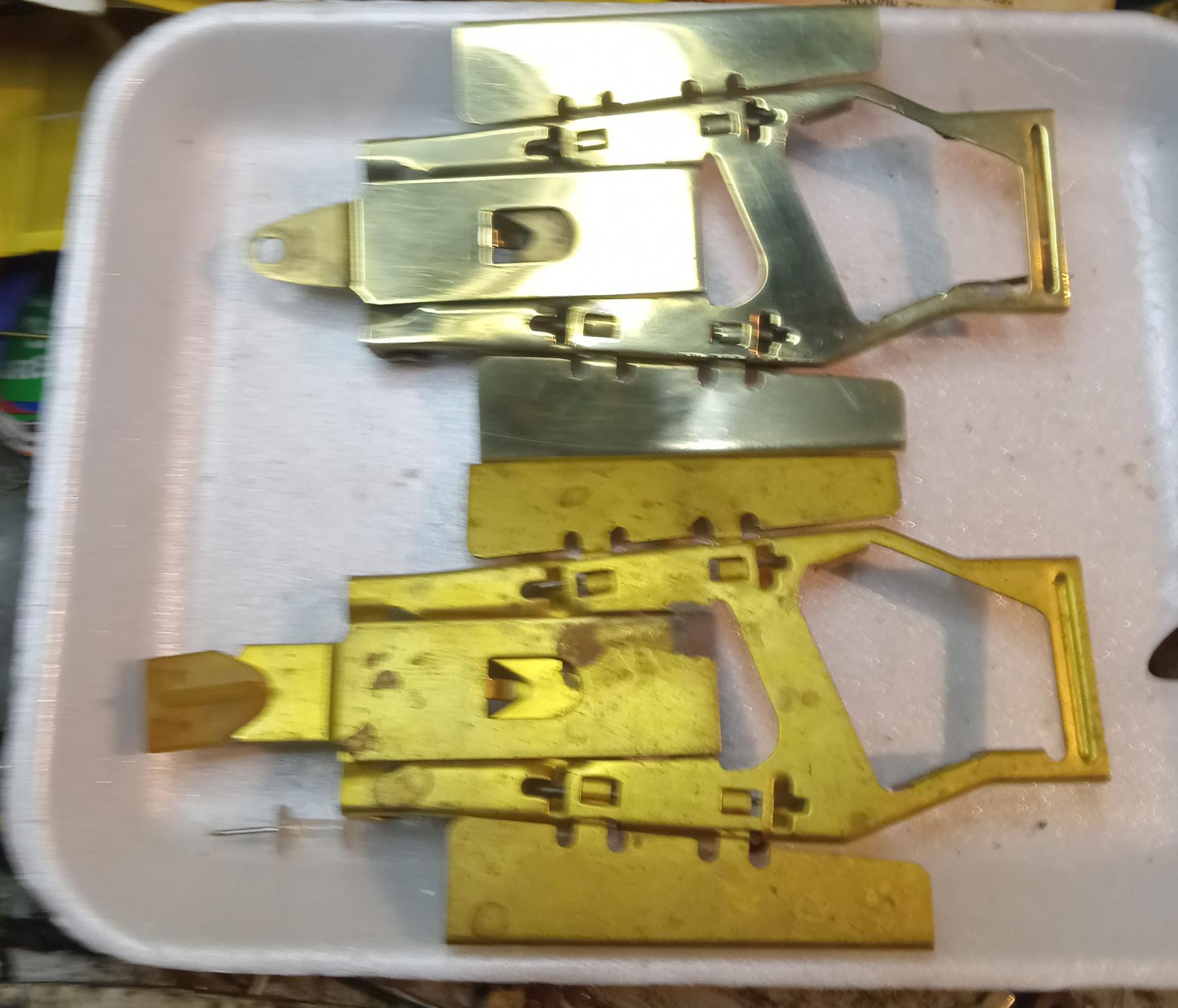

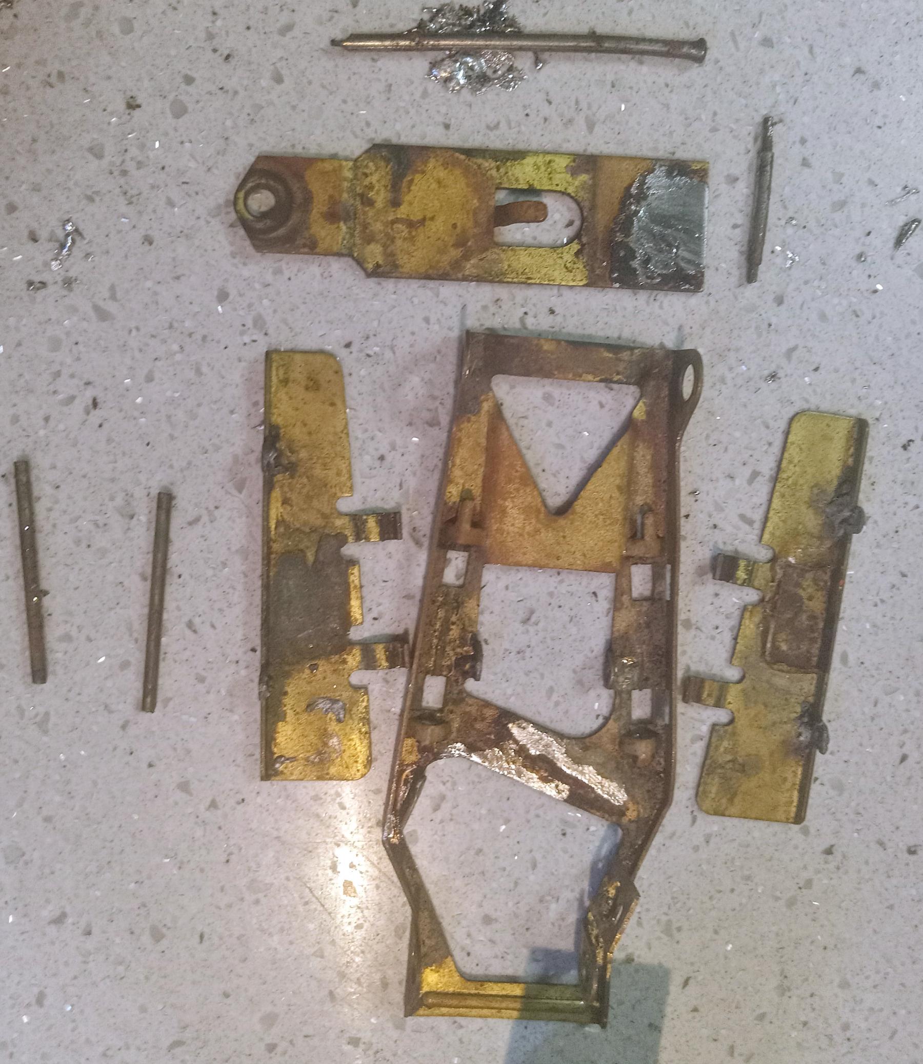

#4 Mark Onofri
  • 3,023 posts
Posted 27 October 2025 - 09:08 PM

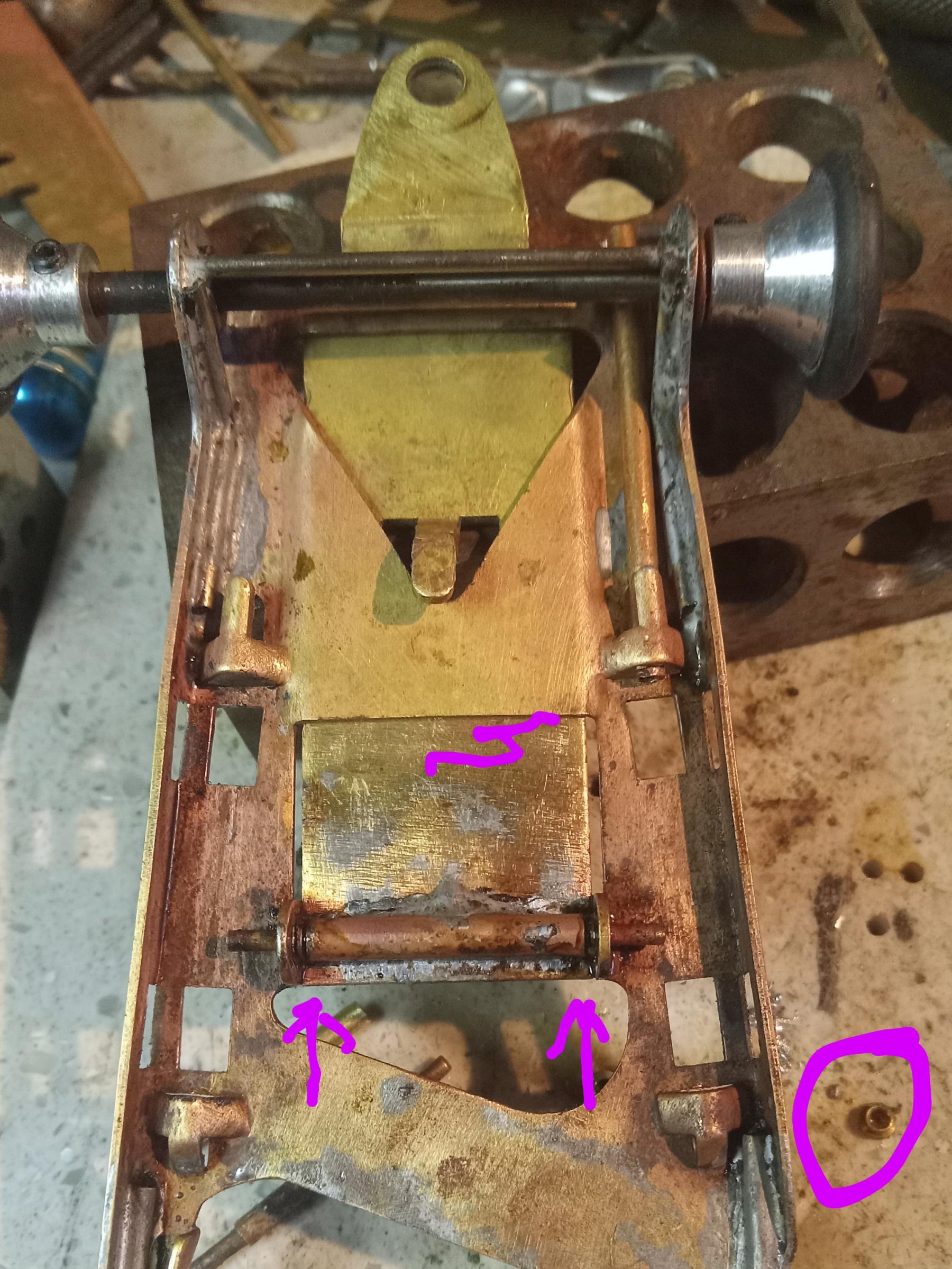

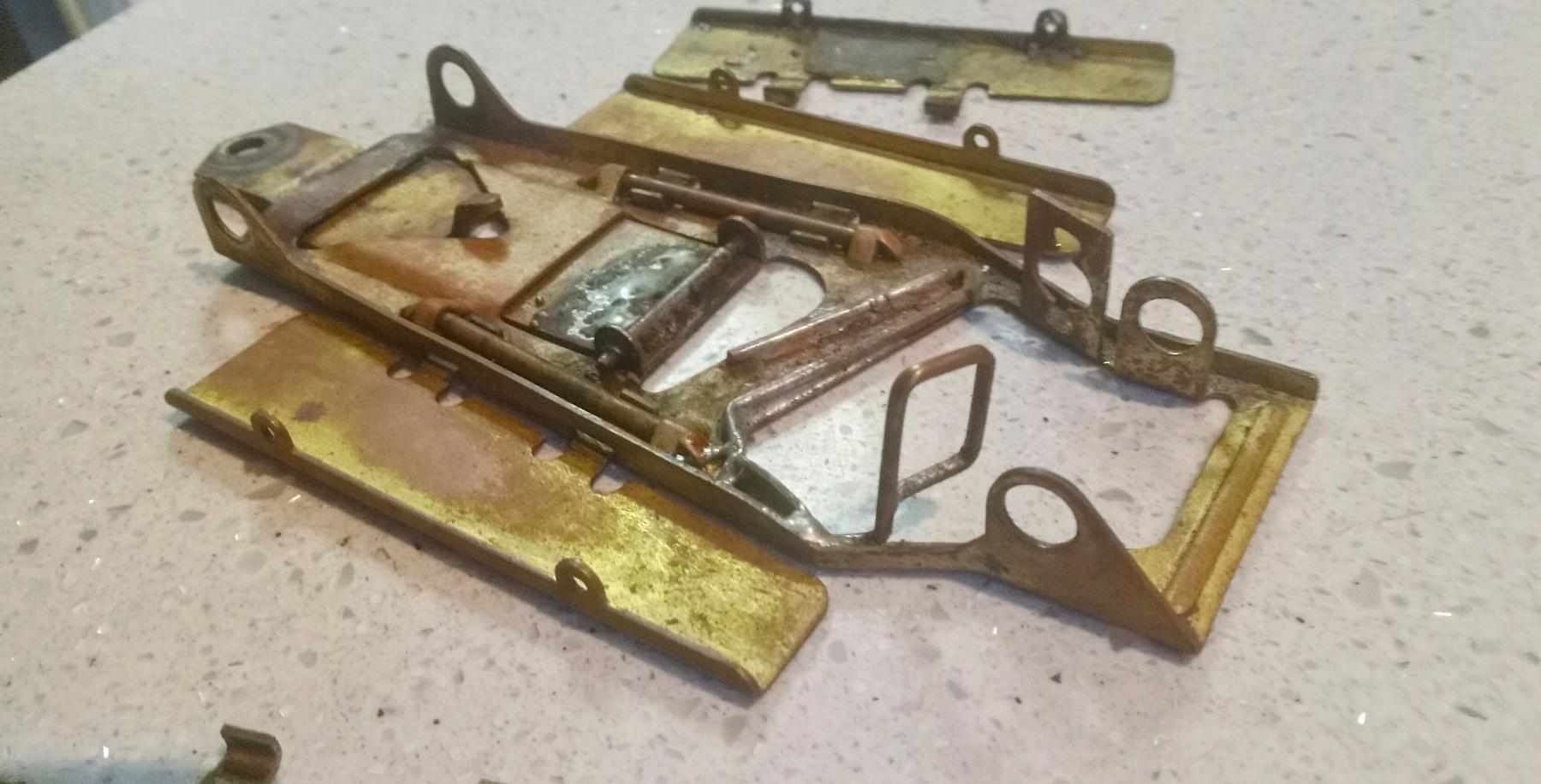

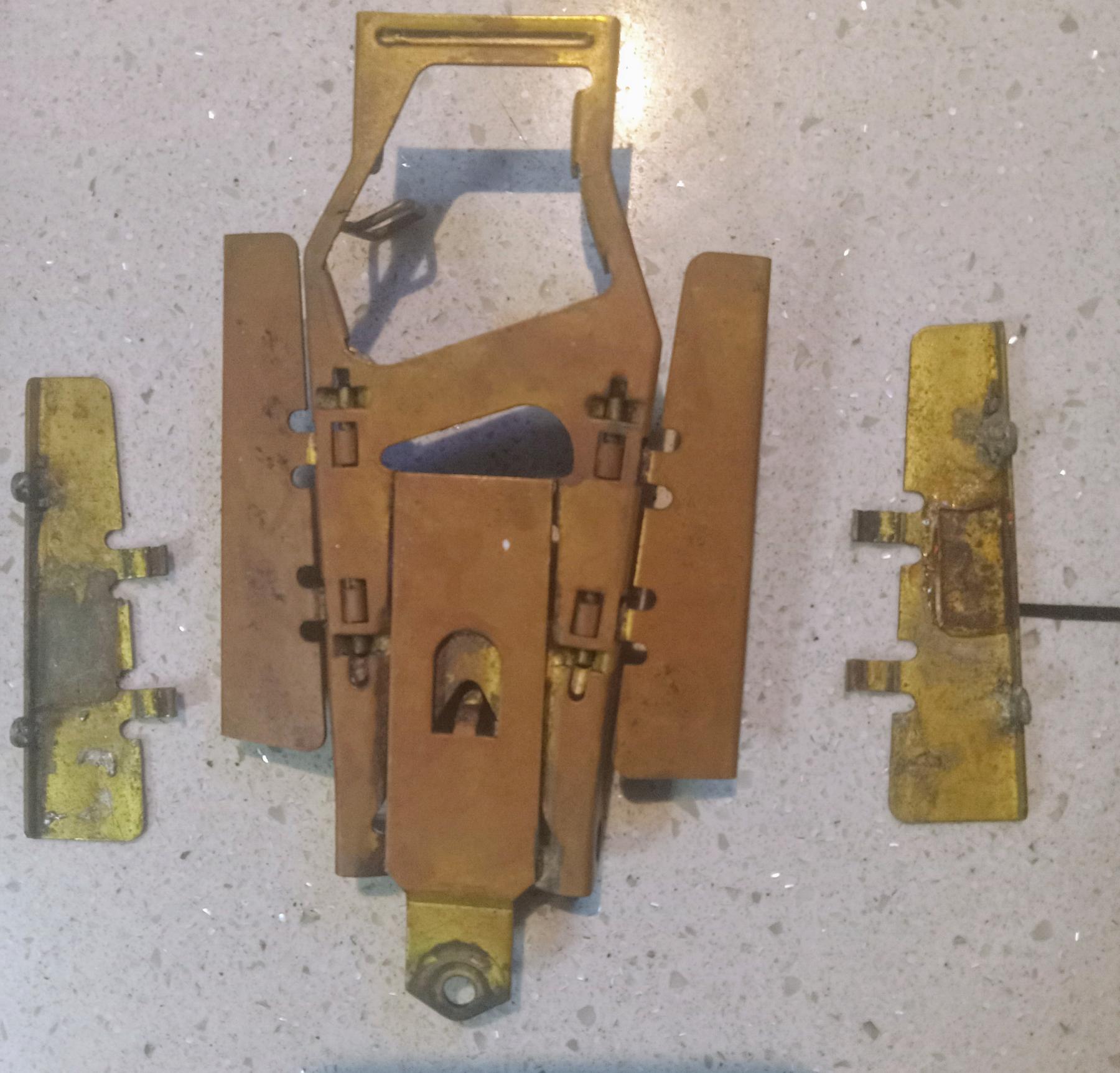

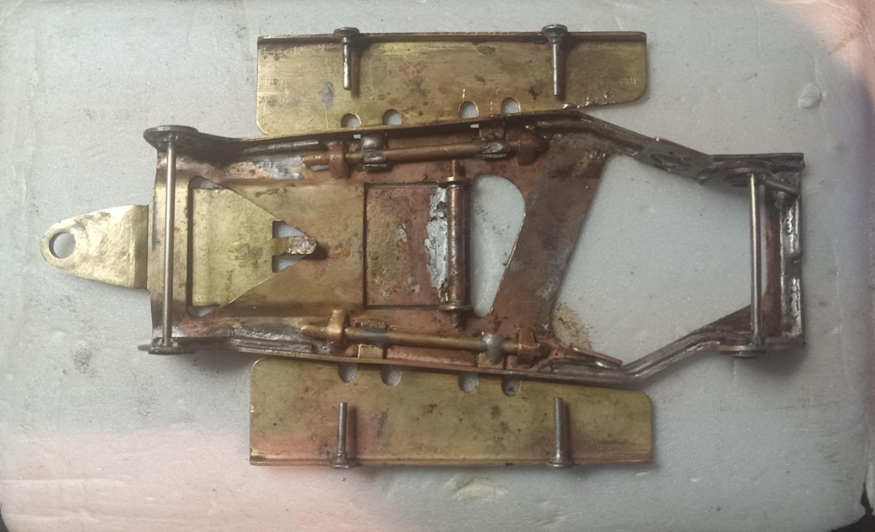

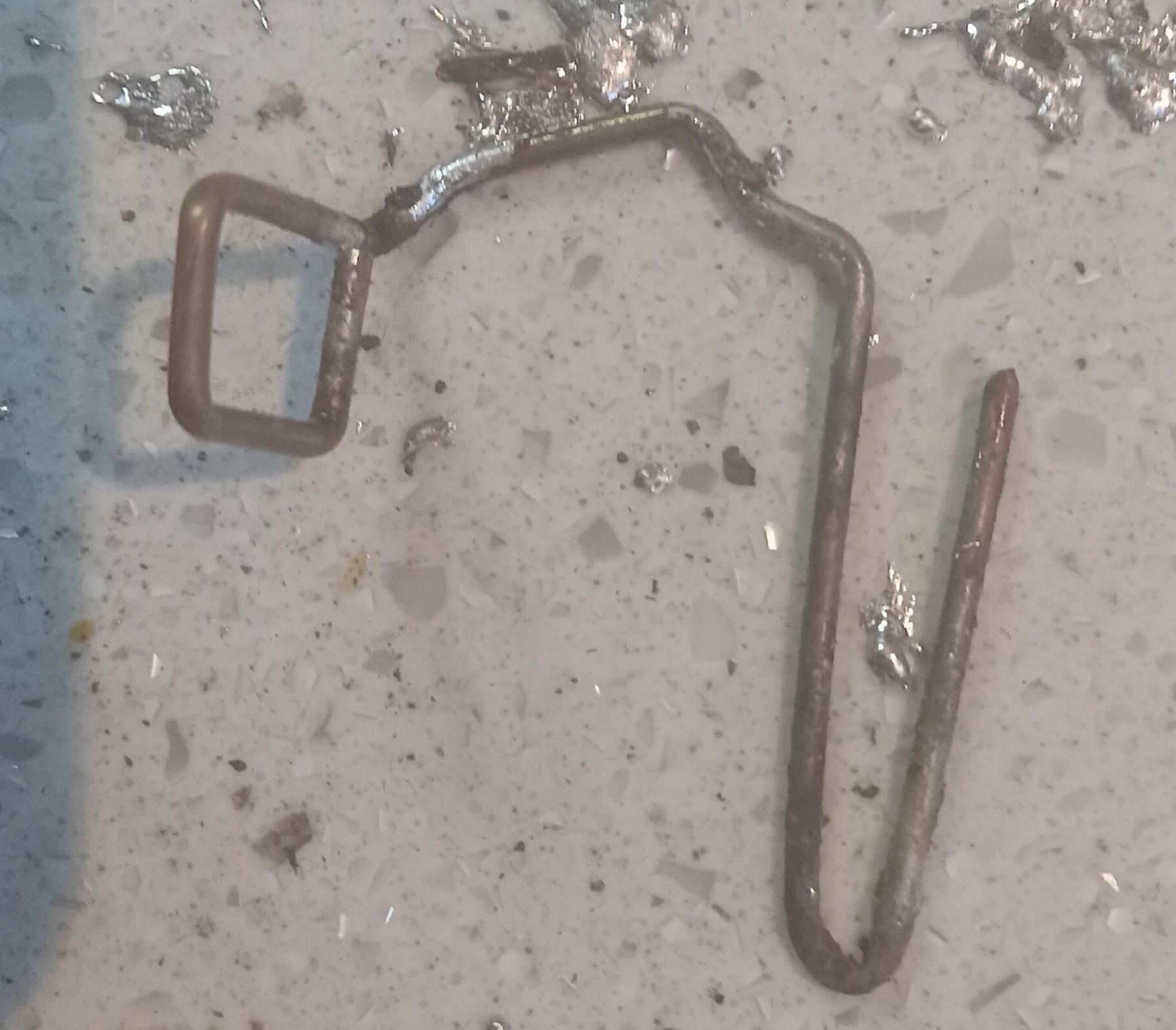

Here it is torn down but not cleaned. A propane torch made quick work of it.
The last two photos are of what was attached to the chassis. No idea if it's factory or a owner addition. Anyone ever seen this before?

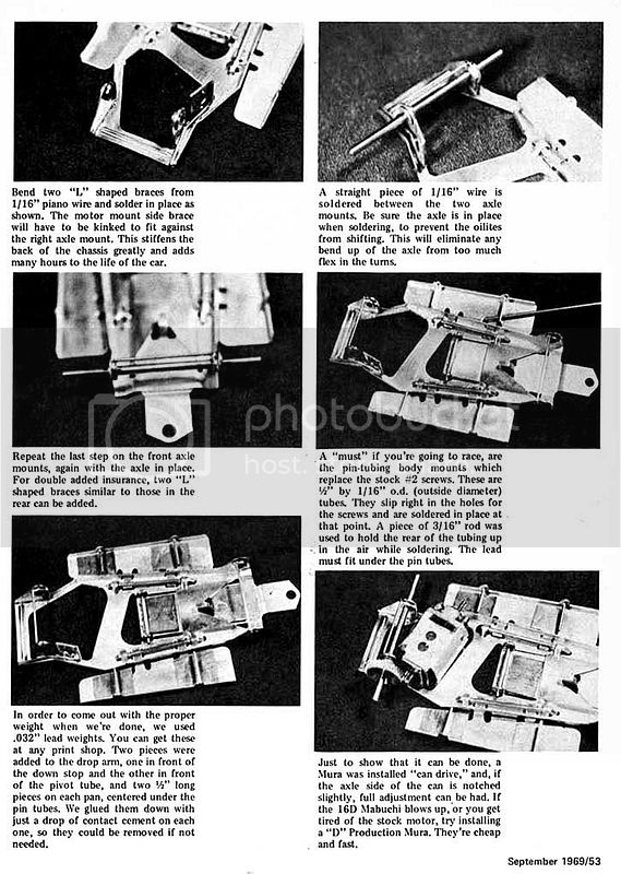

#5 Mark Onofri
  • 3,023 posts
Posted 27 October 2025 - 11:39 PM

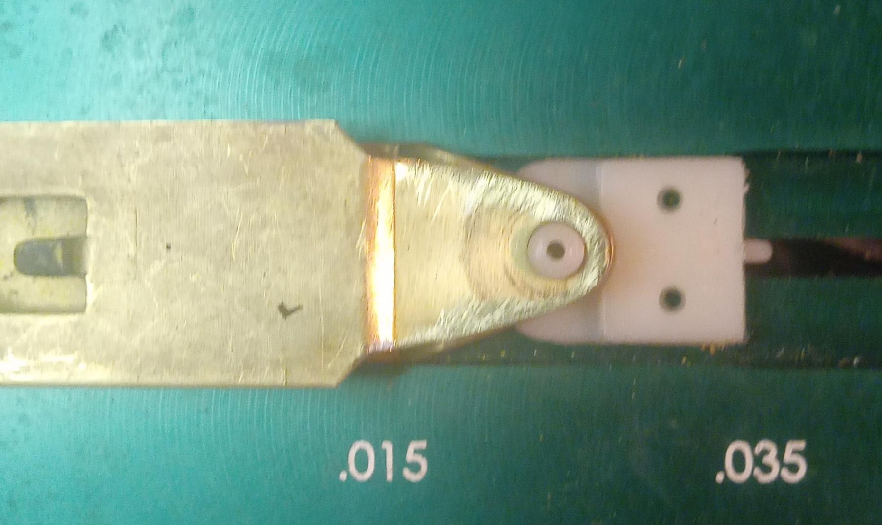

Page 3, and here's the modified guide. If you look closely, you can see the Cal-Kar drop arm I used for the pattern.
#6 Mark Onofri
  • 3,023 posts
Posted 27 October 2025 - 11:54 PM
Oops, I went from 1 to 3.
Here's what I came up with for my take on this. With the DuBro bender, it was a joke to make them, ummm, except for the 1 in the motor box. The last photo is the clearest of the MCS mod. It leaves room for interpretation.
I've made the"L" shaped reinforcements but, that all for tonight.
  • don.siegel, Fergy and Slot Car Rod like this

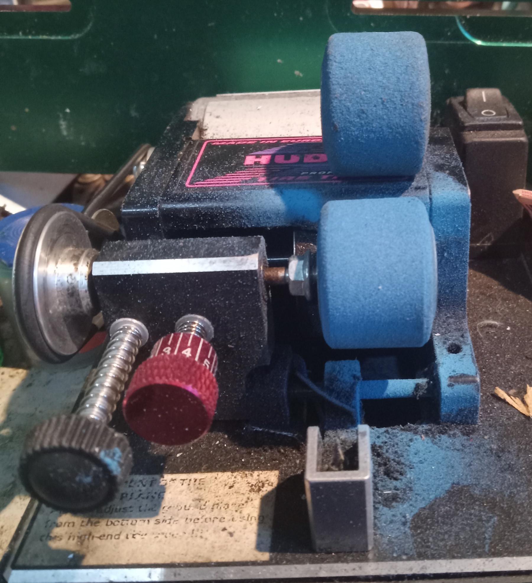

Jumping back to page 1, it sez blue tyres, blue tyres it shall have. Amazing how these come back to life with just a few 1/100" of a cut.

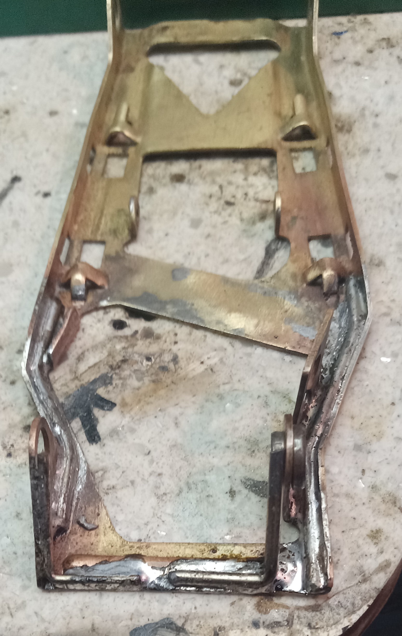

#9 Mark Onofri
  • 3,023 posts
Posted 28 October 2025 - 04:58 PM

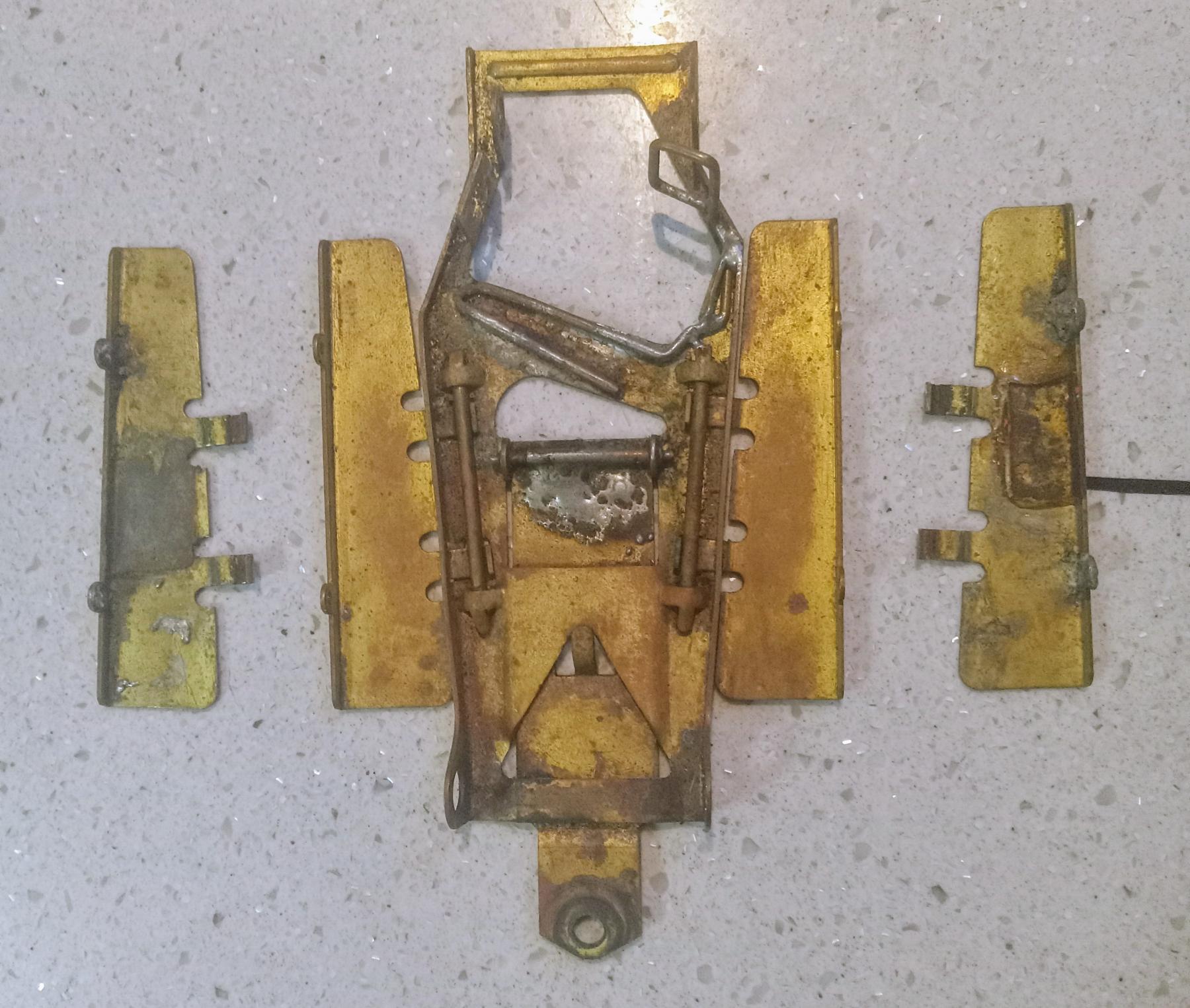

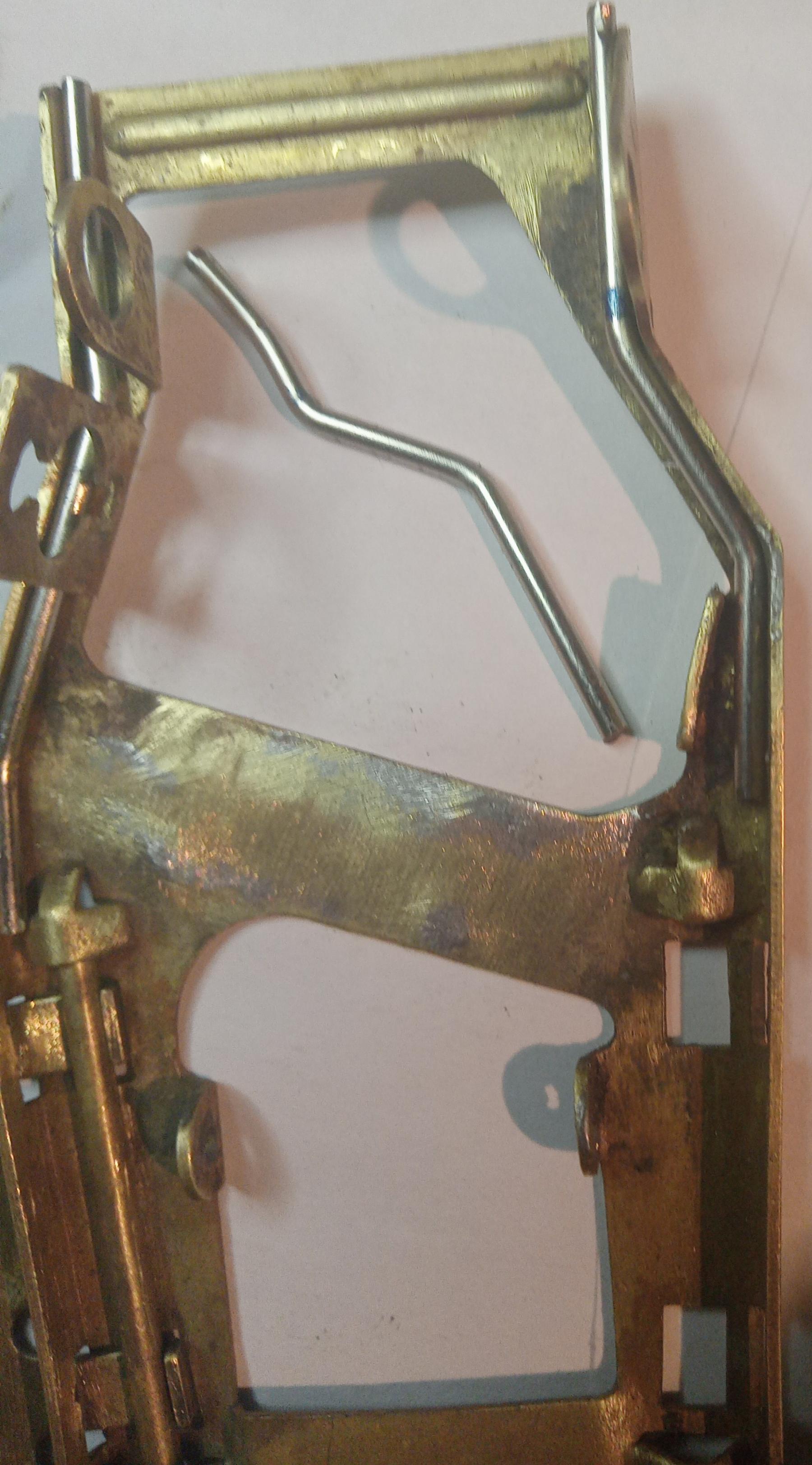

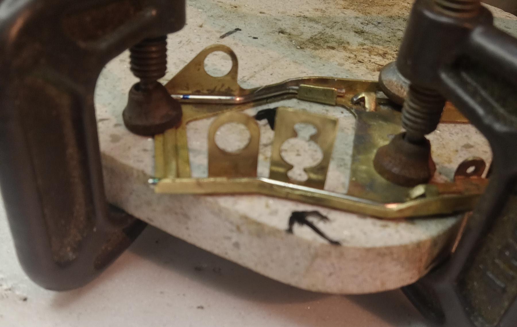

Not as bad as a Flexi 4 but, not good either. If you look closely at the arrows, you can see the cracks in the chassis. With any luck, the clamps will hold it flat and the 0.071" wire will keep it there. Can't remember WTF I did with the 95/5 Silverbrite so until it reappears, this is it for now.
  • Fergy likes this

#11 Mark Onofri
  • 3,023 posts
Posted 29 October 2025 - 06:18 PM
After seeing how bulky 0.073" wire looked on the rear, I went to 0.063"? OK, I couldn't find the 0.073 so I grabbed whatever was in front of me.
I retract my earlier comment about this being better than a Flexible 4. It's softer.
Drop arm, pans and pin tubes next. Ooooh, springs, can't forget about the springs, now can I?
#12 Mark Onofri
  • 3,023 posts
Posted 31 October 2025 - 02:09 PM
A little "artistic license."
  • Slot Car Rod likes this

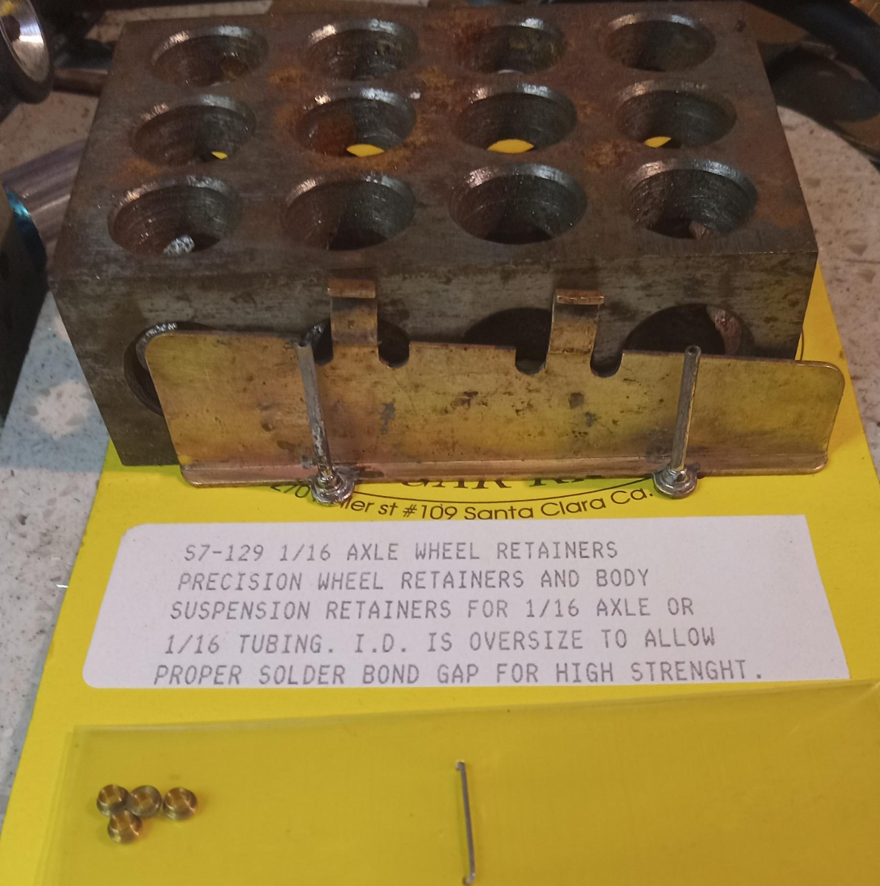

#17 Mark Onofri
  • 3,023 posts
Posted 12 November 2025 - 01:33 PM

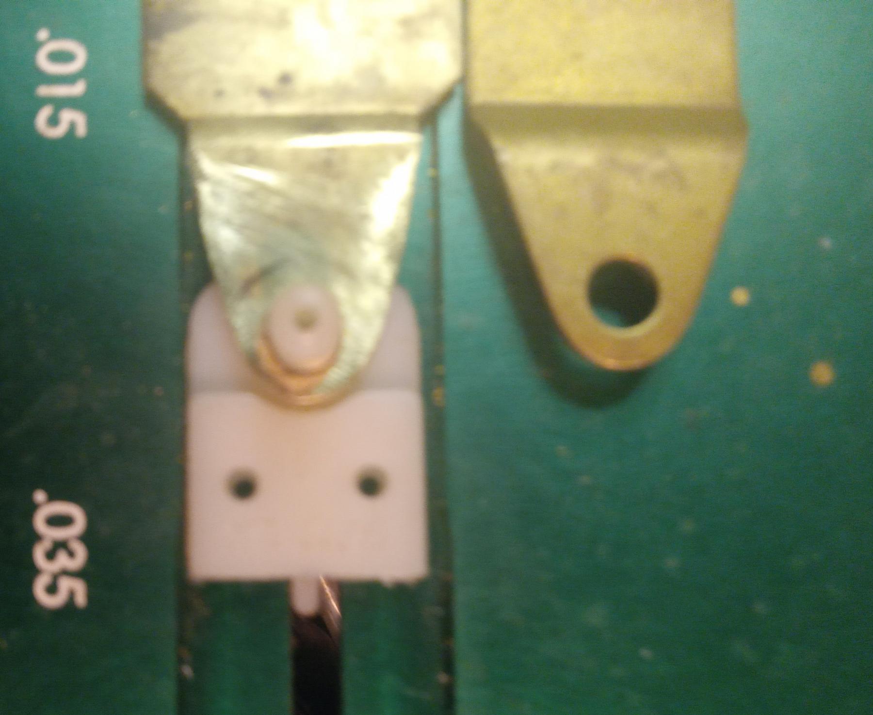

Anyone have a better photo that shows the pan springs? I'm still waiting on 0.015" wire but, in the meantime, I've been trying to use 0.020". Trying to find a place to solder isn't as easy as it looks.
