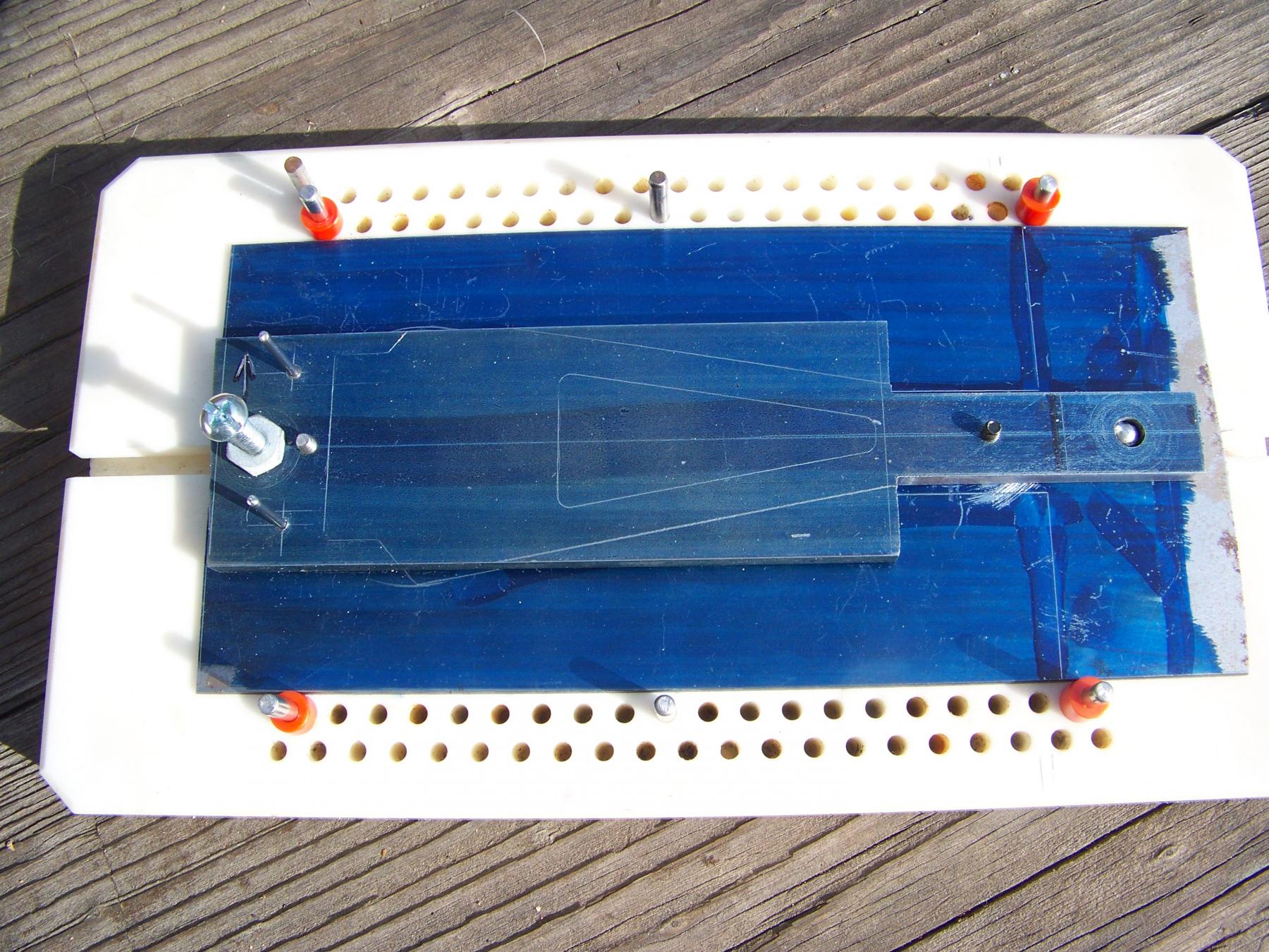

Posted 17 January 2026 - 03:41 PM
Chipping away at the StarShip SideWinder soldering fixture. Now with its .040" base and the 3/16 top plate screwed and pinned together. Next step is to drill the location for the plumber hinge then I can cut the angles on the sides. Leaving the side parallel for now as it is the best way to hold in the mill for drilling.

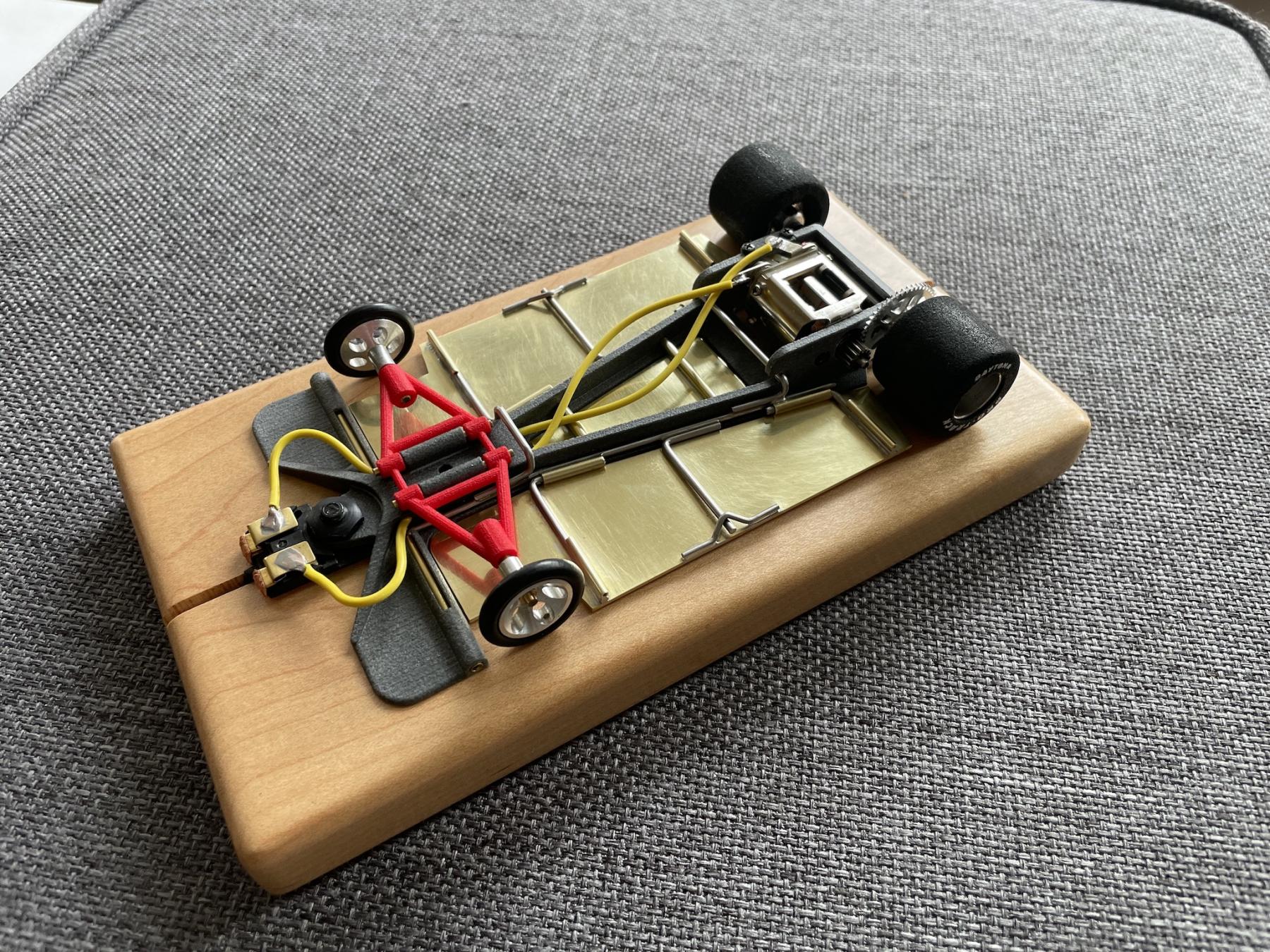

Posted 20 January 2026 - 05:57 PM
Well it takes awhile to get a shipment from the Netherlands but my new chassis finally arrived and I have a finished roller ready for viewing. I also happen to have an extra Lola T70 body lying around which fits this guy perfectly. But it the mean time, here are some beauty queen shots.

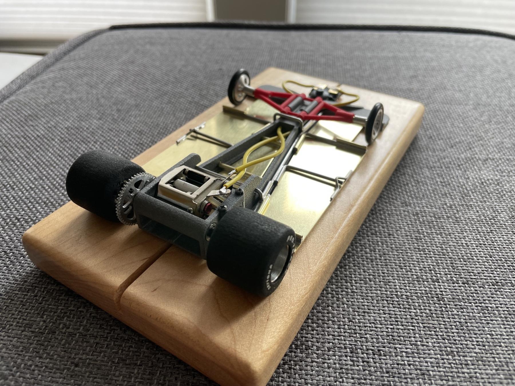

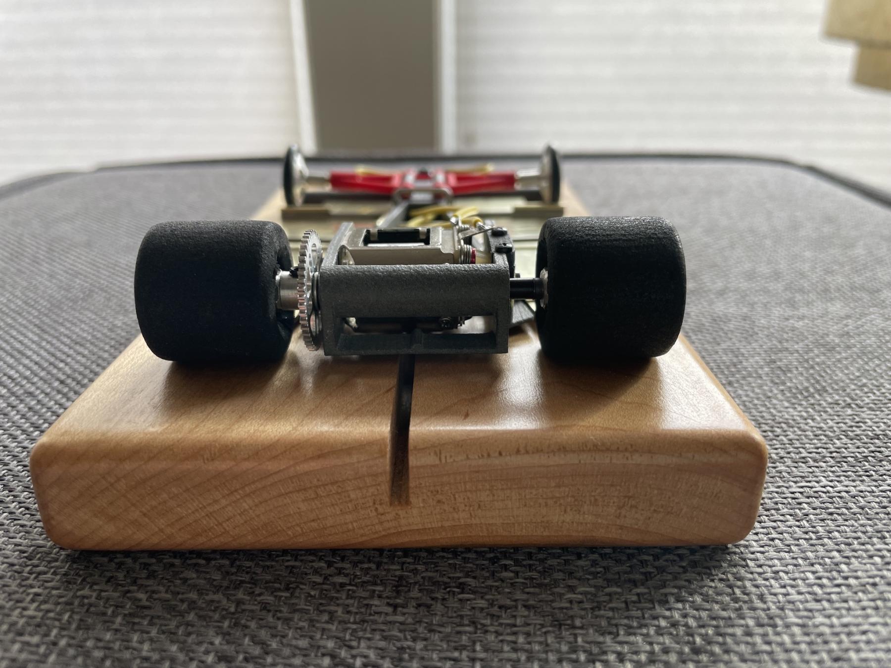

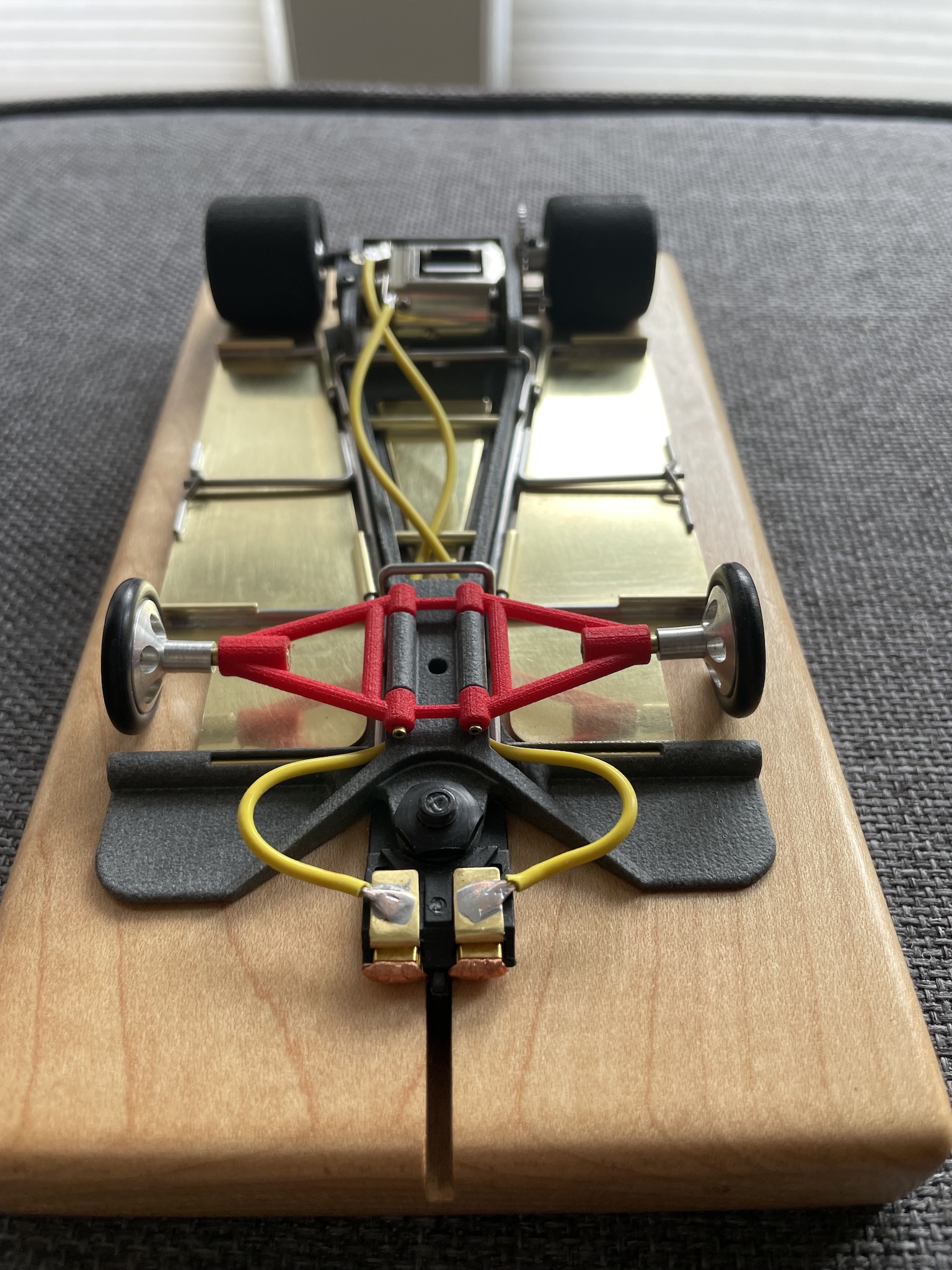

#33 Larry Horner
Larry Horner
  • 572 posts
  • Joined: 18-March 17
  • Location:San Francisco
Posted 20 January 2026 - 05:59 PM
more...

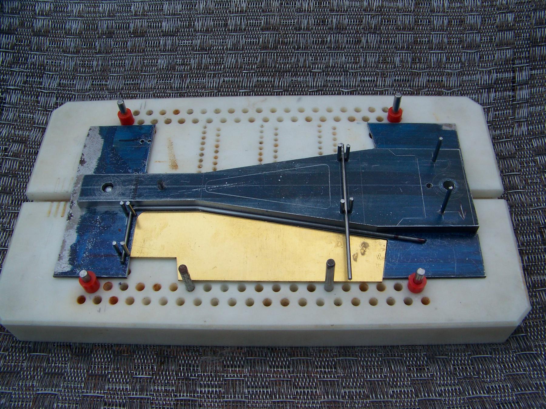

Posted 26 January 2026 - 07:52 PM
Not proofed out yet, but here is the soldering jig holding the parts in there correct location.
Plumber hinge rail set in place between pins with air gap to 3D printed chassis.
Bite bar set between pins ready for fab.
Now, hopefully  the hot soldering iron never gets close to the printed chassis. On ward.
