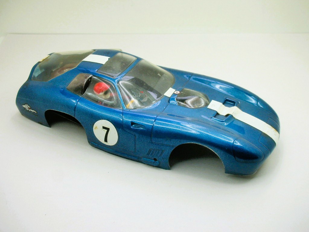

A while back I found a well used example of the car with what I thought was a body in nice shape for $90. I saw the auction shortly before it was to end and didn't have a chance to ask questions of the seller.....so I took a chance.

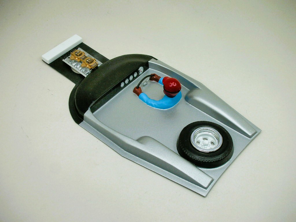

It has a nice unmolested interior although it's missing the driver's head and steering wheel:

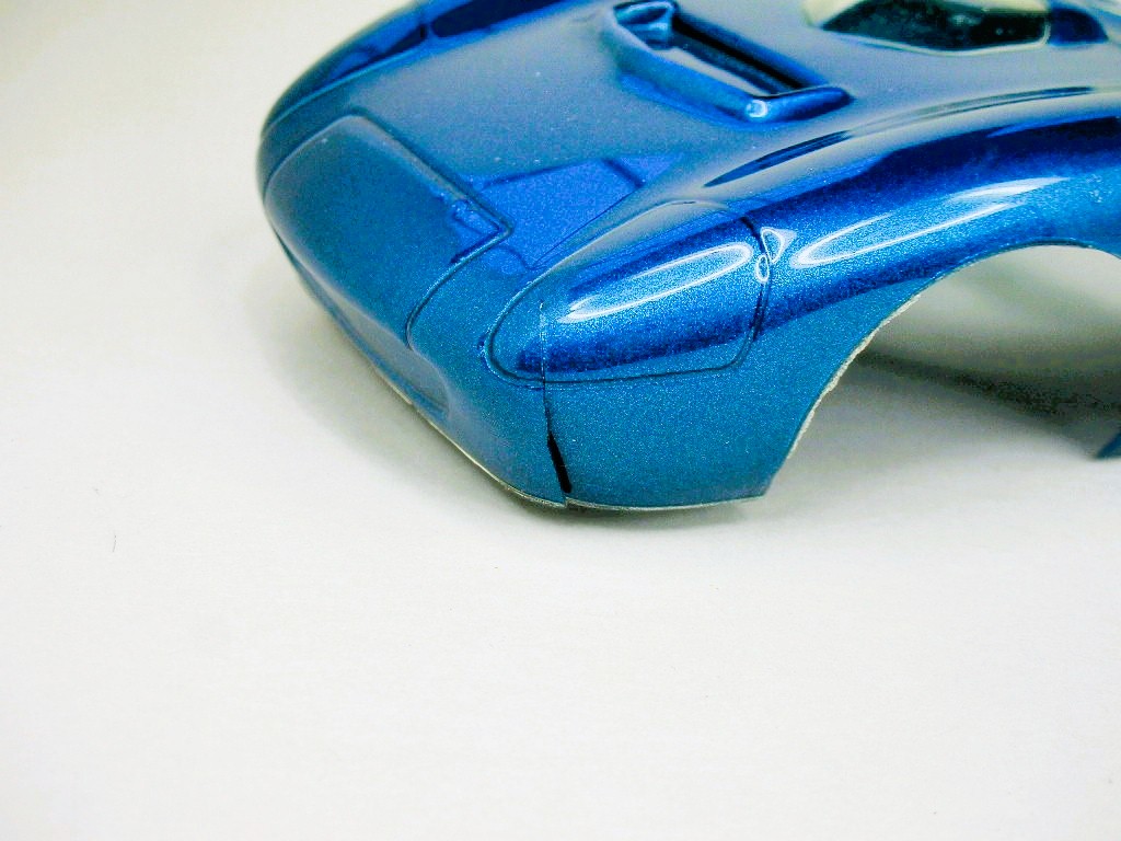

Unfortunately, the body has a huge crack in the nose that didn't show up in the listing pictures:

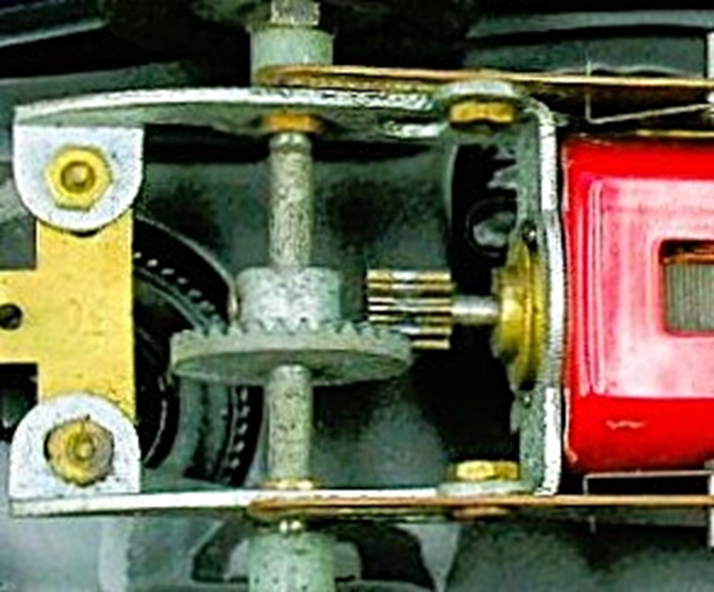

The stamped crown gear was the worse ever invented. I never could get it to work. Sounded like steel cutting steel.
  • S.O. Watt likes this

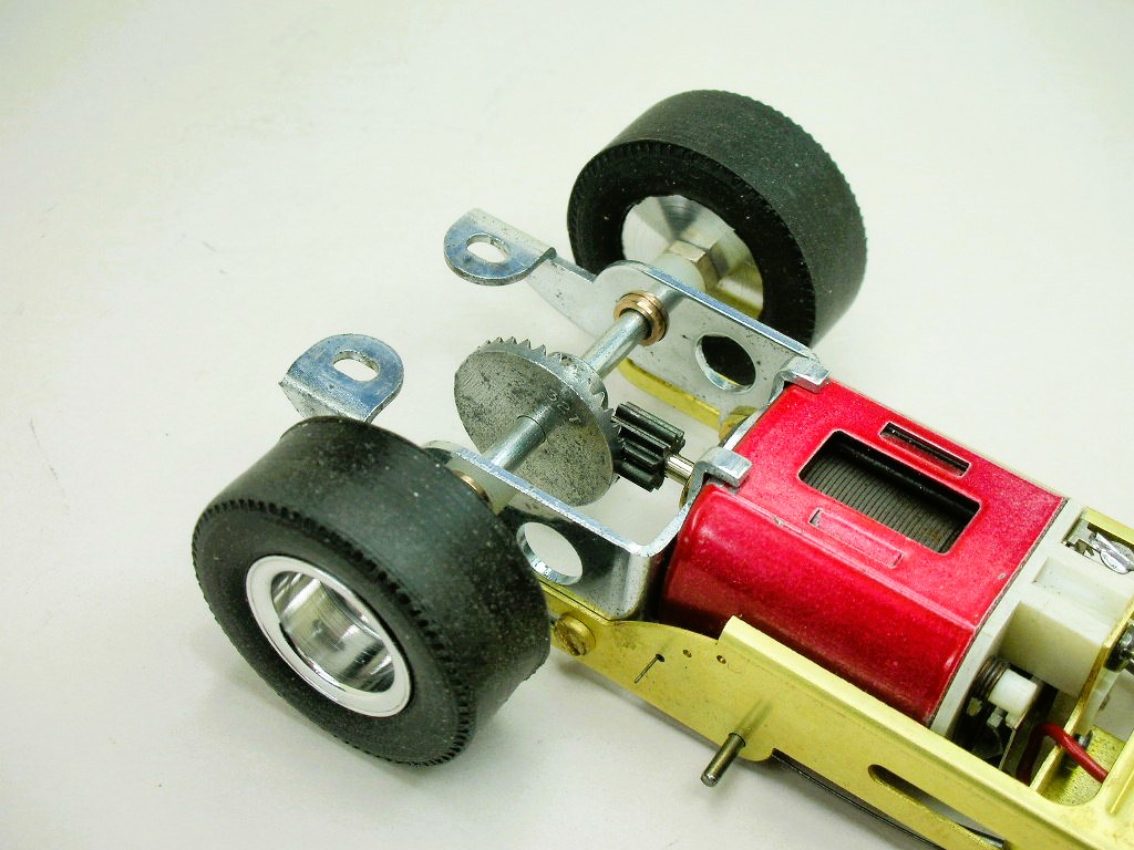

Chris, I think the stamped crown gears were great for sawing pinions in half.   :wacko2:   :crazy:
Even the die cast crown on this car has really dug into the steel pinion but they aren't usually as bad as the stamped gears. I will be replacing that pinion:

Chris I believe the gear you speak of is cast not stamped, not saying it was any better. I think it maybe a zink based alloy casting.
It may of been cast by MDC or Wilson ? It looks a lot like theirs. Even Dynamic used that same cast material for some of their gears.

Monogram ditched the stamped gear and went with a cast gear (as seen on this car) after their early generation of cars.

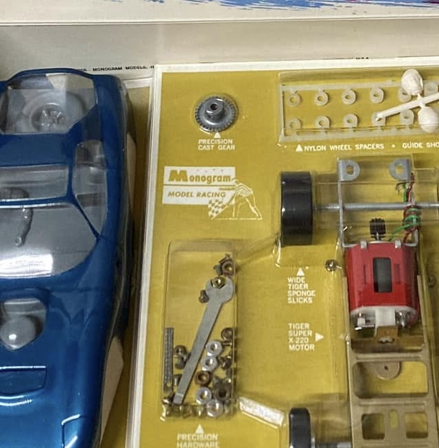

Lee Welch

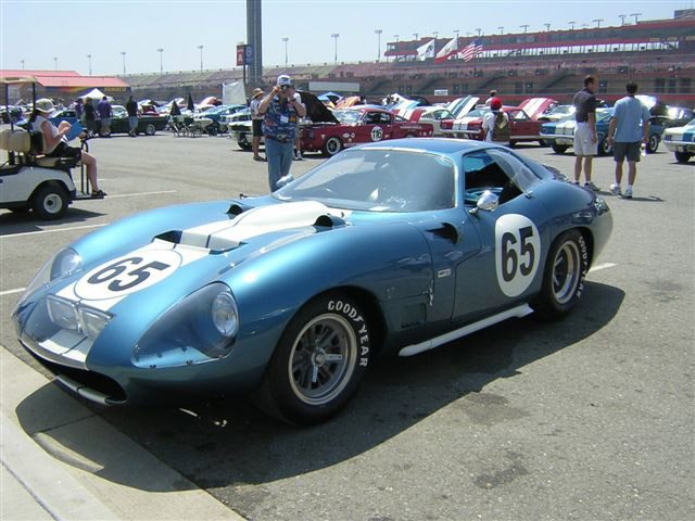

I did find this image of a 65 coupe but lord it is ugly.
1965_Shelby_CobraDaytona427SuperCoupe3.j
  • Tex likes this

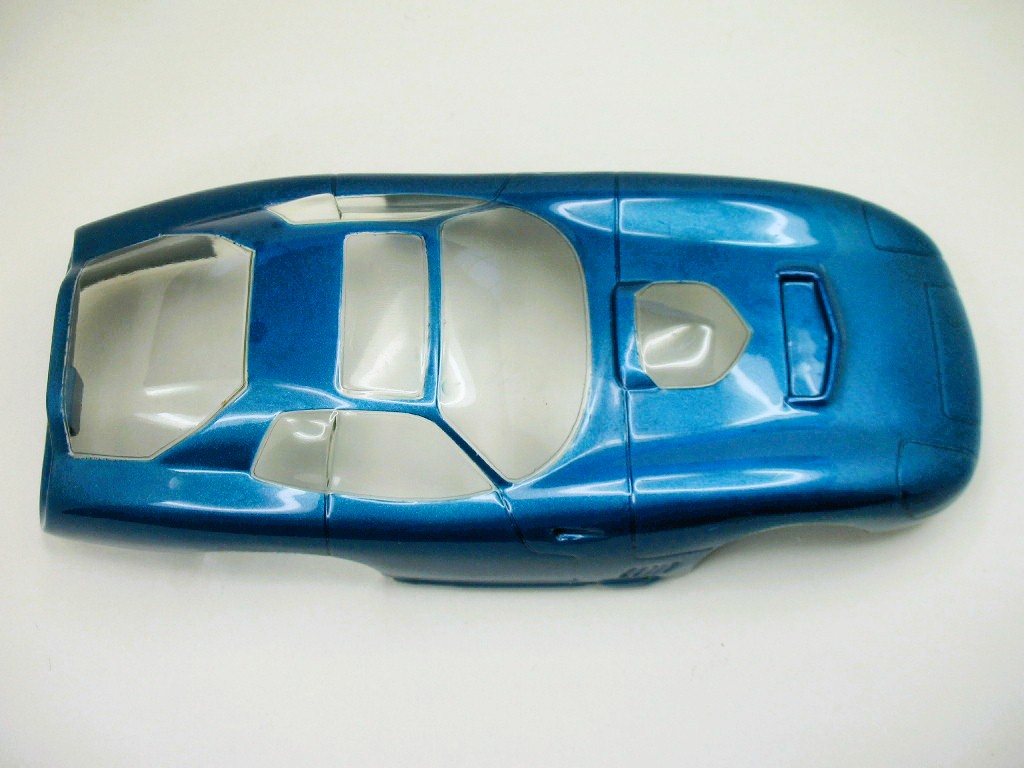

"atrocious"........."ugly".........oh my.   :shok:   I see it more as "brutish" and "purposeful".   :laugh2:   :dance3:
Again, here's the crack free replacement body with horrible decals............

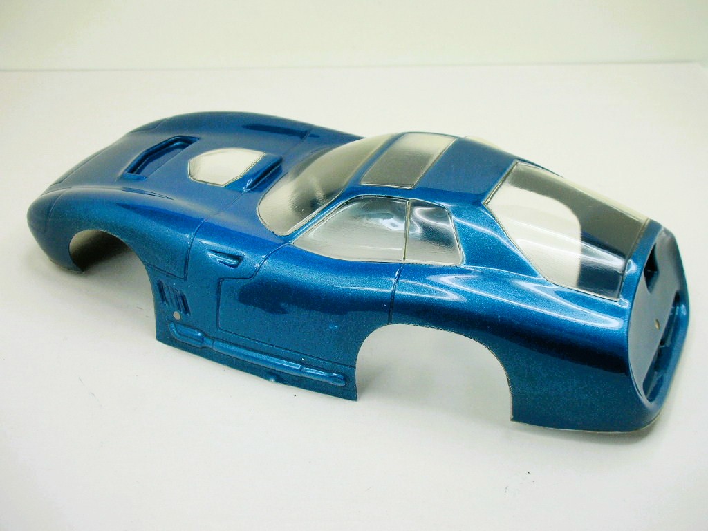

...........and the body with the decals removed and a good polish with Novus #2:

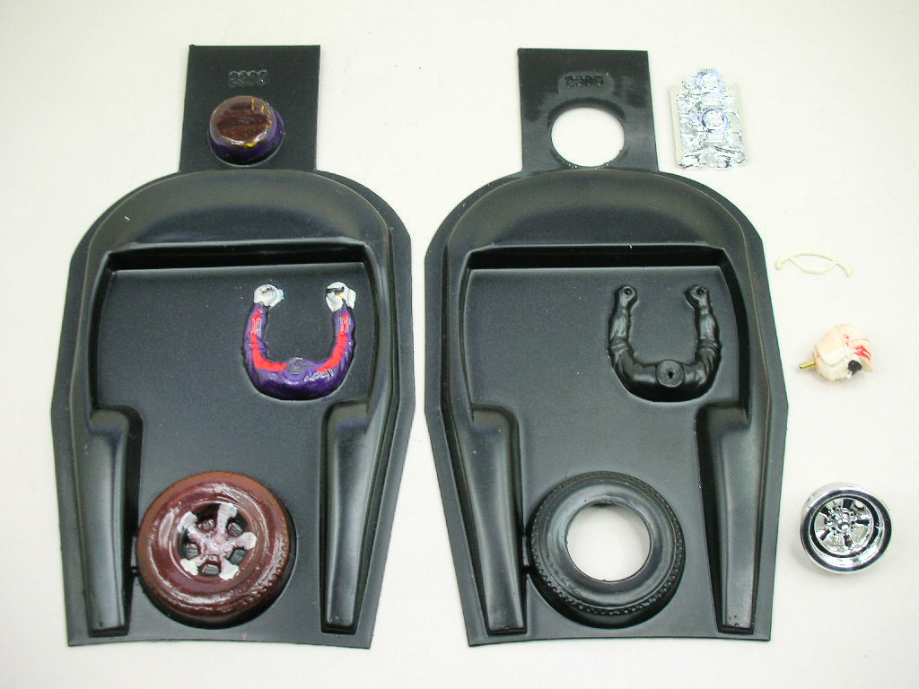

I stripped the replacement bodies interior (left) of the driver's head and steering wheel and transferred them to the cracked bodies unmolested interior (right).

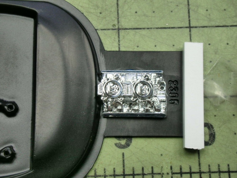

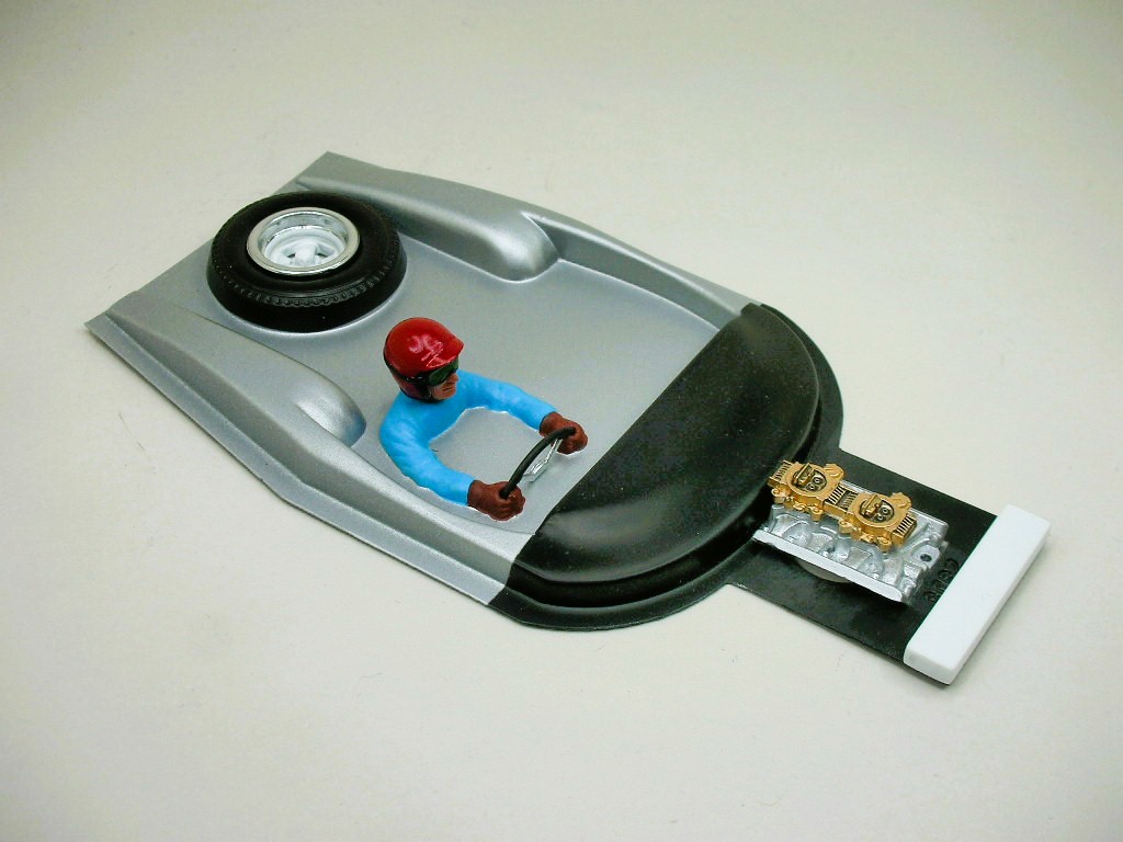

I'm also adding a dual 4-barrel intake from the Cobra Dragon Snake model kit to replace the big raised bump in the stock interior. It fills the clear hood bubble nicely and should look good with some detail painting:

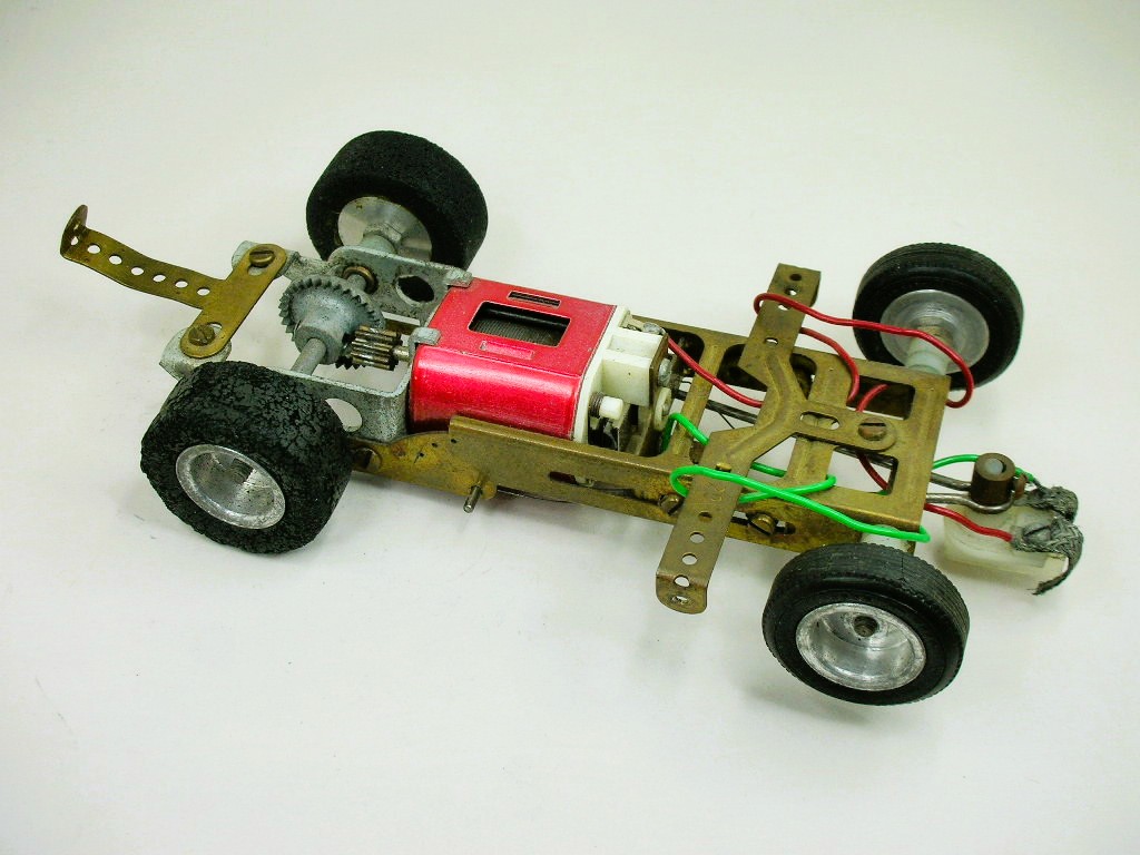

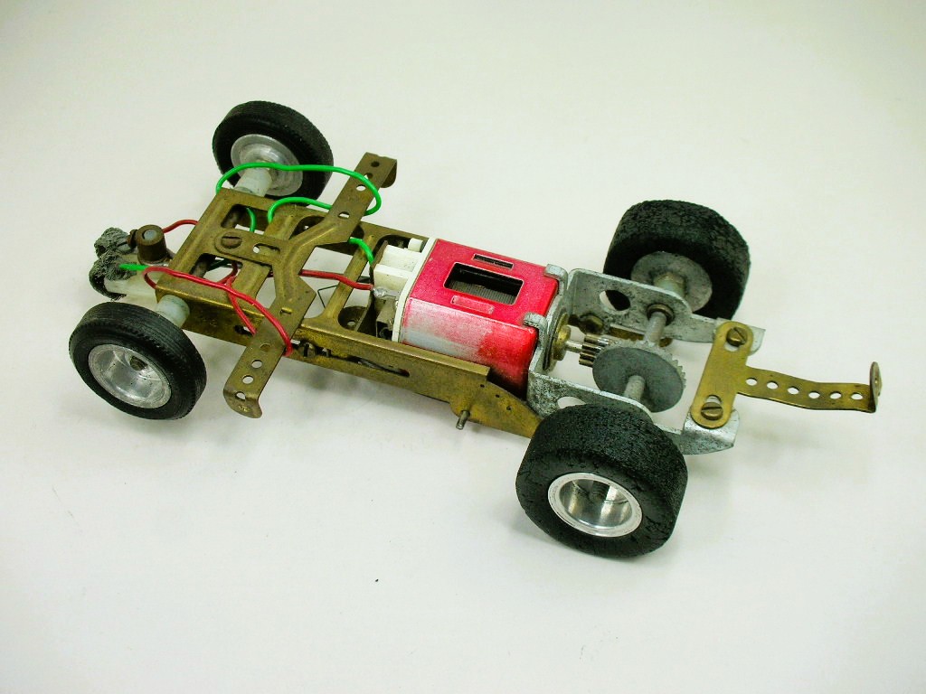

OK, time to freshen up this rather sad mechanical mess:
  • Pablo, munter and Regis4446 like this
#11 Martin
  • 4,649 posts
Posted 01 January 2026 - 04:45 PM
With some of Ricks famous added details this kit will be transformed.
Looking at Eddie's post #8.  I suggest you could cut out the side windows. Leaving the clear air scoops of course. Its kinda a strange shape anyway and was probably meant to be removed? It could be replaced with a flat clear window.
It would have a side benefit of showing off the driver/ interior detail a lot better. My 2 cents.

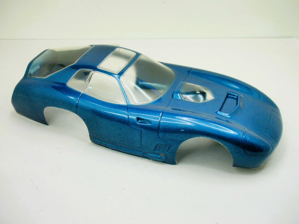

#12 dc-65x
  • 7,204 posts
Posted 02 January 2026 - 01:04 PM

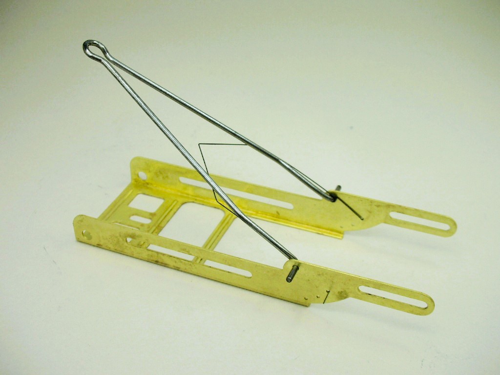

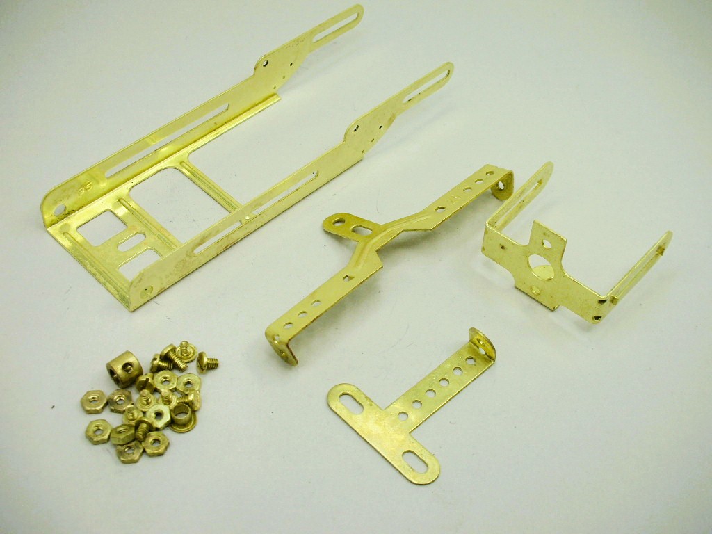

Martin, it's fun to think of little things that could be added to our slot cars models. Side exhaust pipes and a rear gas cap could also be added to this one. But for now it's time to clean up the running gear.

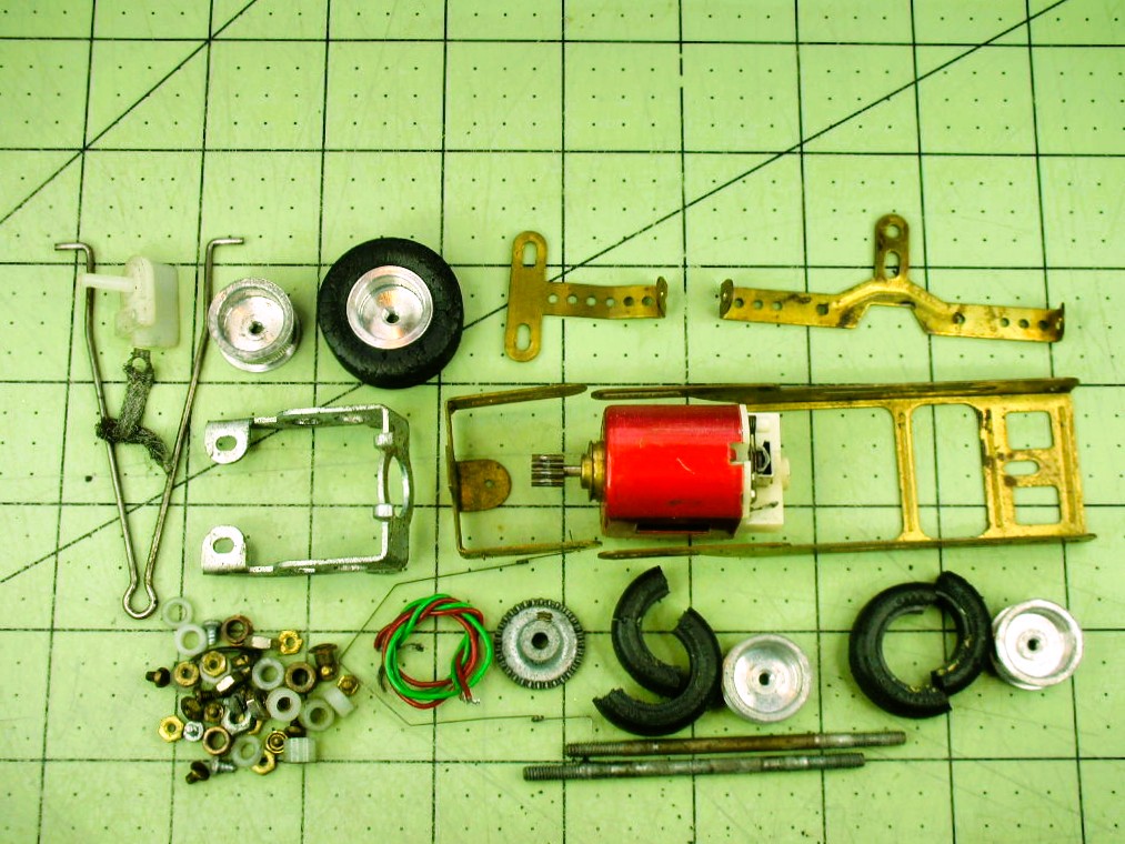

Here are the pieces in all their filthy, corroded glory:
Starting with the brass parts, they get a good cleaning with brake cleaner and a soak in Tarn-X:
They look much better.........
............but still have some gnarly' spots:
They could be removed with some mechanical polishing which I may or may not do. I think I'll leave it like this for now. The color of the brass after polishing kind of changes the look from a stock chassis.
  • munter likes this

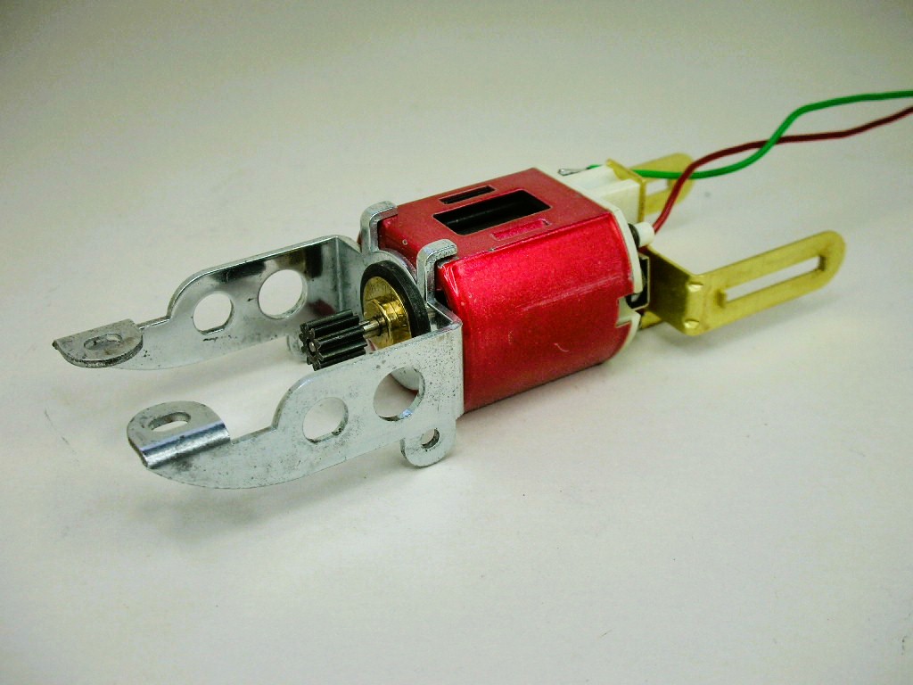

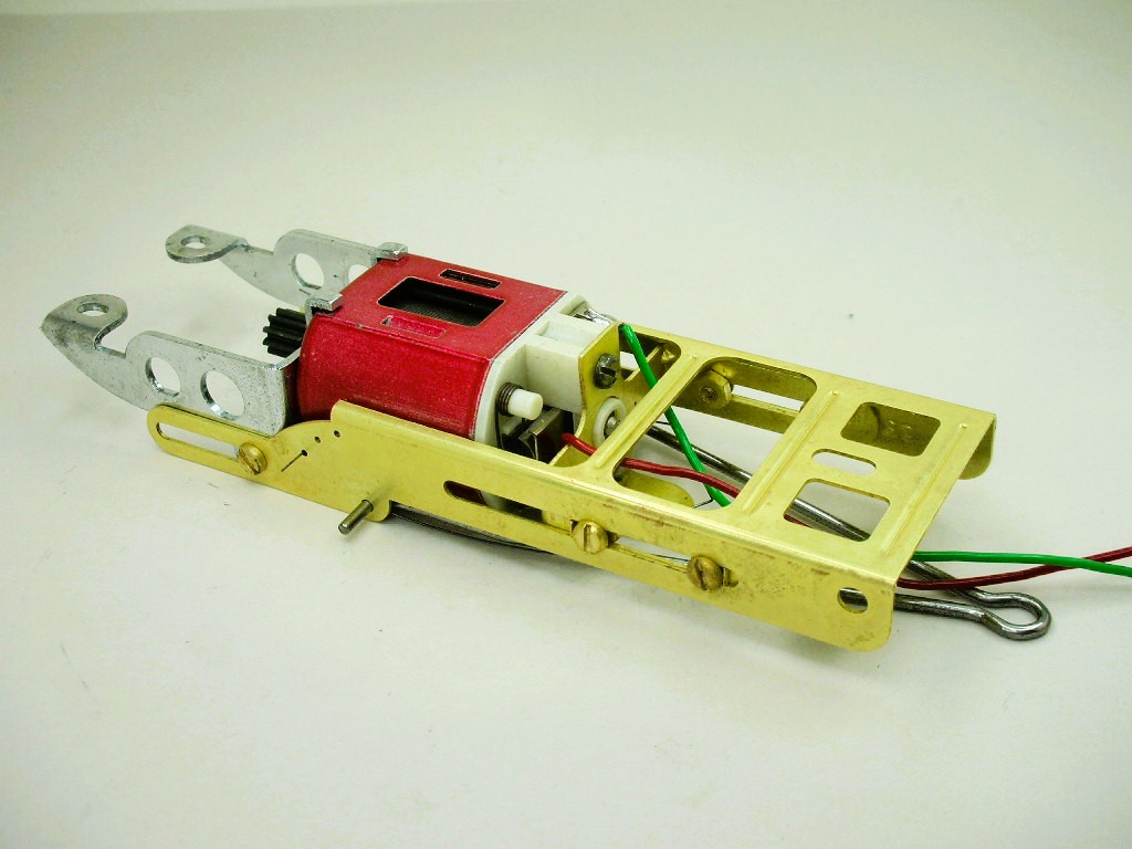

Thank you Martin but I'll just be using the detailing bits I've already shown on this kit car. You are a great modeler and could do wonders with a Daytona coupe of your own. The pictures you show are from the earlier small block car though. No leather straps for the spare tire or dual side exhaust on the big block version but still plenty of detailing options.   :good:

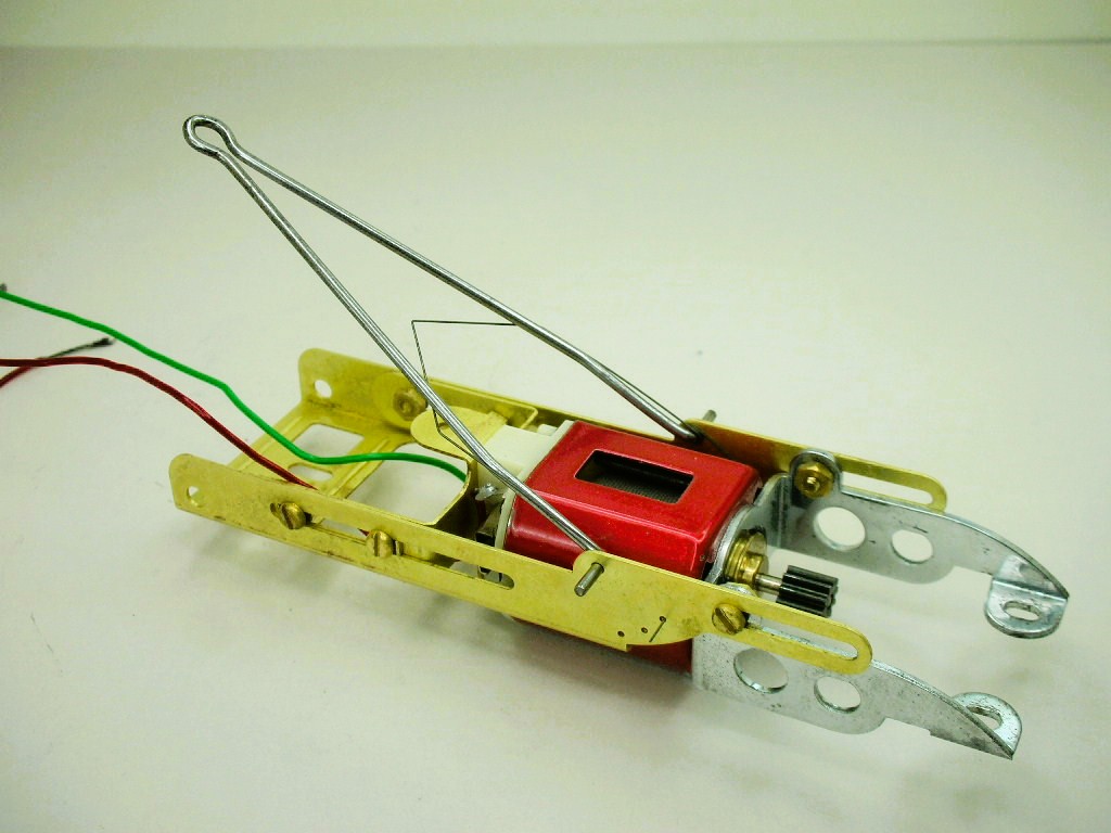

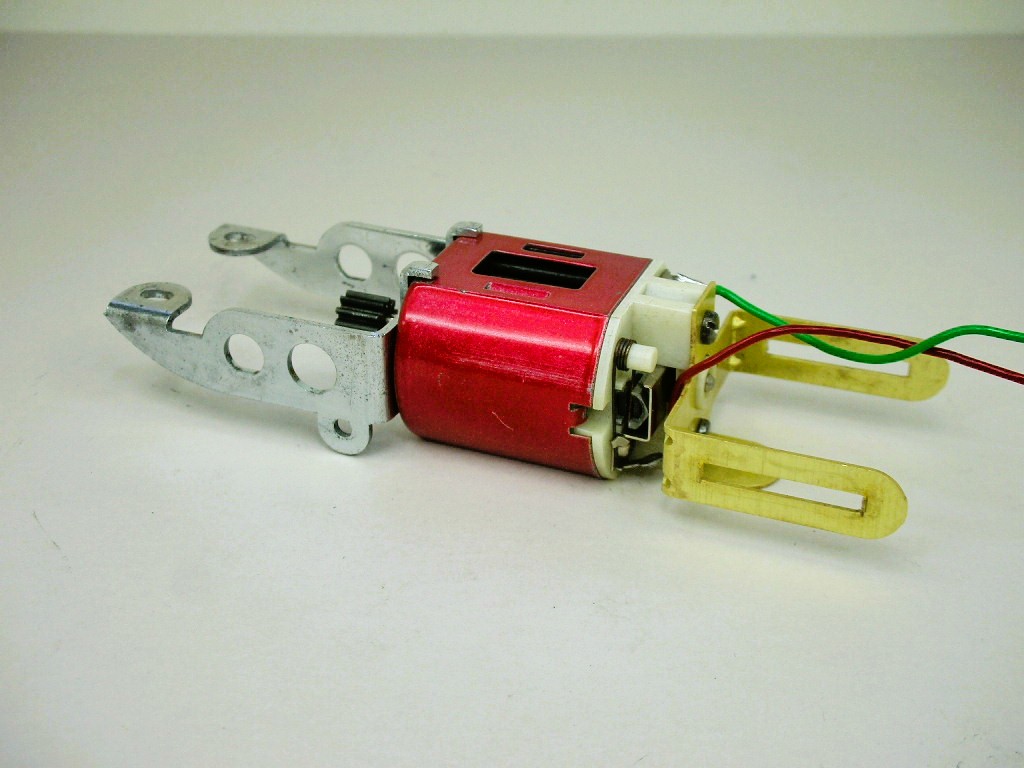

The motor and it's mounting and axle brackets are ready to go:
  • slotcarone and munter like this

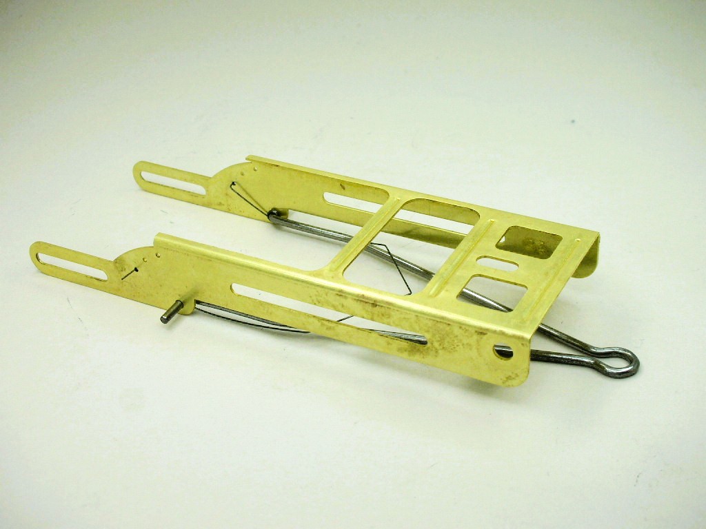

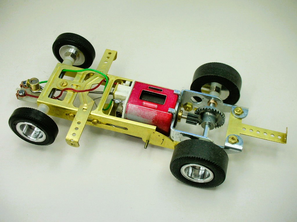

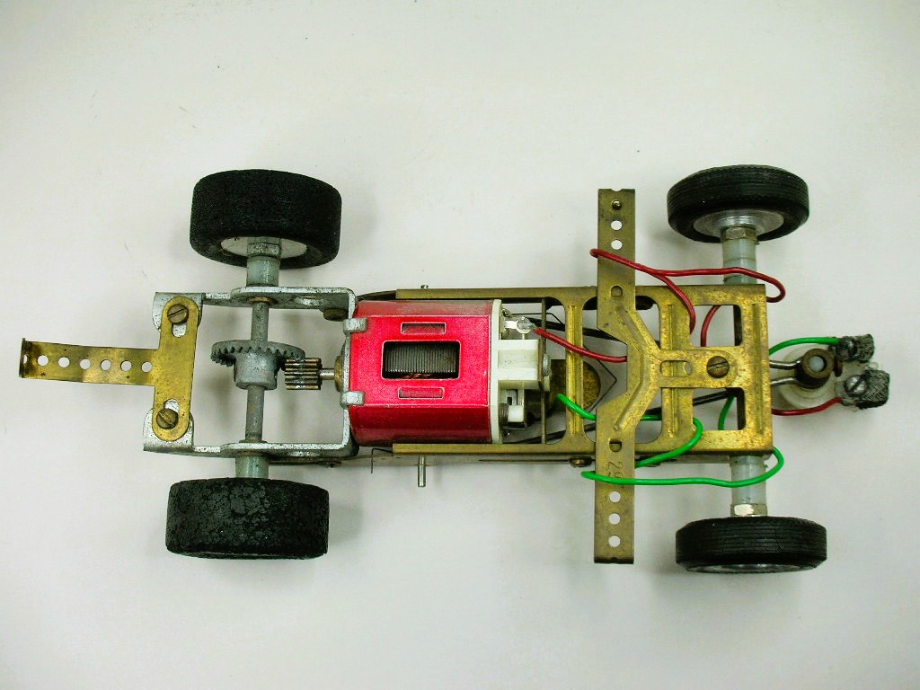

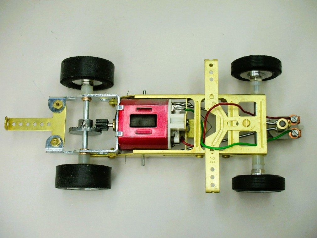

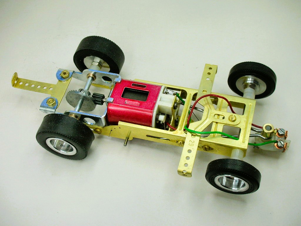

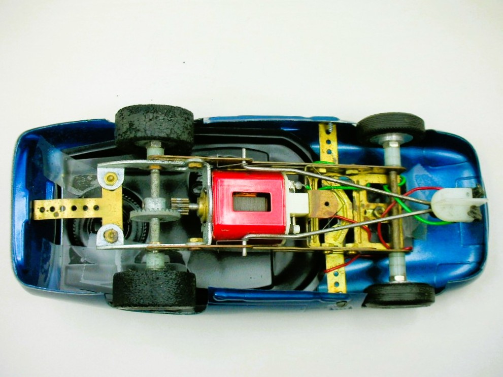

The chassis is coming together as its parts are cleaned up:

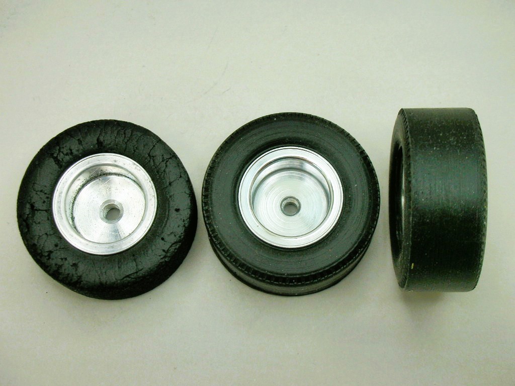

Time for some wheels and tires. The original tires were dried out and broke into pieces when removed from the wheels.
For rear tires I went with urethane reproduction Monogram slicks from a French firm called SLOTCARSTYRES.
Here's a link to SLOTCARSTYRES
Original dried out tire on the left beautiful repops on the right:
These French tires are not poured into an open mold with a crappy back side. Both side are nicely finished:
  • Pablo and munter like this

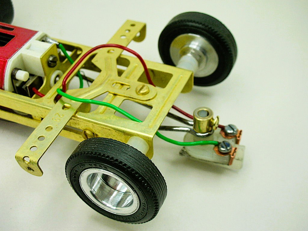

#17 dc-65x
  • 7,204 posts
Posted 04 January 2026 - 08:51 PM
The roller is all together.   :dance3:
Here are some before and after pictures:
Front and rear closeups:
New parts used:
1 pair    Cox Superflex style braid
2           5-40 threaded axles
1 pair   Monogram front tires
1 pair    urethane repop Monogram rear slicks
1           10T steel pinion gear
  • Pablo, munter, mickey thumbs and 1 other like this

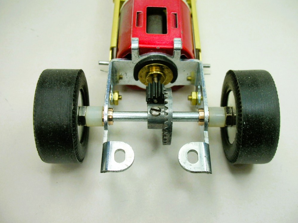

#18 slotcarone
  • 4,179 posts
Posted 04 January 2026 - 09:39 PM
Looks great! I notice you reversed the lead wires and the gear. How come? :D
#19 dc-65x
  • 7,204 posts
Posted 05 January 2026 - 11:43 AM
Hi Mike,
I removed the lead wires from the motor, trimmed a bit off and soldered them back on the motor for a nice fresh joint with no broken wires. I didn't pay attention to the original position of the colored wires. Functionally it doesn't matter.    :unknw:
I oiled the motor bearings, buzzed it up and put the crown gear on the side that I thought would allow the motor to rev the fastest and the car to go forward.
I like the later era motors that are timed in a specific direction. No relying on the sound of the motor to know which direction is fastest.   :D
  • slotcarone likes this
#20 slotcarone
  • 4,179 posts
Posted 05 January 2026 - 01:19 PM
Yes I remember way back when using the sound of the motor to determine the gear side very often. :)

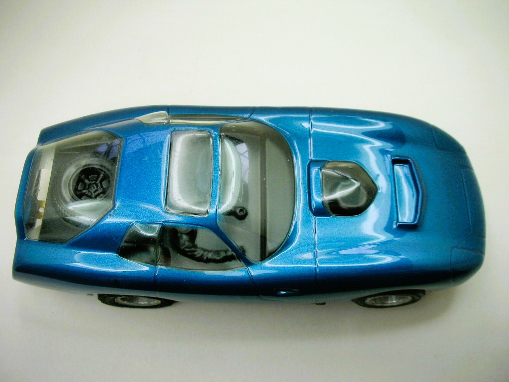

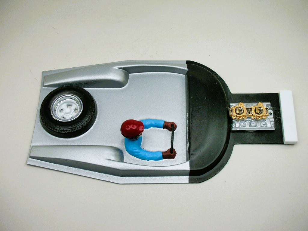

I've got the interior dolled up a bit. I hope with all the window area on the body this will brighten up the car a bit:
  • Tex, slotcarone, munter and 3 others like this

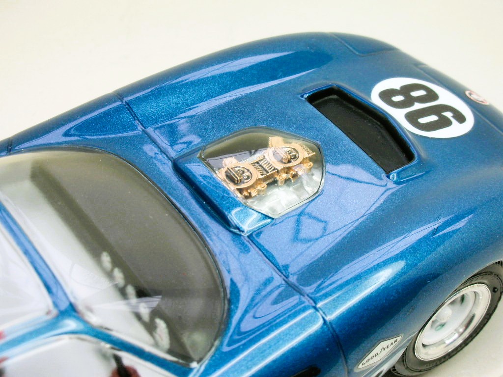

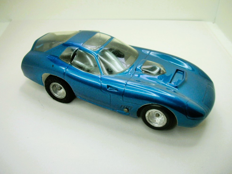

Thanks John. I thought the car could really benefit from some wheel inserts and engine detail and still look like a Monogram raceway kit car that it is.

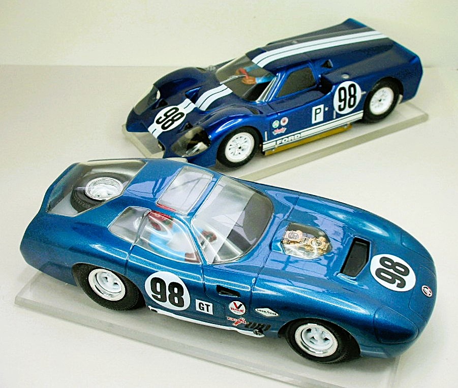

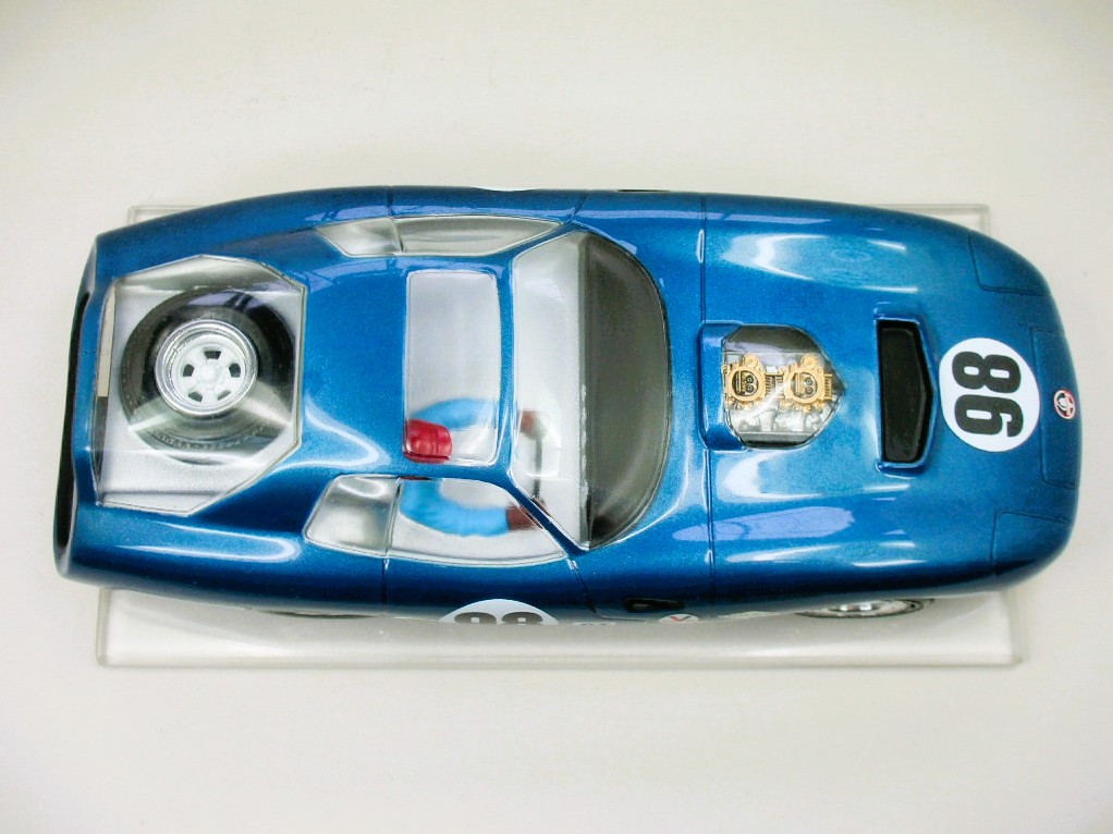

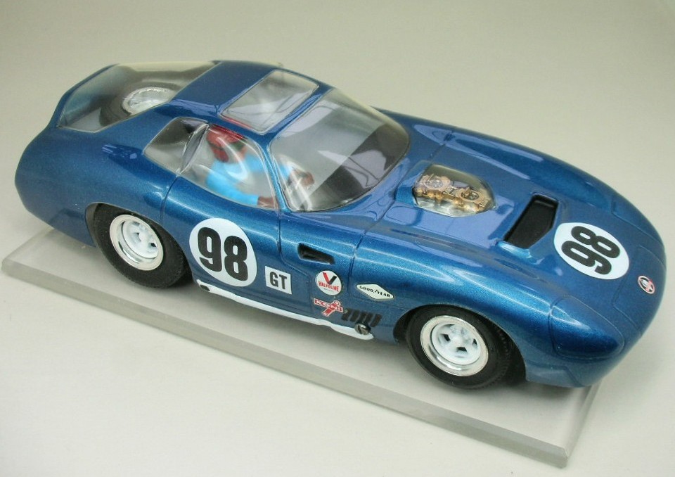

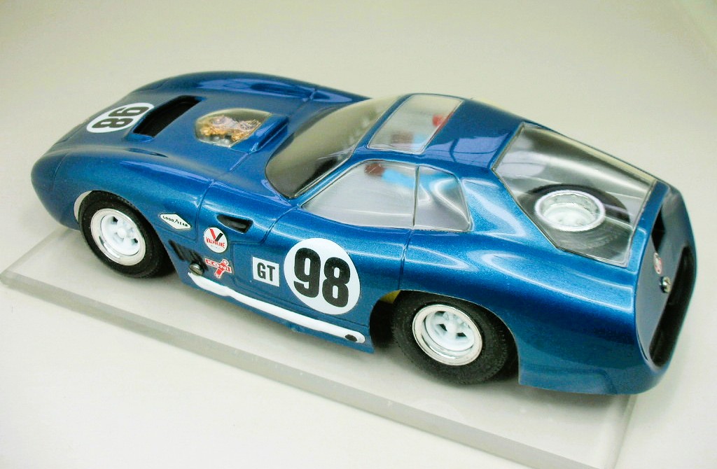

Here's the finished project:
I decided to do a "What If" livery as if Shelby American had actually raced the car. I also did this for my RAM 850 powered Ford J-car in the background:
Fun stuff!    :dance3:
