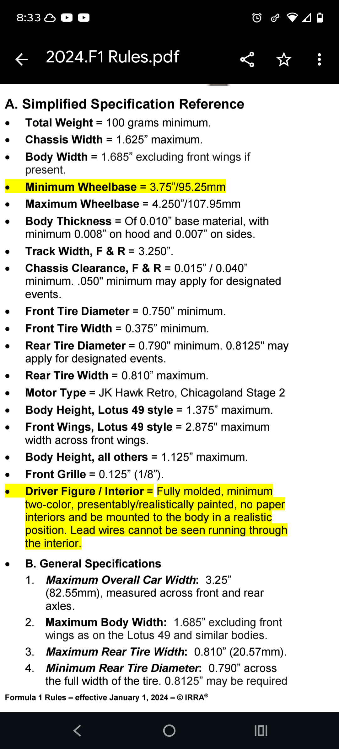

My simpleton brain is having some issues with the rear height and rear bumper height.
Is the rear bumper height the minimum rear bumper length? .750" from the top of the spoiler down?
I get the rear height of 1.250" for the Daytona, etc.
Is there going to be some clarification on the F1 bodies also? The way I read the rules is that only one body can measure 1.375" max height, all others 1.125" yet at every race my McLaren is legal at 1.375", unless my simpleton brain is failing me again.

Brandon:
Yes, the minimum size of the rear of the stockcar body is .750", that is from the top of the spoiler down to the bottom of the body.
As for the F1 bodies, a "Lotus 49 style" body is basically any body that has front wings and large rear spoiler.  At the time the F1 rules were written many were still using bodies like the Maserati which just had relatively low exhaust pipes and no front wings.  Virtually any body with the large rear spoiler and front wings would fall under the "Lotus 49" rules.

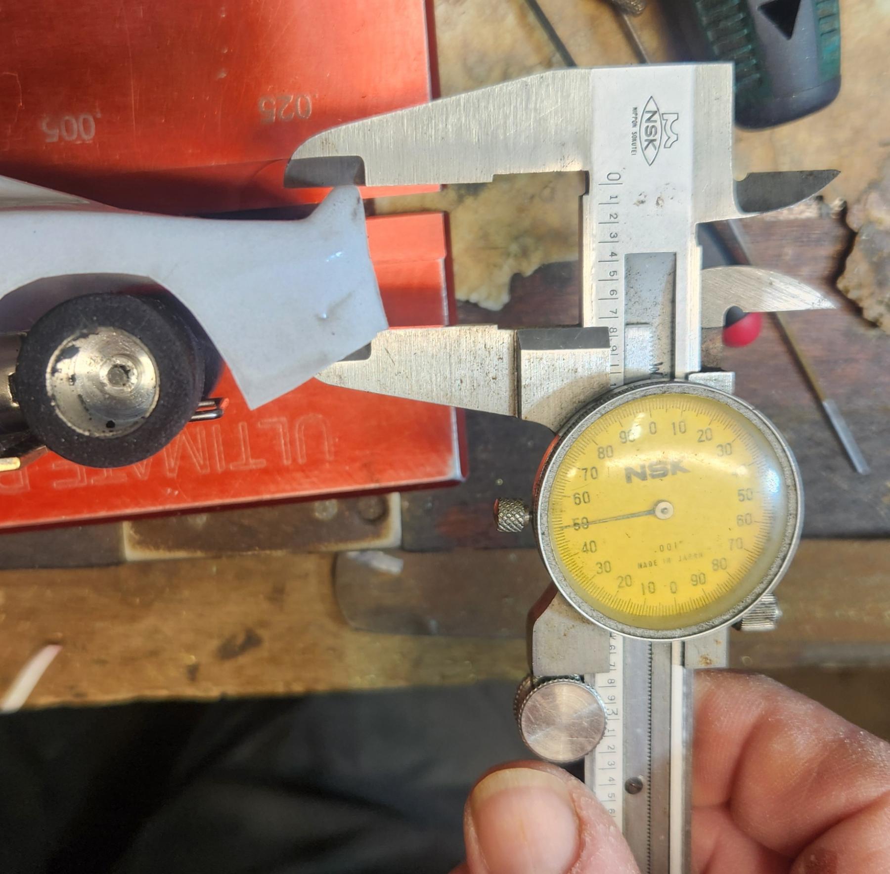

As requested here are pics explaining the rear bumper height.

#14 slotcarone
  • 4,179 posts
Posted 19 March 2026 - 07:20 AM
So this really is the total height of the rear of the body not just the bumper. :)

#15 Dominator
Dominator
  • 3,134 posts
  • Joined: 19-September 07
Posted 19 March 2026 - 12:24 PM
Measurement from the top of spoiler to the bottom of the bumper.
Rear body height is measured from tech block to top of spoiler.
